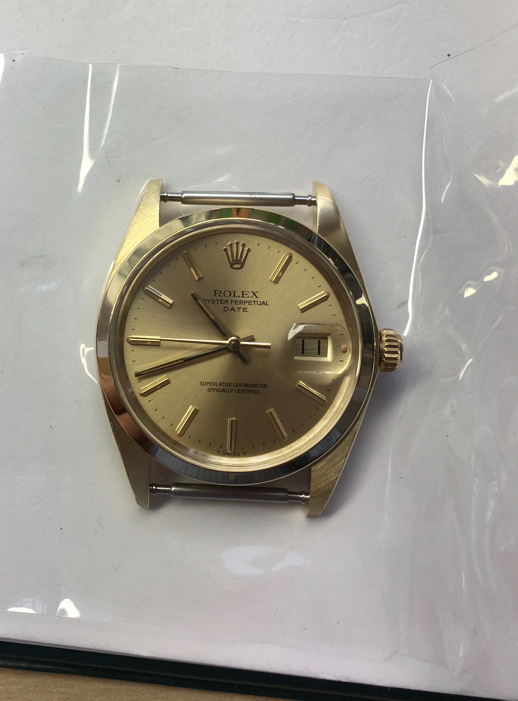

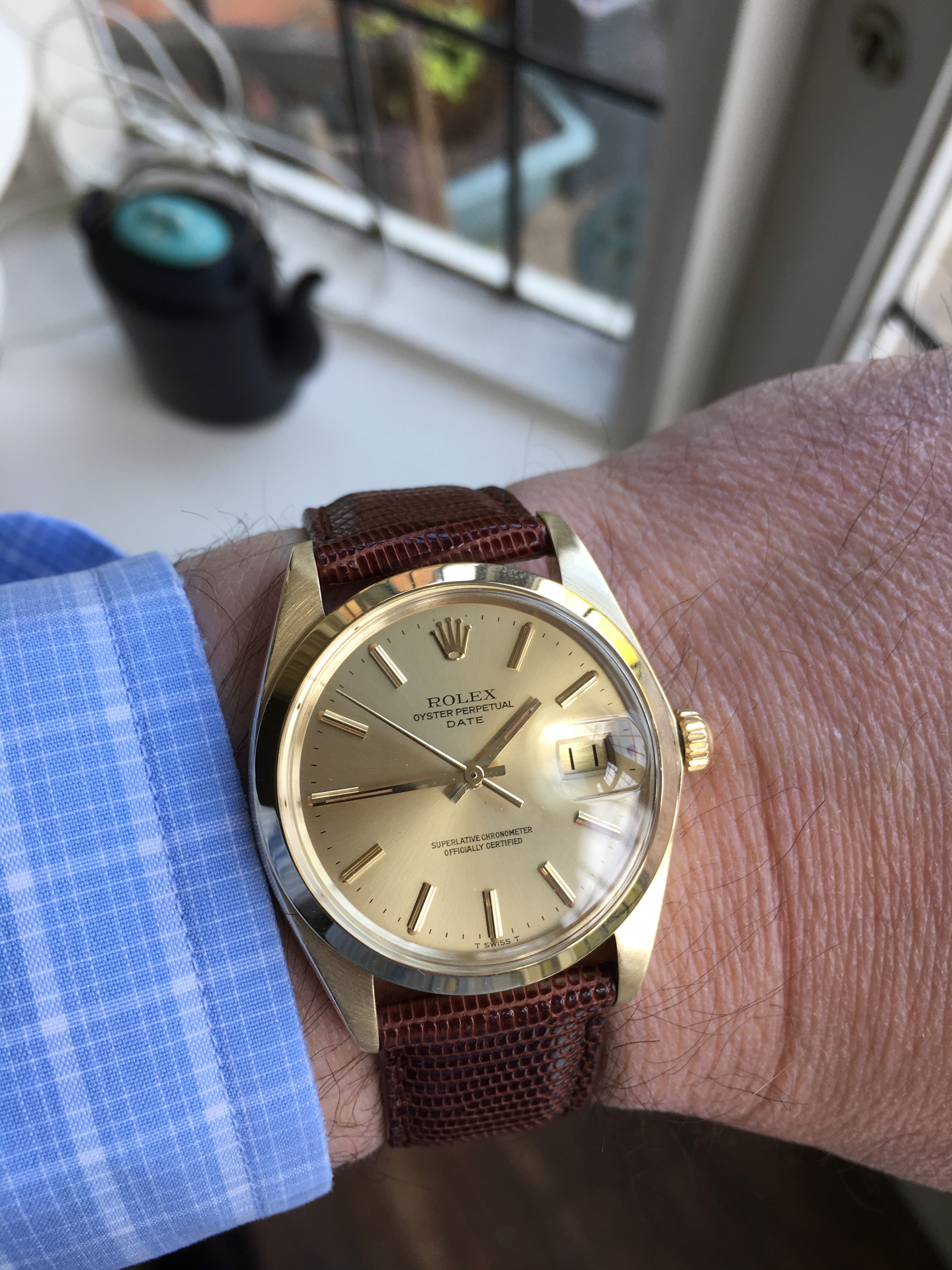

Here is a solid gold 1978 Rolex which came to me in a pretty worn and poorly state, sadly I don't have a decent before photo but the lugs were worn smooth with small dents, the crystal was cracked and the bezel scuffed. STS did the refinish as part of a full service at a price considerably cheaper than RSC. I think this looks much better this way.
Sorry for the minor thread hijack but I wanted to add weight to the argument that refinishing isn't necessarily a dirty word.
Thanks for taking time to explain that to me. It’s interesting to learn what that is all about and how it differs from just polishing a watch to a super sheen.
That Rolex is magnificent too!
