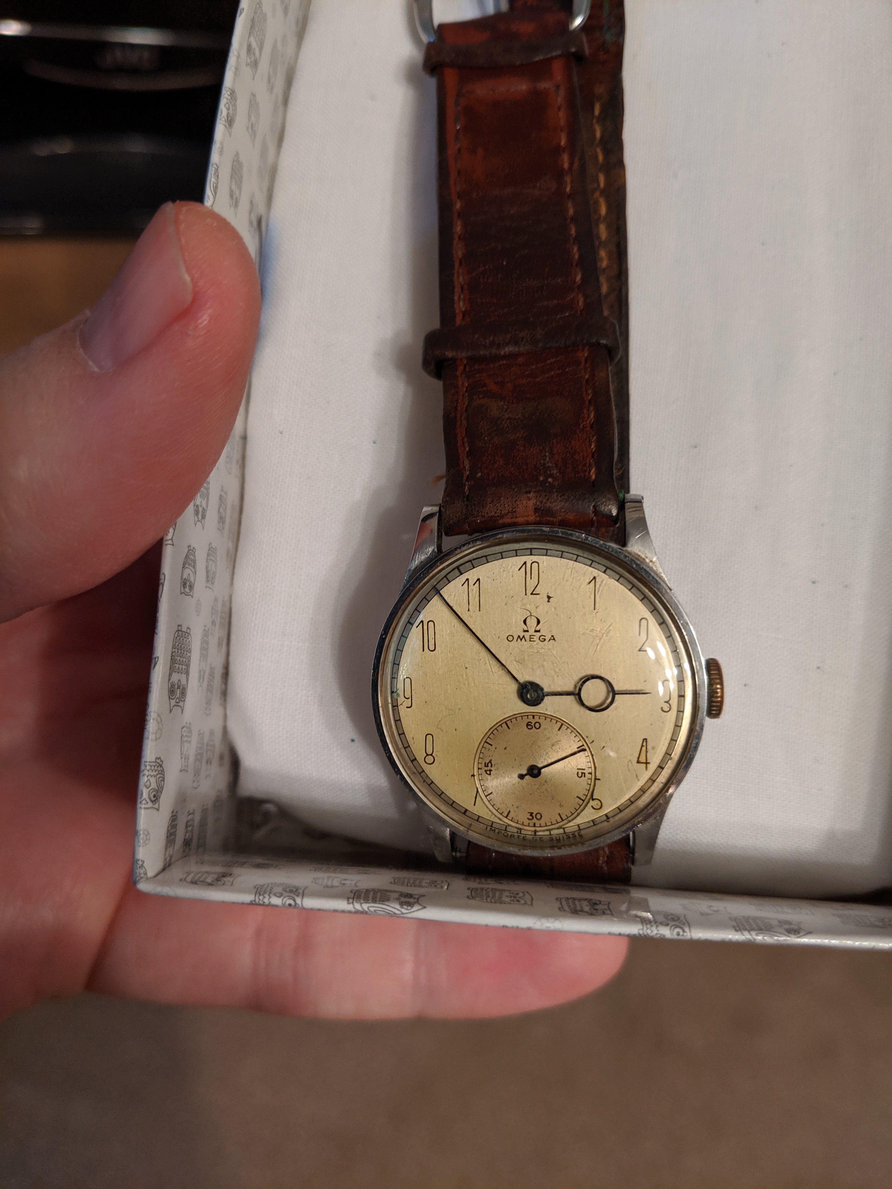

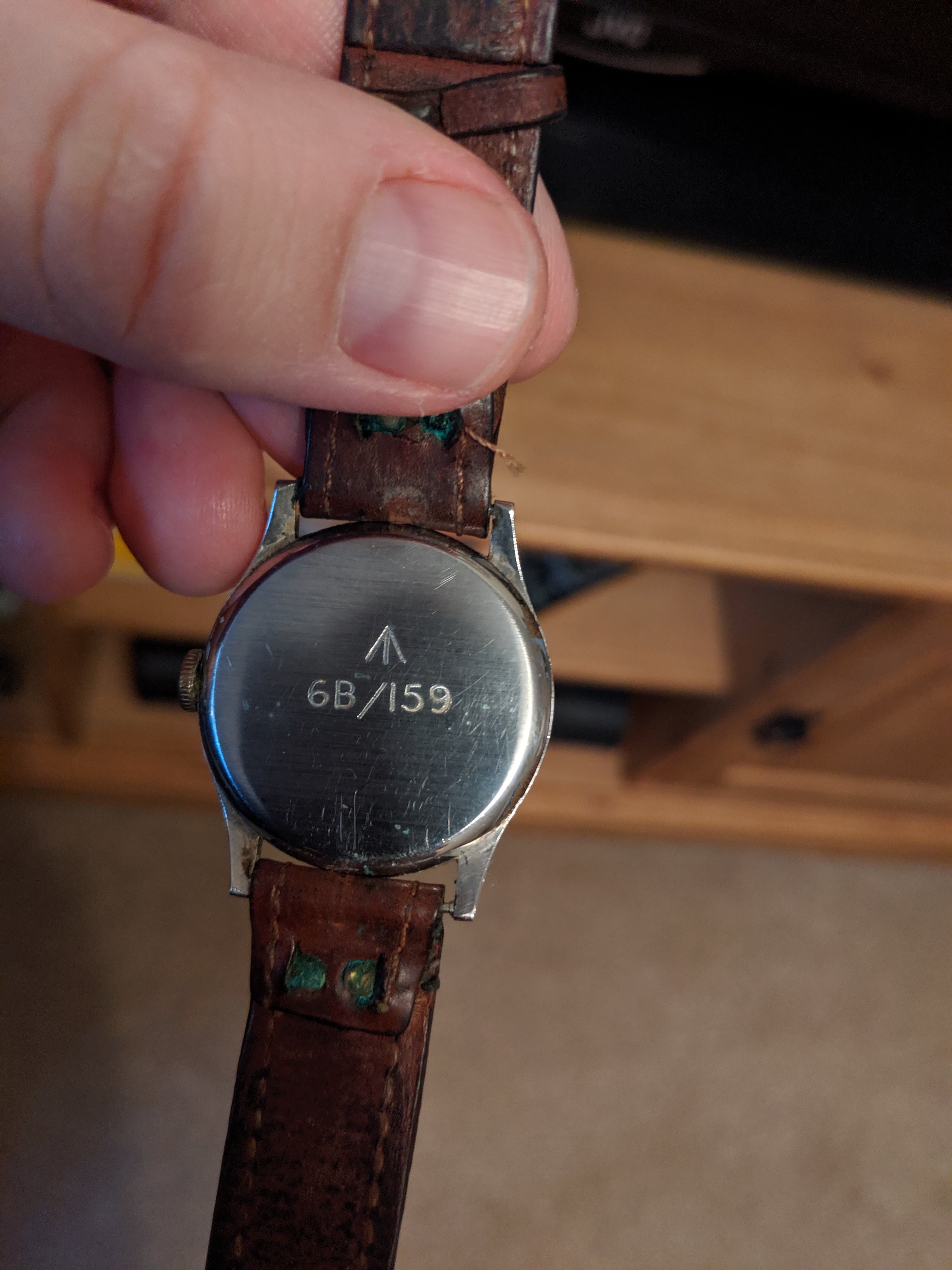

Hello,
I've been passed down my grandfather's old Omega watch.
From a bit of googling of the numbers on the back (6B/159) it looks like these were RAF issued watches in the 40's or 50's. He was in the RAF in WWII so this adds up but is long dead (RIP) and we know nothing about it other than the fact he was "very proud of it". We don't know what he did in the RAF but wasn't a pilot.
I've attached images of the watch and have a couple of questions if people would be so kind to help point me in the right direction:
1. How do I find out the history of the watch?
2. Is there somewhere trustworthy I can get it repaired? I'm in London, UK.
Many thanks

Very cool watch! Interesting that it says importe de Swiss. Nice heirloom. Try to get some better pictures of the face of the watch. Local help is on the way!
106
338
I am sorry to say a quick google search will show you that not much of your watch looks like a 6B/159. These watches were from the 1940's and had sweep second hands rather than the sub dial yours have. Also dial and hands are definitely not correct and the lugs were fixed.

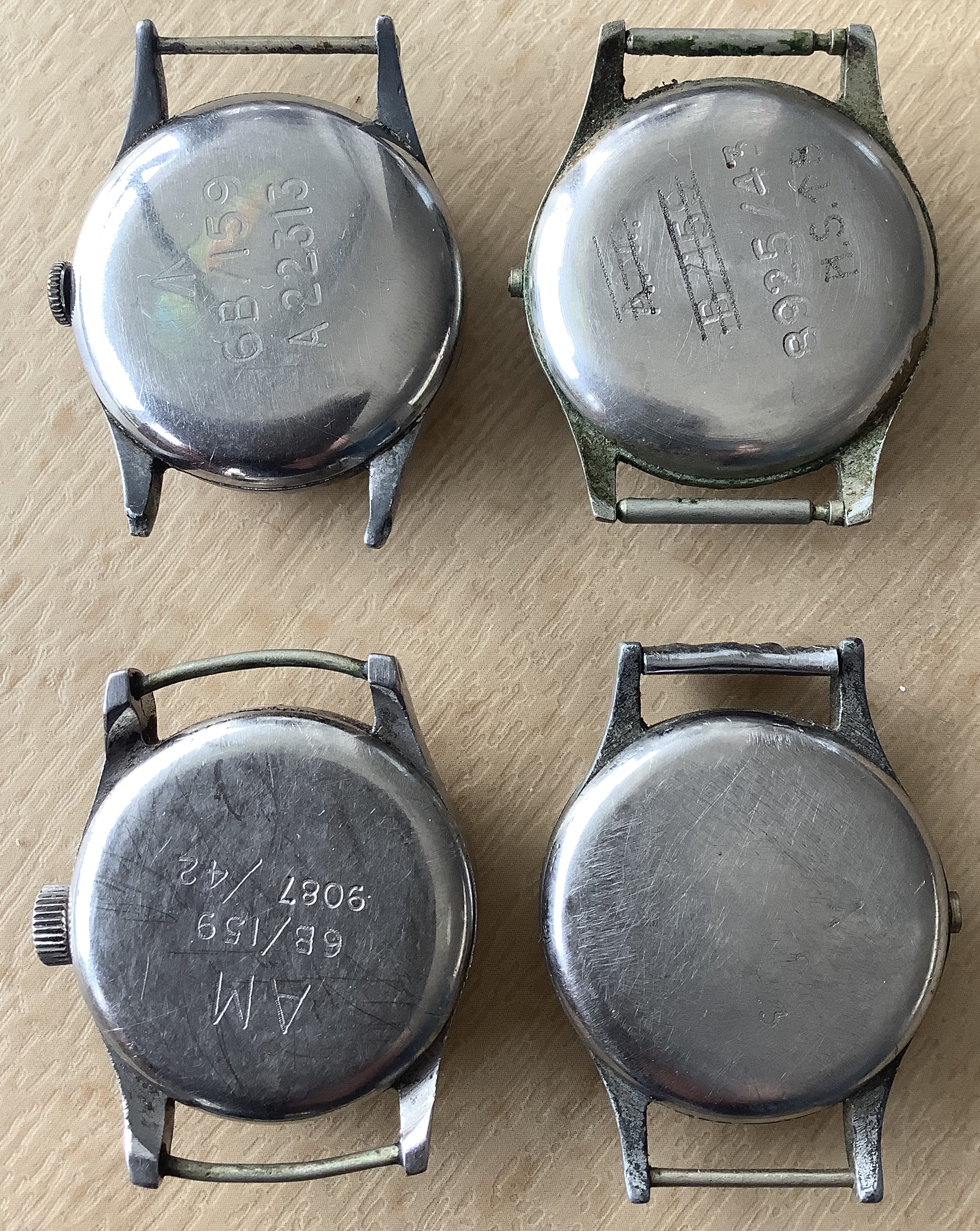

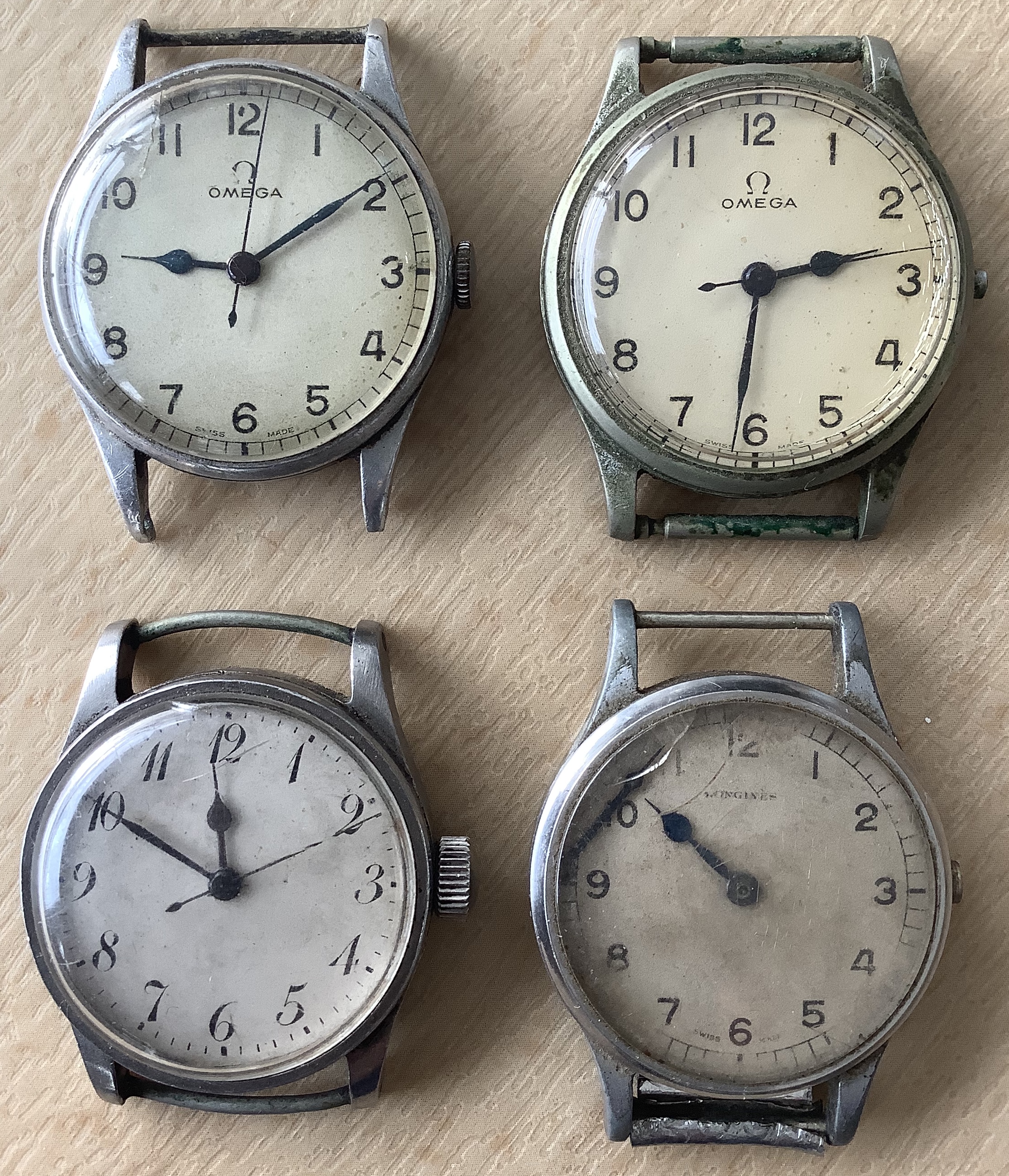

I’ve got a bunch of 6B/159 projects. This is what they should look like.
Well, not as knackered as these but you get the idea 😁.

Ive owned a 6B and HS8 in the past. I really like that dial but nothing about that watch looks like its from a 6B. Even the caseback looks odd.
7,690
22,055
Hi there,
This watch looks lovely and is priceless as a keepsake from your grand father.
as others have pointed out, it does not comport with the very strict specifications of RAF watches, and from a collector’s standpoint it’s a bit of an oddball.
The dial is a nice civilian dial - the movement is definitely not RAF as stated above. The markings are intriguing even though again not in keeping with Royal Air Force standards.
I would suggest you post it on the Military Watch Ressource Forum and see what the guys there have to say about it.
All of the above again just for the sake of discussion, because again it is a nice watch and a family heirloom.
It may well be that the watch was assembled from loose ends from the time your grand father was in the military and may have held sentimental value for him regardless of what collectors have to say about it.
