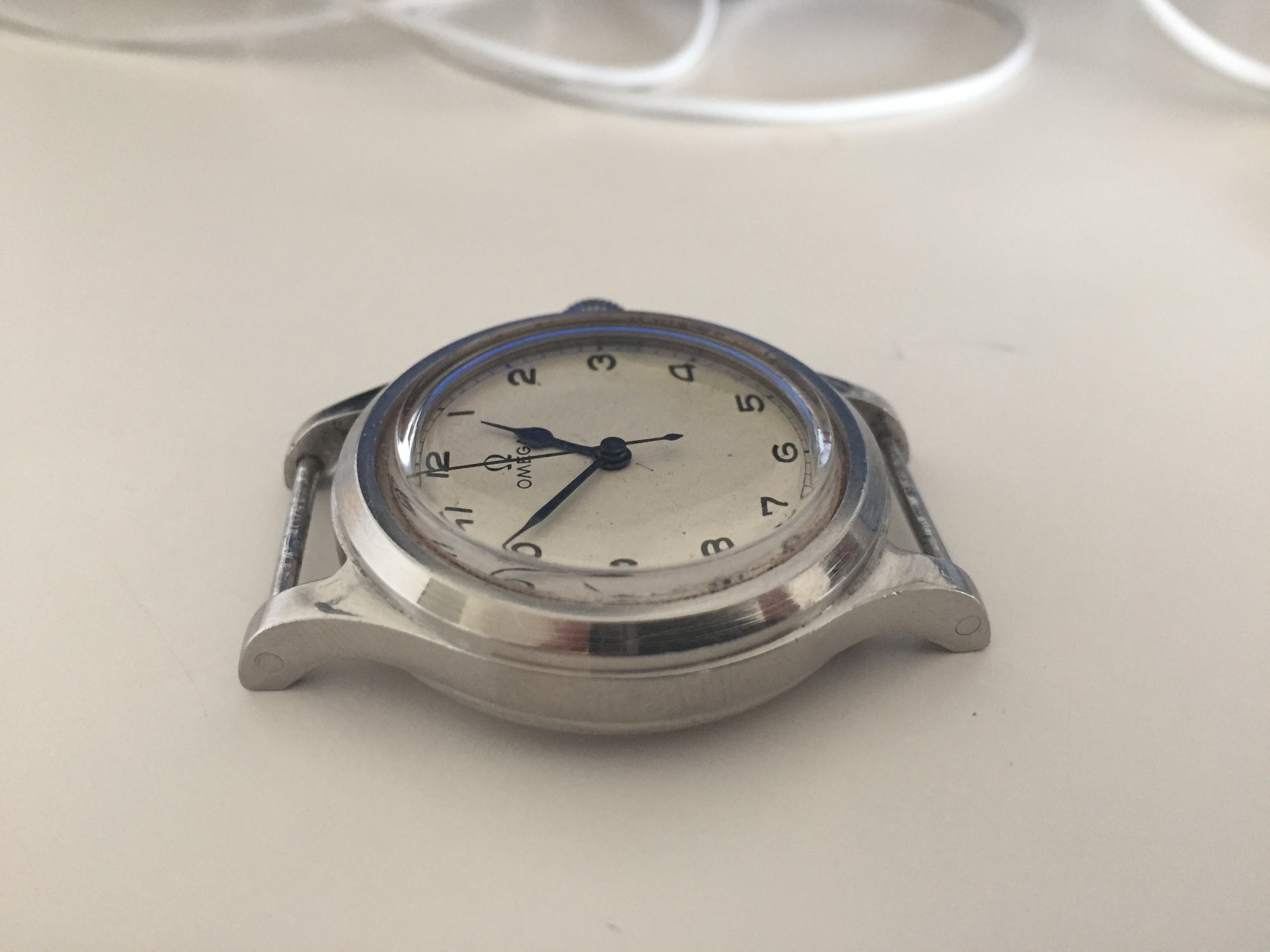

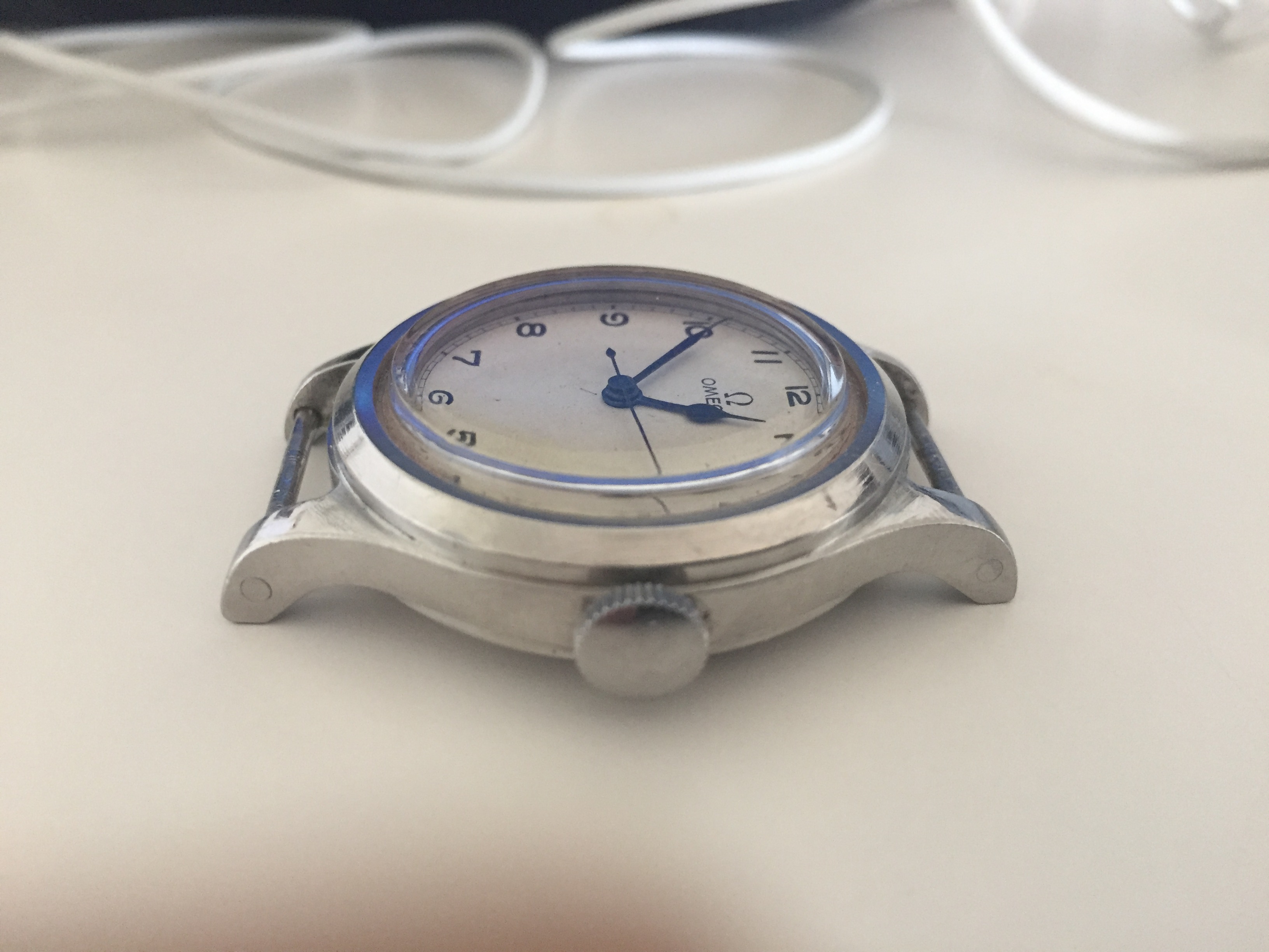

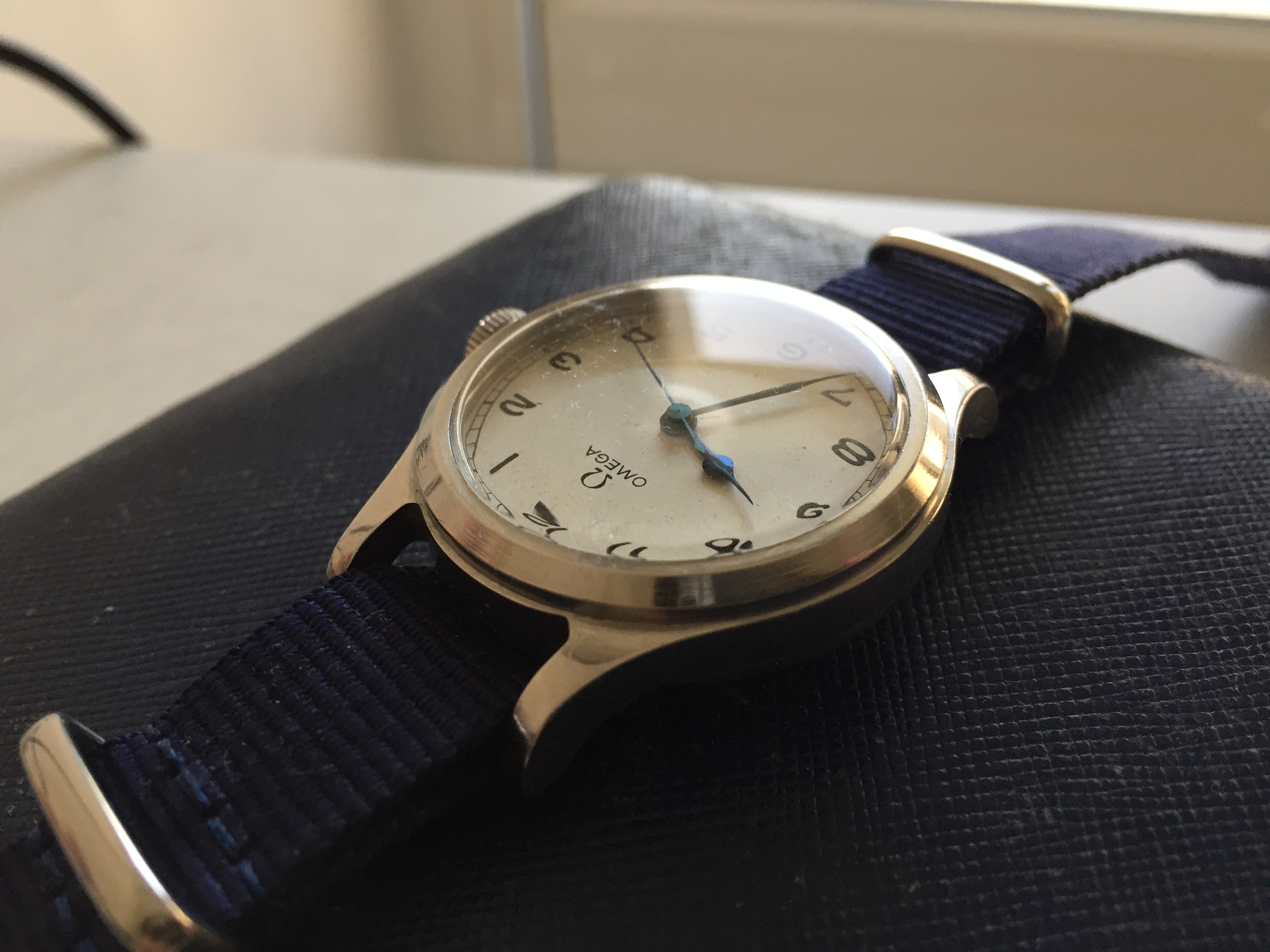

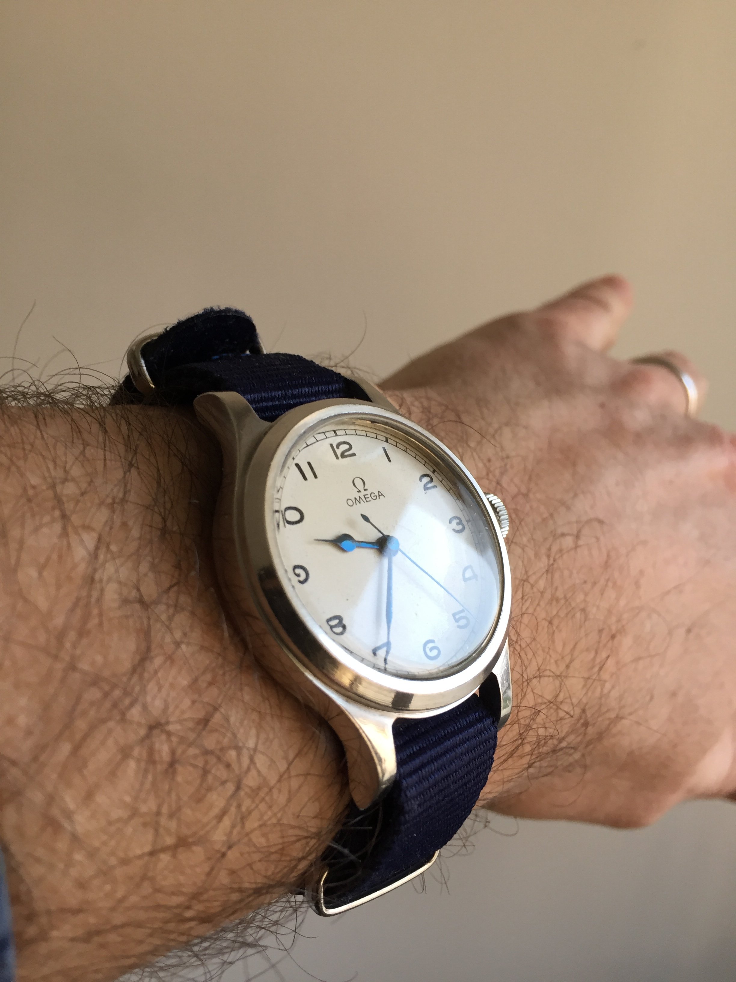

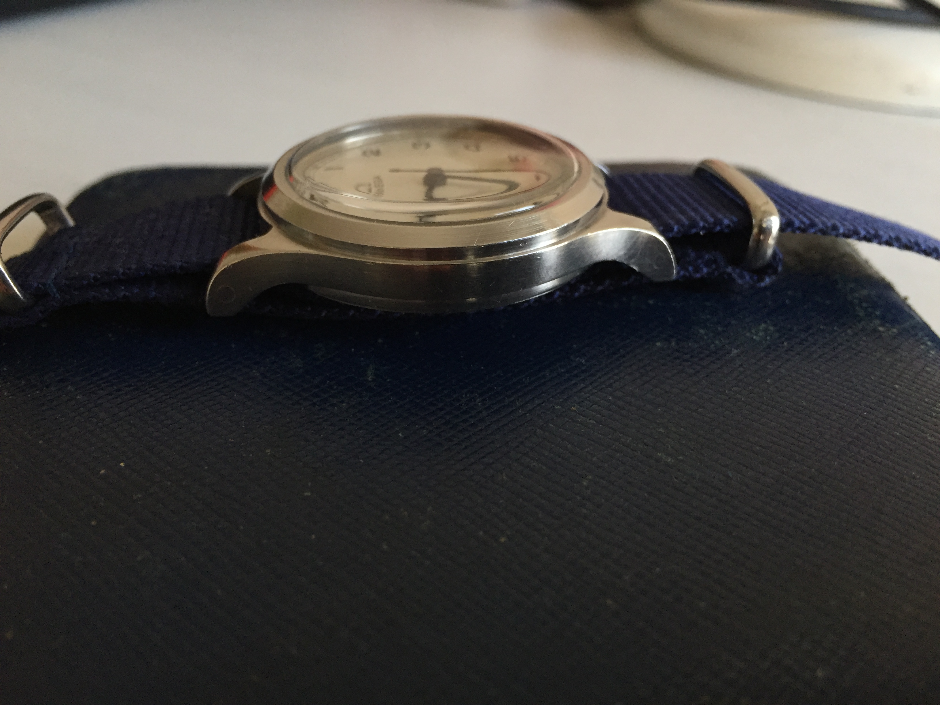

Hello,
I'm new in this superb forum, and I first want to thank you for permitting me to post my question.
I recently had the chance to get a wonderful Omega AM 6B/159 56. Which is in my opinion one of the beautifulest military watch.
It's a gorgeous watch... but I need to change the crystal, because the one fitted now is not appropriate : it seems that the previous watchmaker who overhauled it didn't find the proper crystal and put a solid one, but not very beautiful (it's a non-dome version).
I read that it is a special acrylic crystal, with a horizontal lip 'underlayed' inside the case.
Could you give me some informations about this ? I think it could be something like this :
https://www.cousinsuk.com/product/seal-domed-bcl
As I'm not sure, I prefer to ask to you, Omega specialists :
which underlayed acrylic crystal would better fit this watch ?
If you know the size of it, it would be also great !
Thank you very Much

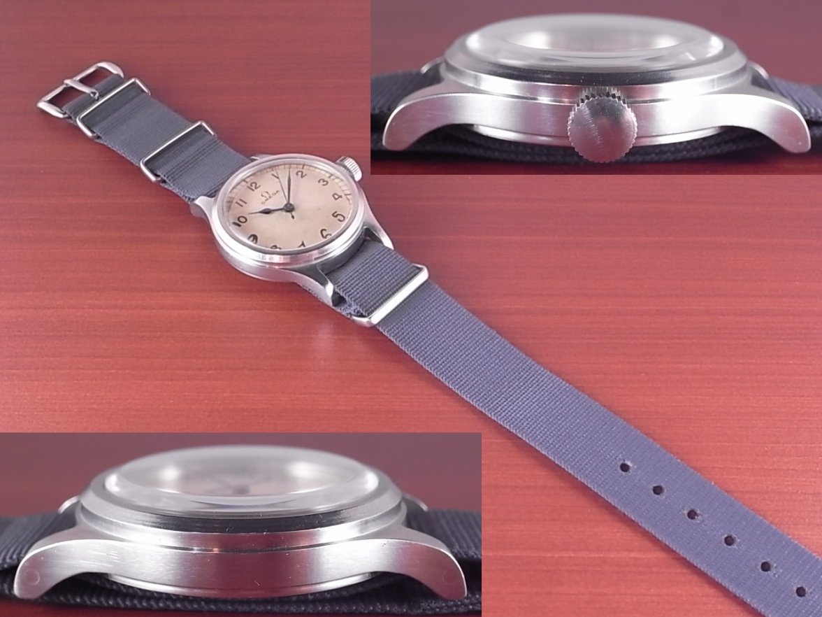

I found this online, it might help you choose?
It's exactly what I'm looking for.
By the way, this one has been overpolished in my opinion.

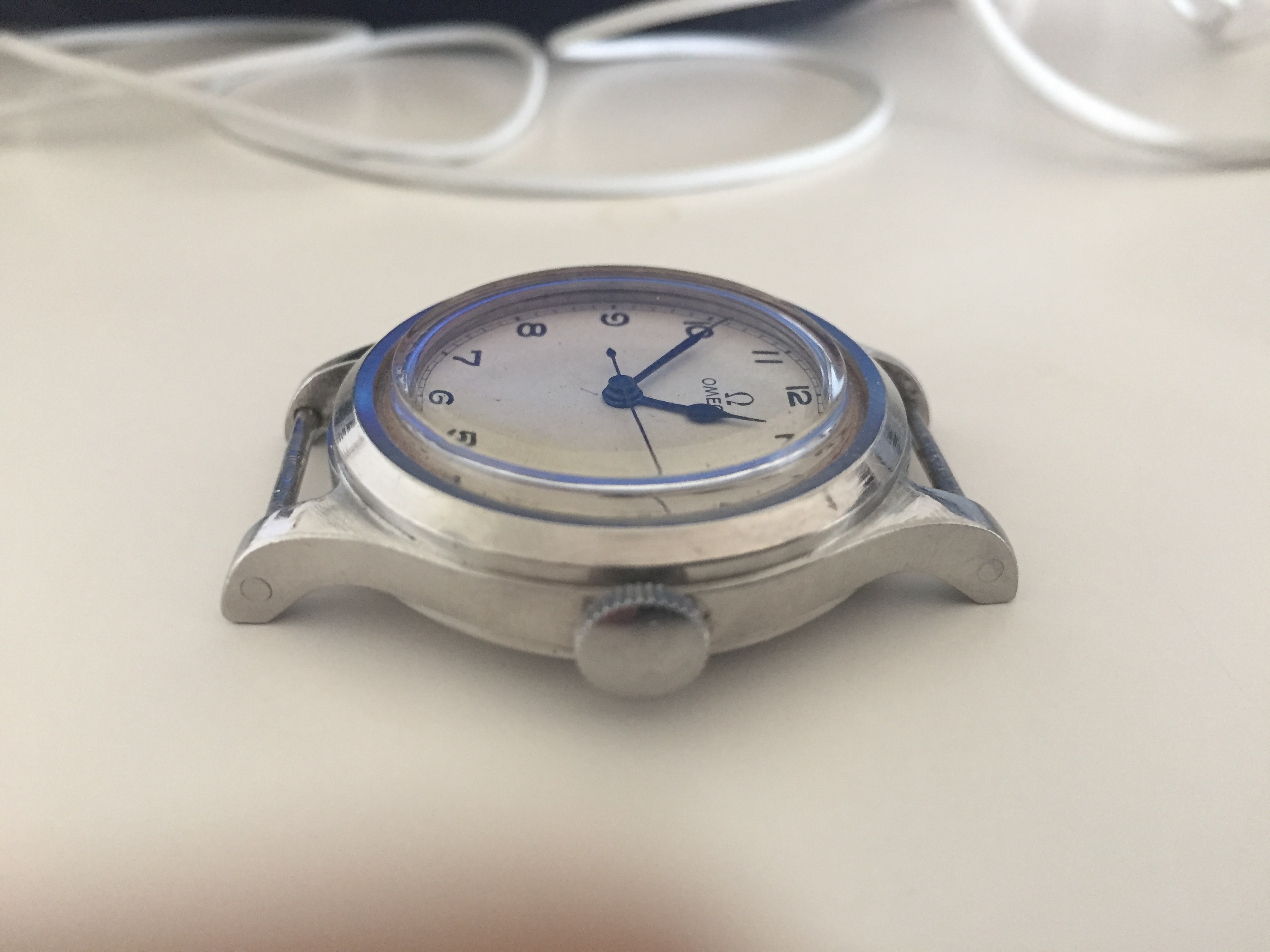

I opened the watch in order to discover how the acrylic crystal is fitted.
There is an internal tightening screwed ring in the case, which holds the underlayed crystal by the inside.
I had never seen such a system before. This Dennison case is very well thought out, with a beautiful solid stainless steel !
As I don't have the tool to remove this internal ring, I dropped my 6B/159 56 at my watchmaker's.
I will let you know when the crystal will be swapped.
I cannot wait to get it back!
Thank you

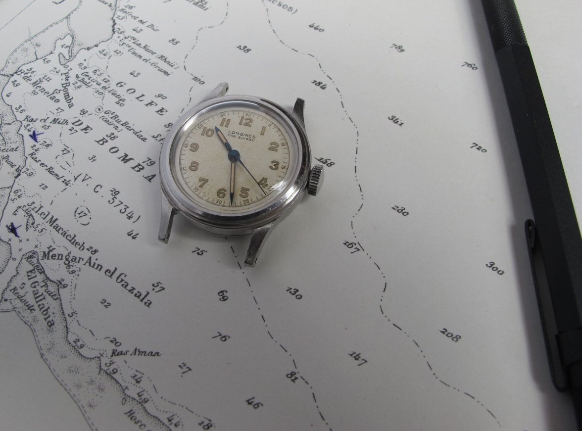

Fortunately, I have this Longines Marine Nationale that compensates for the absence of my Omega ...

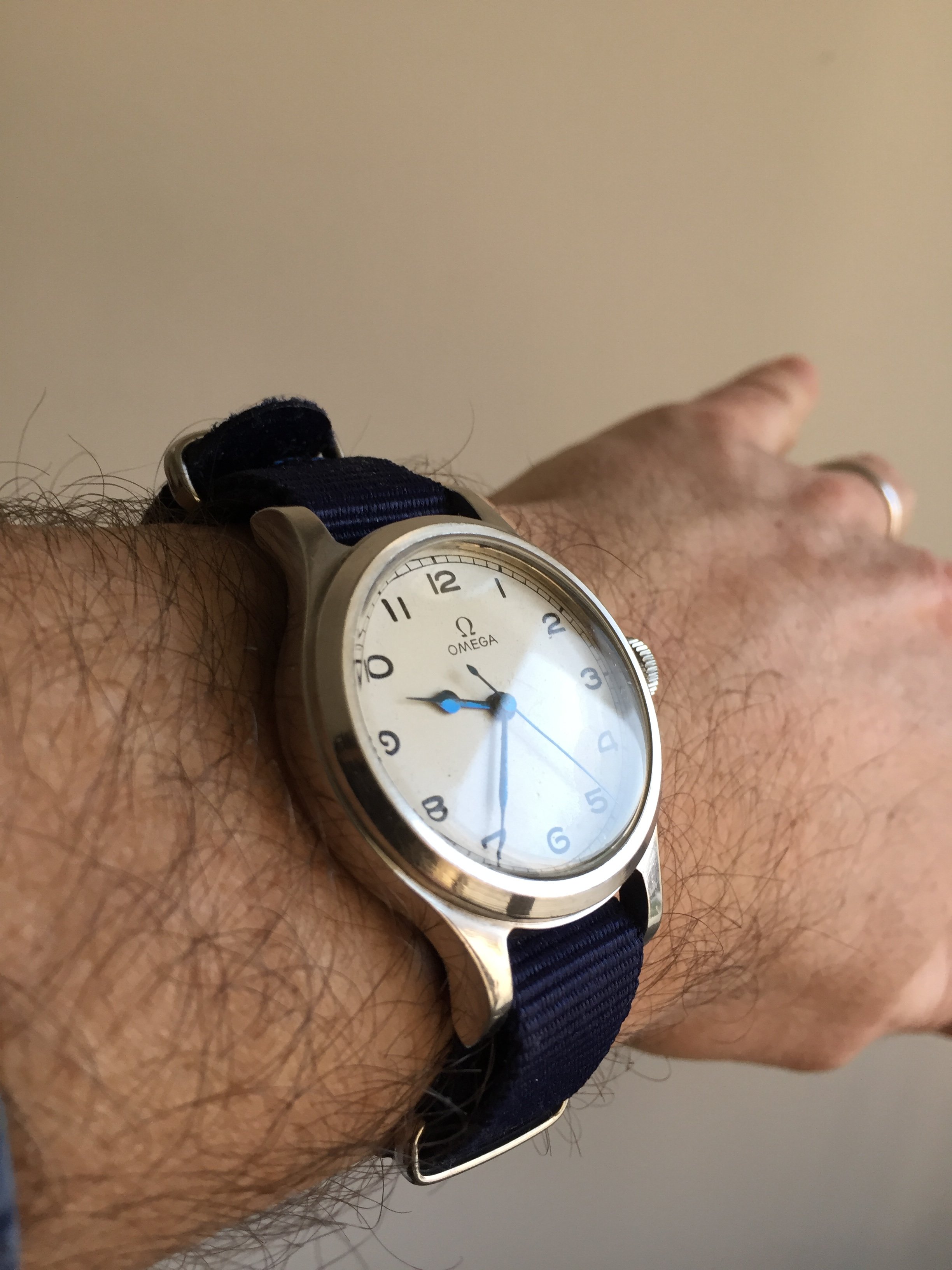

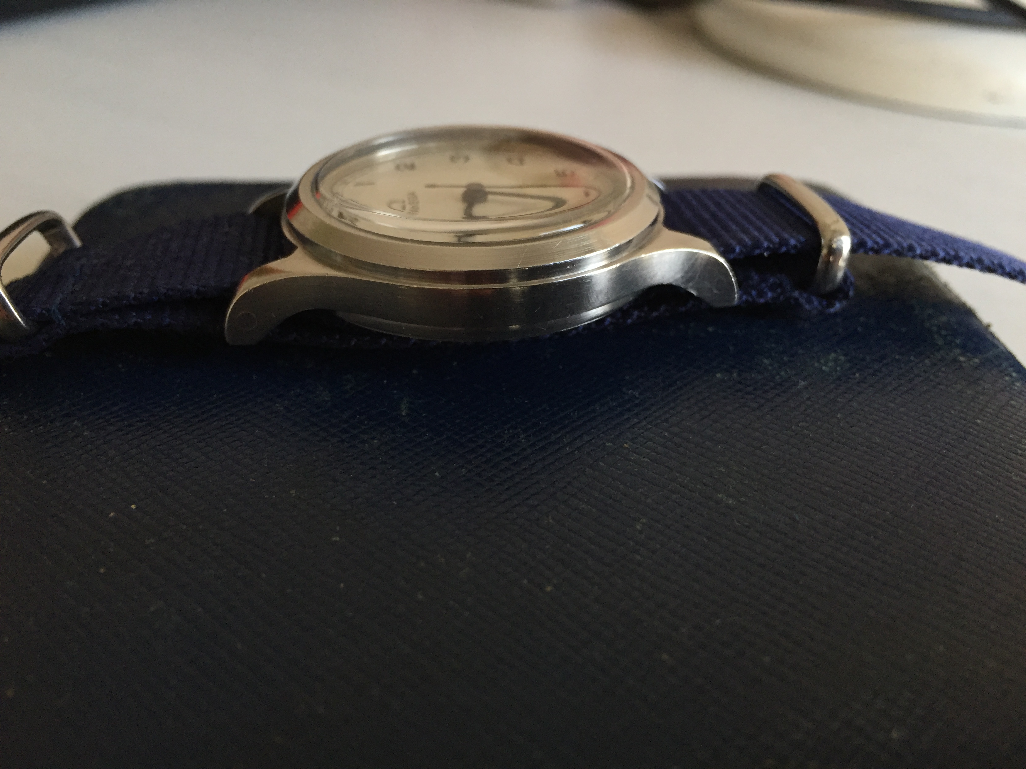

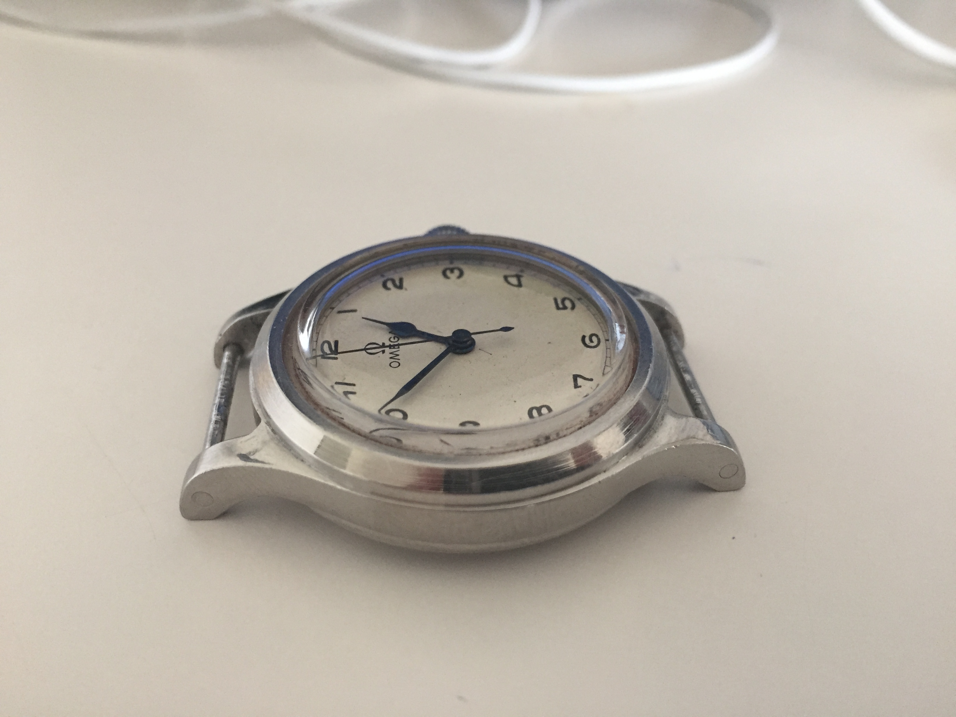

Thank you a lot for all your advices, I finally found a proper crystal and succeeded in install it (by myself, following Archer's advices) !
Best regards,
Best regards,

Hello,
I contacted Ian Wilkinson in the UK, and bought him this crystal (exactly the good size);
After that, in order to install it, I modified the pins of a case opener, to tighten the threaded ring (as Archer indicated), and it worked very well.
Can you send us some pictures of your watch ?
