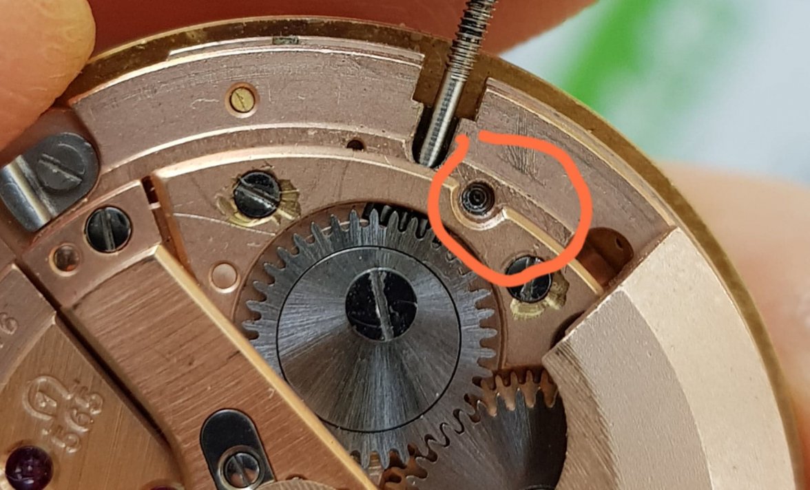

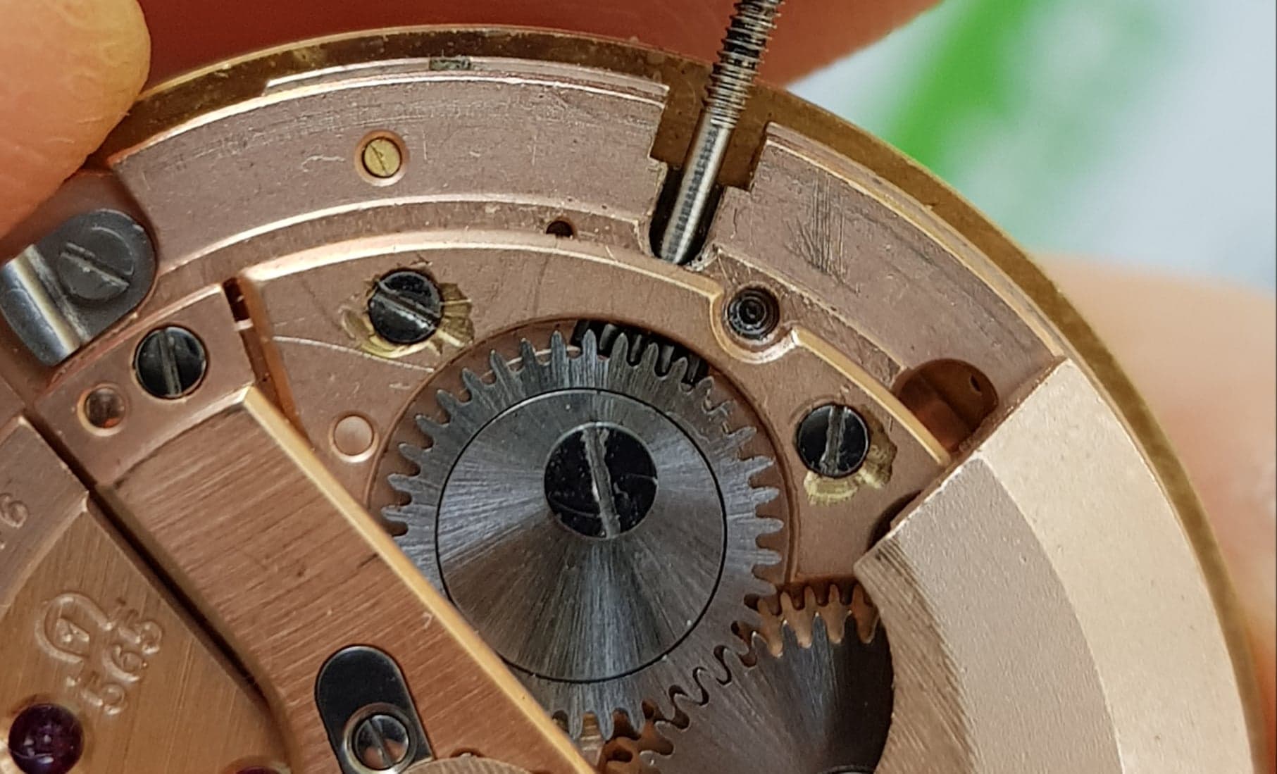

Today I removed the 565 movement from my Omega Geneve watch in order to clean some dirt from the back of the glass.
When I tried to refit the stem and crown I have discovered that the pusher that releases the stem is stuck in pressed down position and the stem comes out.
There is an easy fix?
Thanks!

Yes - remove hands, dial, disassemble calendar, fix it, then put it all back together.
Cheers, Al
411
1,412
As Archer said. No other way to fix it. Lever has jumped out from position.
Its pain in the ass when this happens 馃榾, becouse you need to be carefull not to damage hands and dial. In your case if dial and hands are in same condition as movement you dont need to be carefull, just do it.

Does anyone know how this happens? Is there a push equivalent of turning the screw too far anti-clockwise and accidentally disengaging it from the plate?

No - the "button" is part of the setting lever, so there's no way they can be disengaged like in a system that uses a setting lever screw. Likely the button was pushed too far in, and the yoke came out of the groove in the sliding pinion.
It's possible also that the hole that the setting lever "button" goes into might be dirty, causing it to stick...but most likely the yoke is out of position.

Filthy, poorly serviced movement; the old oil and dirt acting as a cement. Possibly chips from the watch beaver jamming it.
