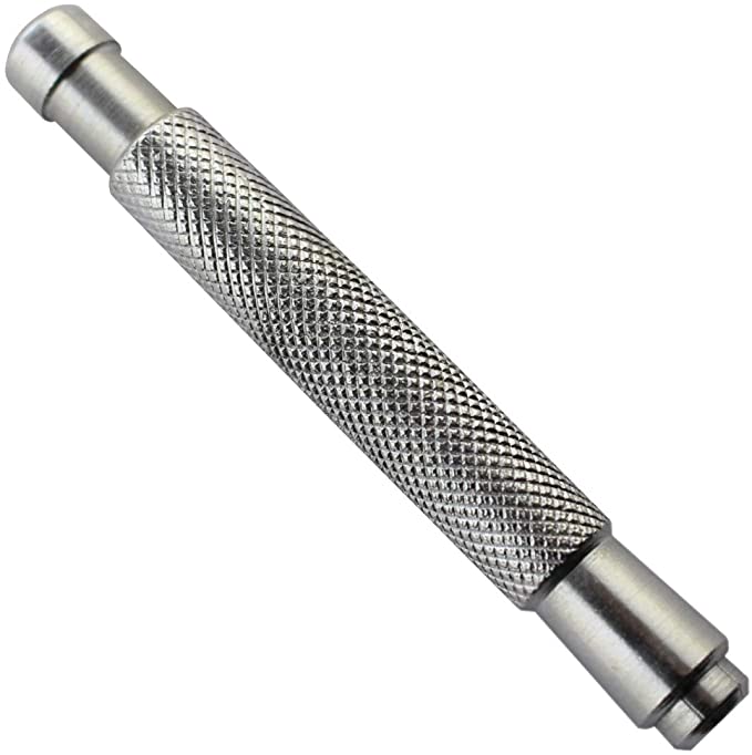

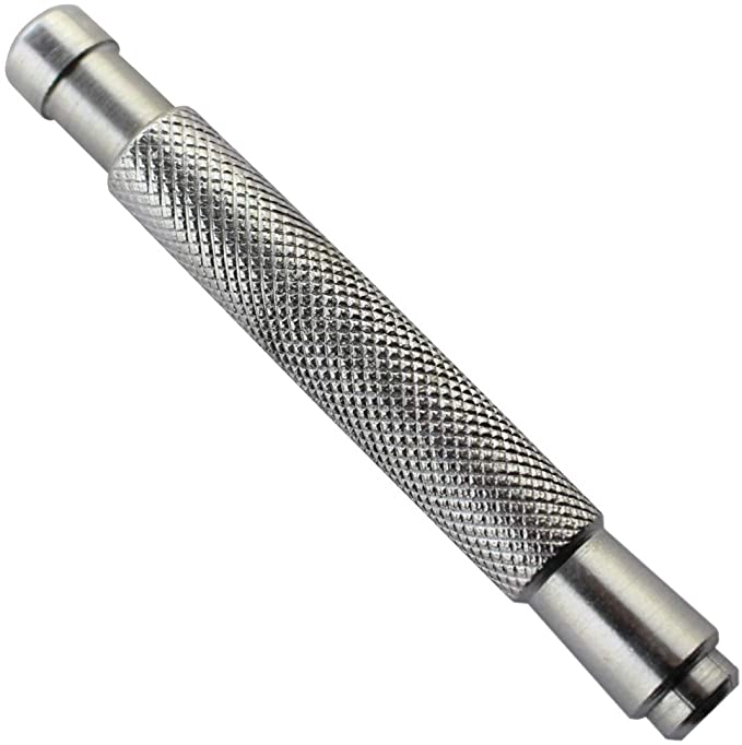

I have a couple of 165.003s, also with the recessed crown.
I use a watch crown winder (but bear in mind they come in different sizes)

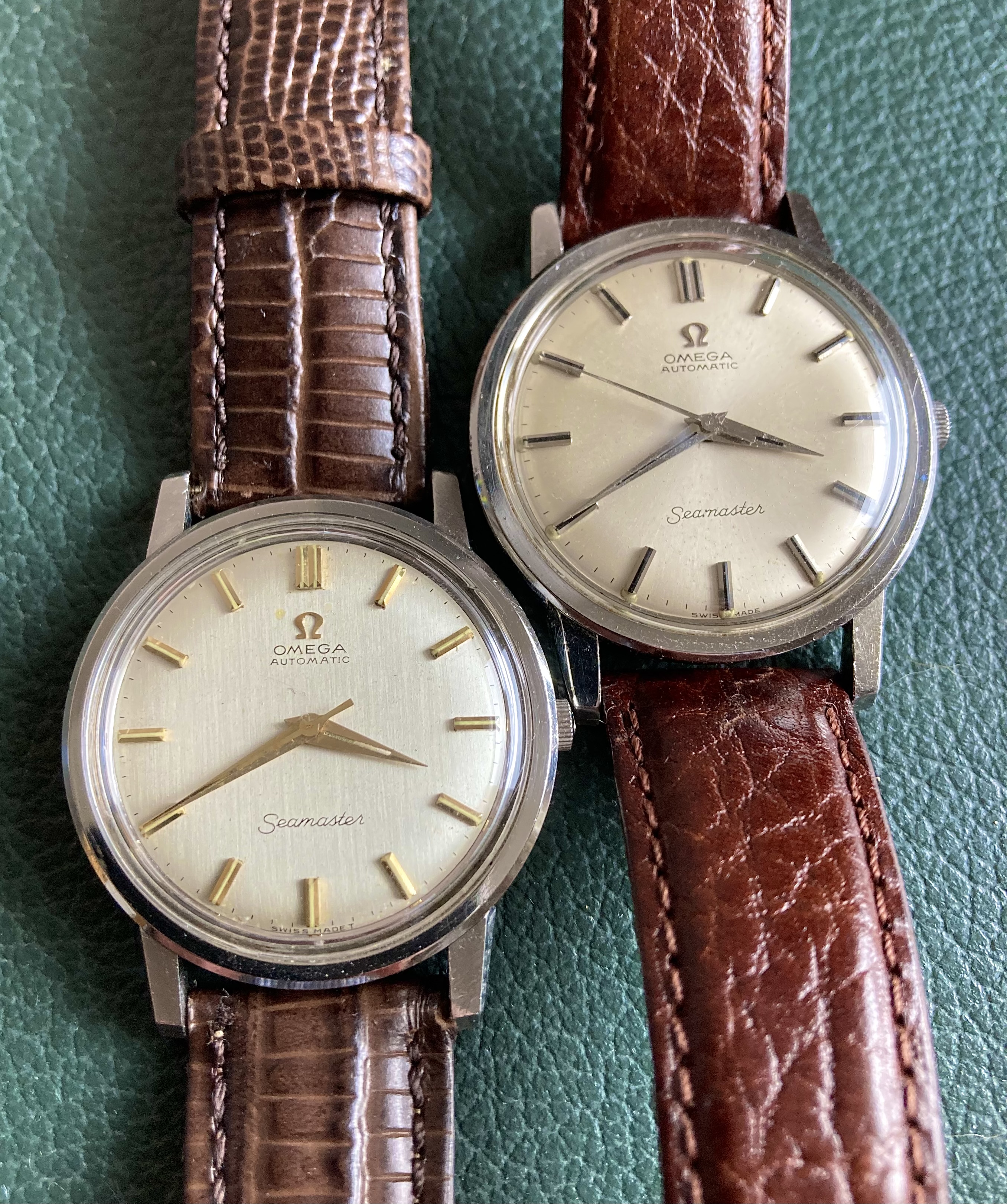

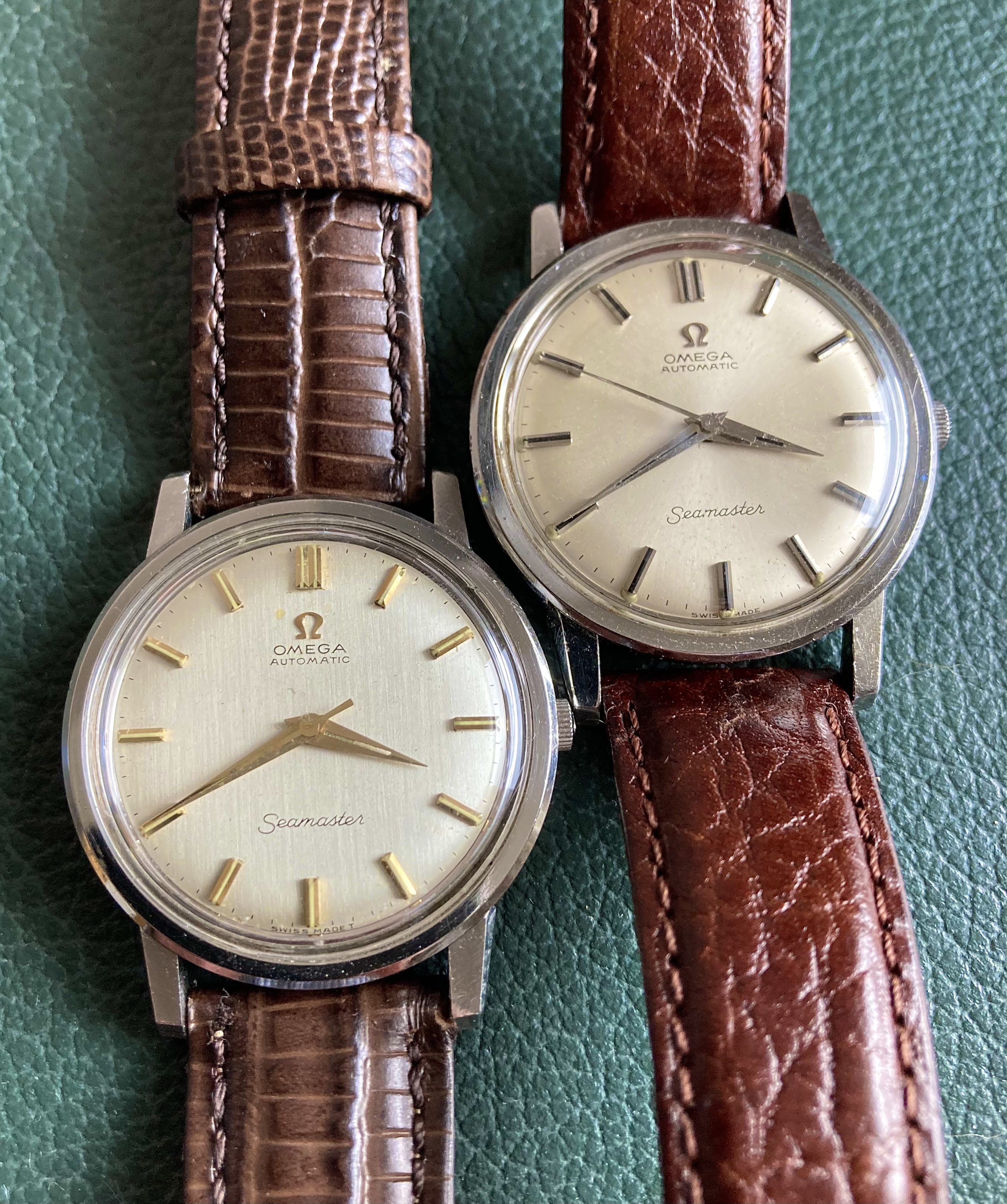

Wow @Spruce I had no idea you were a .003'er also, we have so many interests in common 😁 I can't wear my C-Case's as I care about them too much, yet enjoy this 166.003 immensely, pictures don't really do it justice, the lugs ...
Luckily 550 Auto's are pretty performant, even just wearing this thing a couple of minutes gets it wind, so going to ignore the issue, but thanks for the suggestion, had no idea such a tool existed, I might get one for smaller tanks

These are my boys 😀 I was so pleased with them but they now take a back seat compared to the various C cases (Connies, Admirals & others) that I’m currently hooked on.
