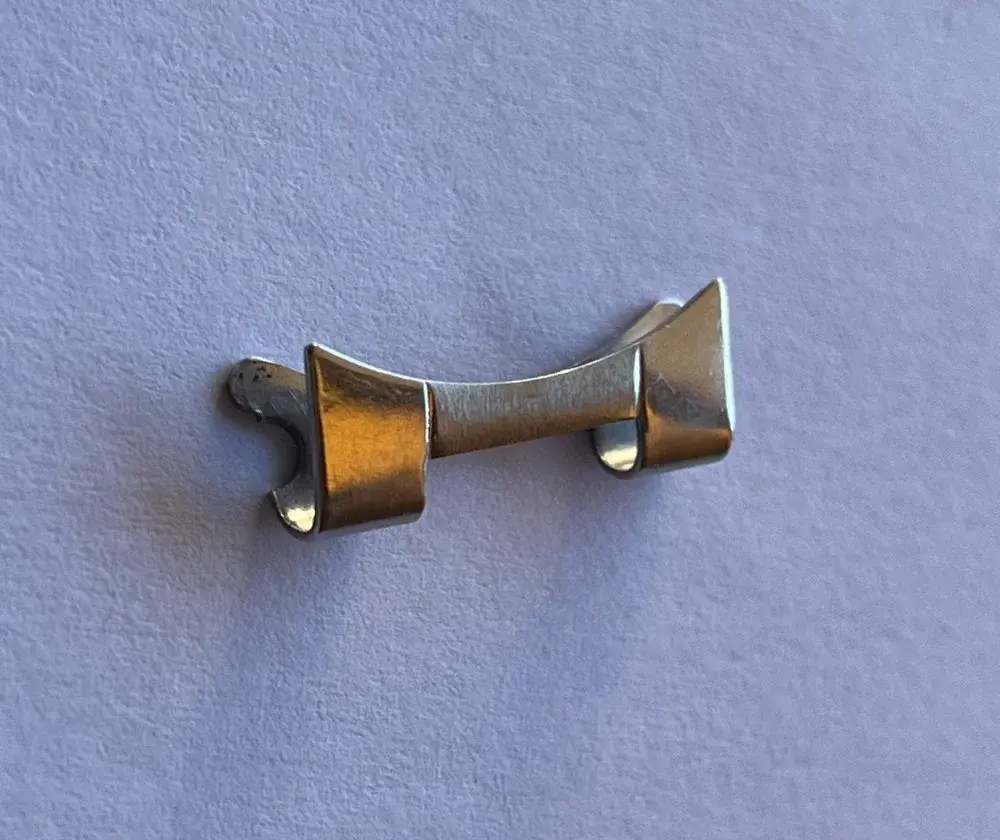

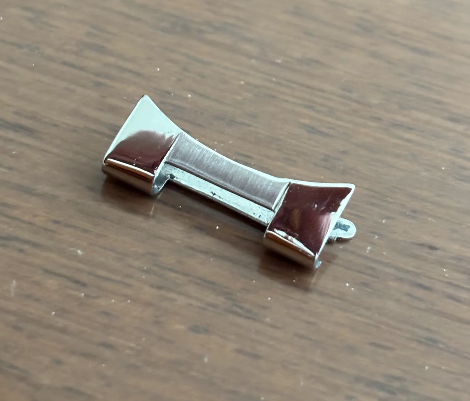

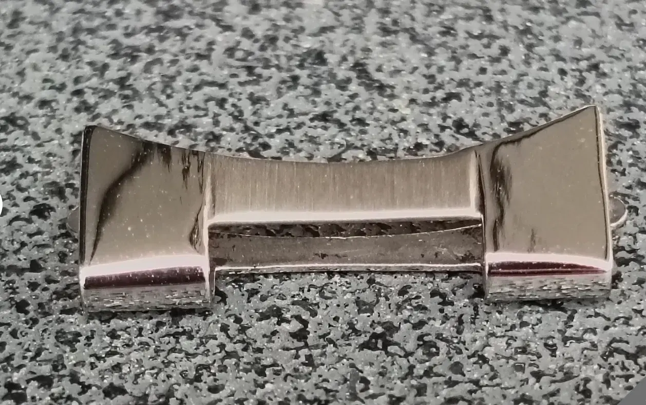

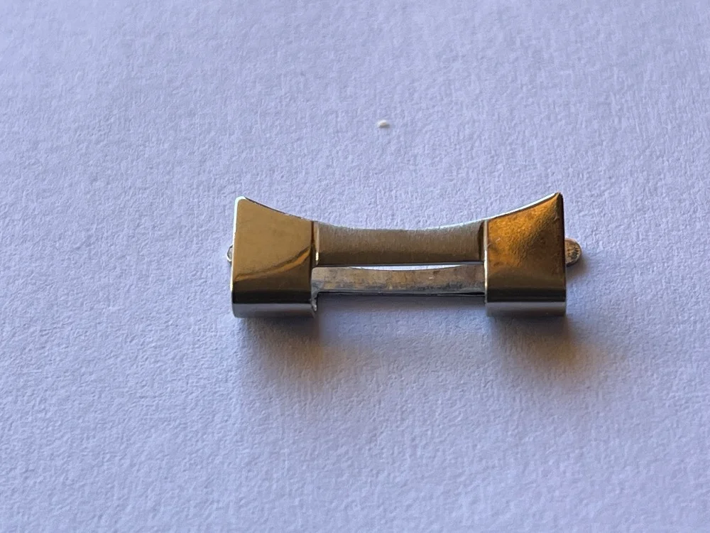

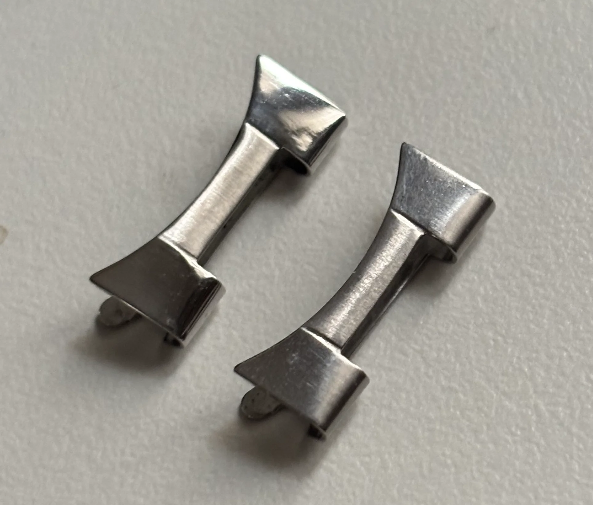

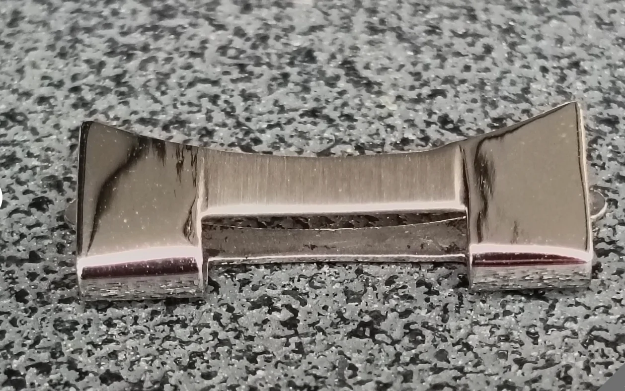

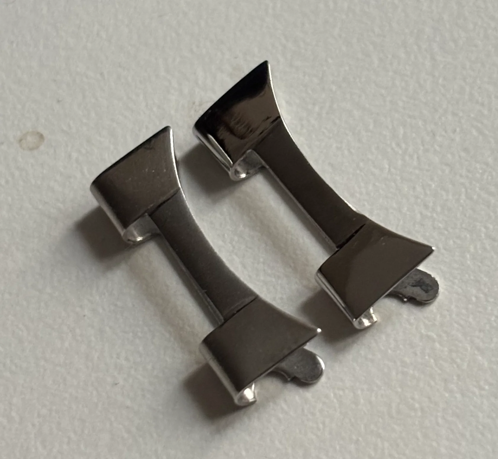

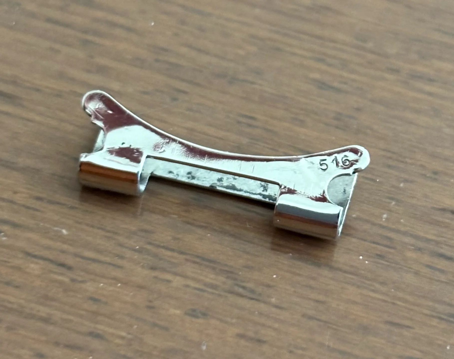

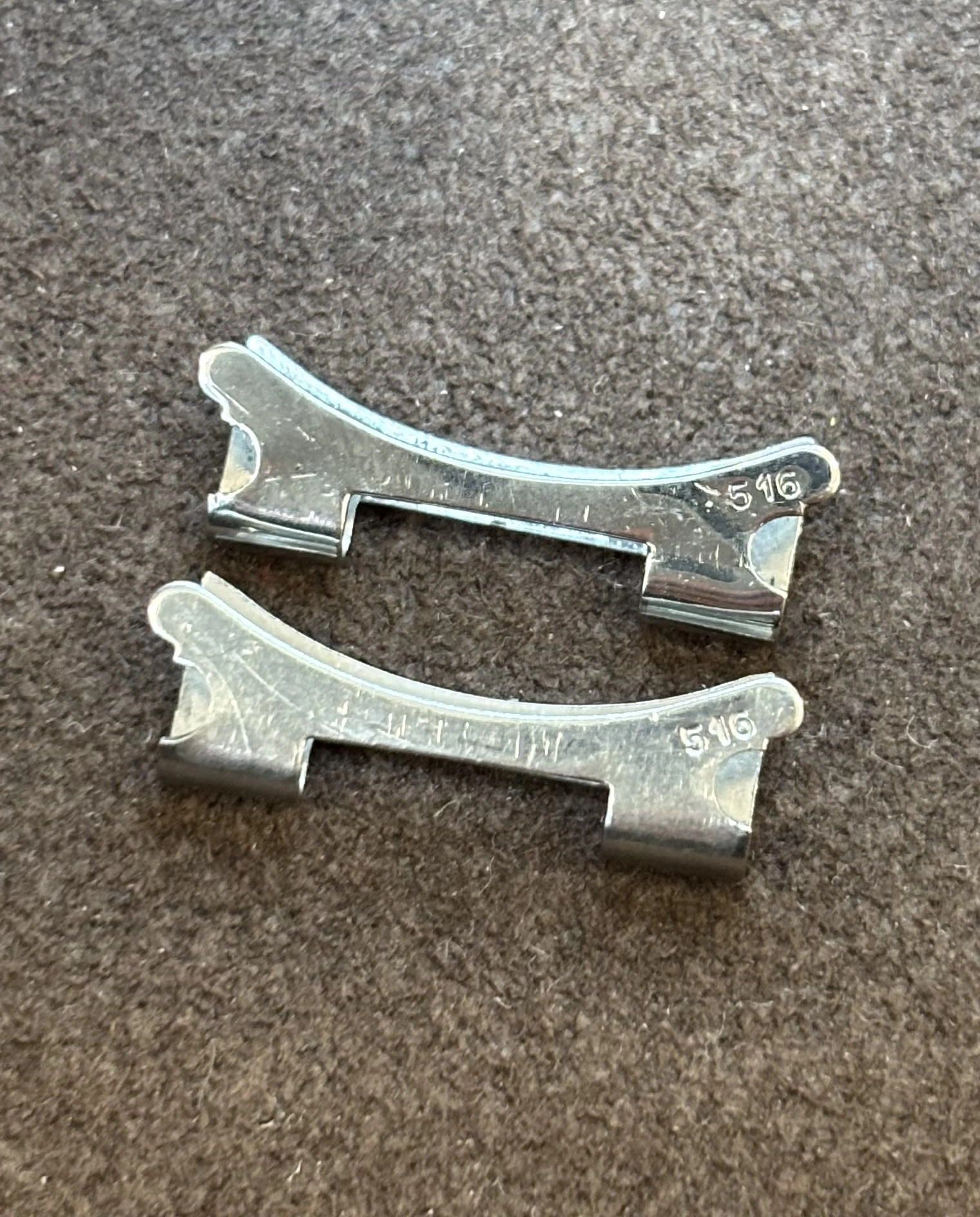

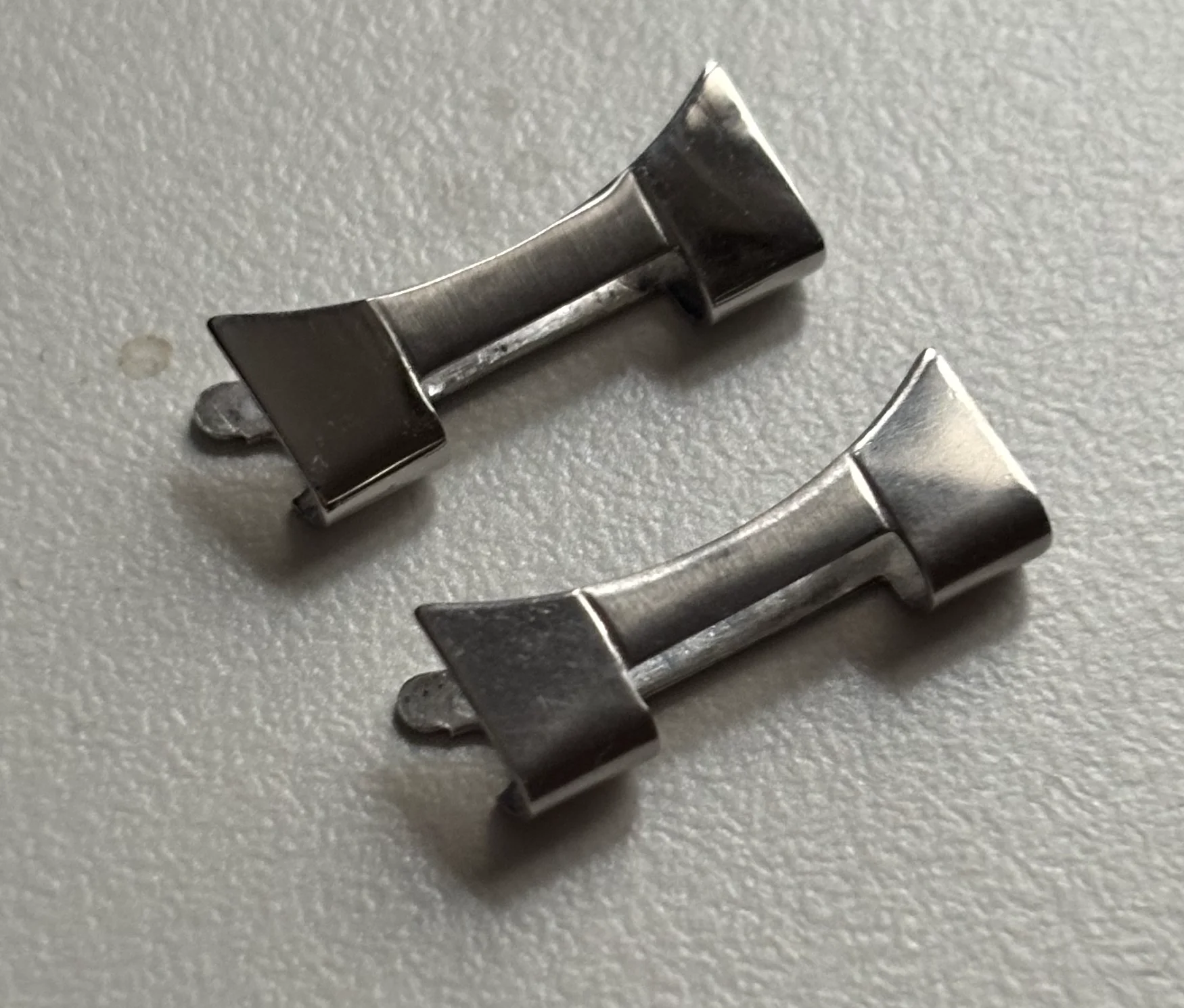

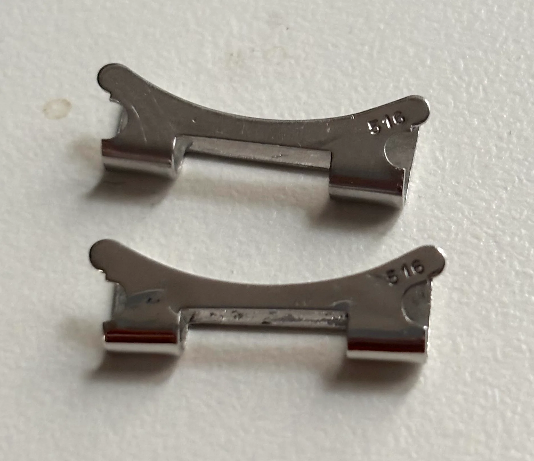

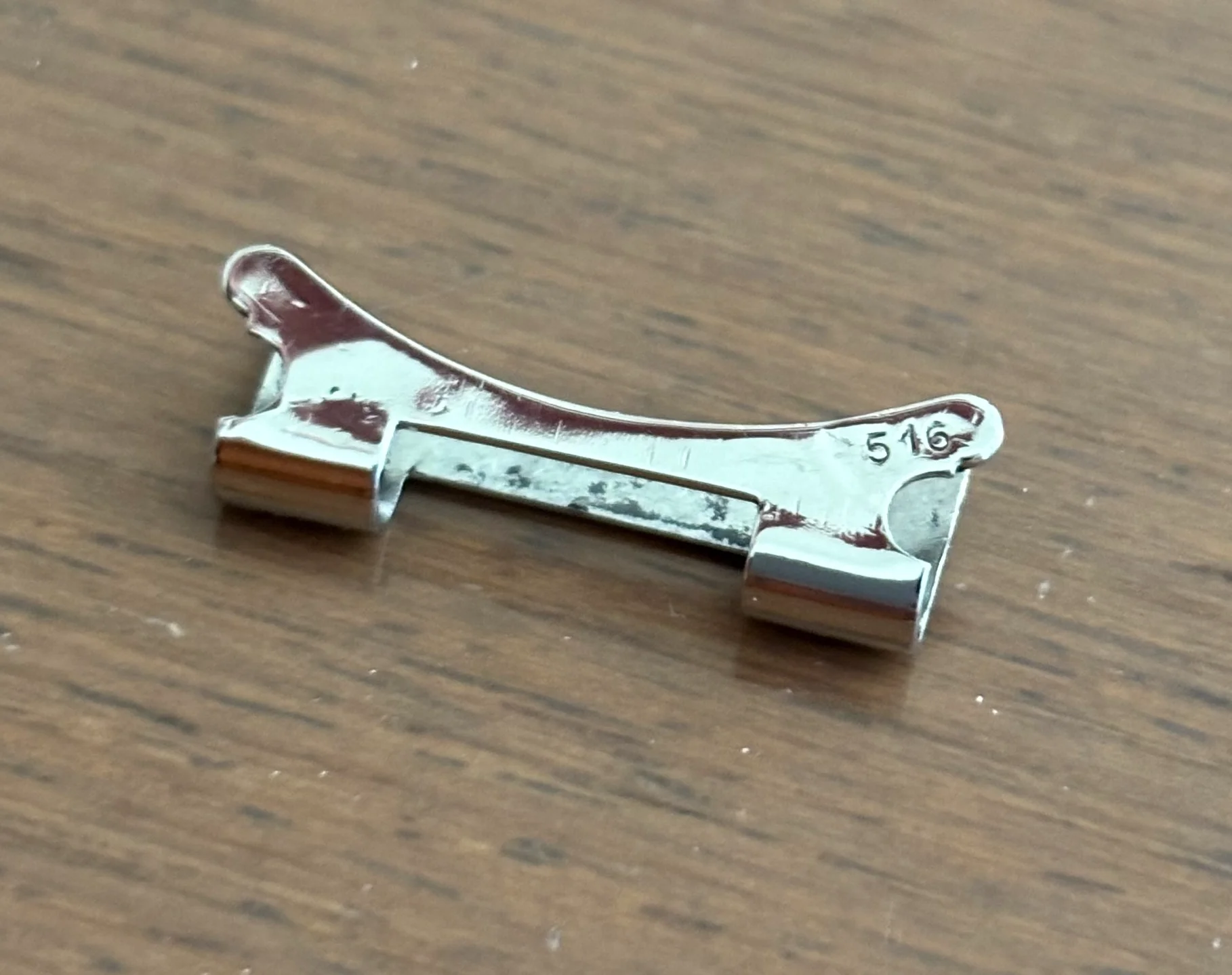

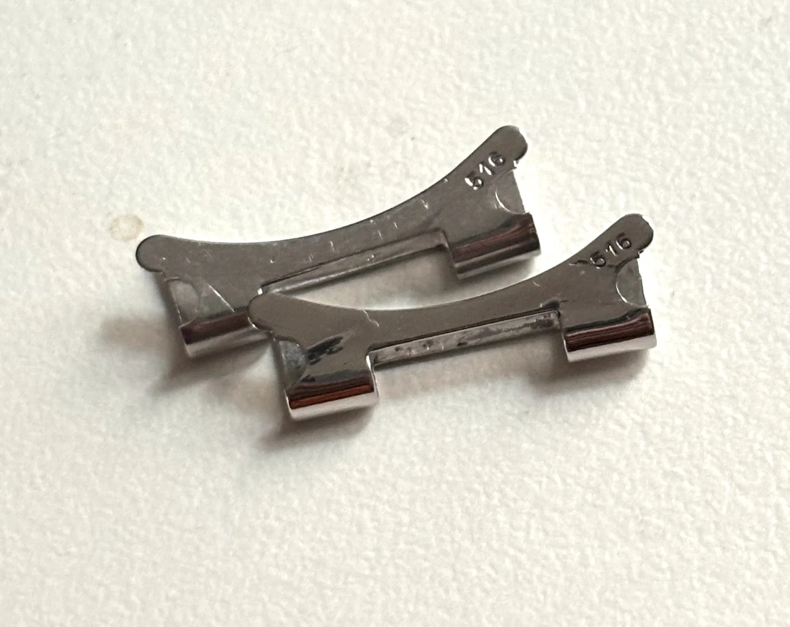

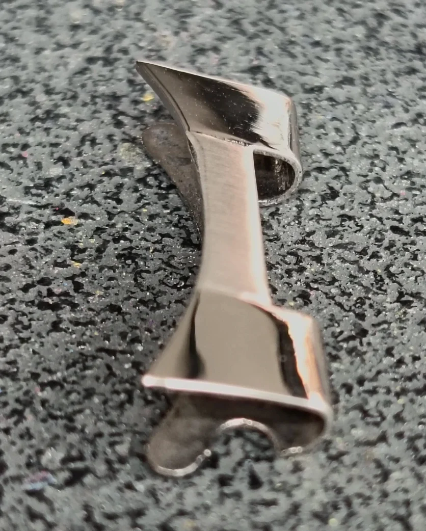

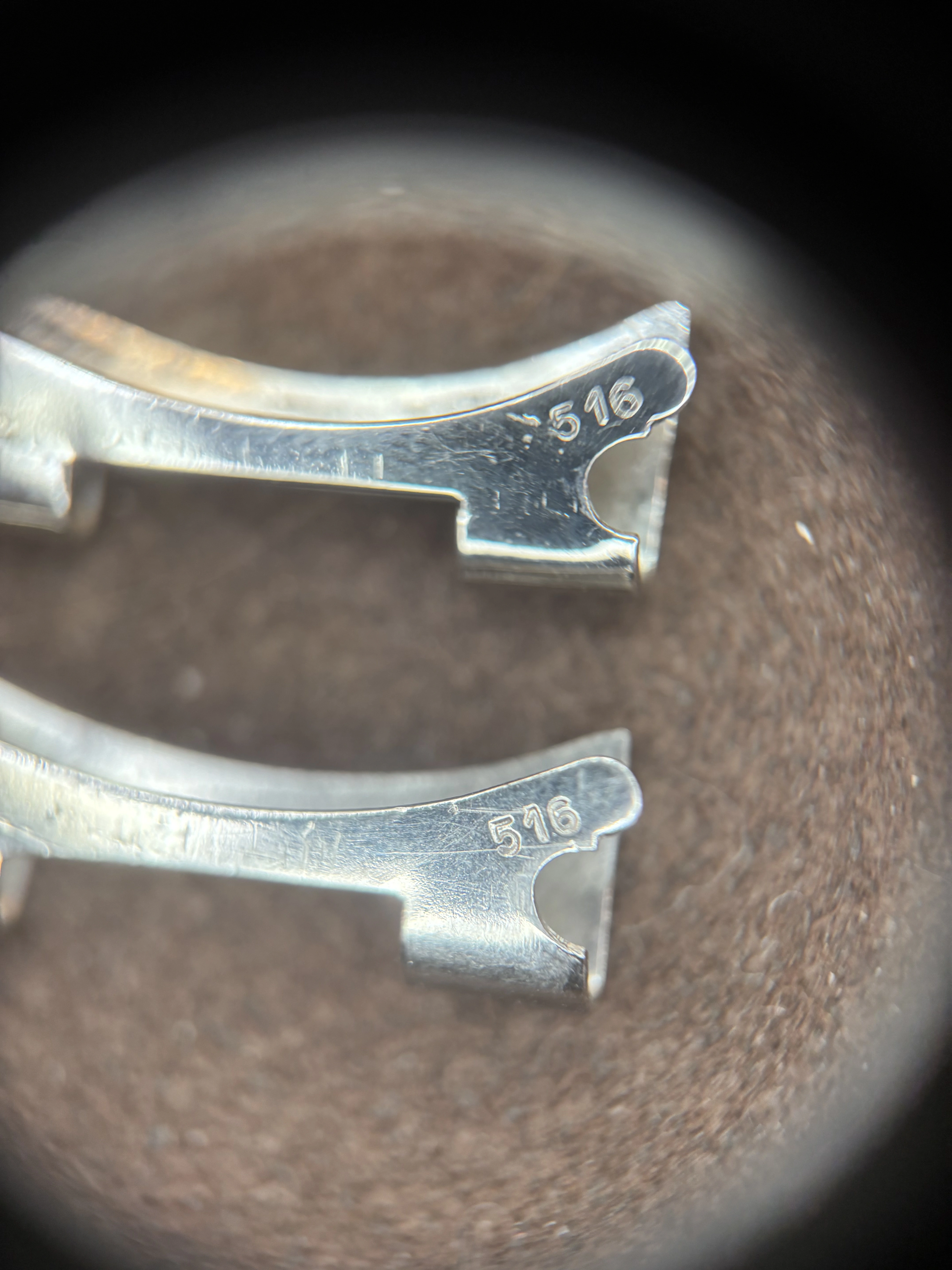

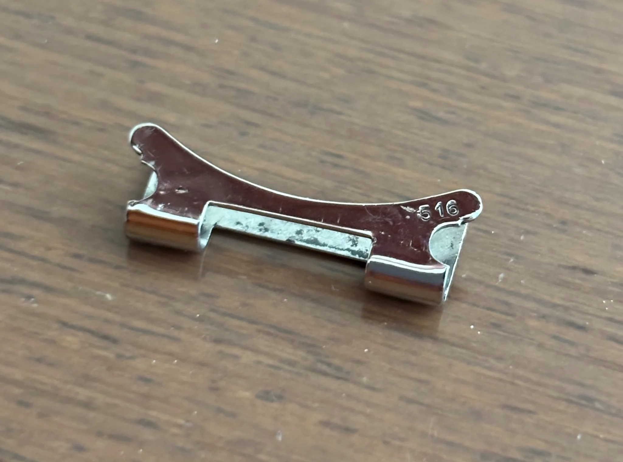

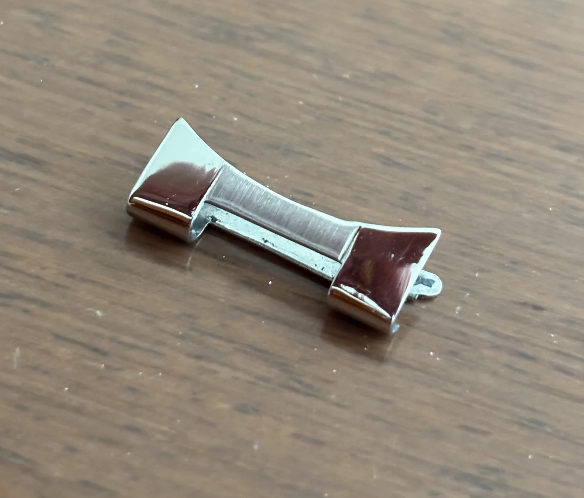

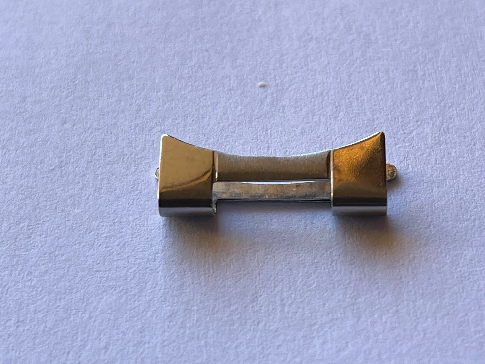

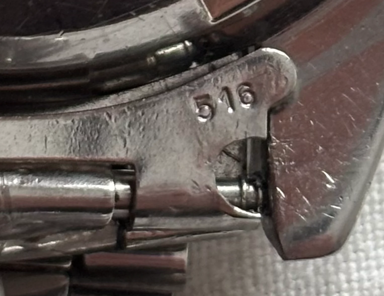

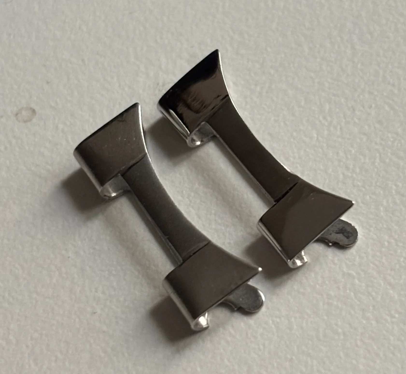

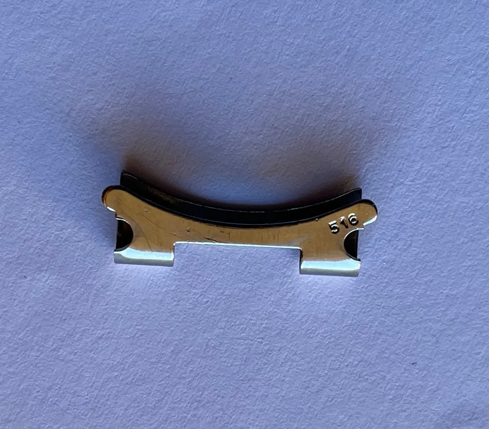

Posts 133 Likes 500 puntodvista ·Mar 16, 2026 Hello, I have a 516 (first picture) and am looking for the second one. I received two offers, displayed in the other pictures. I'm worried because the shape is completely different. Also, the fonts of the numbers are different. Are they legit?
Posts 1,588 Likes 6,838 Aludic ·Mar 16, 2026·@SpeedyBirthYear M'Bob Leaning towards legit. Nothing jumping out at me. Same. Looks okay to me.
Posts 133 Likes 500 puntodvista ·Mar 16, 2026 Ron_W Nr 3 is okay for me, i am not sure on nr 2. Interesting. I just bought it on eBay, I will post more accurate pictures when it arrives.

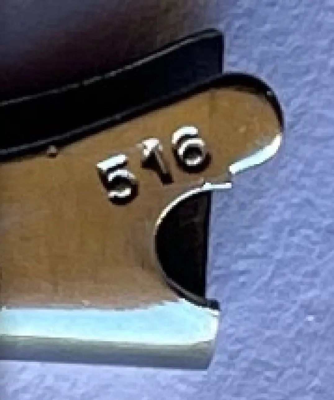

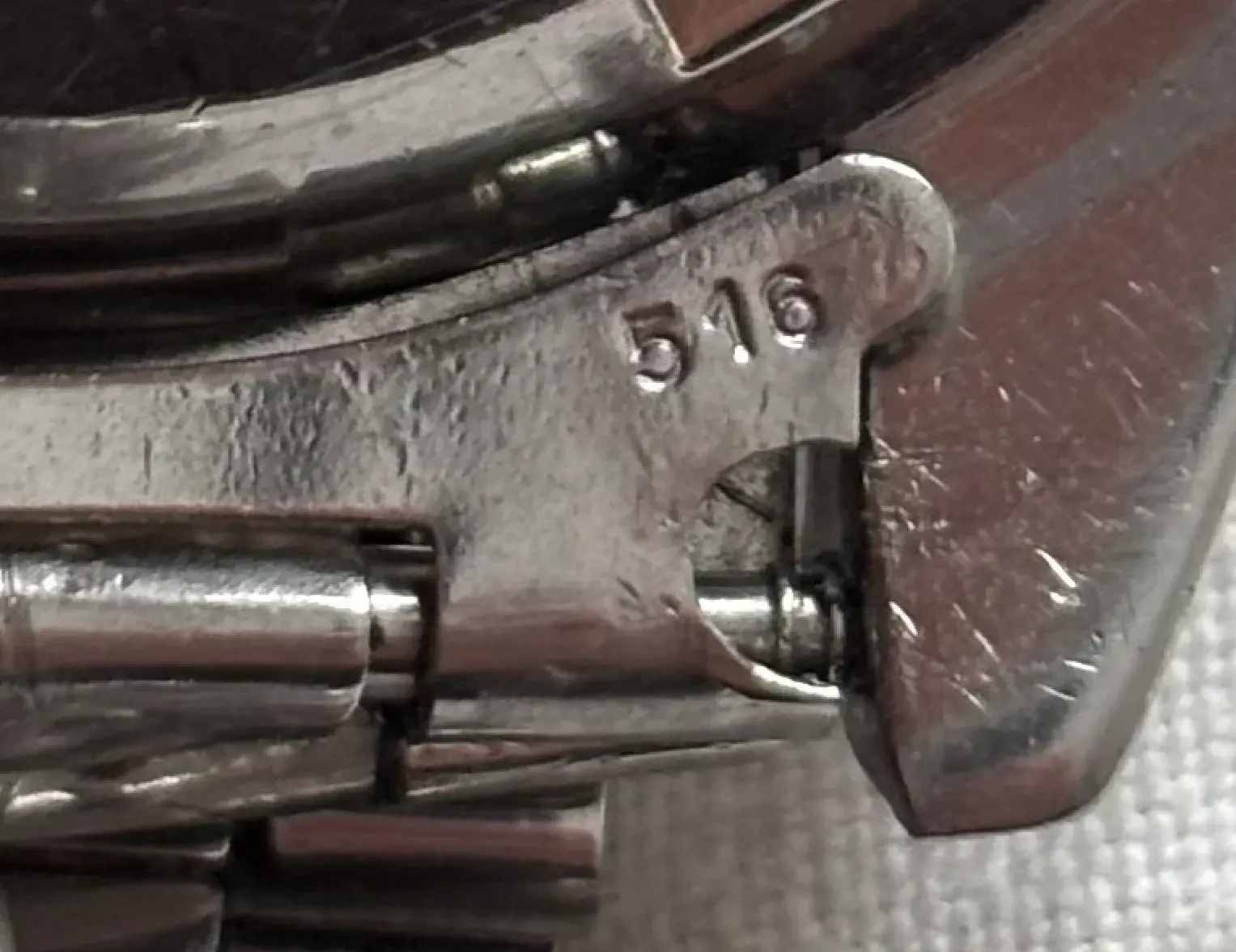

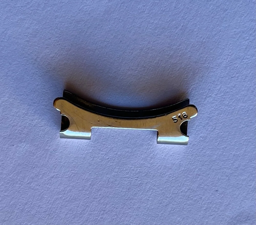

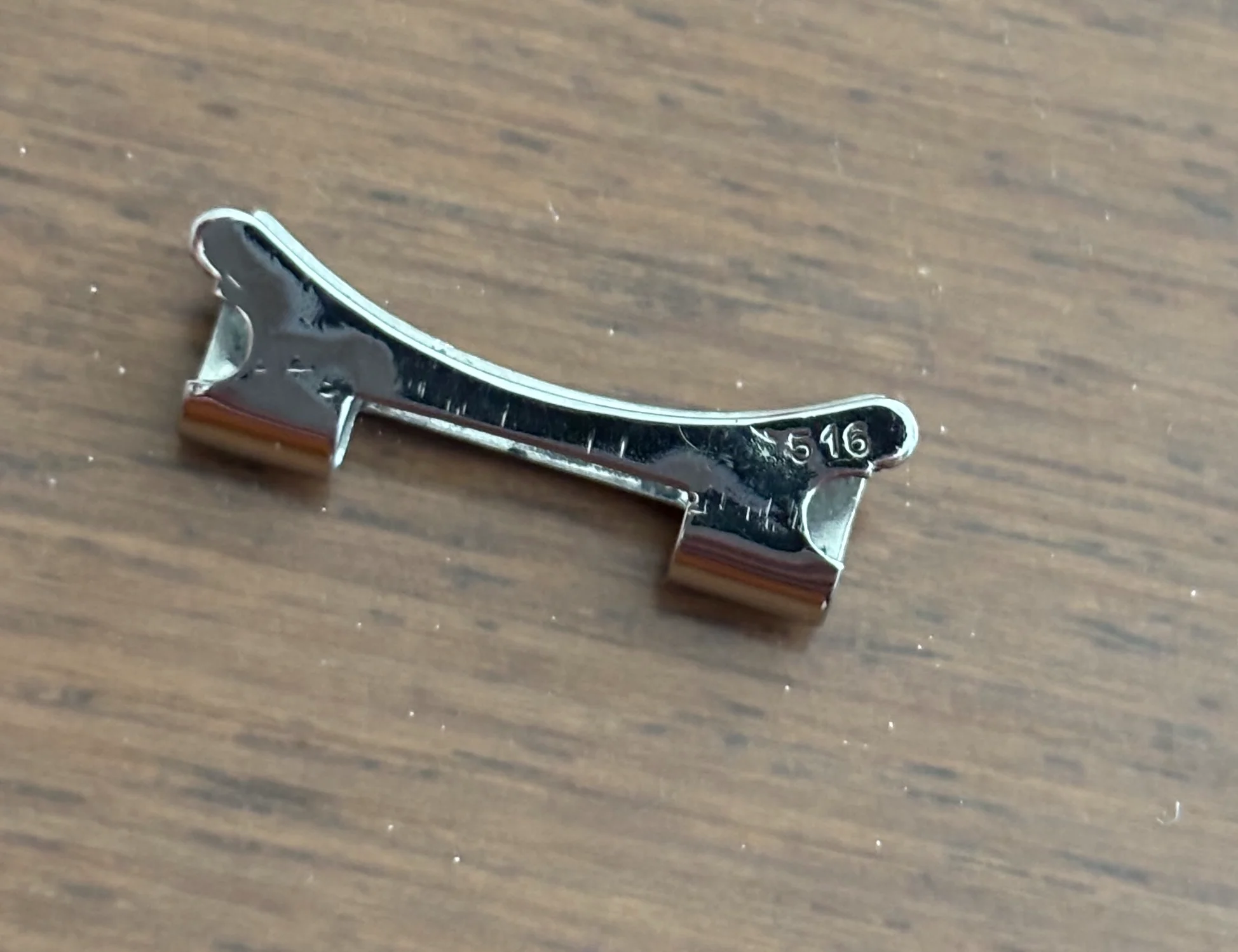

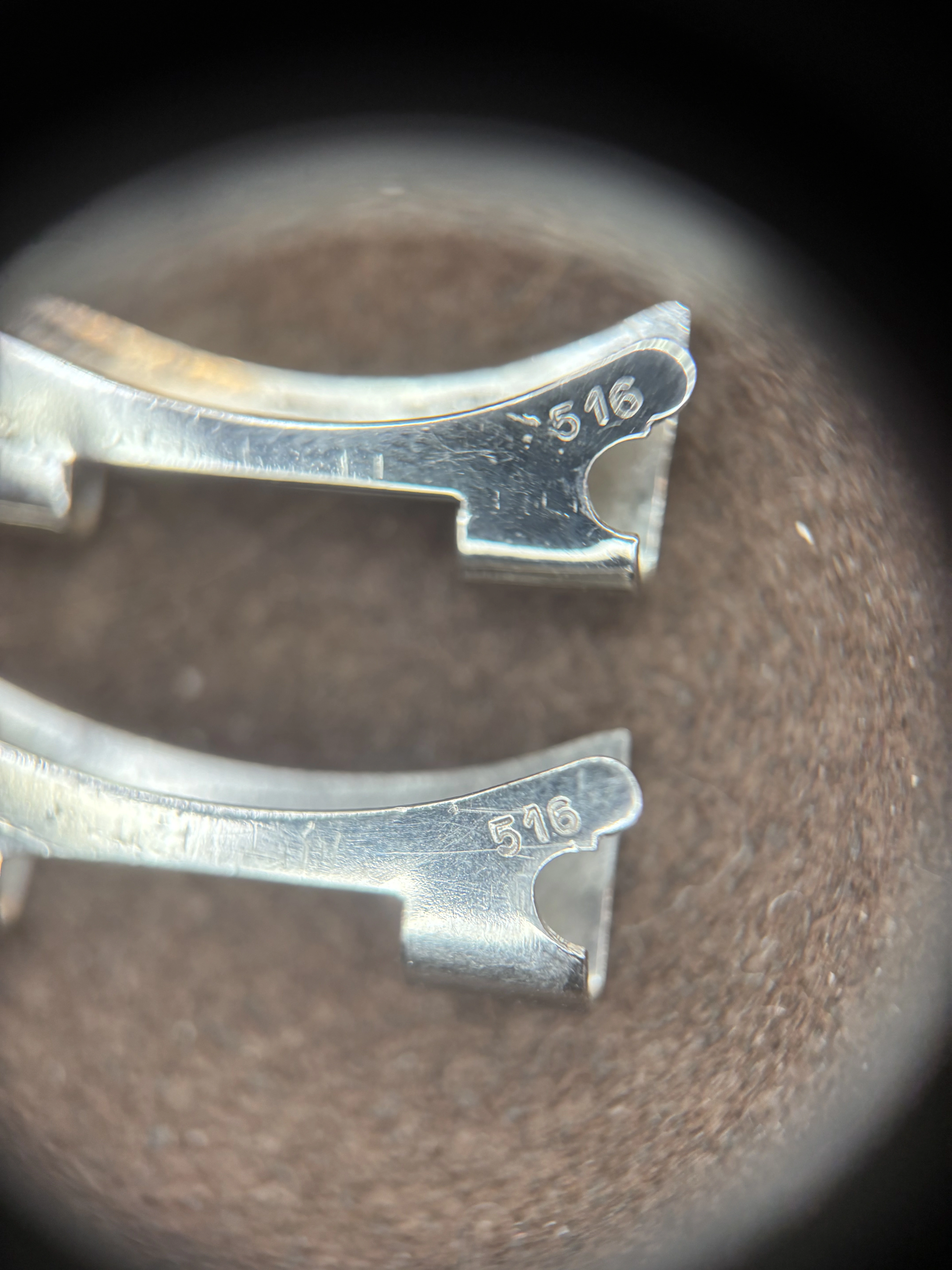

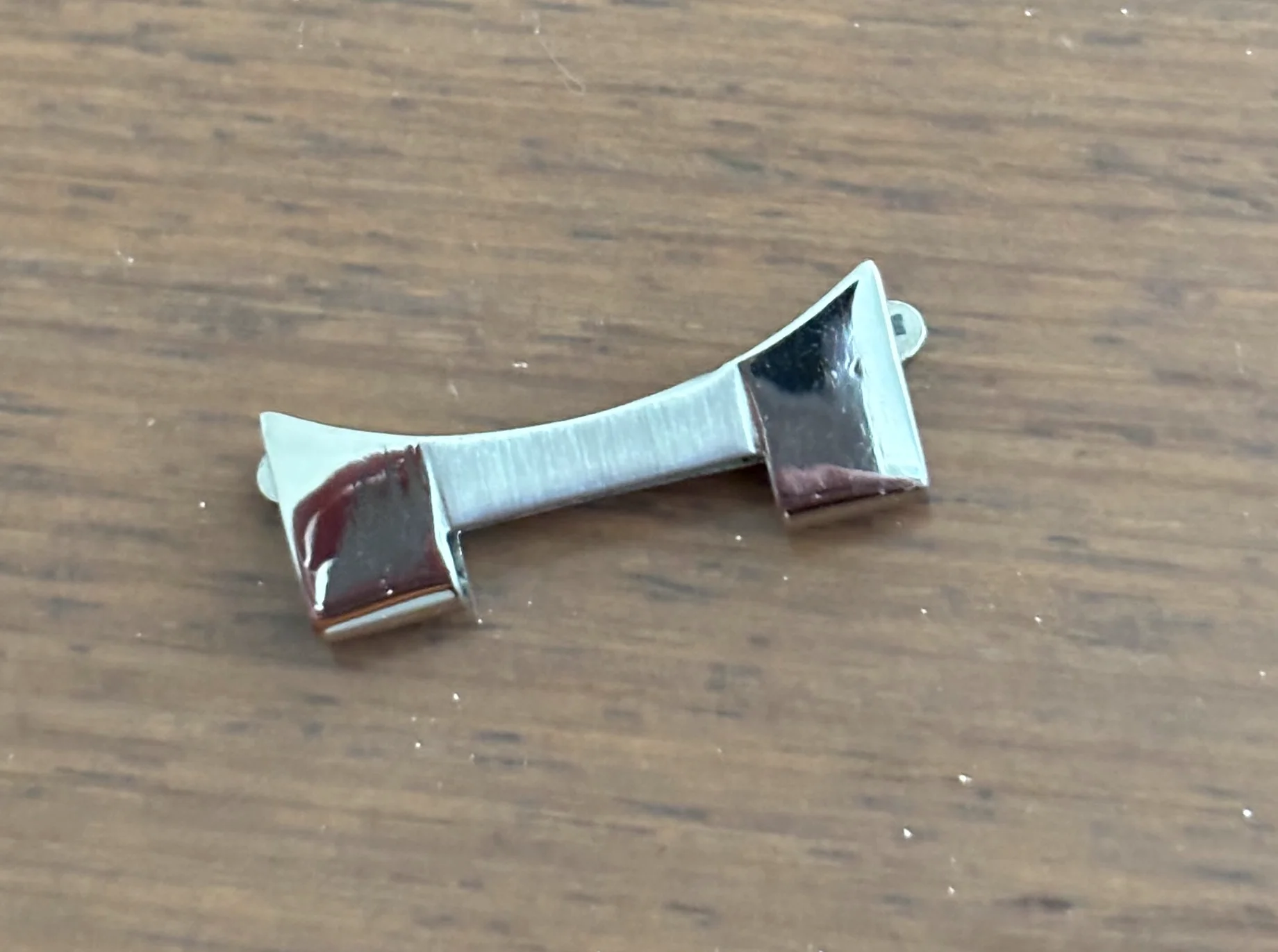

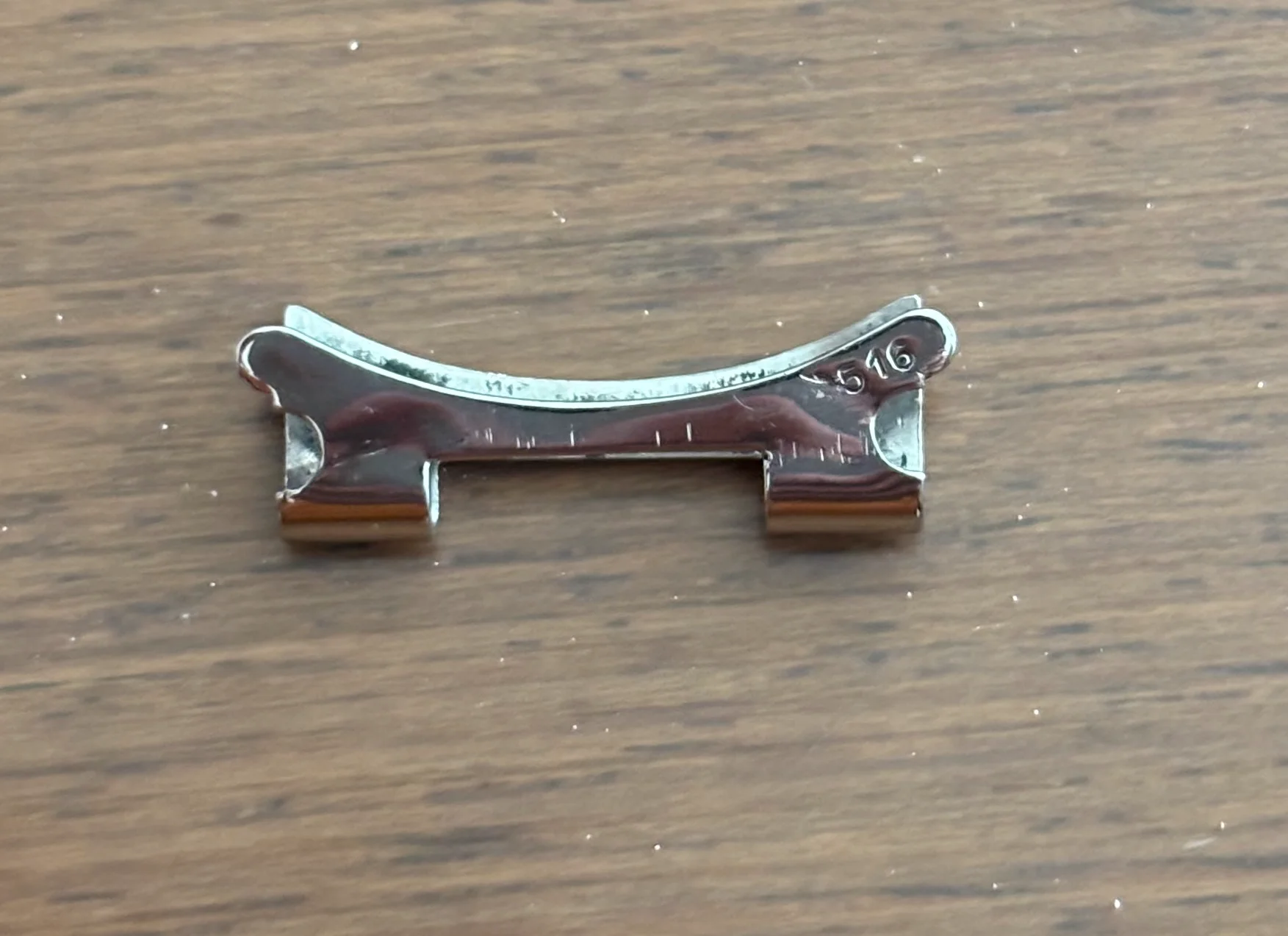

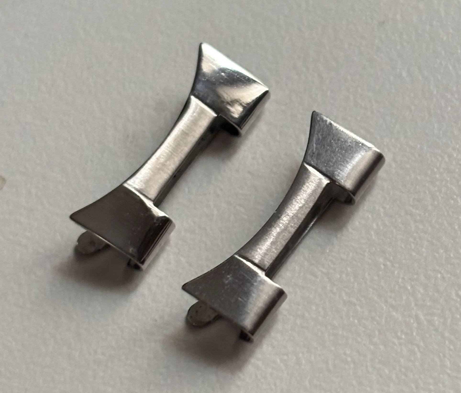

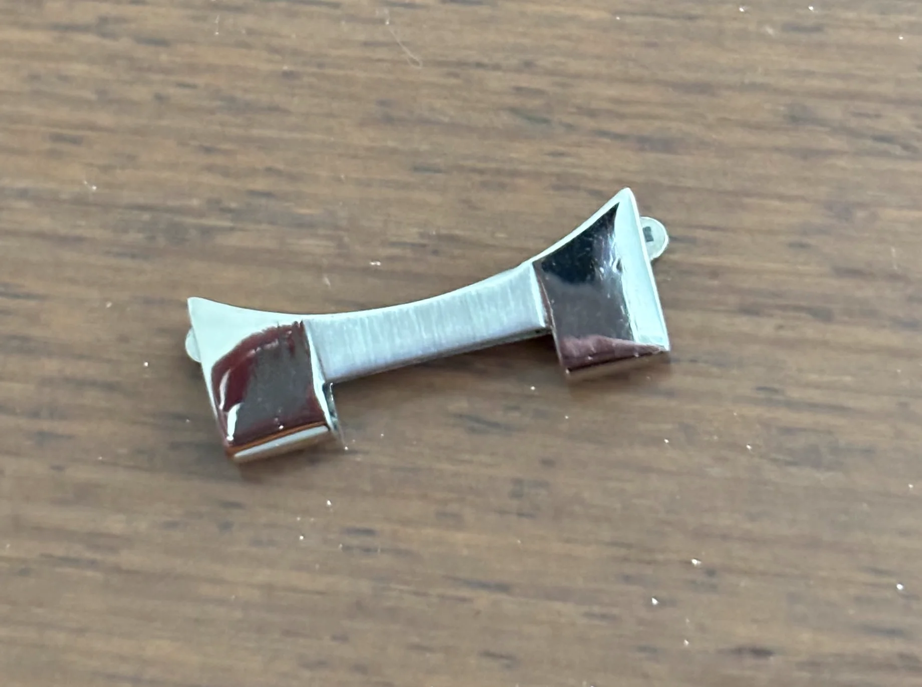

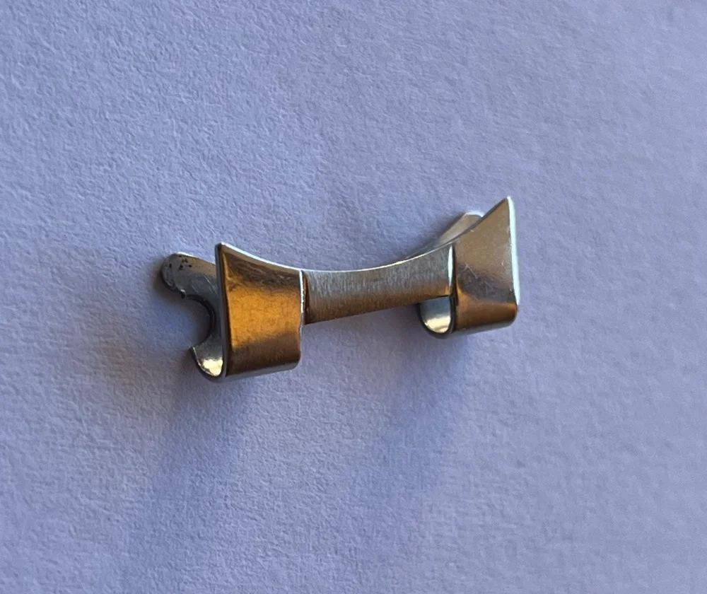

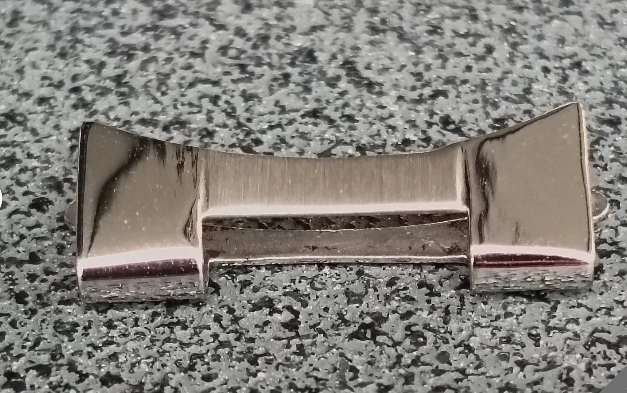

Posts 133 Likes 500 puntodvista ·Mar 19, 2026 Here we are. I got it today. It seems legit to me. What you think?

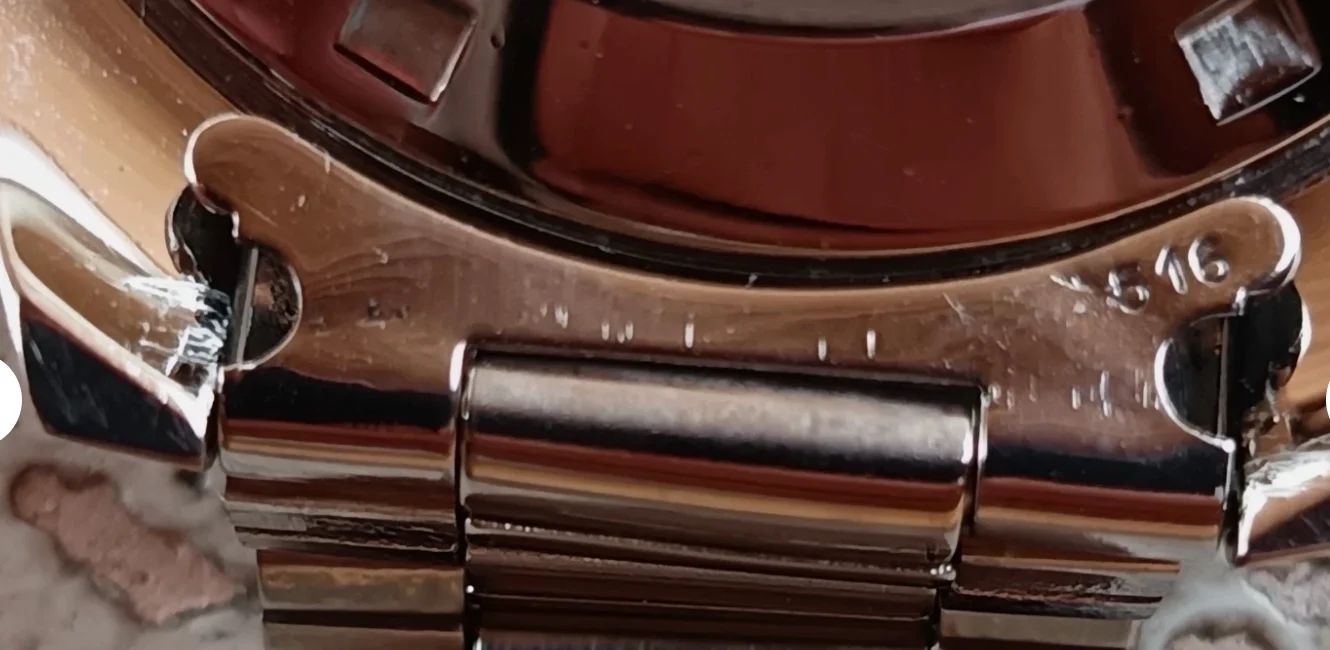

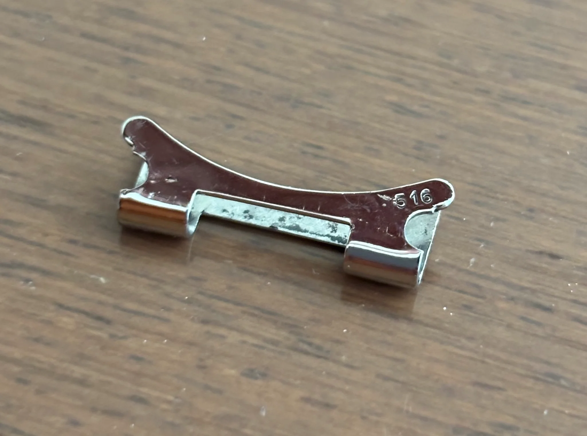

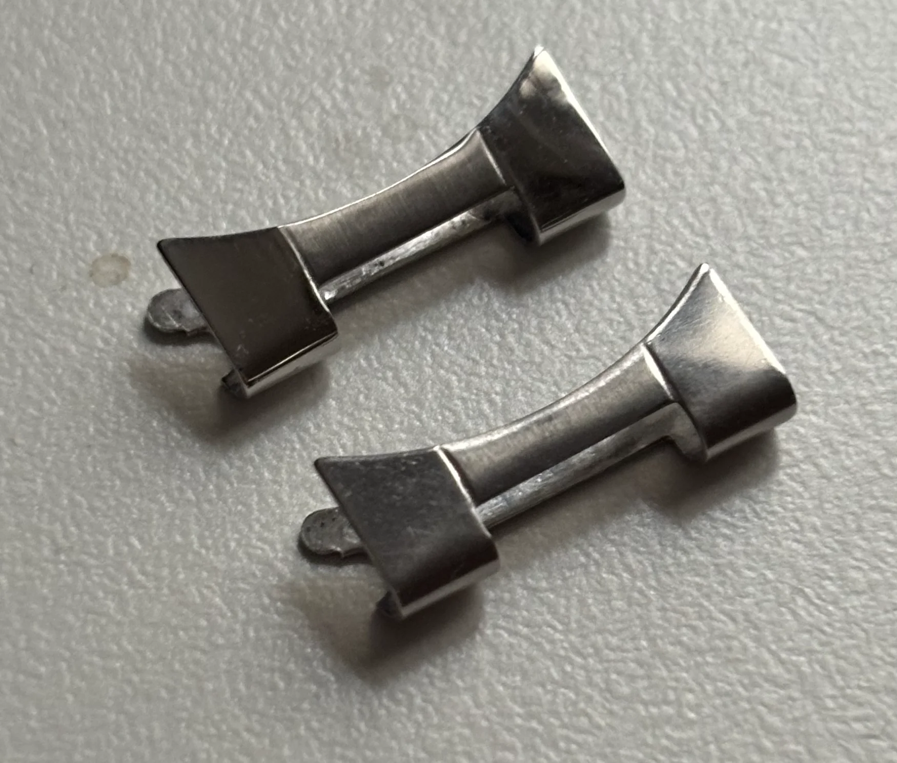

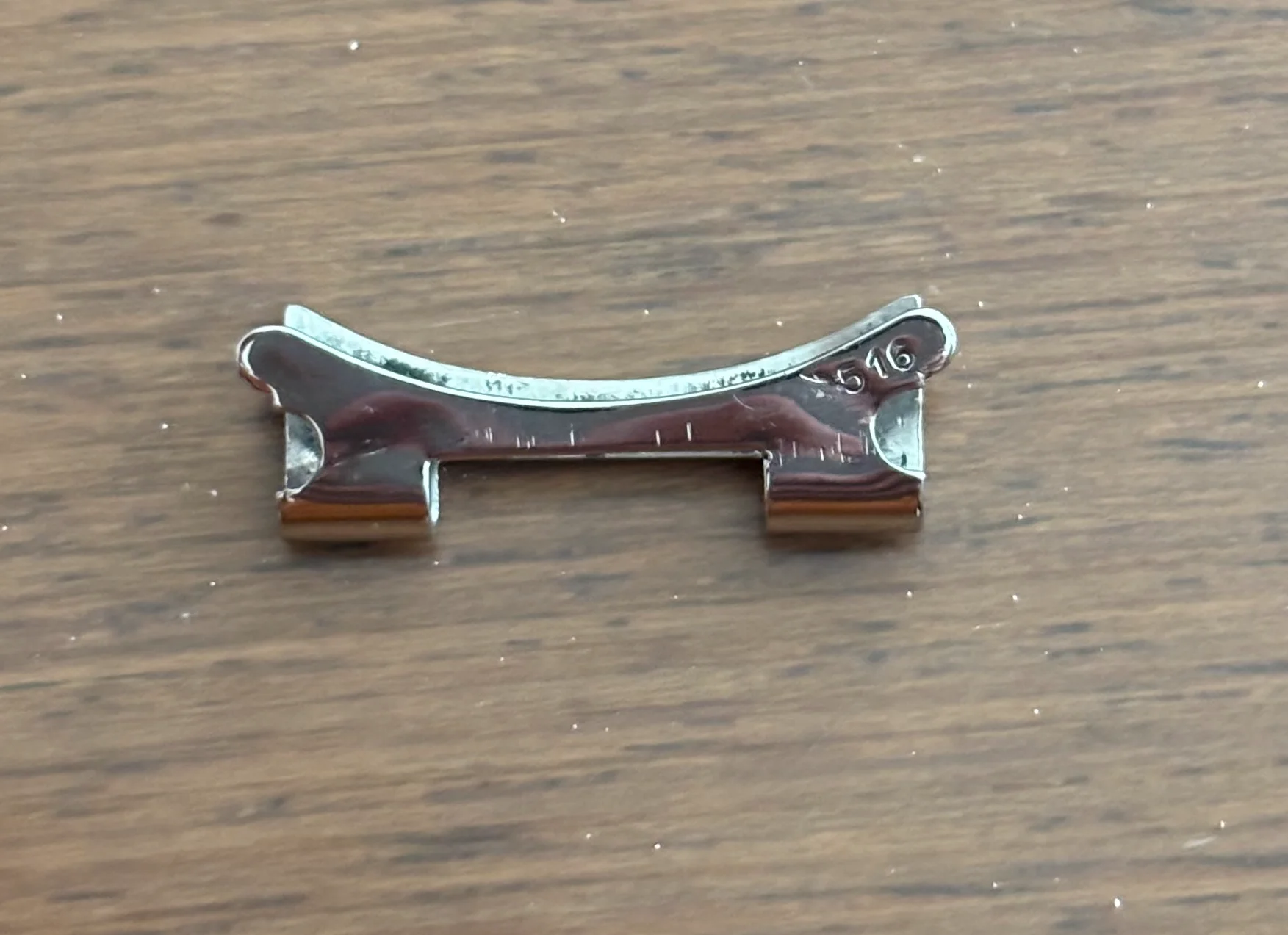

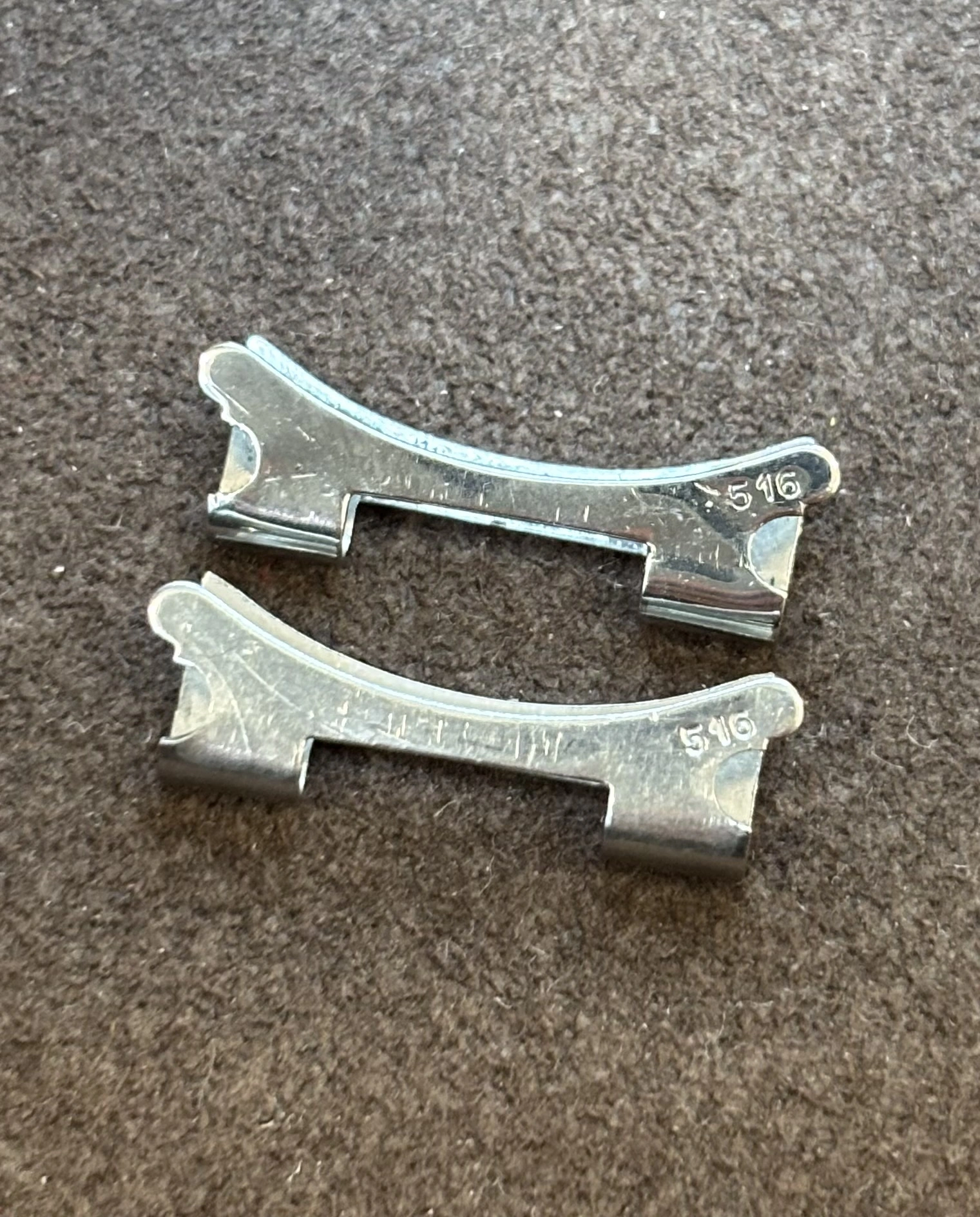

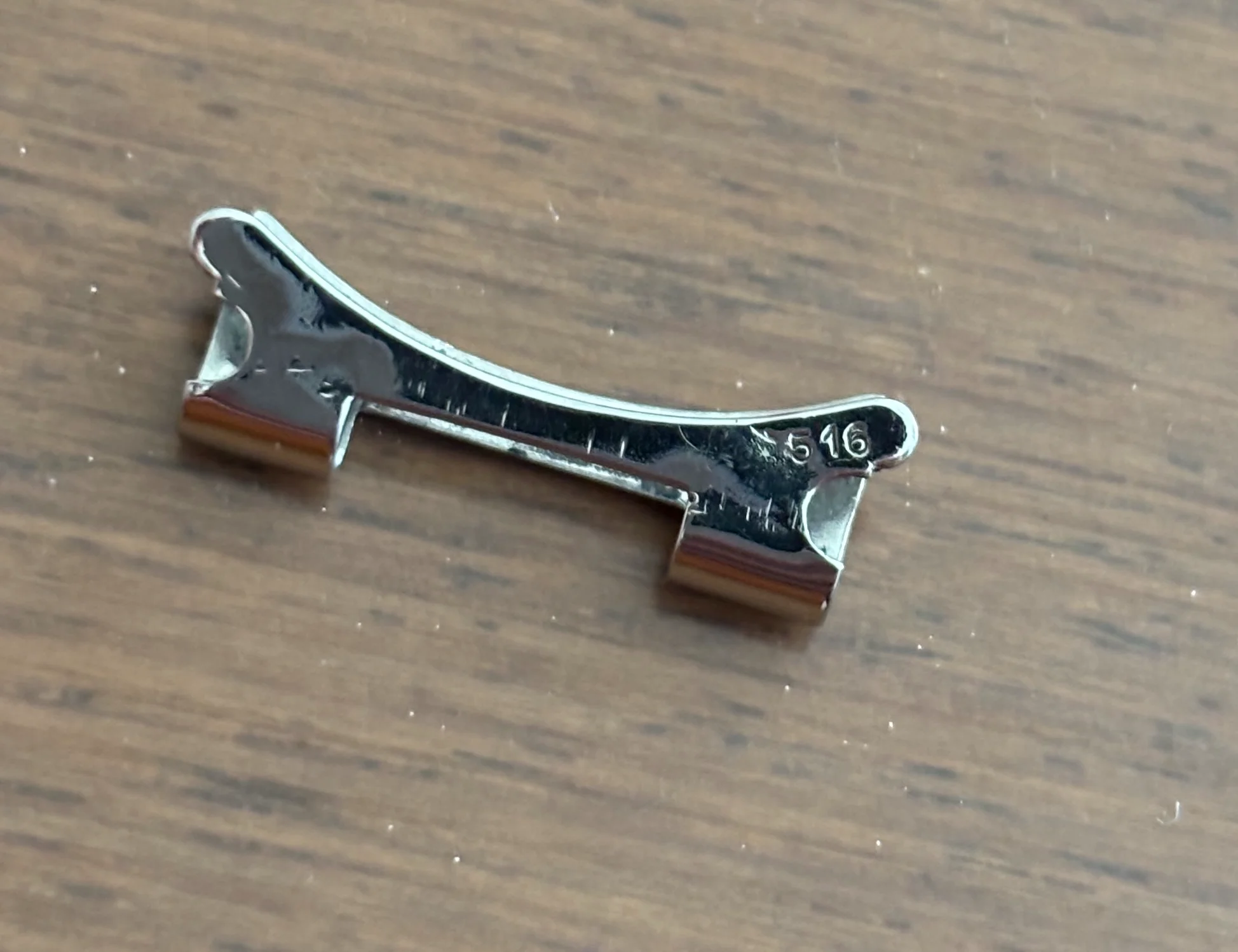

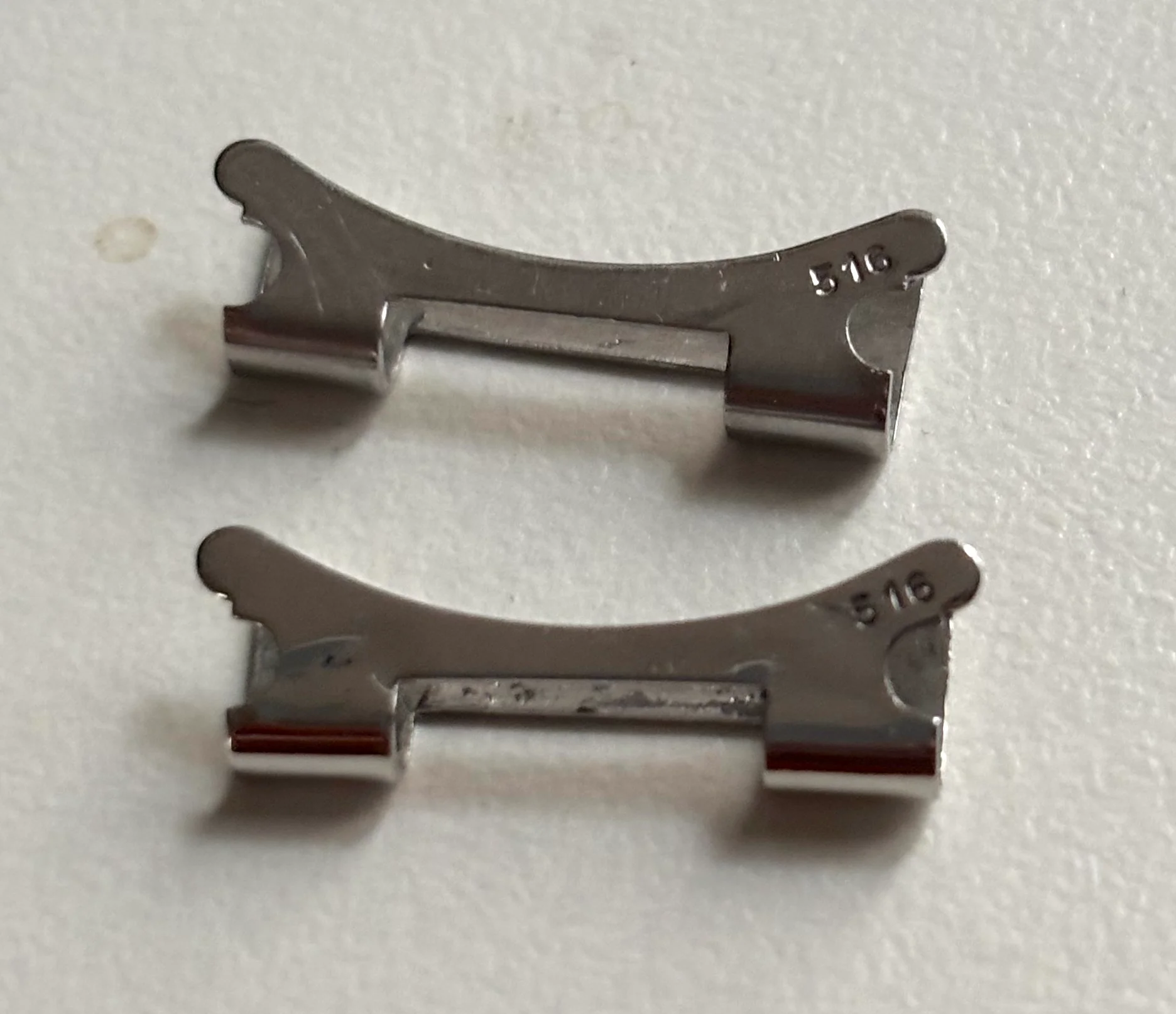

Posts 133 Likes 500 puntodvista ·Mar 19, 2026 My watchmaker says #2 is good (top) but #3 looks no good at all (bottom).

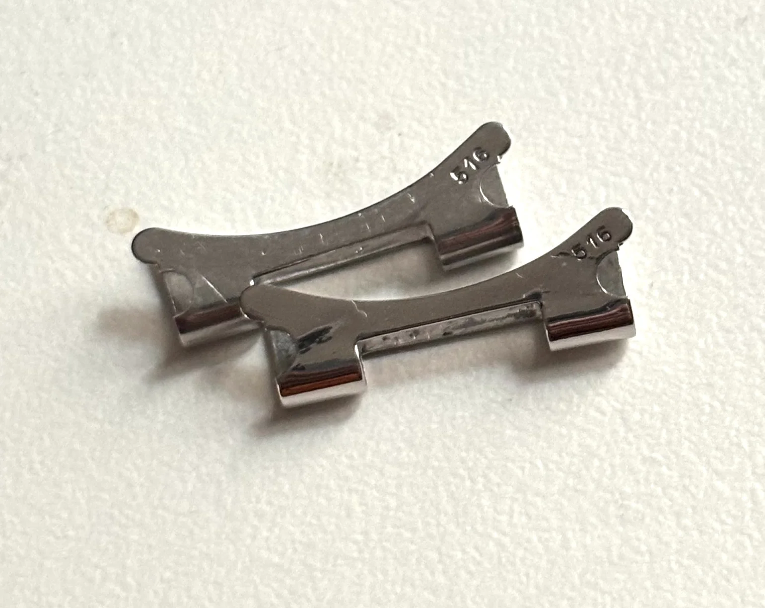

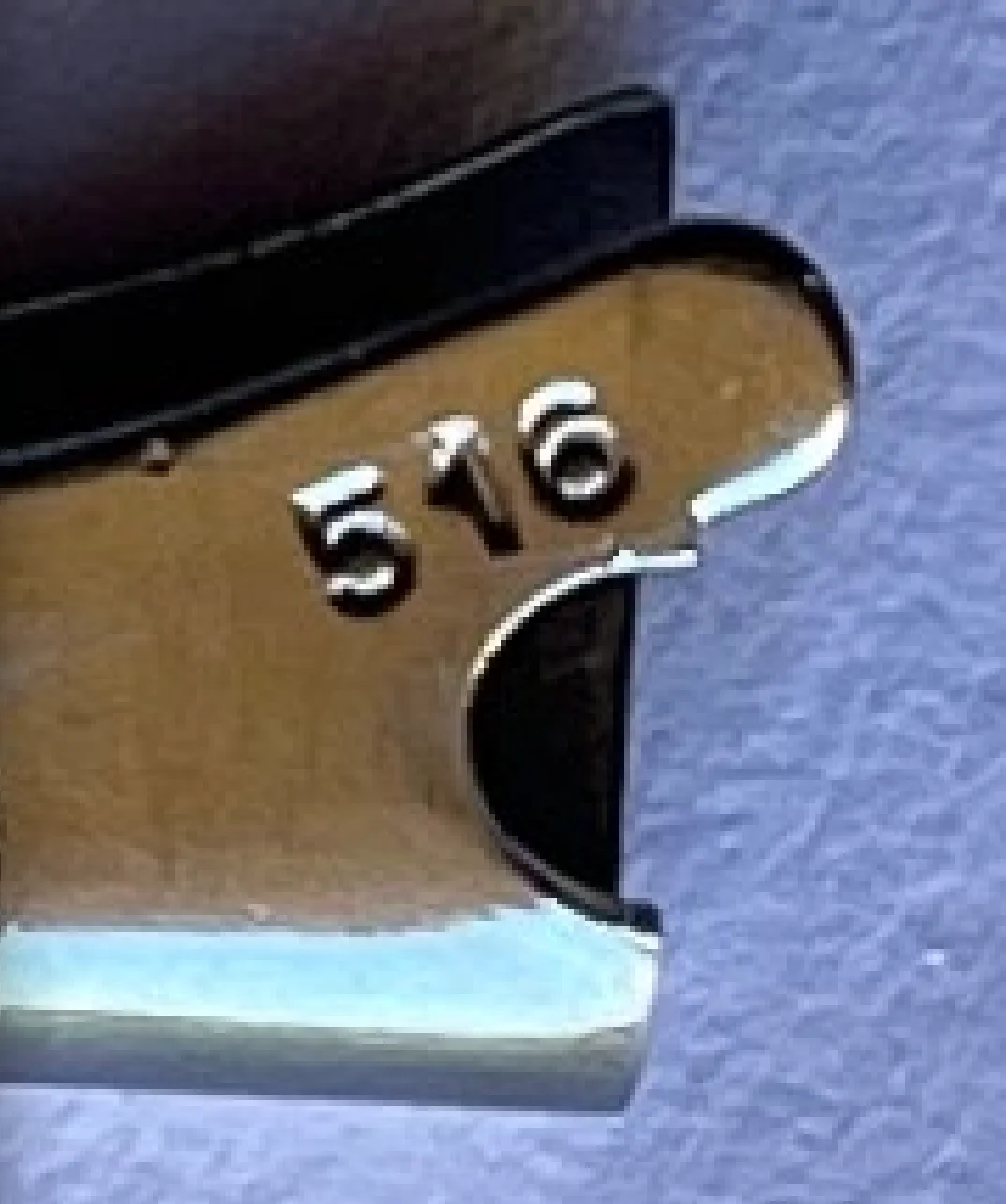

Posts 133 Likes 500 puntodvista ·Mar 19, 2026 Another pic. #2 top, #3 bottom. Pay attention to the distance between numbers and borders. It’s completely different.
Posts 41 Likes 56 Raf006 ·Mar 19, 2026 I guess moonwatch only book could provide reliable informations about it !

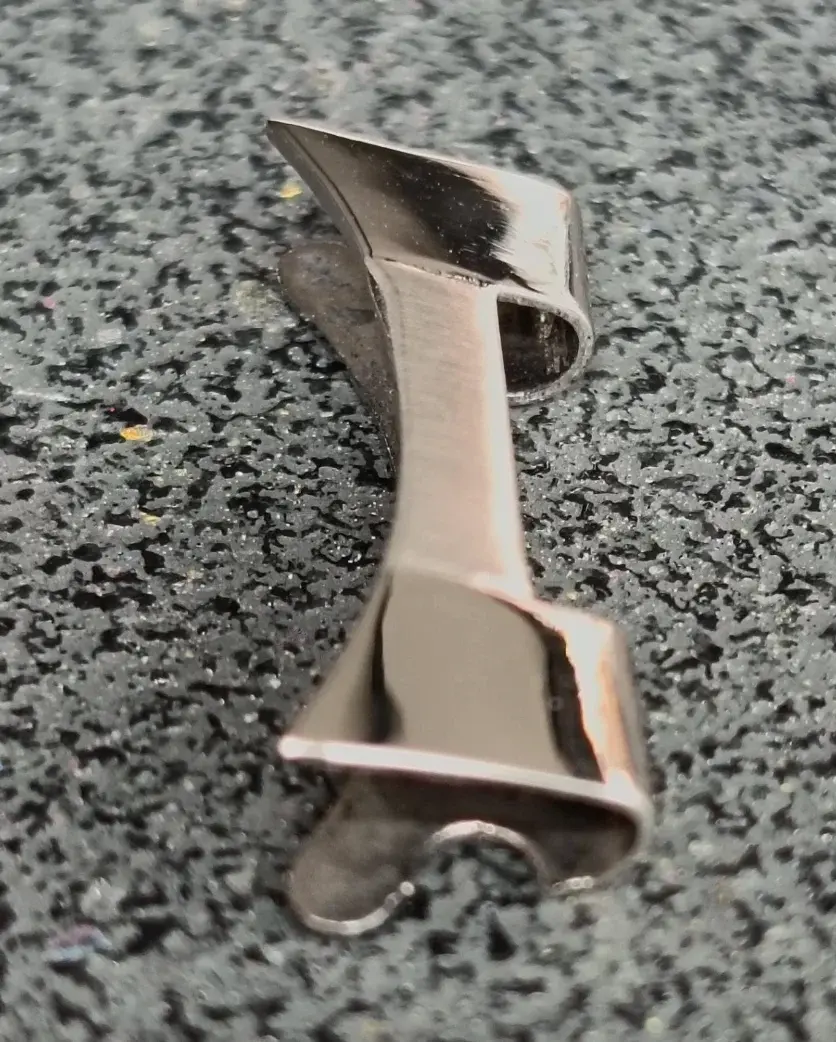

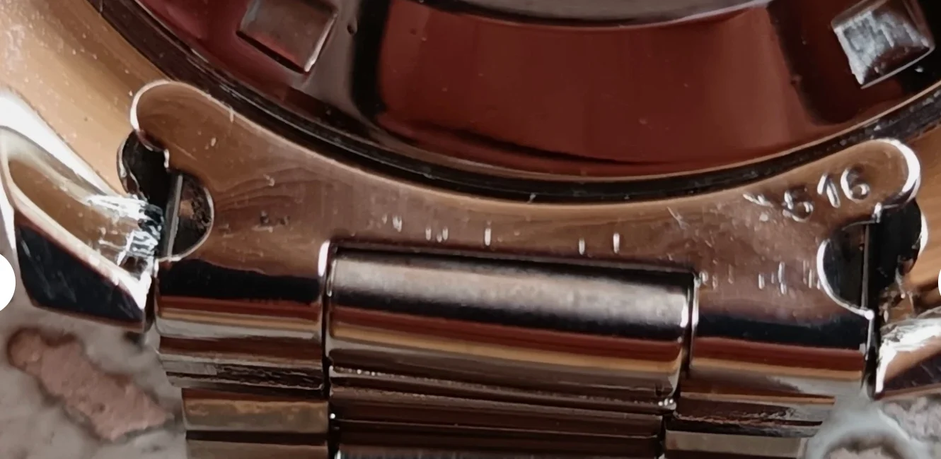

Posts 2,003 Likes 3,901 Ron_W ·Mar 19, 2026 I think you are okay, production diffferences not uncommon in those days. But compare to these ; https://omegaforums.net/threads/omega-516-end-link-stamp-information.170034/ Thread 'Omega 516 end link stamp information' · Hi everyone, I have these 2 1039/516 bracelets and just noticing the difference in the 516 stamp on the endlinks. Is this typical? I would expect maybe some variation from 1967 to 1972 and have... EdtheAussie · Mar 6, 2024 and the ones listed for sale in the parts section here on OF
Posts 133 Likes 500 puntodvista ·Mar 19, 2026 Raf006 I guess moonwatch only book could provide reliable informations about it ! The ones depicted in that book (only one pic, and rather small) look also different. The production is very varied.
Posts 133 Likes 500 puntodvista ·Mar 25, 2026 I asked several people who are more expert than me. There is a general agreement that both end links are legit. I therefore decided to keep them.
