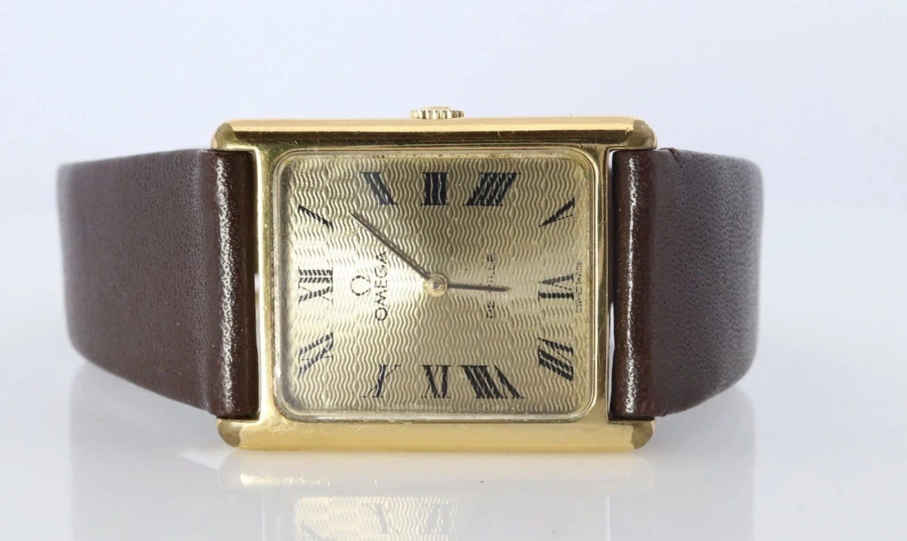

Can someone tell me if this watch looks correct? Considering buying for my girlfriend but don’t want to buy something that isn’t correct if I’m going to spend $1k
2,671
2,856
I don't see anything wrong with it, Omega 511.0404. $1000 is quite a bit overpriced, last two ebay sales were ~$550 and $800 for one of these in 'near mint' condition.

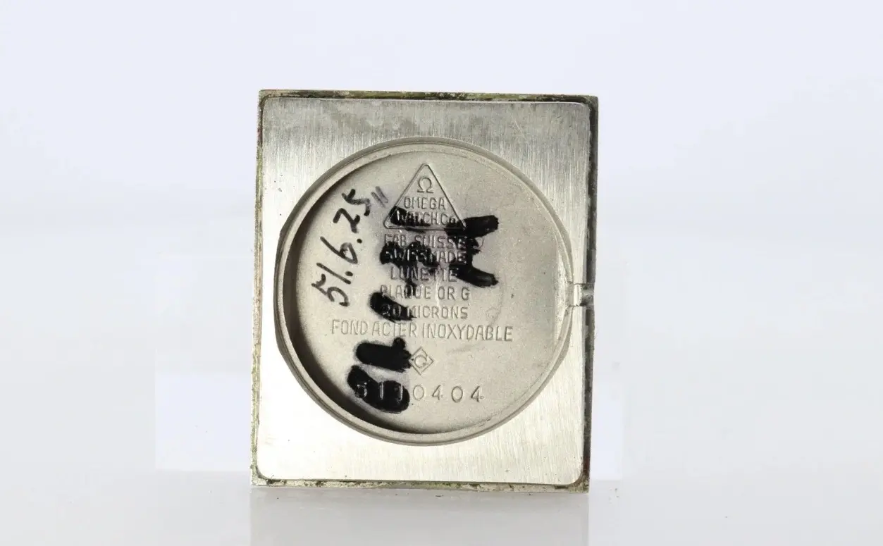

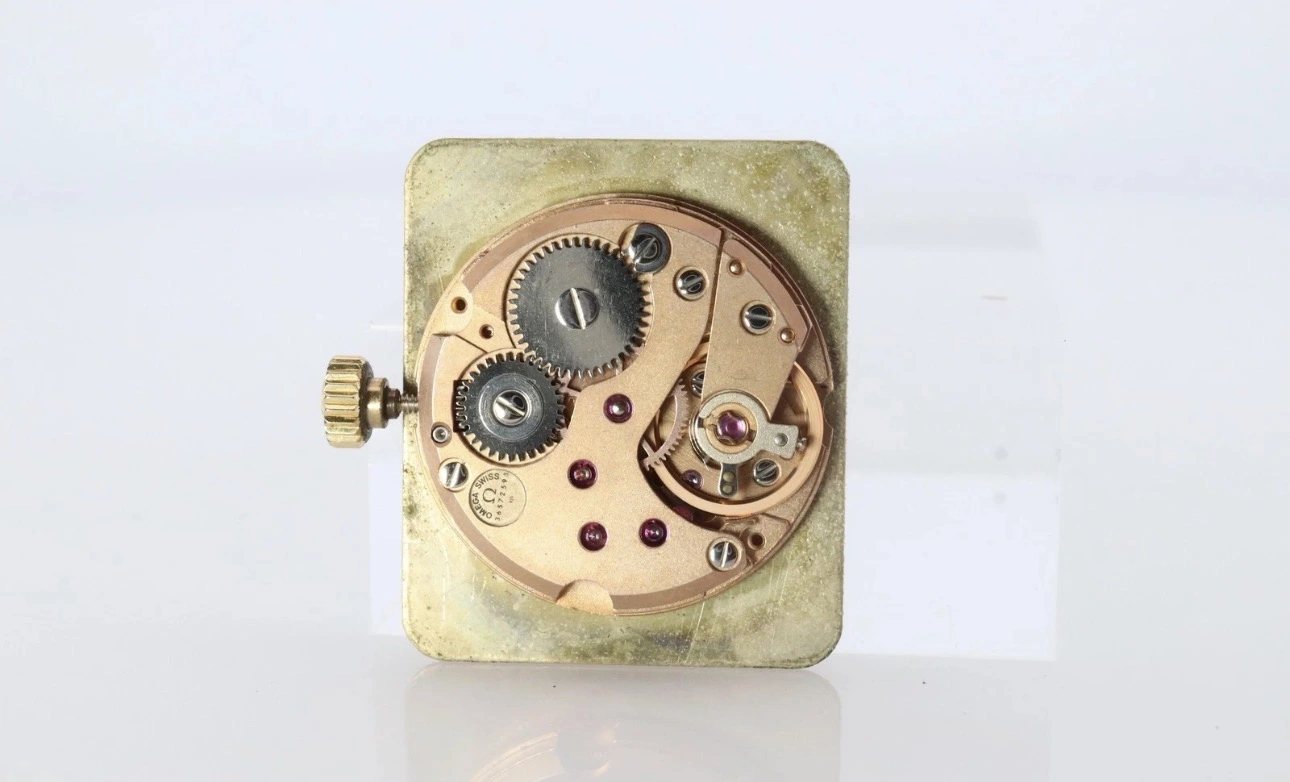

Quite a few watchmaker marks inside the case, which always makes me afraid, but the movement looks well taken care of. Crown doesn't look like the right one perhaps, but I don't know enough to say definitively.
24,838
55,263
The case is very badly damaged. I wouldn't buy it, but especially not as a gift.
18,847
39,194
All genuine but very tired and worn. 20 micron gold plate showing wear through as Dan noted.
And if that is USD$1,000 the price is exorbitant for what it is.
978
4,540
Even if this watch did not already have the obvious wear through to base metal on the corners, investing in a gold plated watch of that period is not a good gift option if your lady will be wearing it all the time. The plating is only 20 microns thick (.02 of a mm) and will wear through fairly quickly. $1000 is a ridiculous price.
Earlier vintage watches with gold capping, which is 200 microns, last for many years.
