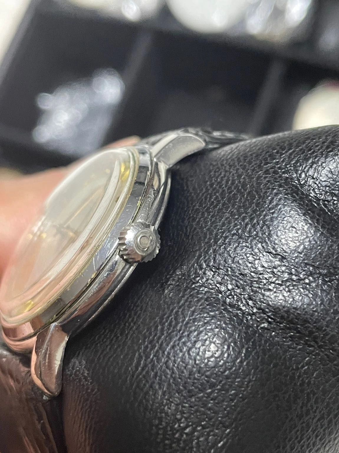

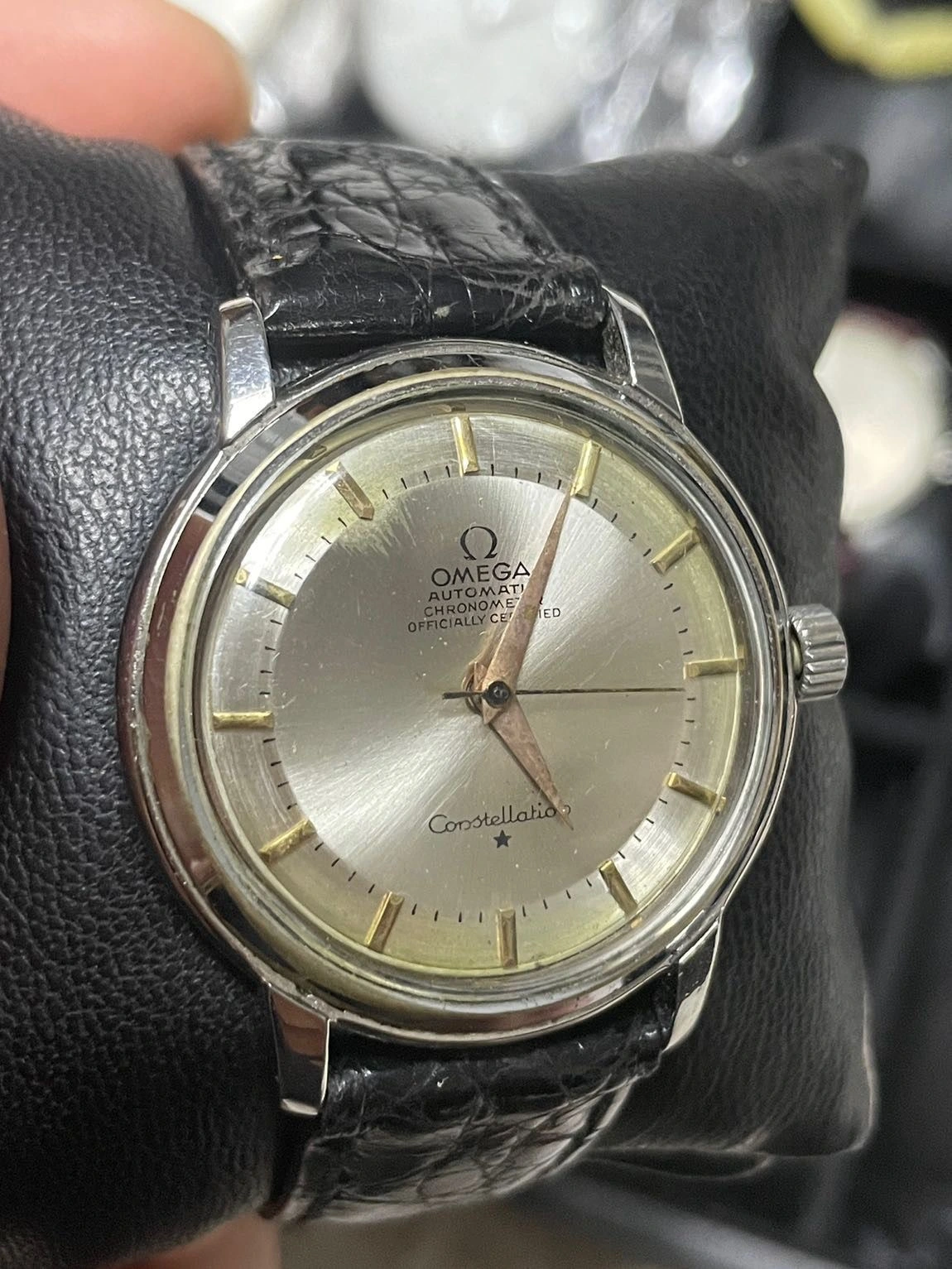

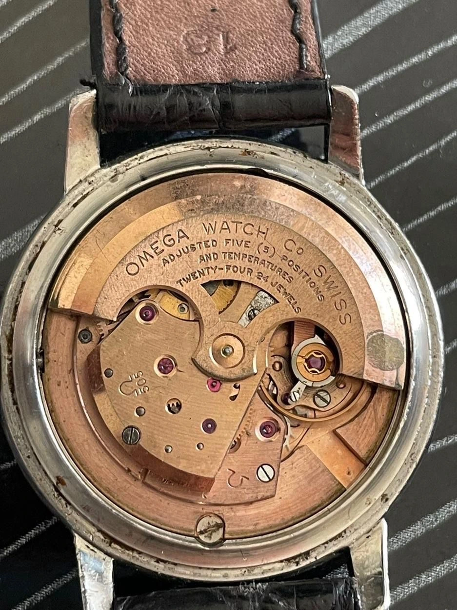

It is real, but it has seen better days. The dial has been repainted, the case and the movement are both in rough shape. The snap-on case back is supposed to have a gasket in it. I also don't think that's the original crown. Experts can correct me if I'm wrong.

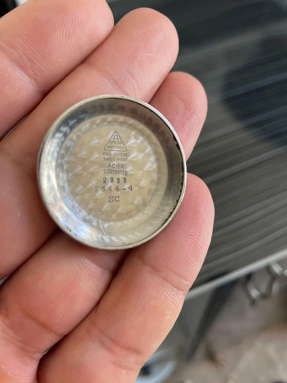

Omega 2864 is not a Constellation reference so not real IMO
This is a complete mess, a frankenwatch!

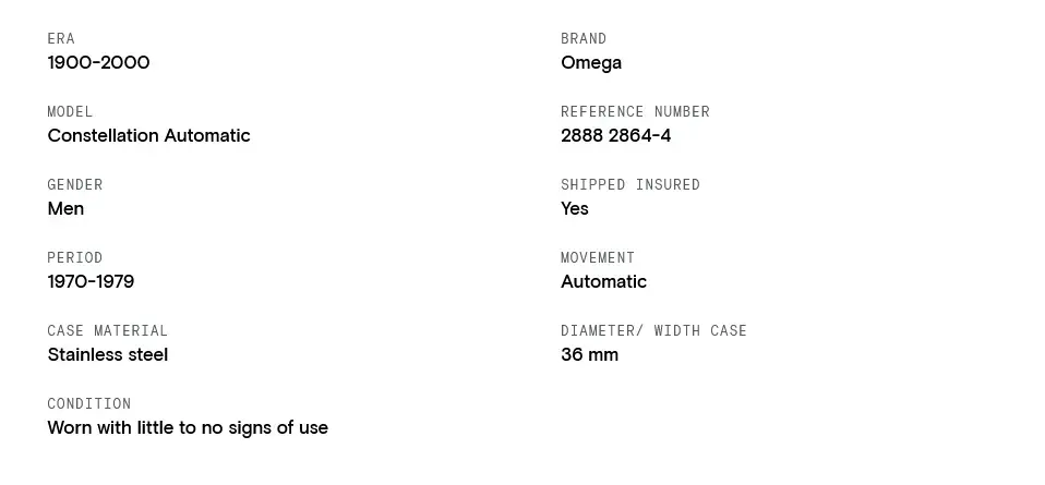

Neither "1970-1979" nor "with little to no signs of use"

In addition to all the above, so much wrong with this one. 2864 should have a 501, not a 505.

The 11 o'clock marker comes from a different watch, and you can see the effect on the dial's finish in the adjacent area. Sorry.

This is a franken-watch, put together from original Omega parts that did not ever go together at the factory.
As pointed out above, the dial was poorly repainted and you can see the marks where the improper dial index was replaced.
Looks like a Mumbai Special to me.
