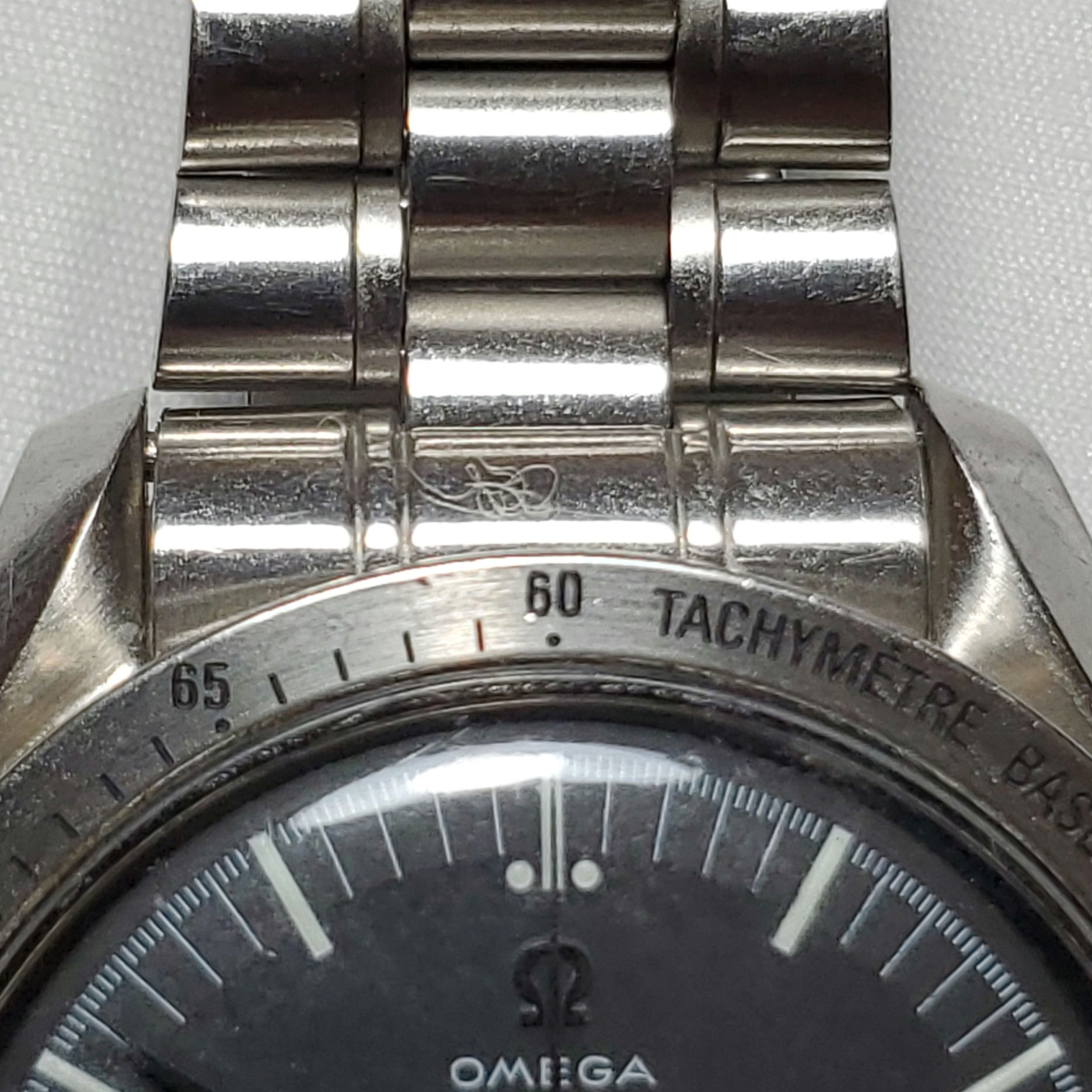

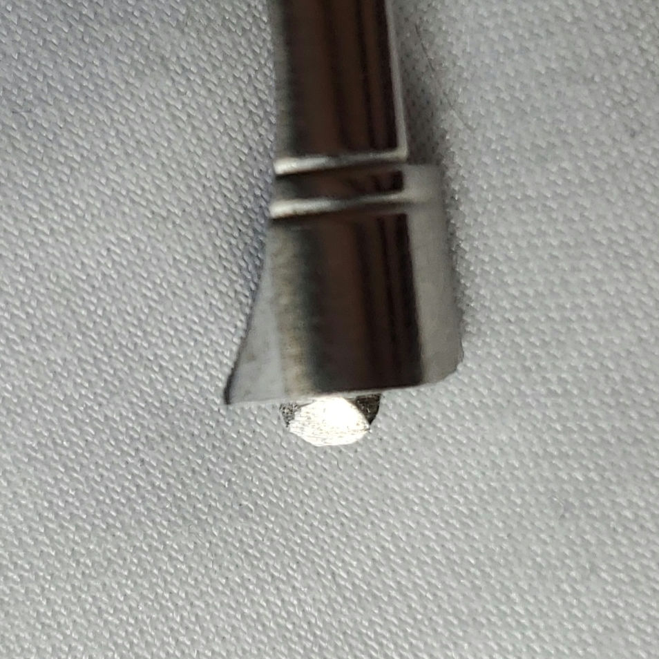

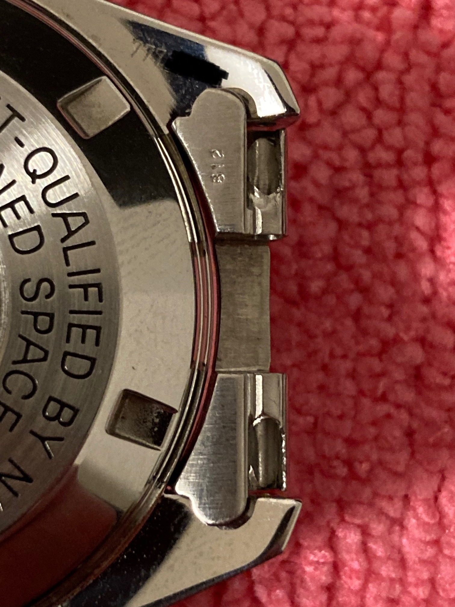

Hey all,
I recently did some research and decided that I would purchase a 1479 with 812 endlinks as I had read that said endlinks would fit without any modifications.
Well, today the bracelet and the endlinks arrived and to my dismay the curvature of the endlinks do not seem to fit with the curvature of my 3570.50 case. Because the fit isn’t snug, there is no chance in getting the end links to fit and I do not, of course, intend to force them in.
So the question is, do you think the endlinks could have been altered in any way or is the radius of the 3570.50 different to its predecessor? I am pretty clueless as to how this could be the case.
Please find attached two pictures where you can clearly see the gap between the case and the endlinks. This is caused by corners of the endlinks fitting snug into the case, but the gap progresses at it moves towards the center of the link. Interestingly, both links appear to have a different radius. Thoughts?
Best regards,
S.

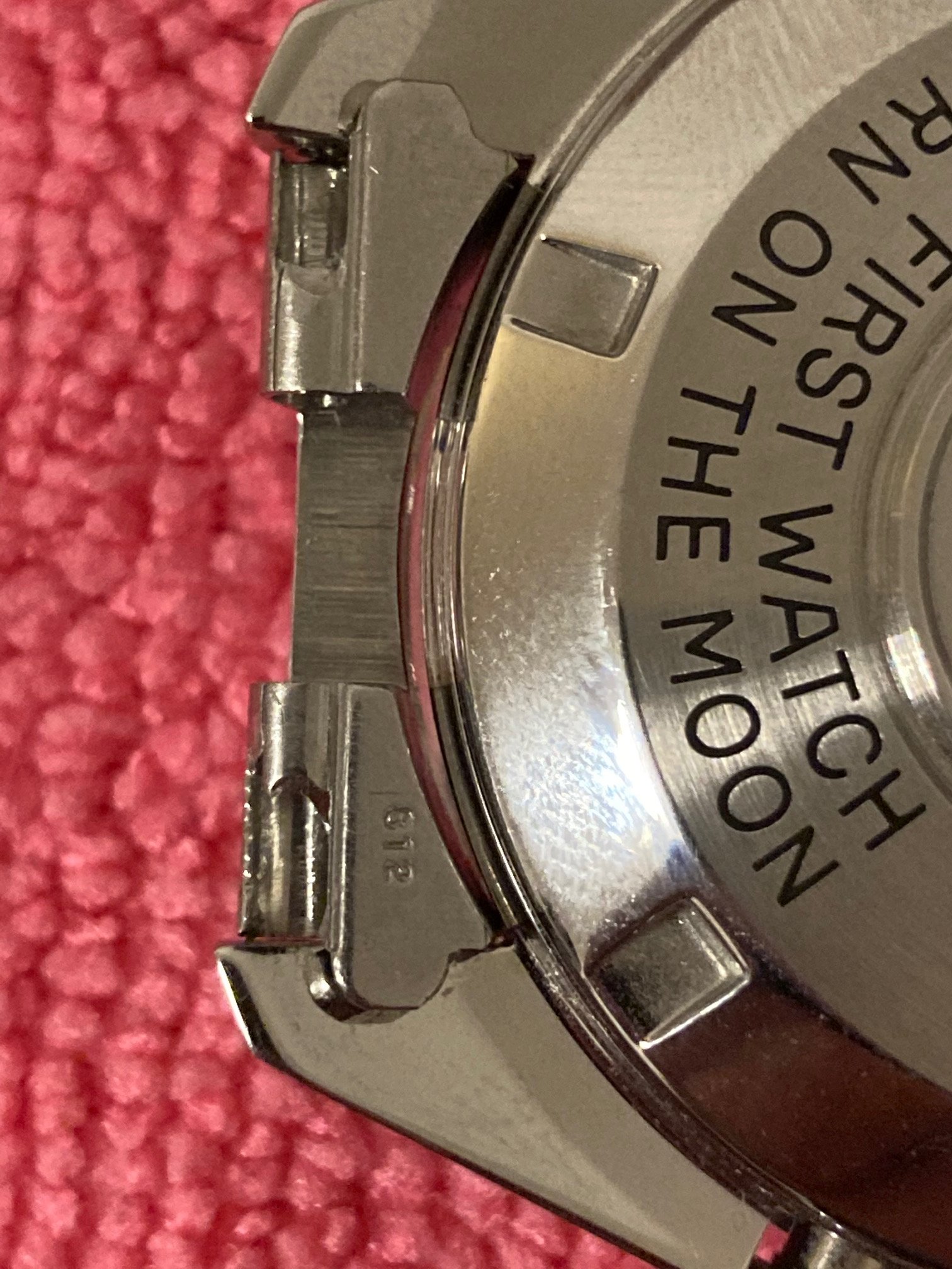

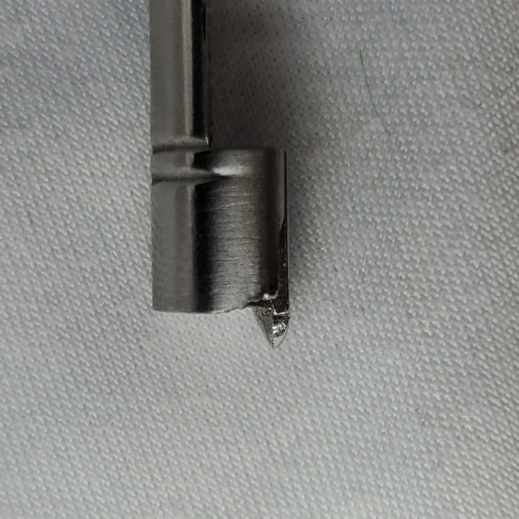

You have to file the end-link ears so that the end-link moves farther up and into the lug opening and the holes all line up. Had to do it so that they would fit my 3894.50 and now it fits my 145.022-69, also.

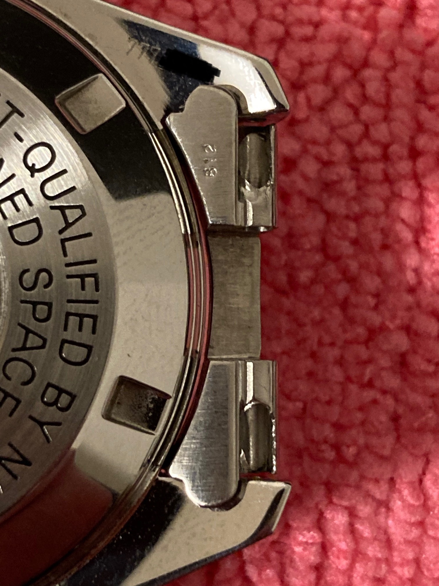

The 3570.50 and 3894.50 use the same midcase.

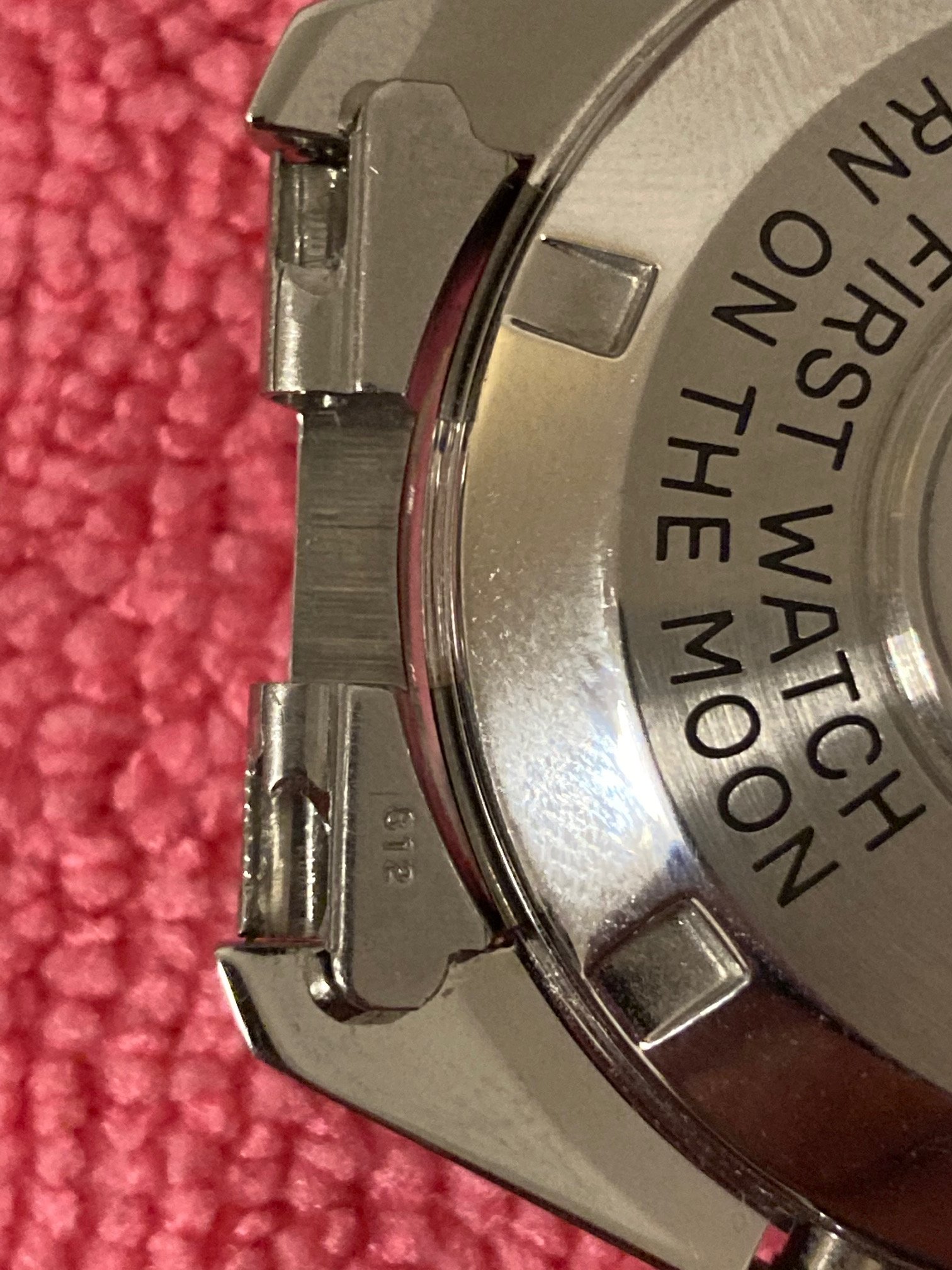

I don't know if you can see the modifications I had to make.

I have read that the ears need to be in some cases gently filed, but do you think that will free up enough space for the endlinks to move up towards the case? Looking at my pictures it doesnt seem that it is possible, but since the lugs are curved slightly towards the tips, I wonder if this is even worth it. It seems that I would have to get the angle just right in order for them to sit properly, I don‘t know. I don‘t want to ruin the endlinks, either.

Well, where is the end-link hitting the case now? Relieve the end-link in that area. The end-link tab is too wide and too tall. Unless your midcase is different or they changed the end-link design, it is doable. It took me several hours over a couple nights with a diamond file.

I have looked at it further and have now changed my mind.
1) The holes line up on the endlinks fine, though they do sit a little high. Filing the ears would solve the problem of being able to get them mounted.
2) There would still be a gap on both sides, they will not sit snug on the case as they should. Something seems about the endlinks, but I am not sure what it is.

I don't know what to tell you. A 1479/812 100% fits the 80s and 90s Speedmaster. And vintage ones from the 60s and 70s. And the modern ones even. These cases are "identical" in this regard. It even fits my new-parts SM300. The end-links require filing, like the modern 1171/1 bracelet 633 end-link does since the end-links are made meaty so they can be modified to fit properly.
I'm not sure what you're seeing so I'm not sure if I can provide any additional advice. If it's a gap against the face of the end-link and the case, improper spring bars might cause that.
12
Thank you for your pictures and help. The endlinks in your pictures are sitting the way they should.

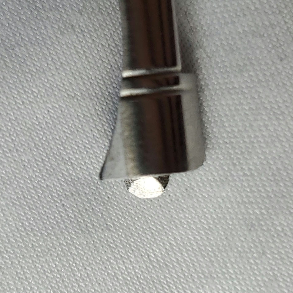

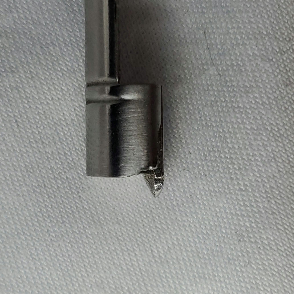

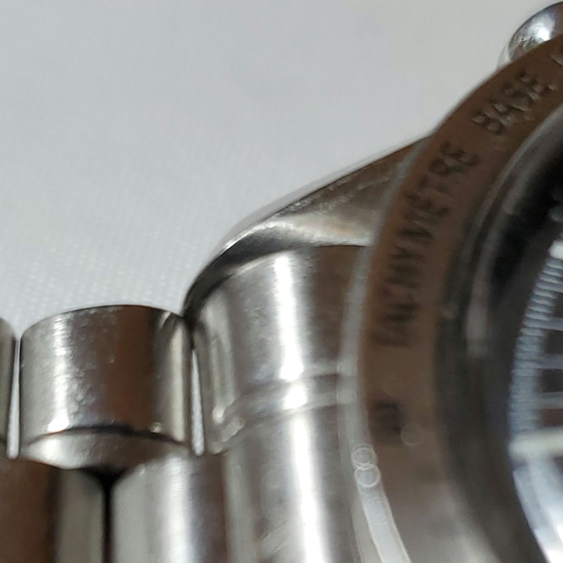

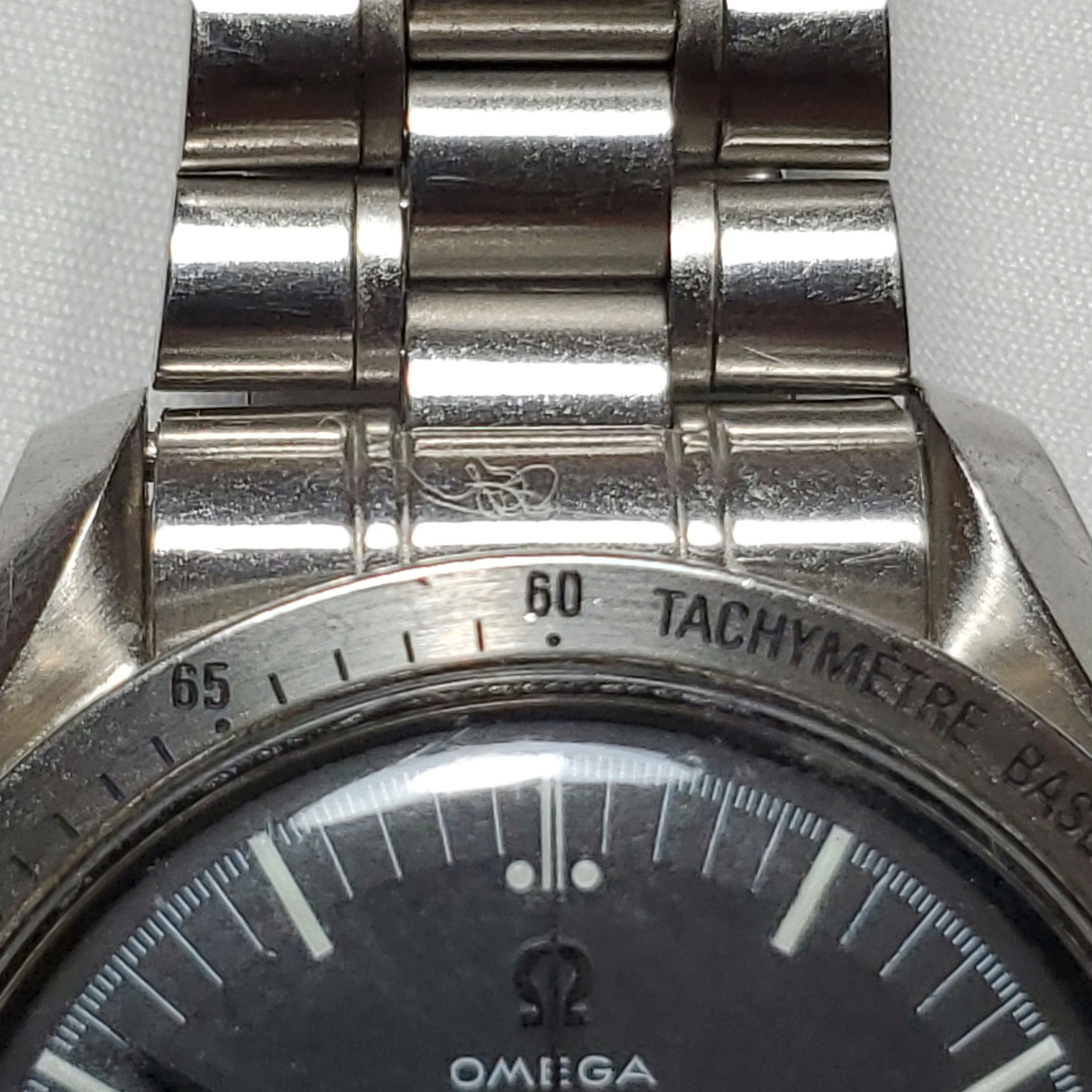

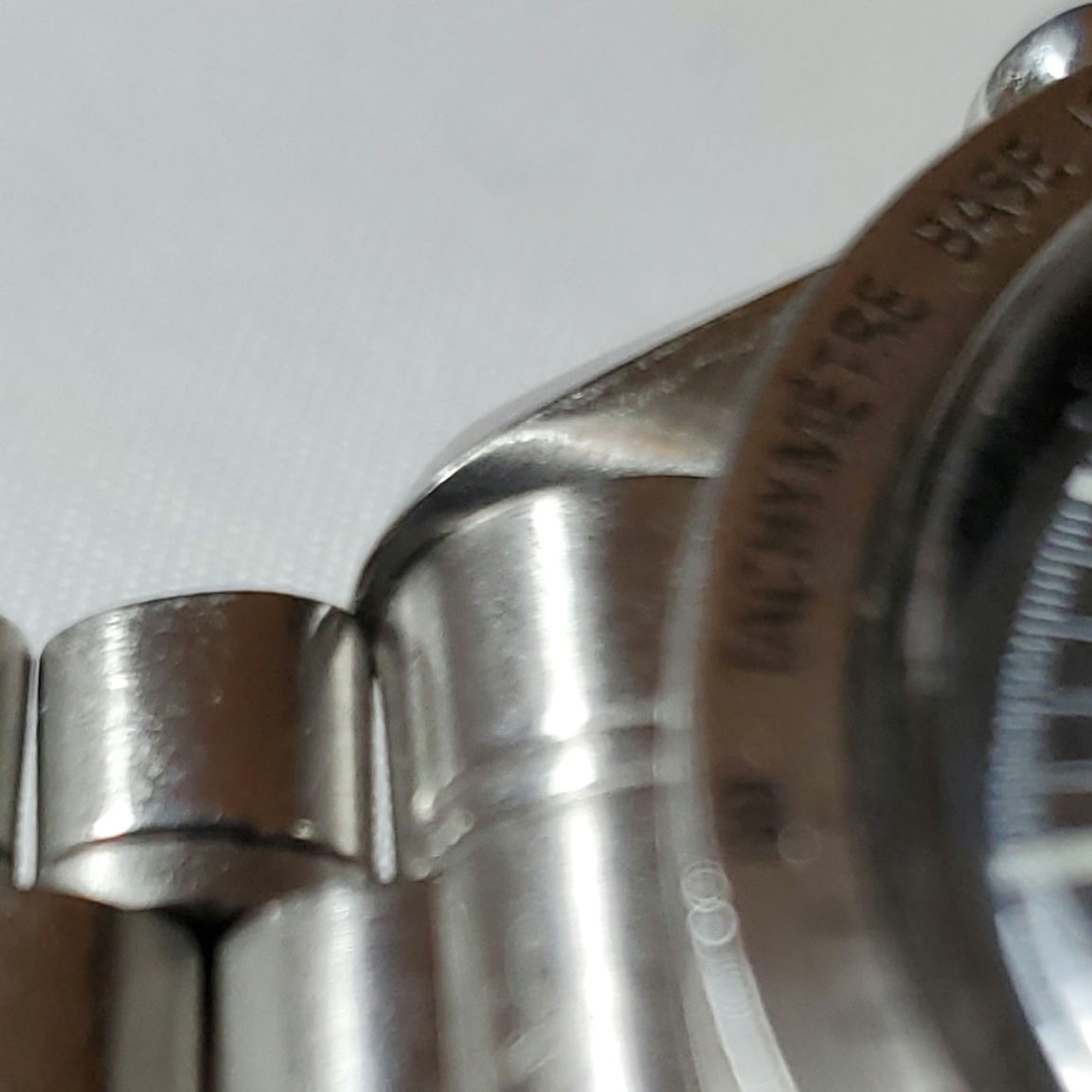

Could you take a picture of the top of your end-links placed in the lugs?
12
Yes, I will do so this evening. The only problem is that I cannot mount them with springbars yet due to the endlinks sitting too high, but I can try my best to hold them on and snap a few photos.
1,568
3,136
Yeah, like you had them for the photos in the OP just from the top. Just trying to see what you're seeing.

Update: I took everything to the AD today and had their watchmaker look at it and his opinion was that the endlinks wouldn’t fit without laser welding and modifying the links. Generally speaking, he questioned the authenticity of the endlinks and simply said that they wouldn’t be able to do anything in their store due to strict orders from Omega regarding modifications.
Looks like I will be parting with not only the bracelet, but also the watch, as I prefer the newest version with the better bracelet. As for the endlinks, I cannot sell them knowing what I already know, so lesson learned, I guess.
