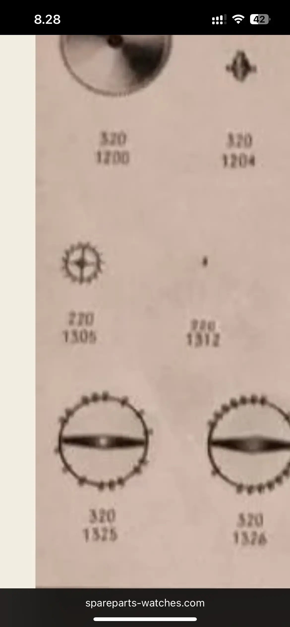

Posts 4 Likes 0 vtee ·Aug 23, 2025 I notice that, 320 uses Omega 220 escape wheel and even same pallet arbor. I found complete 220 pallet fork, so i am going to try my luck
Posts 104 Likes 196 mollydooker ·Aug 23, 2025 Here is a list of movements that use that Pallet Fork. https://www.emmywatch.com/db/part/pallet_fork__arbor--710_416/lemania--ch27/
