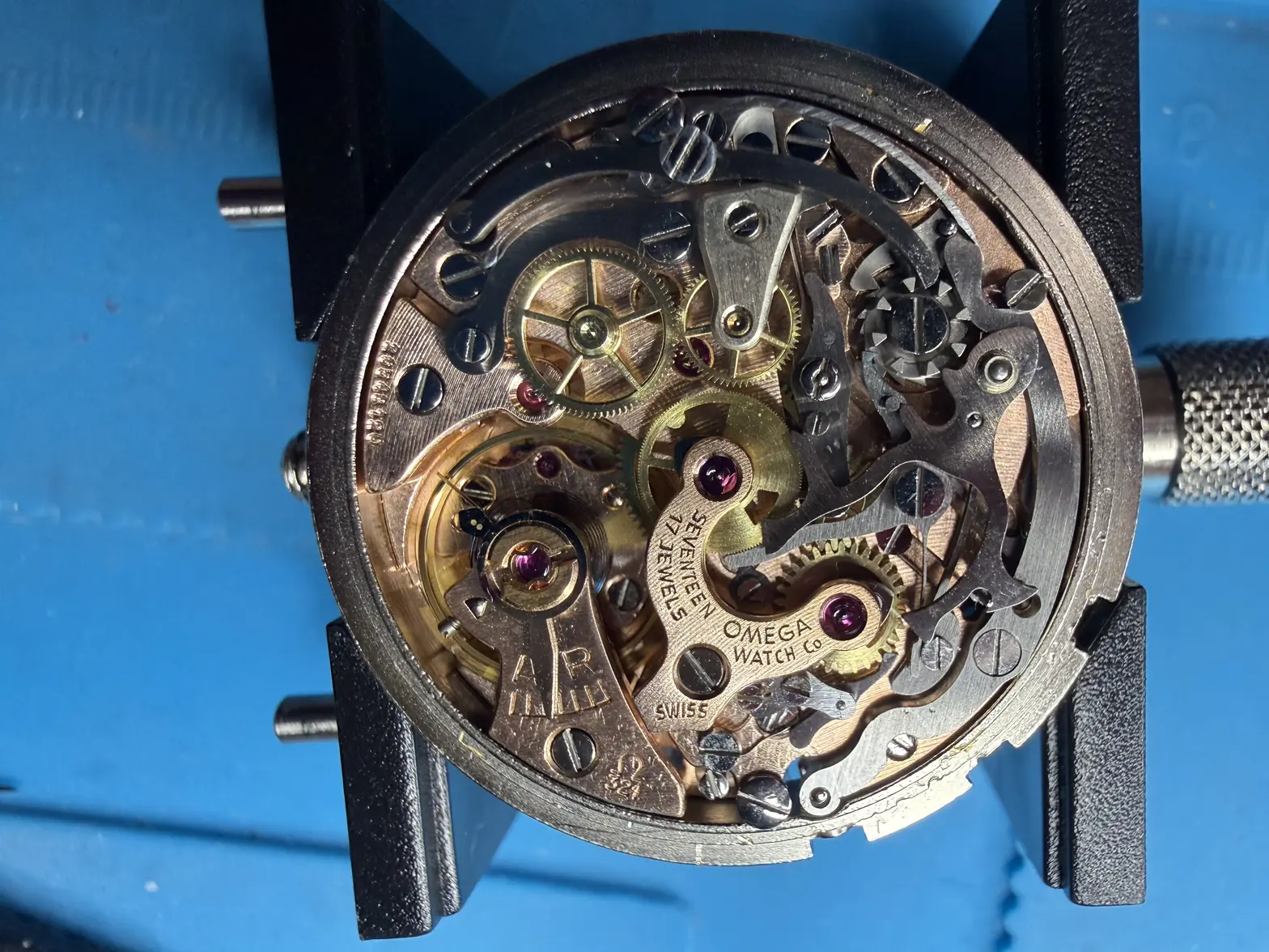

·I’m having an issue with my 321 reassembly. The minute recorder will immediately jump on start (advances a minute right off the bat). The function of it after is perfect. No flaws, except for this.

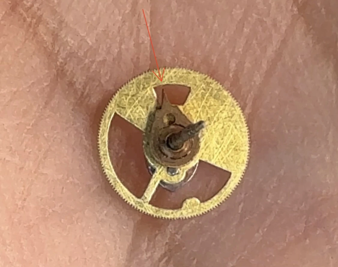

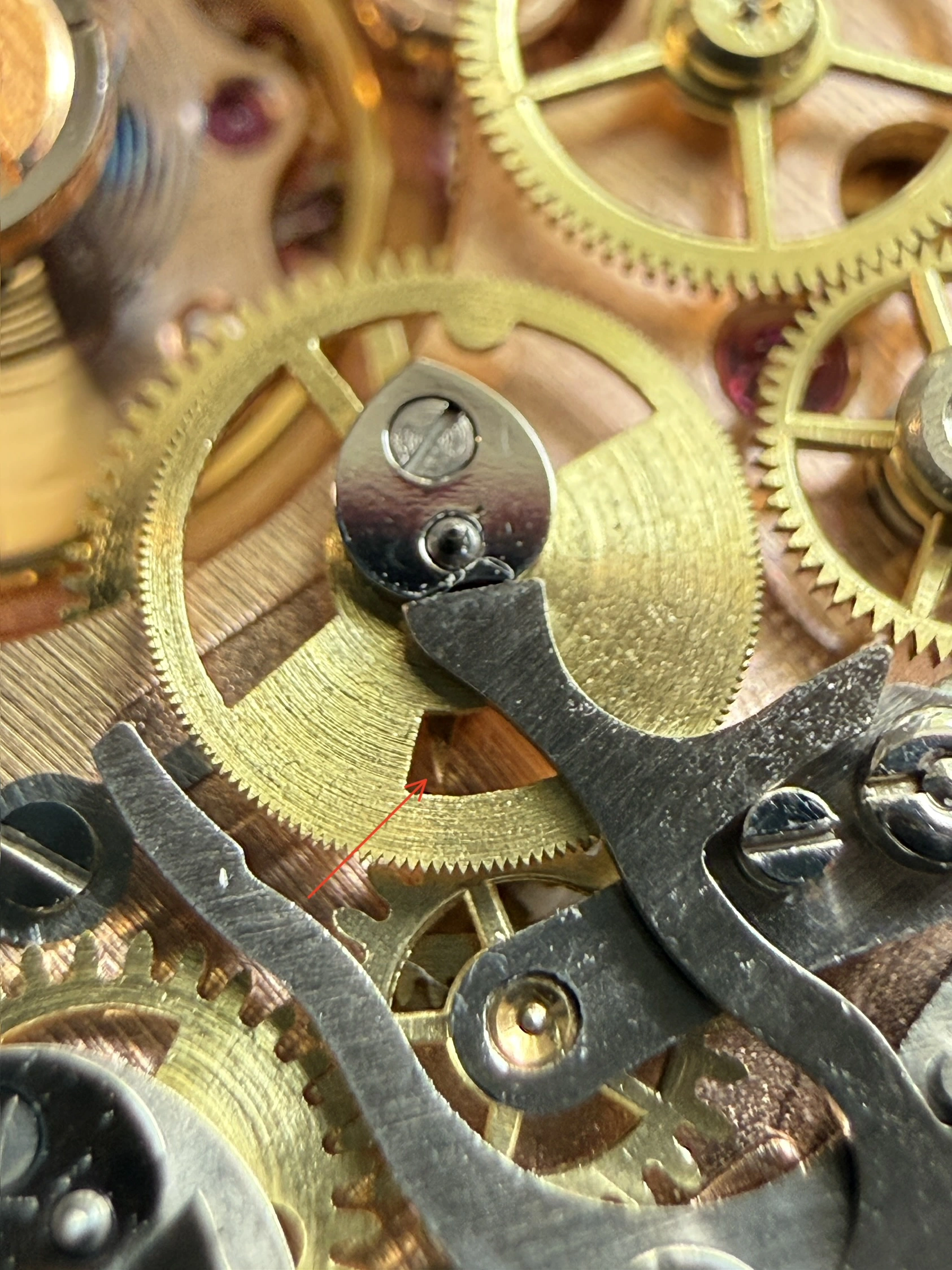

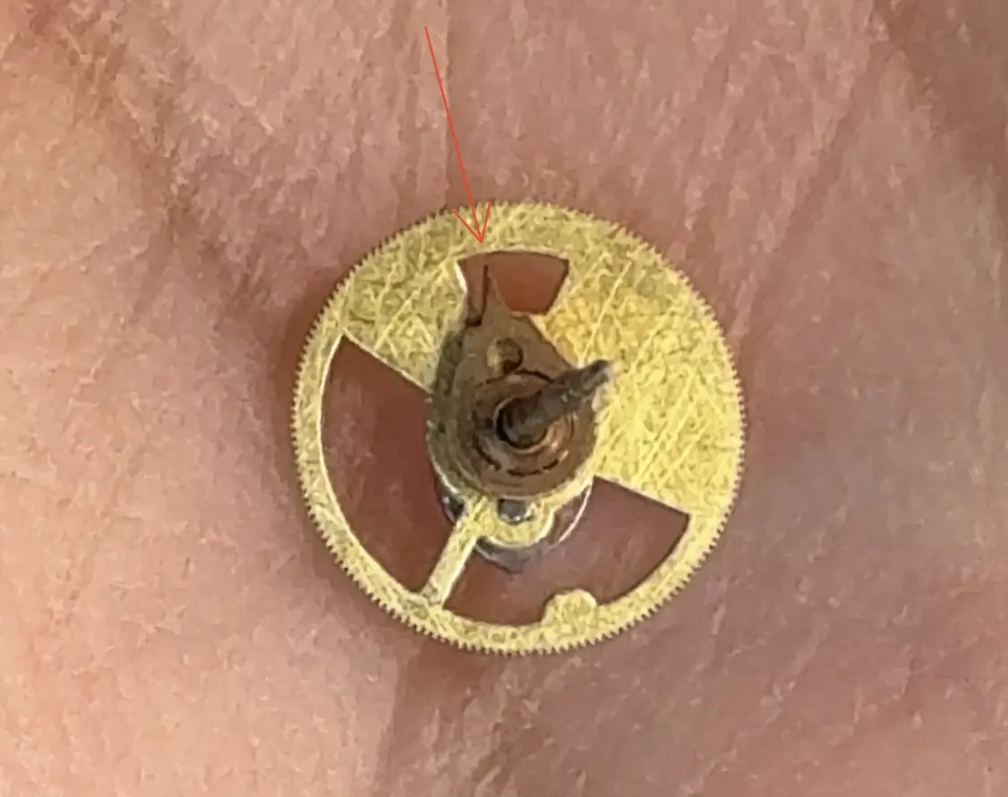

I noticed that the finger on the center chrono runner appears shifted off axis. Photo here.
Does anyone have experience with this?
I’ve read elsewhere on this forum that that finger can be shifted on the post. But that there’s also one of the eccentrics that adjusts the rotation of the minute recorder position. Considering the watch runs very very well with no other issues, I’m tempted to rotate the finger itself. But I’m doing my due diligence.
(Omega 321 - 26xxxxx 1967 transition DNN)
Amplitude 270 chrono off. 240 chrono on. BE 0.2ms. Rate: 0-1
