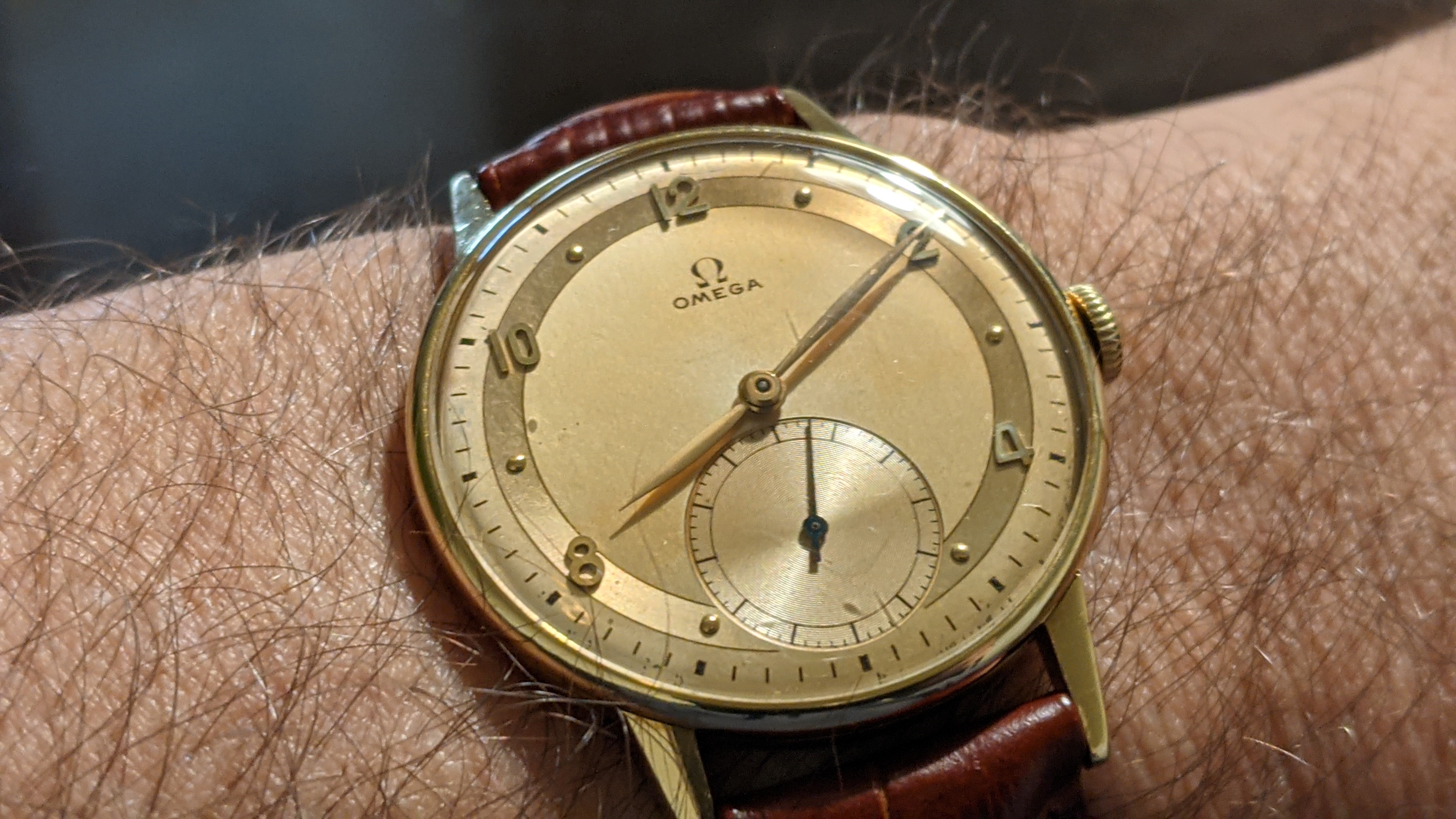

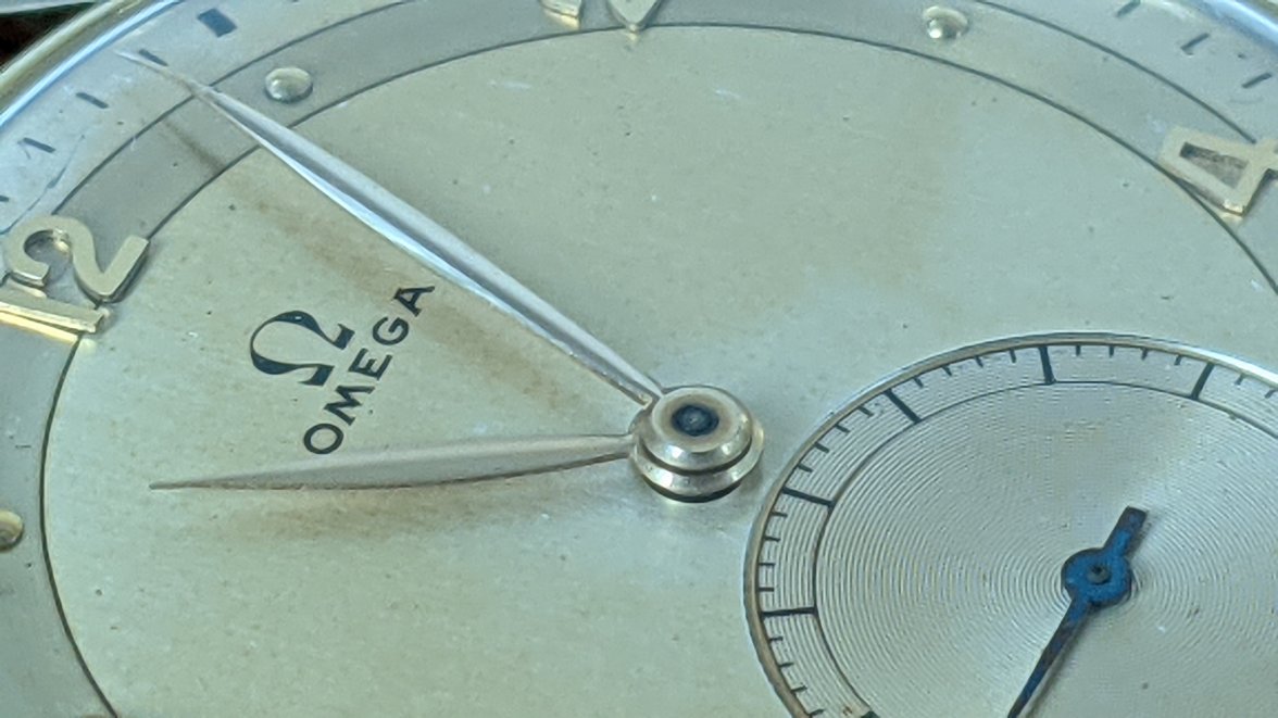

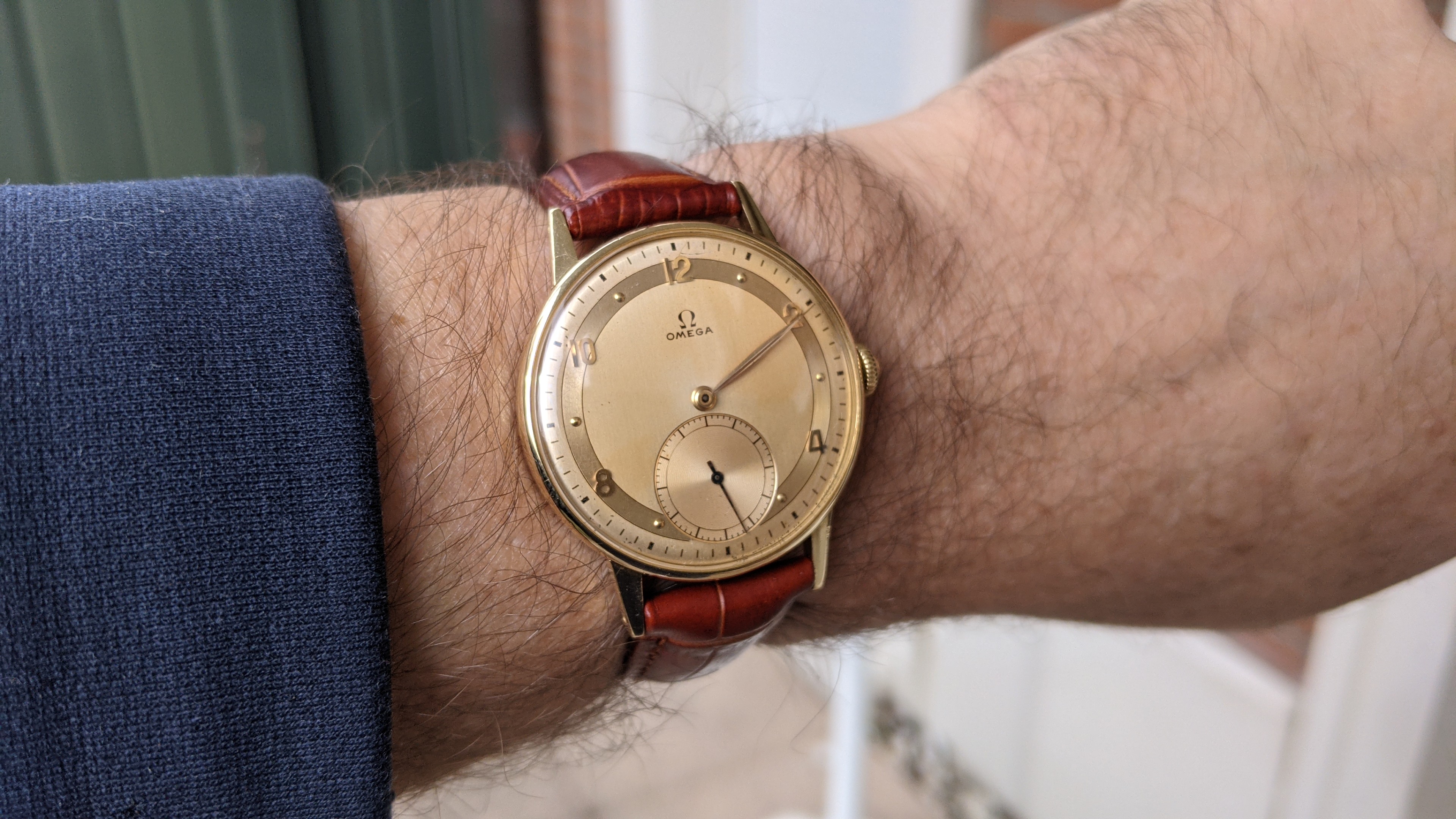

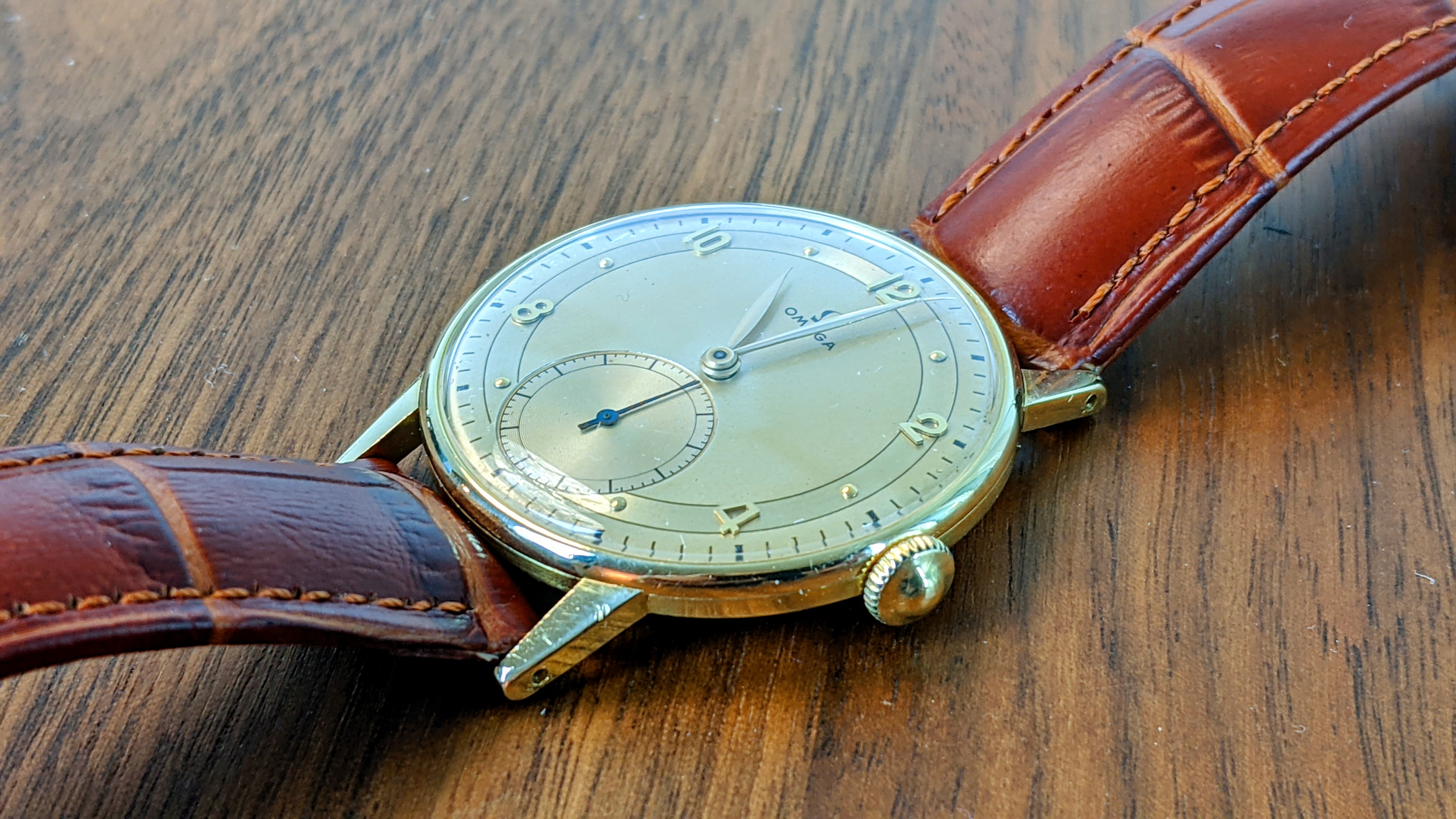

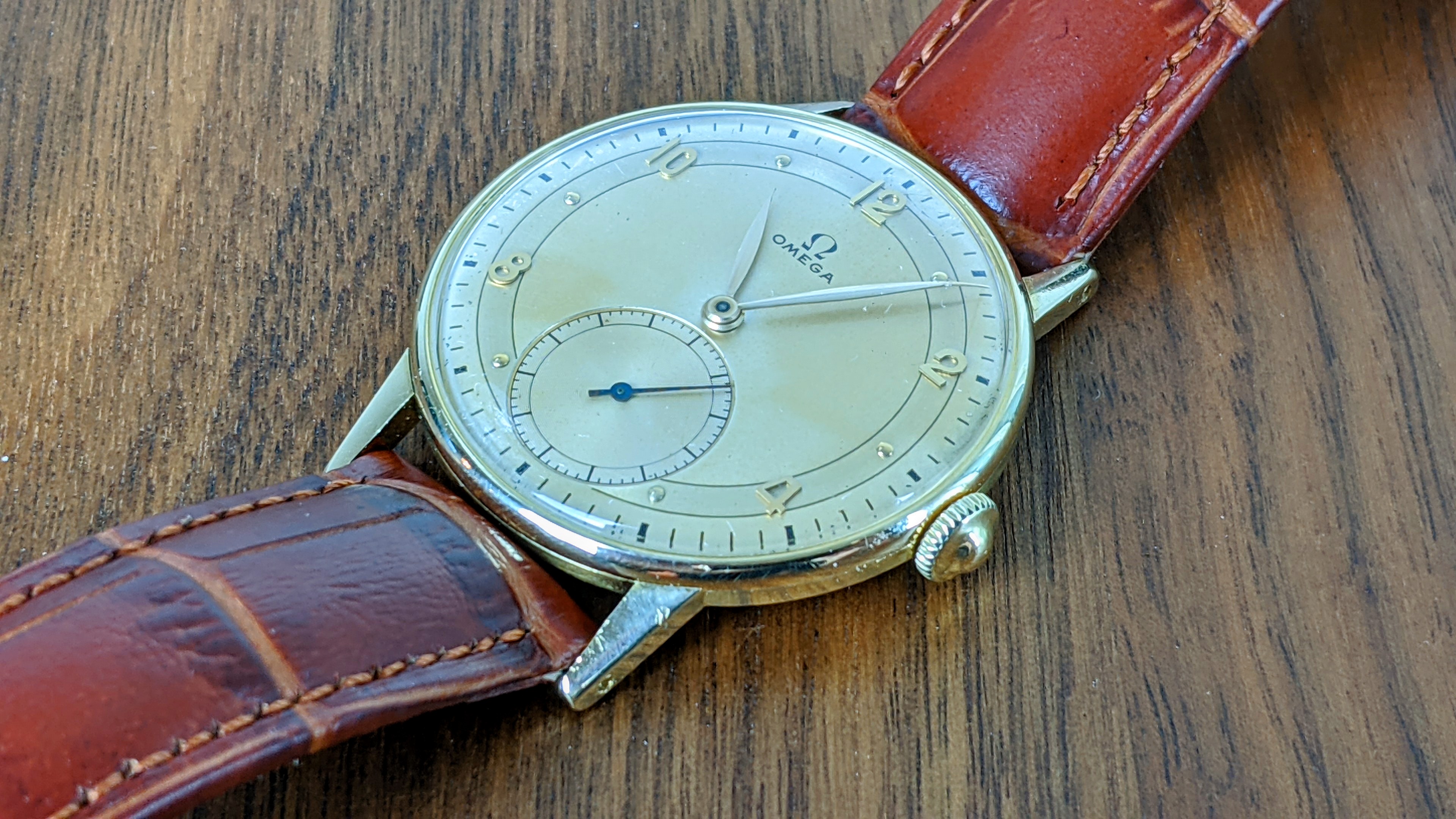

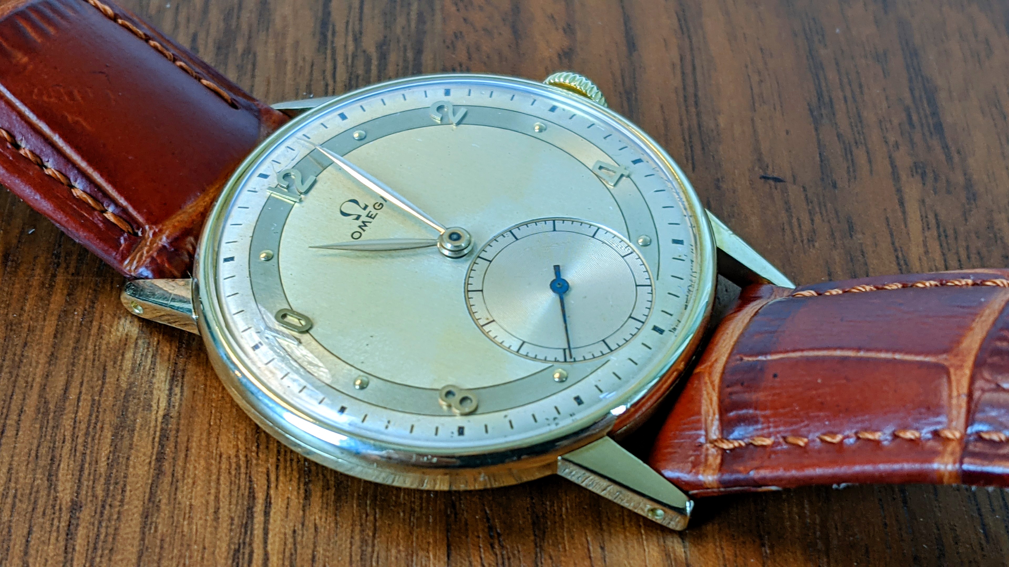

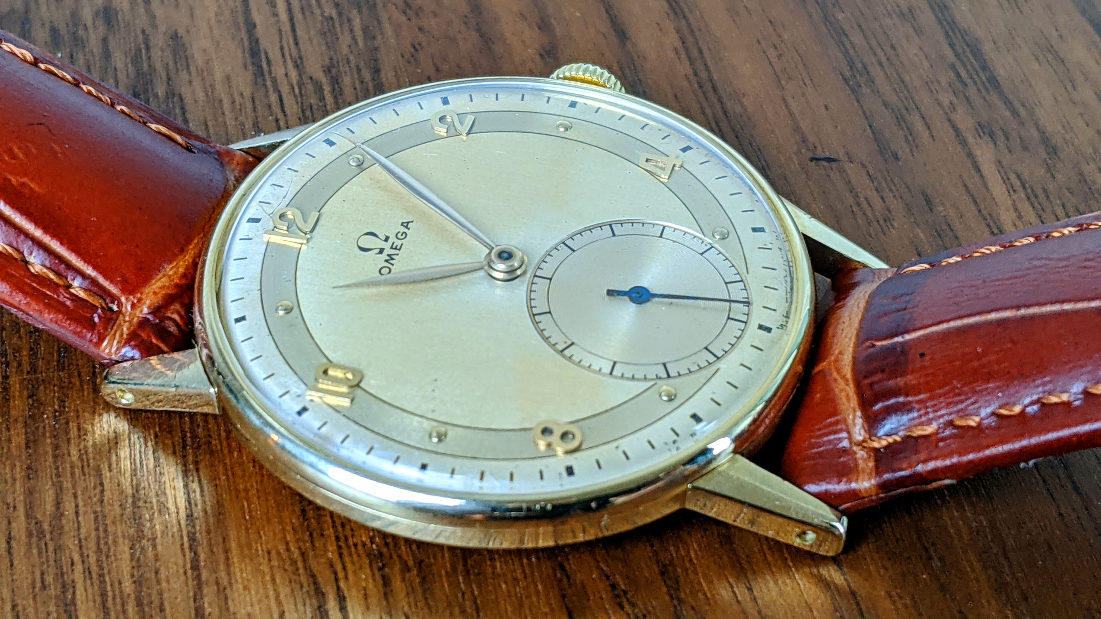

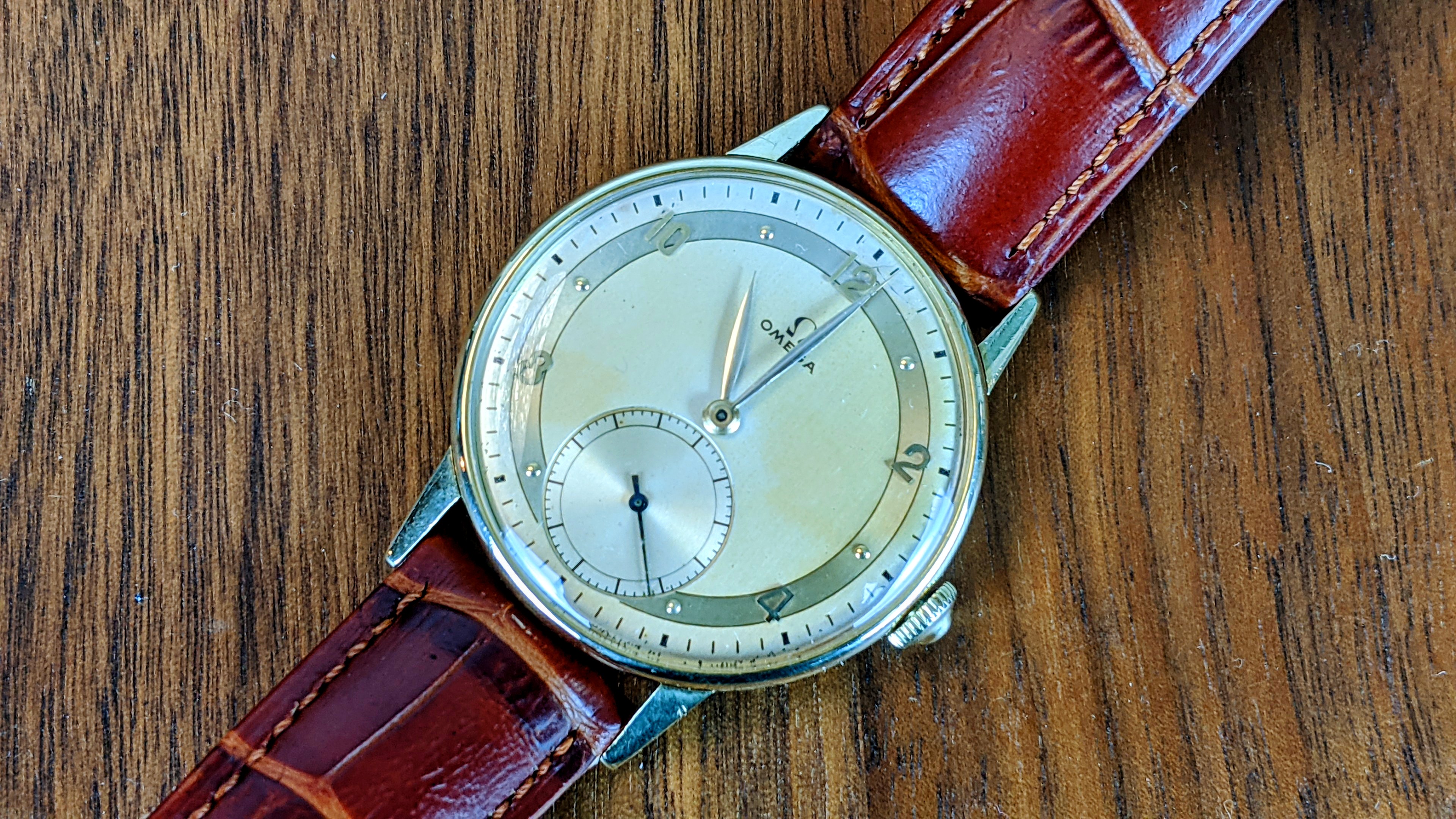

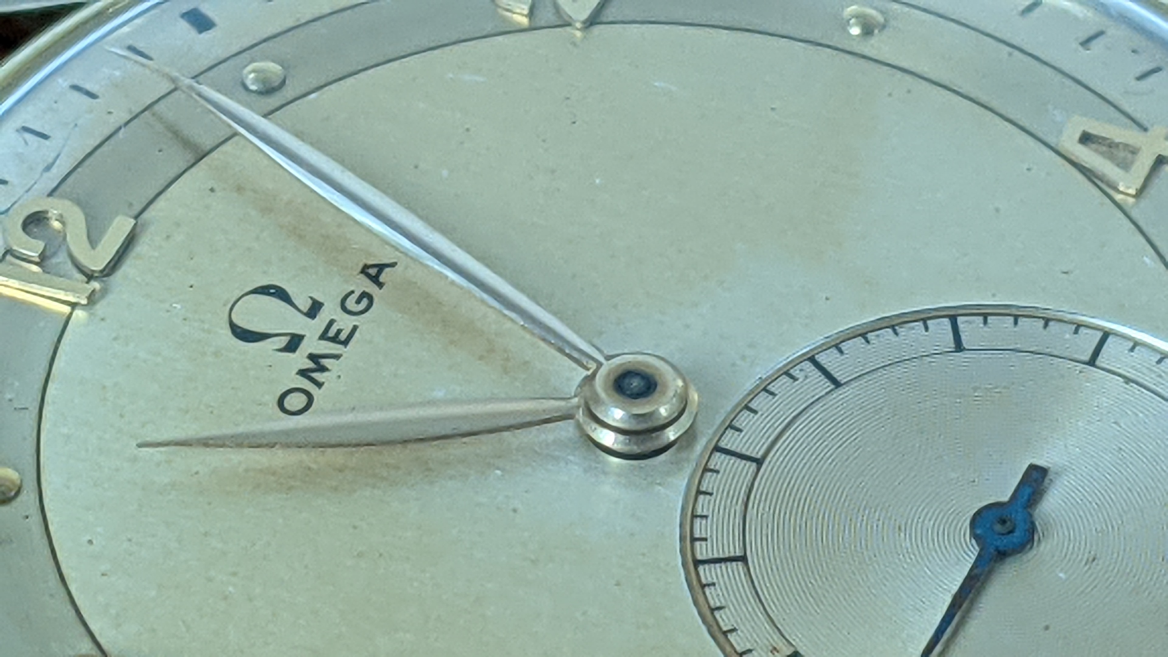

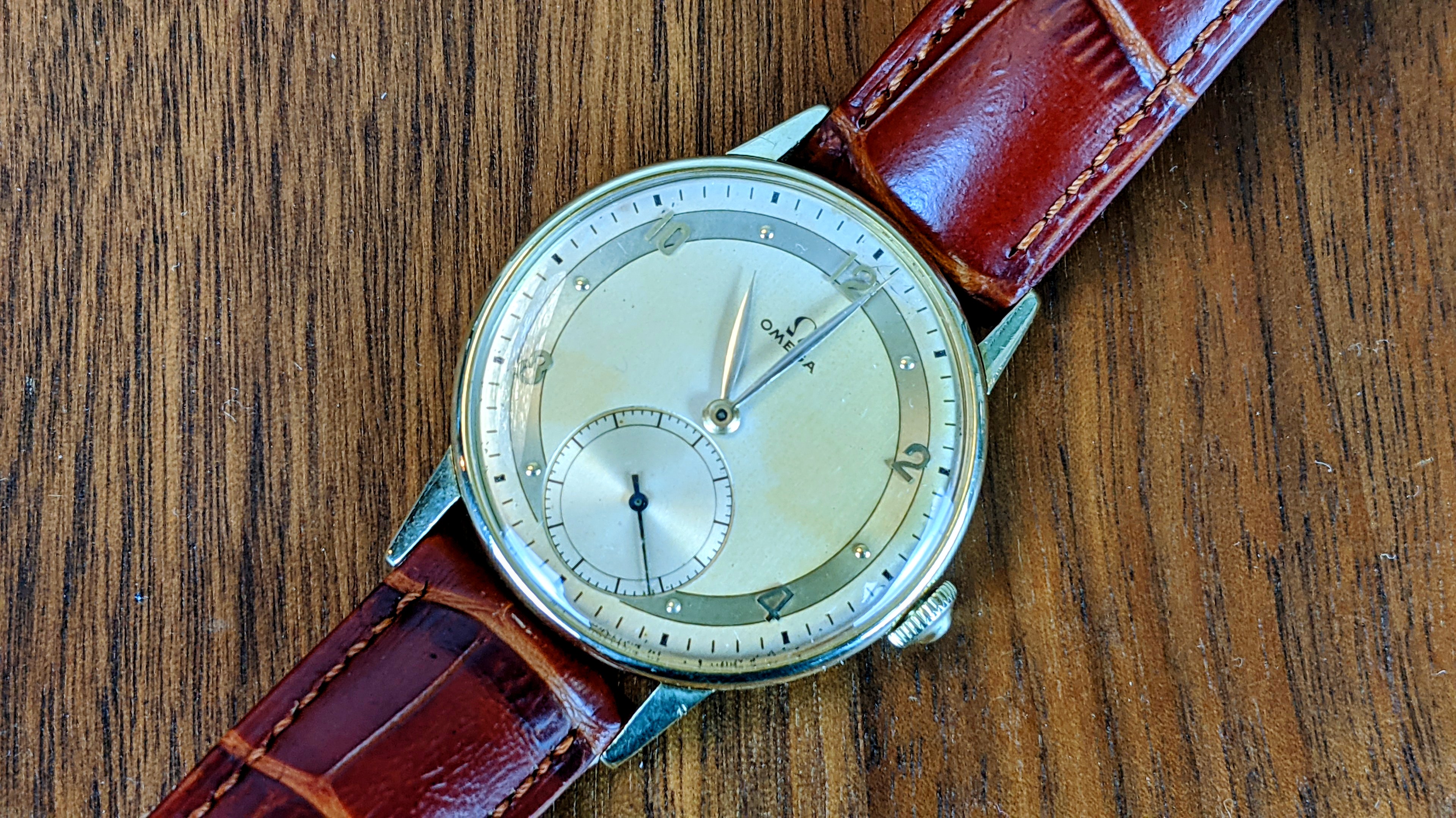

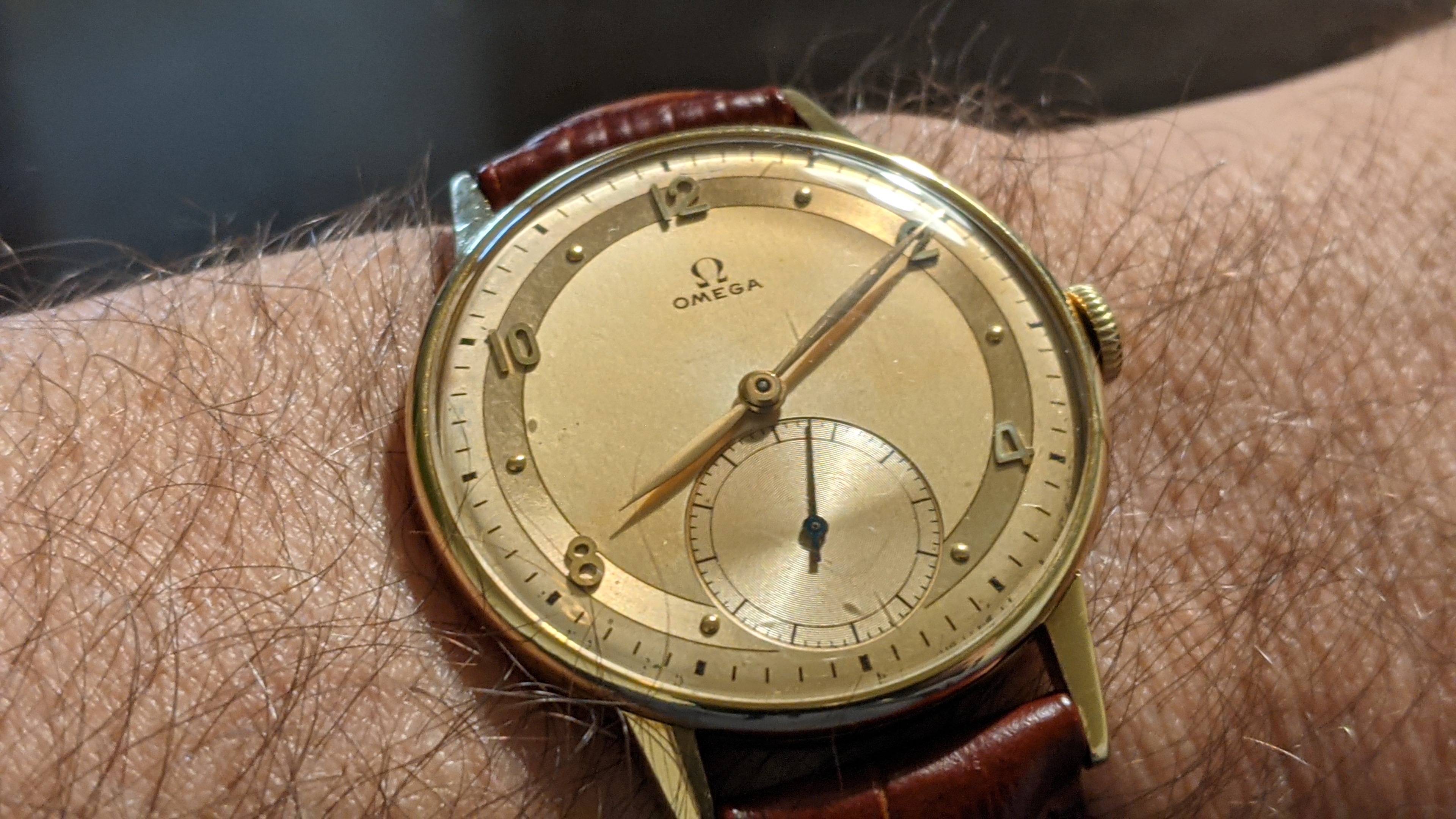

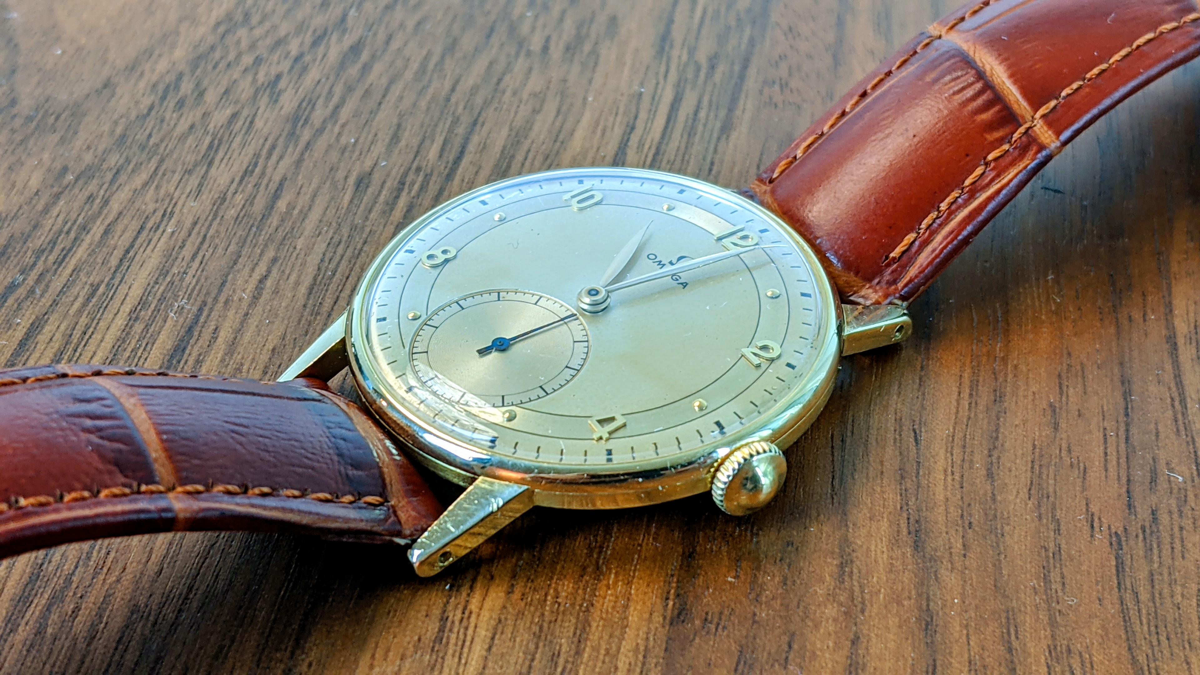

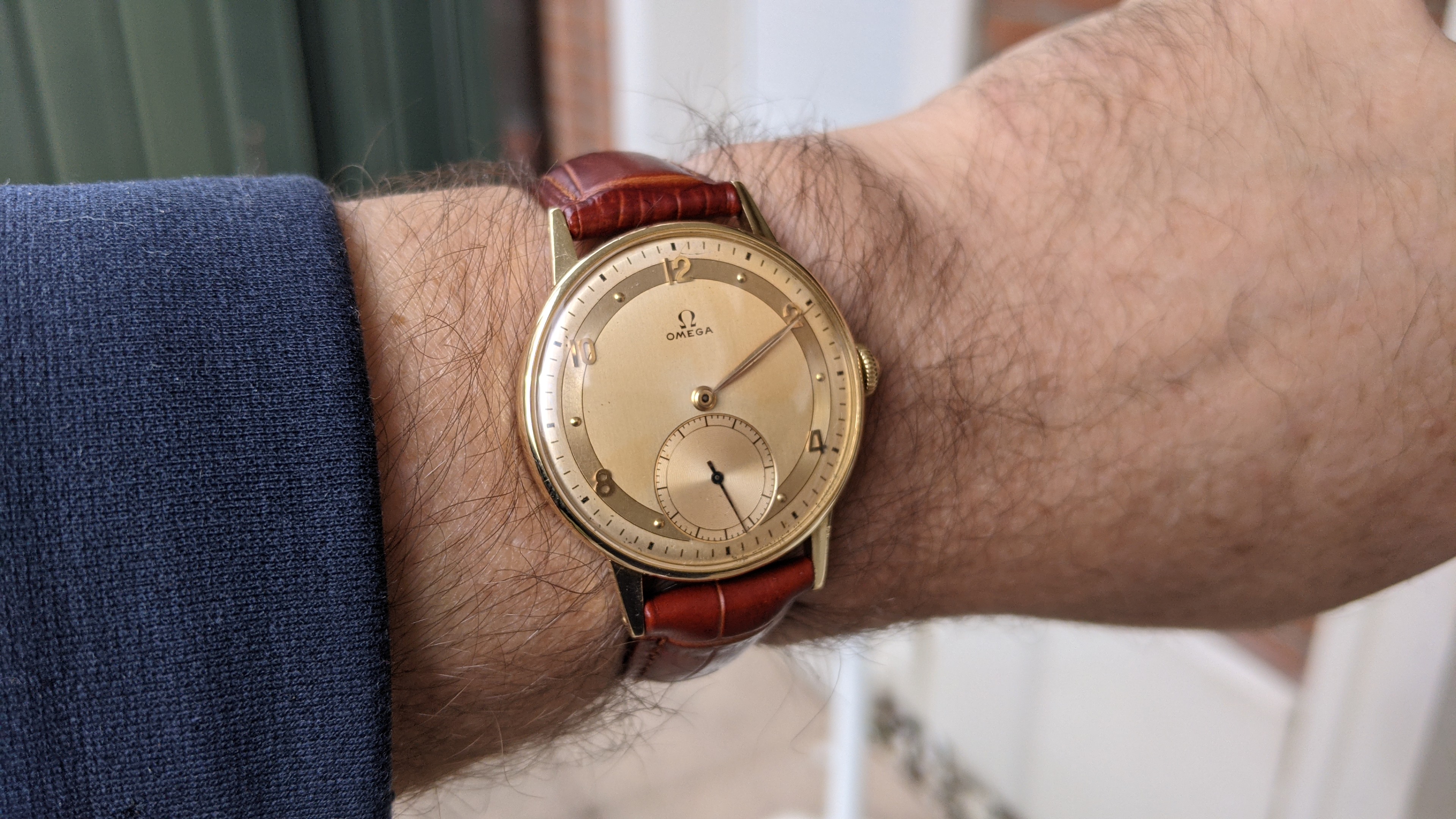

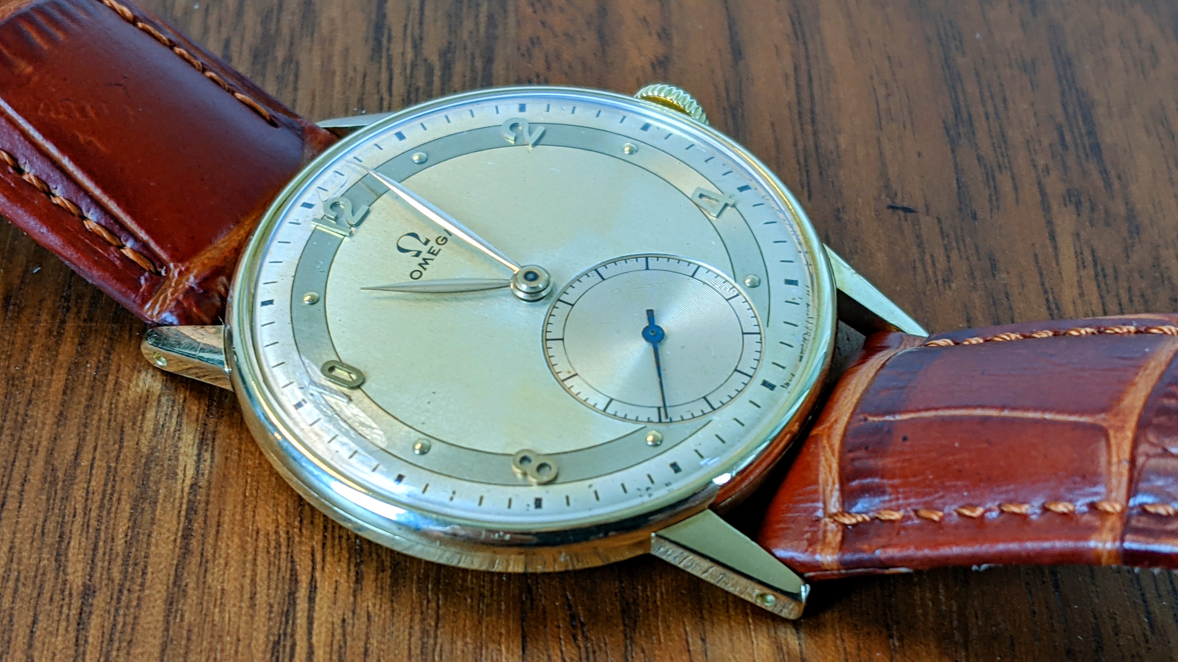

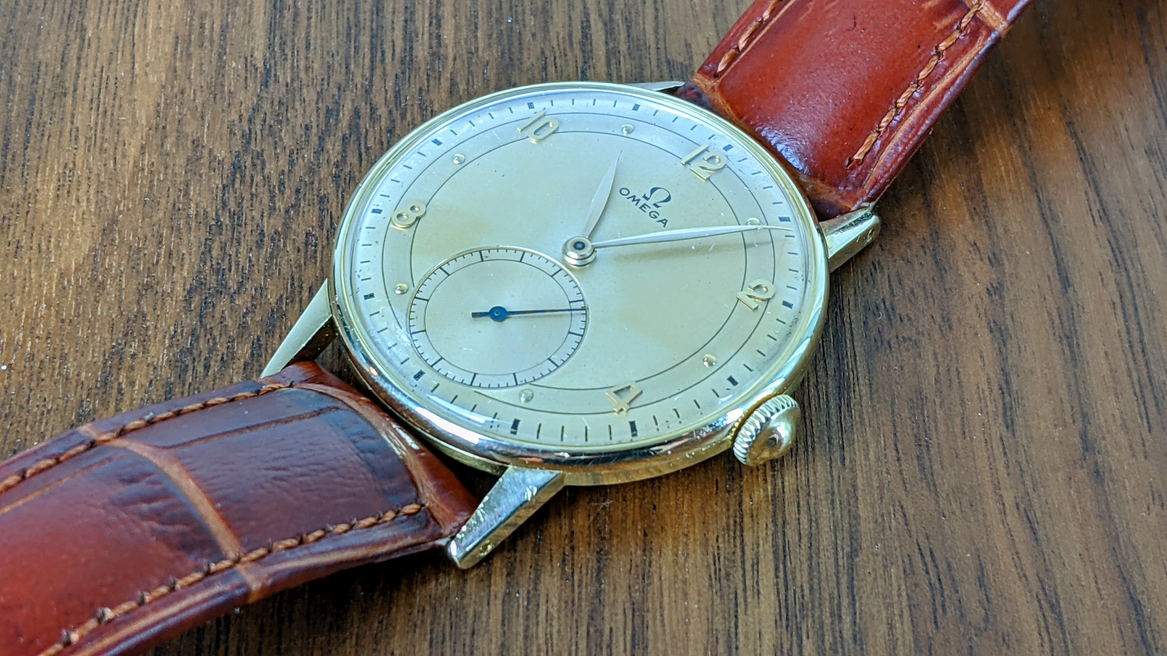

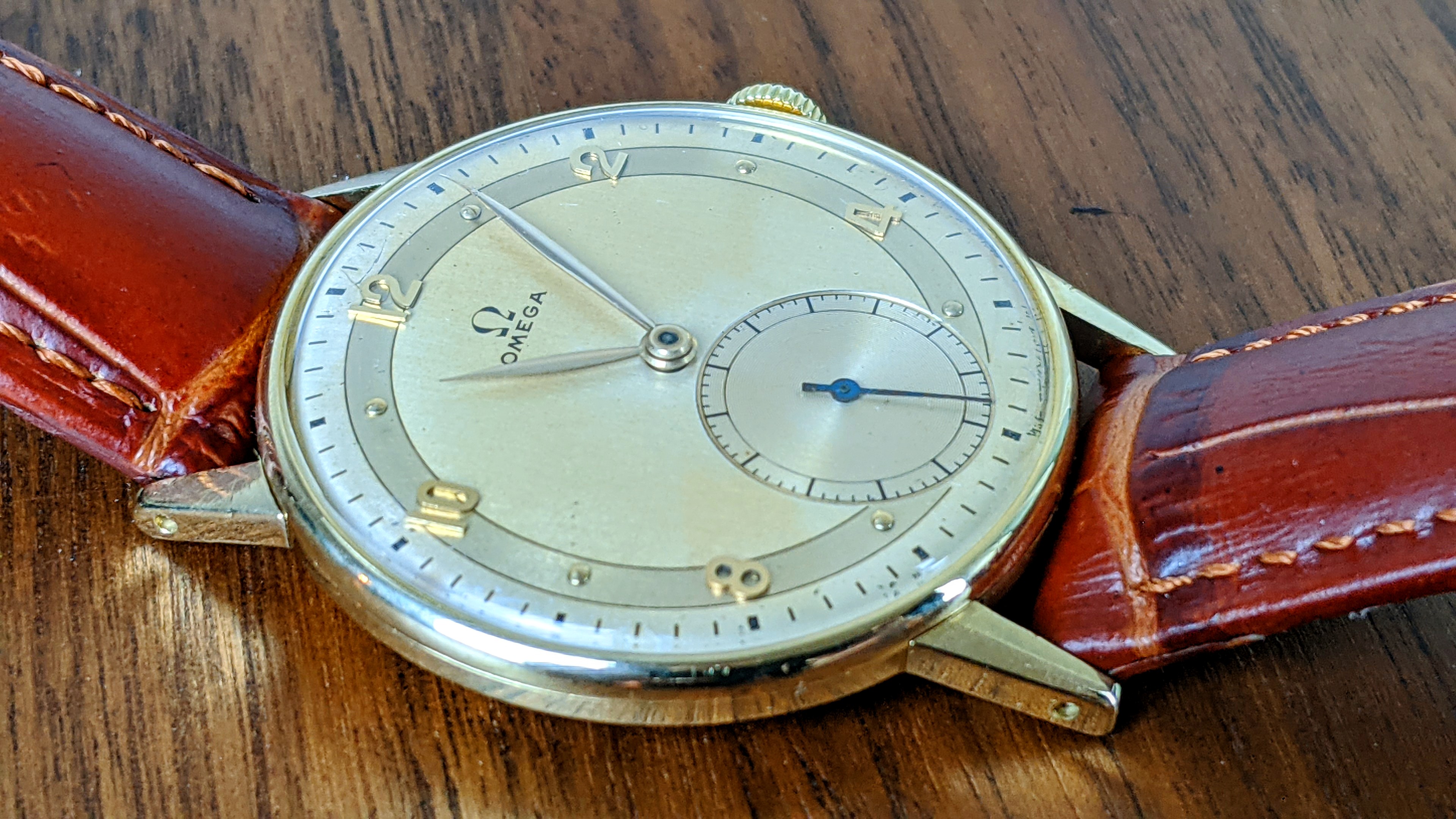

For those who are interested as promised here are some pictures of my 30t2. Sorry for the bad rendition it's taken with a smartphone.

Congrats again, very nice watch, and I call dibs 😁

I noticed the 1 at 12 is a little bit bended. The movement is running well. Amplitude is between 250 and 280° and the watch lost around 15s per day. I'm still wondering if it needs a service right now, considering the regulator is positioned far from the neutral position to slow down the movement.
As Franco has mentioned, the slight vertical brushing is present on the center part of the dial. The blued small second is a bit oxydated. The 2 pictures on natural light show a more accurate rendition of the watch.
Im really over the moon, it's a beautiful watch but I'm now a bit worried to wear it considering its condition as I don't want to damage it.

That is a stunning looking watch, vintage vibe and just screams classic class.
In a word timeless.
Well done.

It almost certainly needs a service. The lift angle appears to be 49 degrees, assuming I'm reading this old chart correctly. If you left your timing machine on its default lift angle, then you're gettinng the wrong amplitude.
The regulator pointer elsewhere than centered usually means it needs service, too.

Welcome back to the thread @seduriku. Thanks for posting all your photos - seeing your watch has quite restored my 1940s Omega mojo: I think it's breathtaking. But that doesn't matter anyway - you have some of the top guys on OF backing you on this one, and no wonder! WIGH and all that.

Yes the timegrapher was set on 49°, that's the value google told me. But thanks for that precision. No matter the amplitude is good or not, that regulator position and your advice convinced me that I have to have the watch serviced right now. It would be a shame that this watch, who has been so well preserved during around 75 years, ends up in the hands of someone who will not take good care of it.

Thank you TimeODanaos, I'm happy these pictures helped you to get your mojo back 😀
Having the approval of some of the most knowledgeable guys on this forum is something that makes me happy and makes me love the watch even more.
