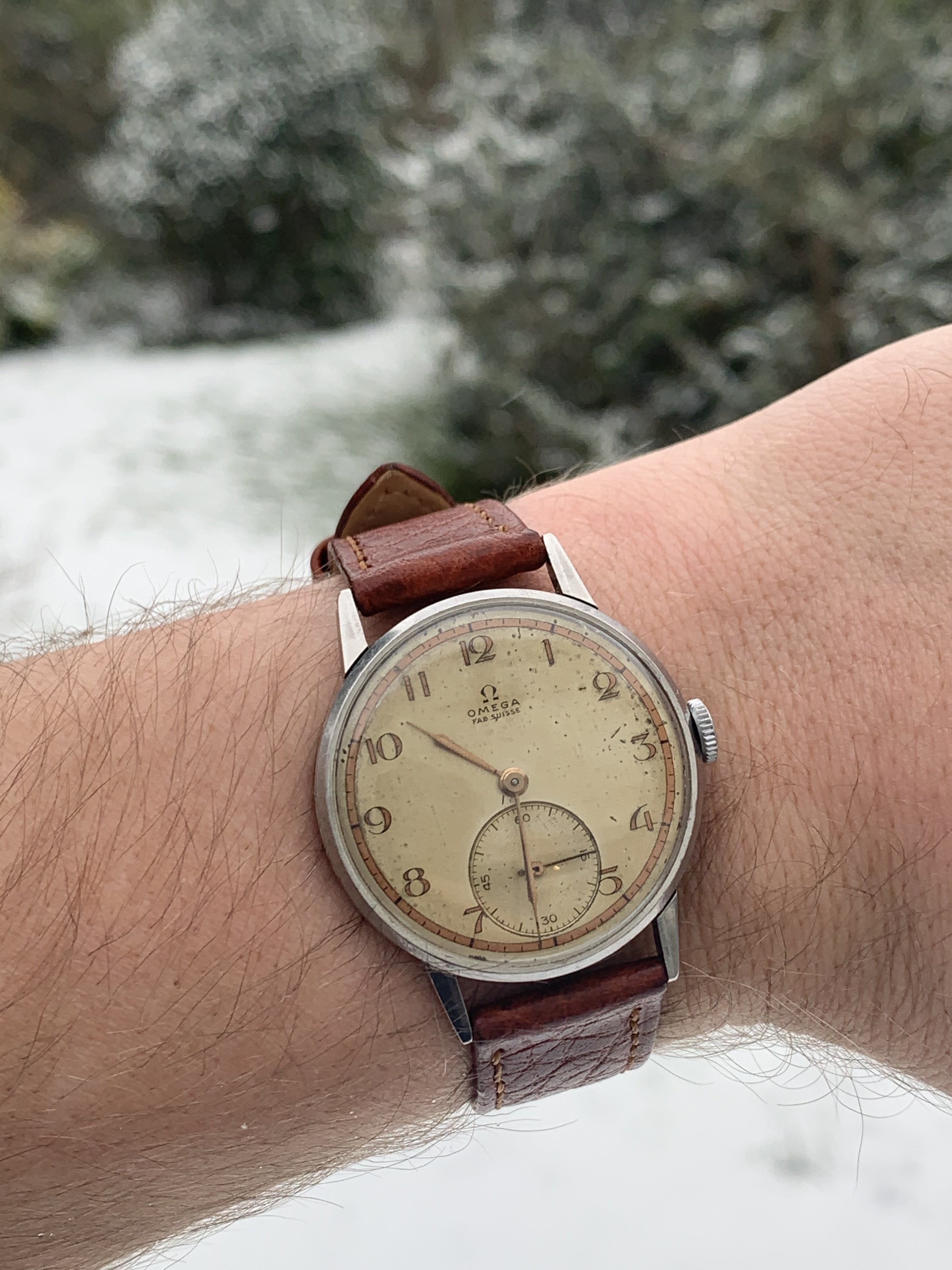

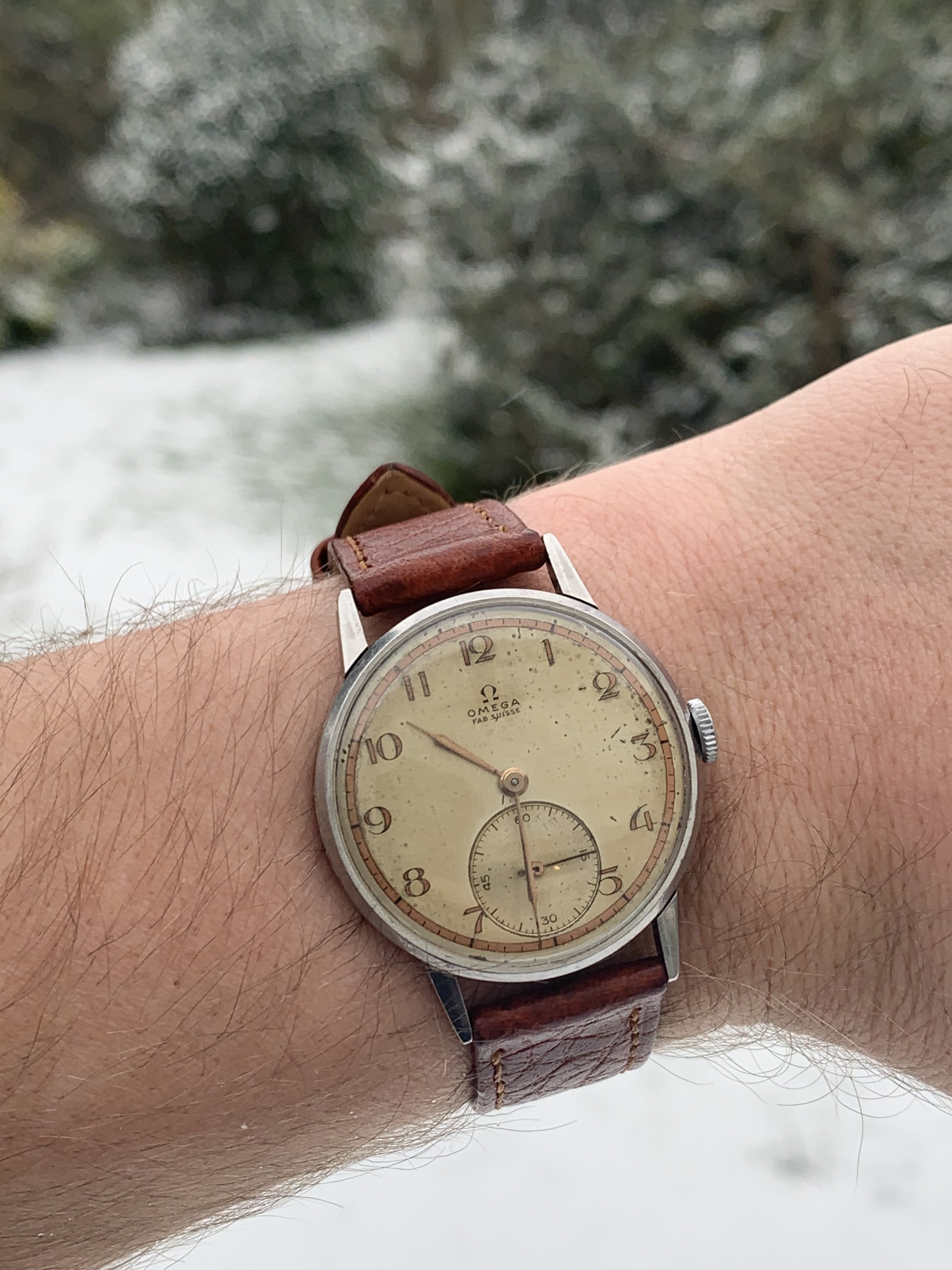

Looks to me like a 2271 case similar to my one, but with a gold case and a different dial. Characteristic of this model.
or could be a 2318 which is like this one, which would match the crown.

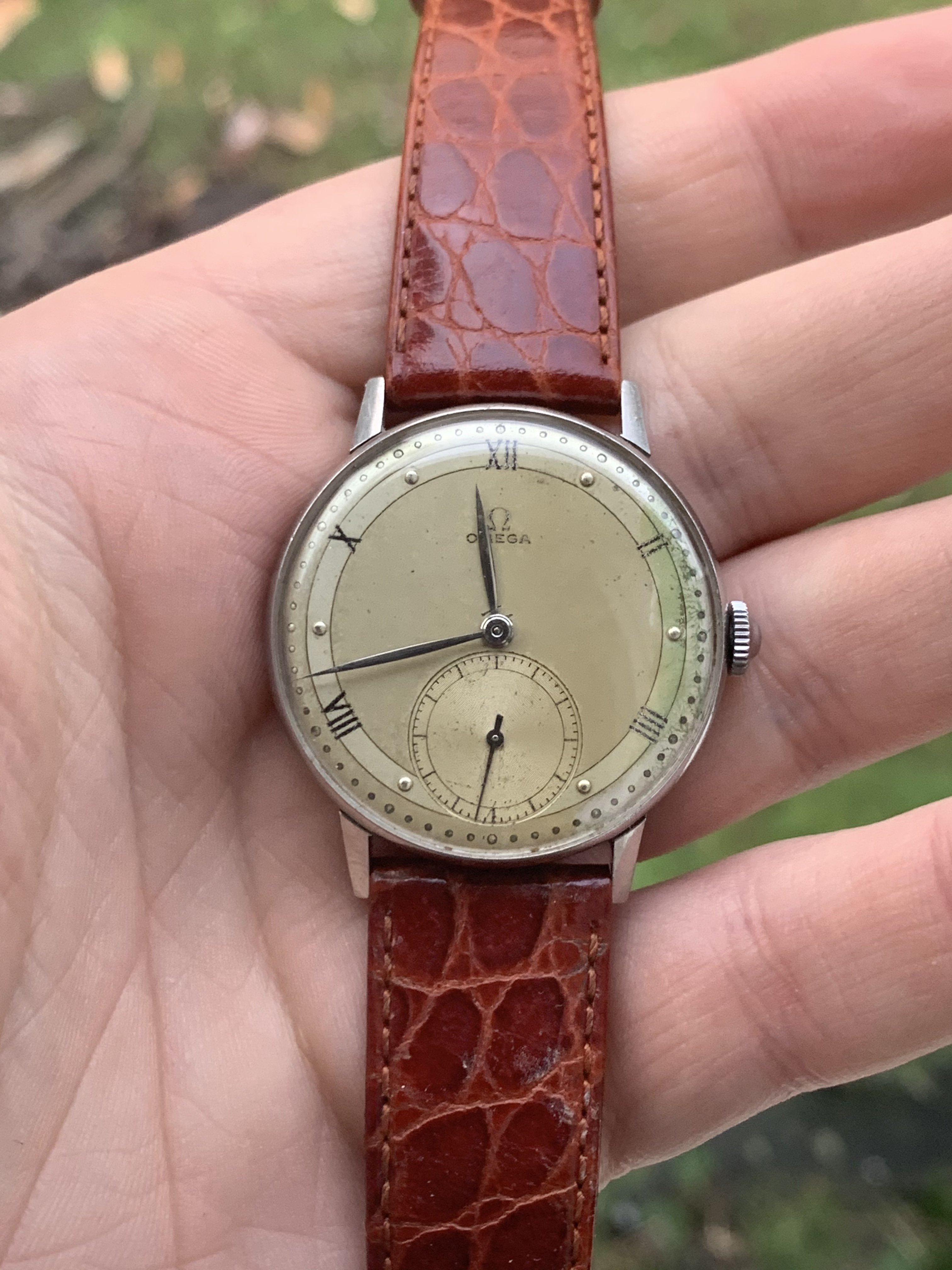

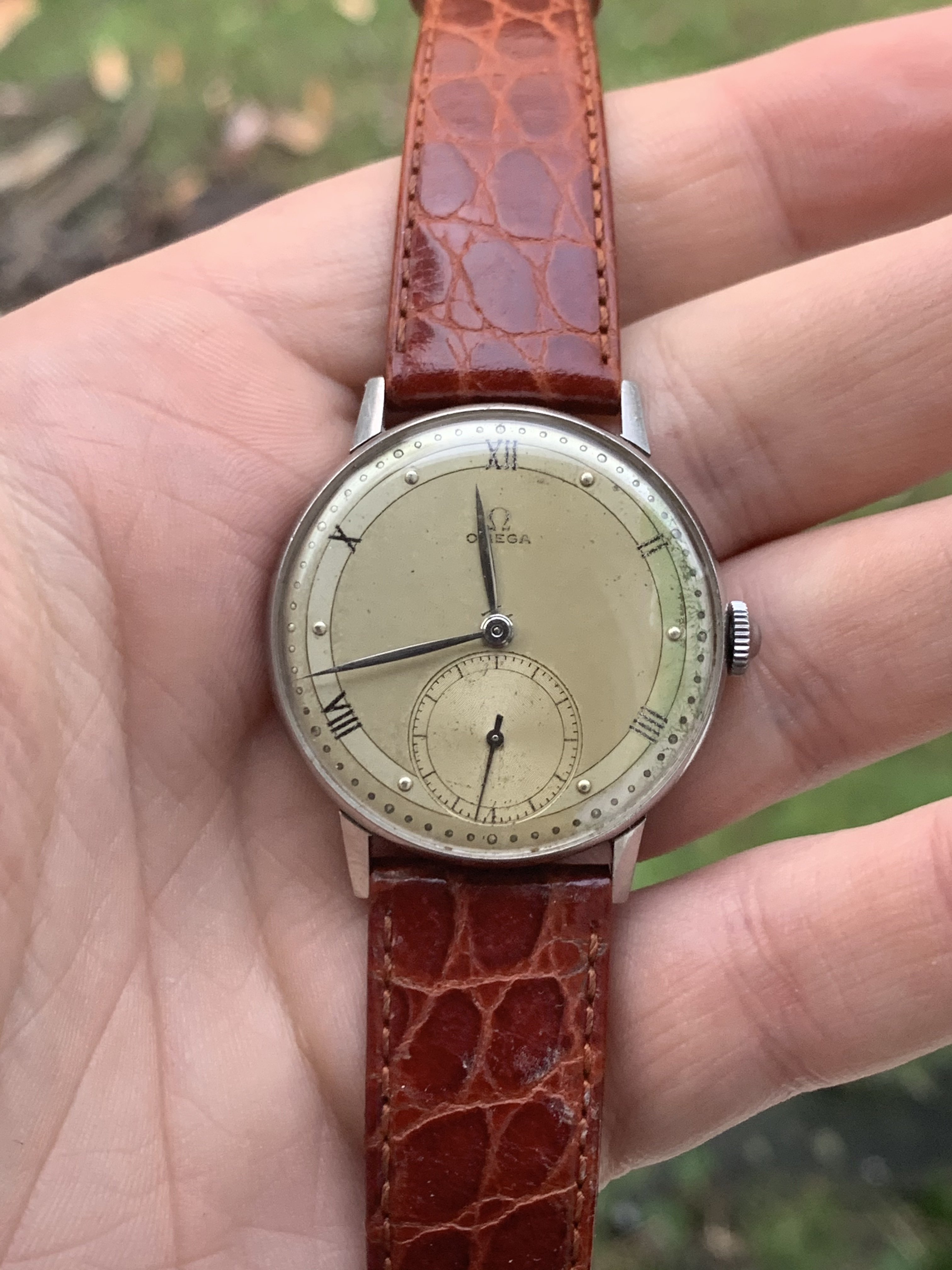

Very interesting! Mine is outside of that range of serial numbers. It's 8 983 xxx. Not sure what would be the difference if any in terms of design / components.
It would mean your watch had been part of the forst issue of the cal 30. It would not imply it has special components, but it mean something for collectors and cal 30 lovers!

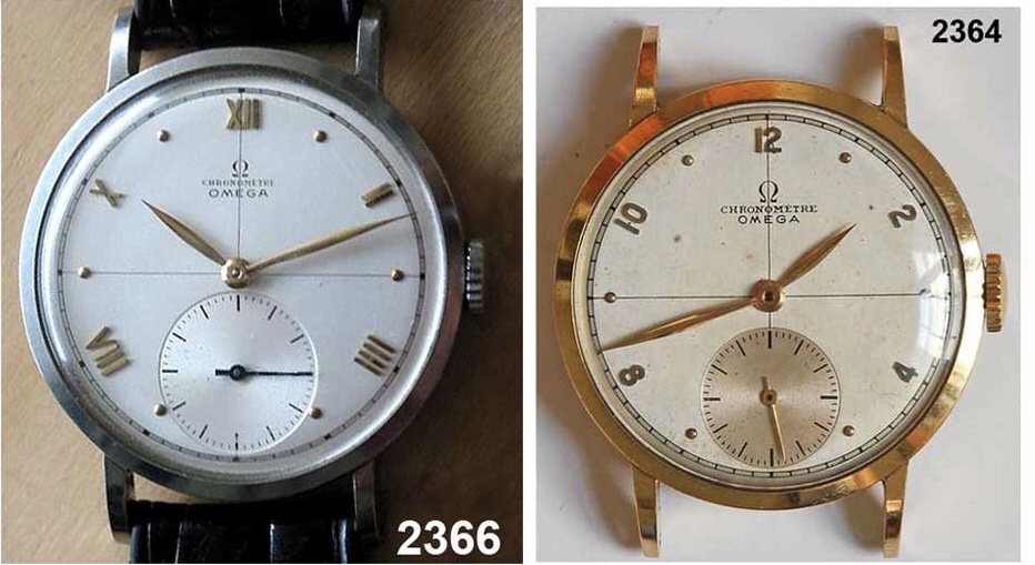

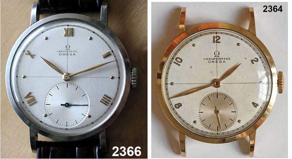

no, it is OT 2366
NOS? Unsold from many-many years ago? 馃榾 Never serviced - preserved since bought N and became OS ?
2366 and 2364 look very much identical - I noticed only one difference - 2366 has a thin line between "3" & "9", and another between XII and centre hole. Extremely sharp looking watch and perfect colour strap (both sides leather - same finish). I wonder why such great watches in 18k gold are often being sold for less than today's Omegas or Rolex in SS case?
Can鈥檛 comment on market tendencies, not my thing. But the large majority of those being sold have problems, in particular redials, sometime repaired with non chronometre parts, often lugs which have lost their sharp edges. Those in perfect conditions command higher prices.
The 2366 and 2364 have different case sizes, 35.5 vs 33mm. Consequently the dial diameter is different, and so the retaining ring. Another consequence is the position of the sub second dial, given that the seconds pinion has a fixed distance from the central pinion, but the diameter of the dials is different

The T02712 appears to be a later handmade marking. Usually, this kind of marking is softer, but your watch did not left the factory with it.
