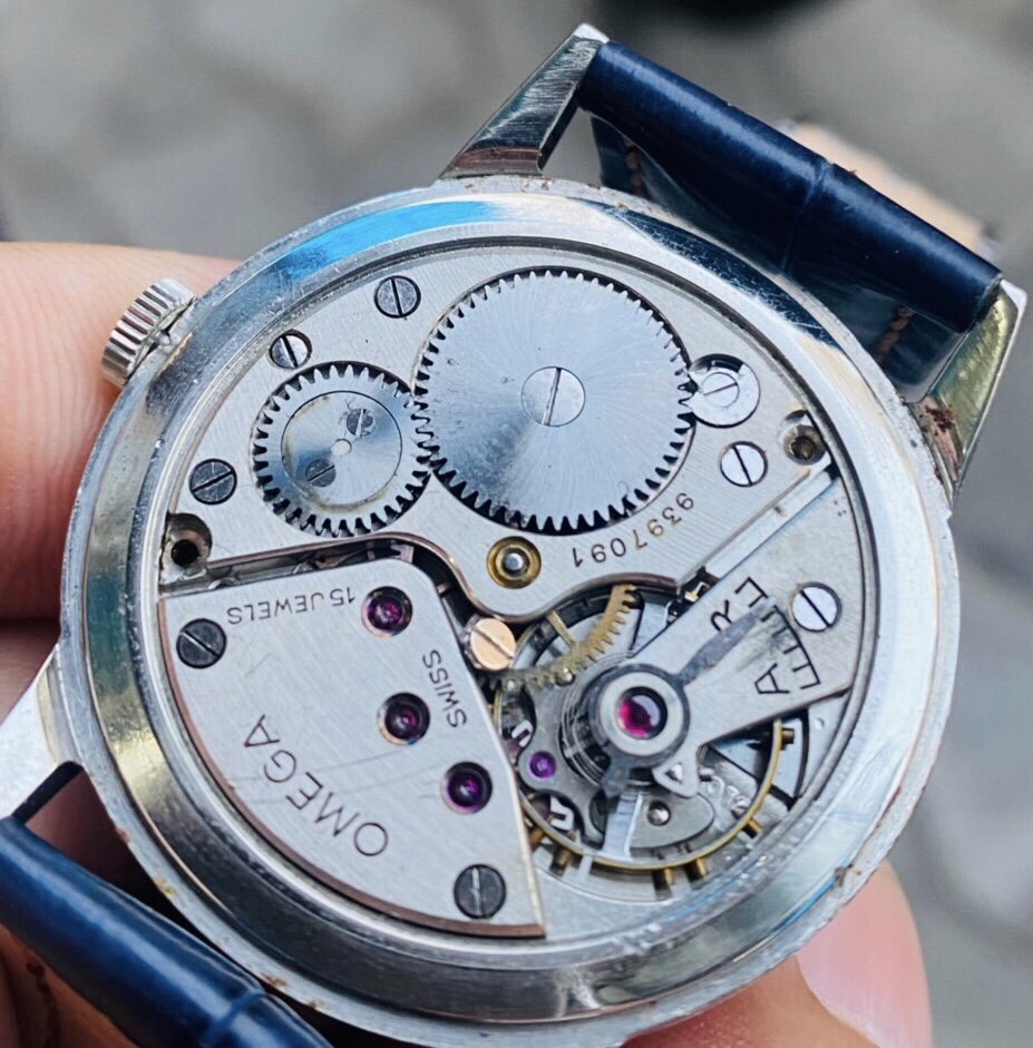

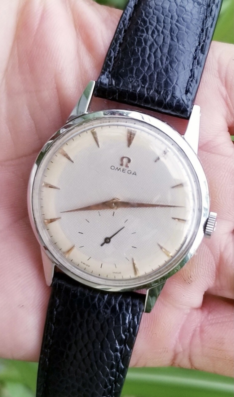

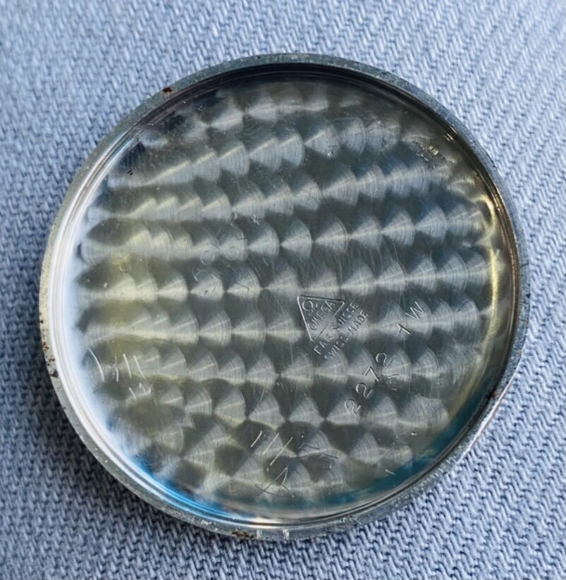

    People give me reviews about this omega 30T2. I am planning to buy this one. I want to know if it is original ?
    Thanks Guys

    1. I think the watch was redialled. The “Swiss Made” is too far apart for this particular model. Here is an example of a Ref. 2272 which I believe has an original dial:
    https://omegaforums.net/threads/omega-2272-10-jumbo-37-5mm.120274/
    2. Either the seconds hand is too small, or it is a replacement. Just doesn’t match up.
    3. What is that case screw doing in the middle of the movement?
    This would be a hard pass from me.
