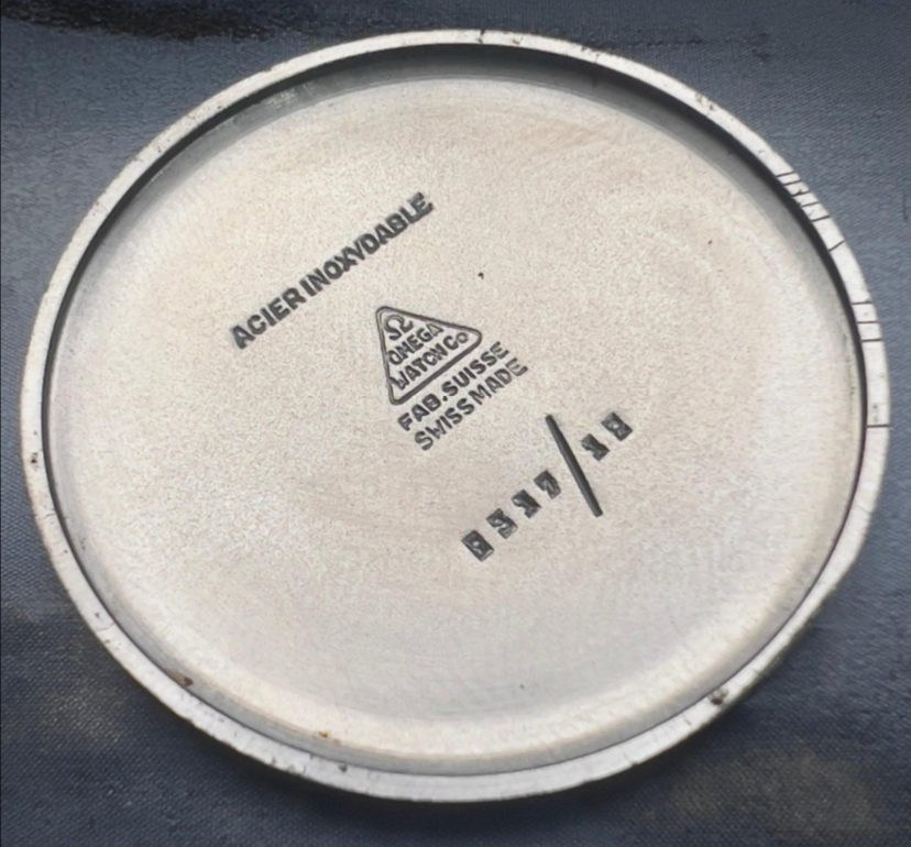

Omega 30T2 2317/13 (1947) fake or real?

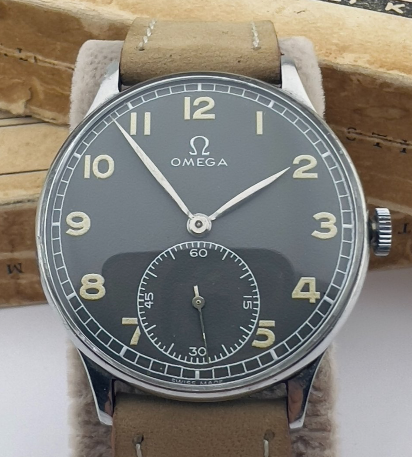

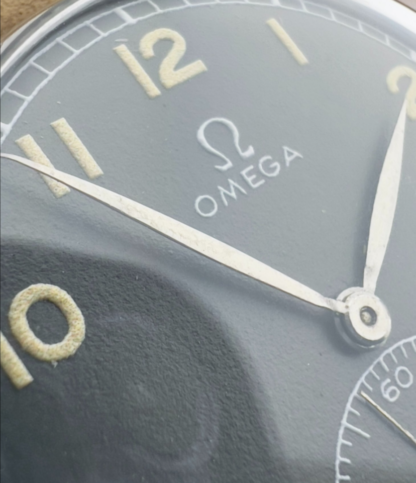

Would anyone here be able to help me out? I can’t tell whether this is the real deal or fake. I noticed:
- The hands are thin, whereas most (not all) contemporaries have broader hands
- The crown doesn’t have the Omega logo on it.
https://auction.catawiki.com/kavels/77922011
many thanks,
Jasper
8,285
29,302
Definite redial and replacement crown. I didn't bother to check the rest.

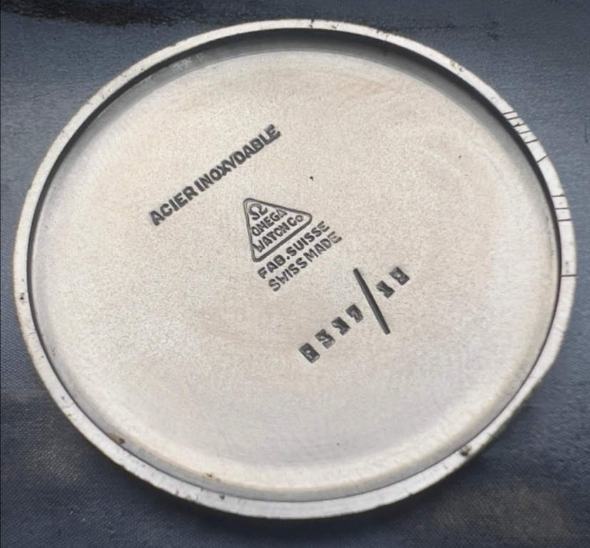

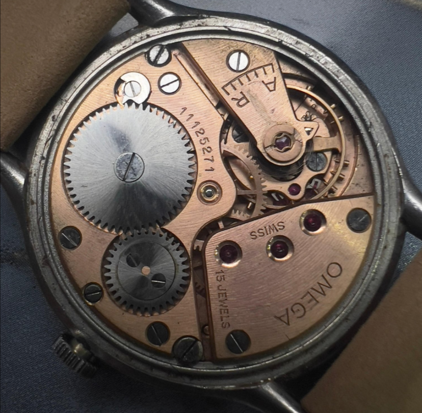

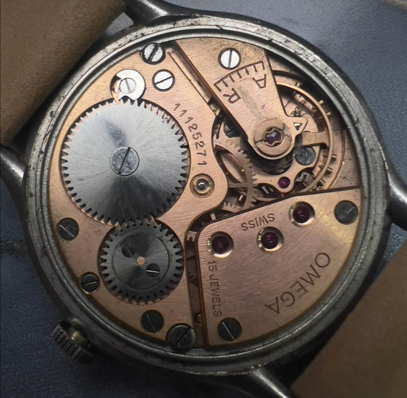

Thanks - very helpful. Any observations on the authenticity of the mechanism? The serial number appears to check out.
