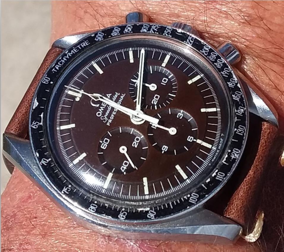

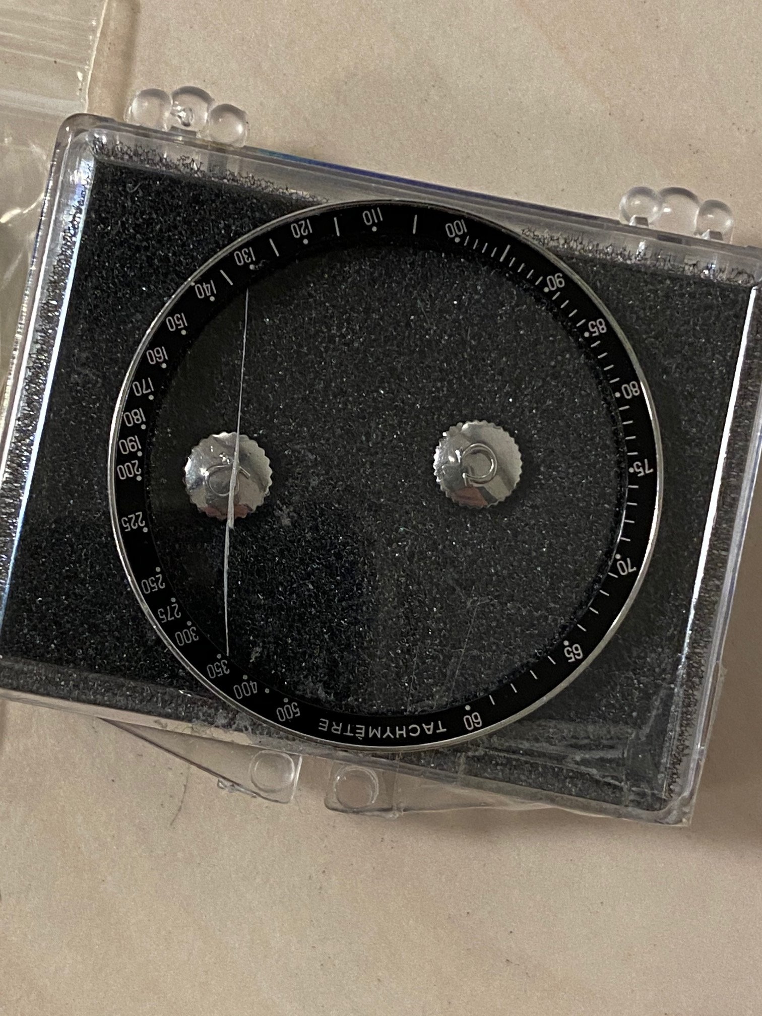

Hi all,
I've been following this forum for a long time reading about vintage Omega Speedmaster.
I recently had the chance to acquire an Omega Speedmaster 2998-6 that would require some repair/upgrade.
As you can see from the pictures, the obvious things would be:
1) poor bezel: I have a replacement bezel, would you recommend to replace?
2) incorrect crown and (I think) pusher: I have a replacement crown, pusher buttons should not be too difficult or find
3) alpha hands: guess not much to do here?
4) chrono hands: the one on the right has probably been replaced. Should I replace the other two as well?
Please note I am not an expert.. Just a newbie, especially on vintage Speedmaster so any advice on what would be better to do it would be really really helpful.
I did read a bit here on the forum as mentioned and also looked into Speedmaster101 but just want to get your opinion before to do anything!
Thanks

Hi,
It's a really nice Speedmaster you have here, congrats !
I would only change the crown (the one on the left on your picture seems appropriate).
Please, don't put the service bezel on this watch...
Once more, this is a very nice Speedy with what looks to show a stunning dial 馃グ
Regards.
Dr R.

Don't know how much $ you are into the watch for and this could be a deciding factor in determining how much you spend. A poor condition 2998-6 still sells for 8k and yours is somewhere between poor and fair.
1. The bezel insert you have is incorrect, it will cost you another 2k+ to find a decent looking insert and more for a very fine one.
2. Crown...replace with the narrow flat feet, pushers might not be as easy to find as you think, but, time is on your side.
3. The alpha hands, I would relume... and generally, I'm not for reluming, but, in this case relume
4. Replace the other chrono counters to match.
5. Leave the dial alone.
6. Case is over polished, but leave alone.
If you can get the hands looking better, the right insert and the right crown... it will look ok and definitely something you'd wear. It's a great watch and highly collectable. If you decide to just replace the crown and leave the rest as is... it's got character. Your decision ultimately.

@Marsimaxam thank you very much for the detailed explanation 馃榾
Whether I am only going to change the crown OR I go for a more extensive overhaul (bezel, pushers, relume of hands, etc) depends on the total cost of doing so and whether the money put into this would eventually lead to a more desirable and valuable watch, just in case in the future I want to trade/sell this watch (I might be very calculative on this but it is a factor to consider I think).
Probably there is not a correct answer for this, but at least I have some $$ to work with in terms of how much a more complete overhaul would cost.
Personally, I feel the current bezel could be replaced as it is in a poor condition. Regarding the bezel for sale on eBay you mentioned in your comment: would you say it is in "decent" conditions? Given you mentioned 2k+ but this one is below that amount (albeit slightly).
I suspect the replacement bezel I have is suited for a mid-90s speedmaster.. The watch came with it so I am probably just going to sell it.
Small pushers at 250$ each, not cheap! I thought I could find them at much cheaper 馃
As for reluming, seem there are always very different views... I find your suggestion makes a lot of sense. I might ask for a quotation to James Hyman in the UK, even though that would mean I need to ship the watch as I live in Hong Kong, unless someone else has a better suggestion.
Would be interesting to hear which material would he used for that. Given this watch should have a radium lume, with a very small chance of it being tritium given Omega seems to have transitioned from radium to tritium around 1962/1963..
Cheers

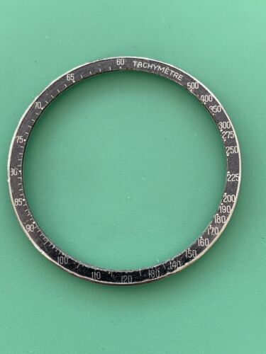

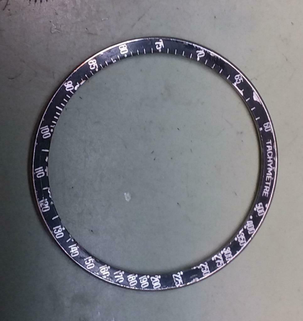

Searching online for a DON Bezel Dot Over 90 I found the below example. Does it look legit? The dot over 90 has been erased by a chip, while the dot under 70 looks fine, but other than that, not sure..
Thanks
This is how it looks on the seller's watch
Cheers
Thanks
Cant see any point in spending lots of money on a replacemeNt DON bezel insert, if you cant see the dot !!!!

Personally I would trade up for a nicer don and get correct crown and pushers. I would hold off on the hand relume and live with the watch for a while before making that decision.

@Marsimaxam
This probably shouldn't be a major factor in your decision. Any improvements you make to the watch will increase its value, but not typically by more than the amount that you put into it. You could spend a few thousand $ to improve the watch and the value will increase by a similar amount. Maybe slightly more, maybe slightly less, it's really impossible to say. I'd suggest that you make your decision primarily based on what will give you the most enjoyment in wearing the watch for the time before you sell it. If you are really looking at this as an investment, you are probably going to be in for an unpleasant surprise, since it's not easy to sell a watch like this.
Of course, you may have budgetary limitations as well, but you haven't indicated how much you are willing to pay for restoration.
Personally, I agree with @Seaborg. Get it cleaned up, replace the crown, and enjoy wearing it.

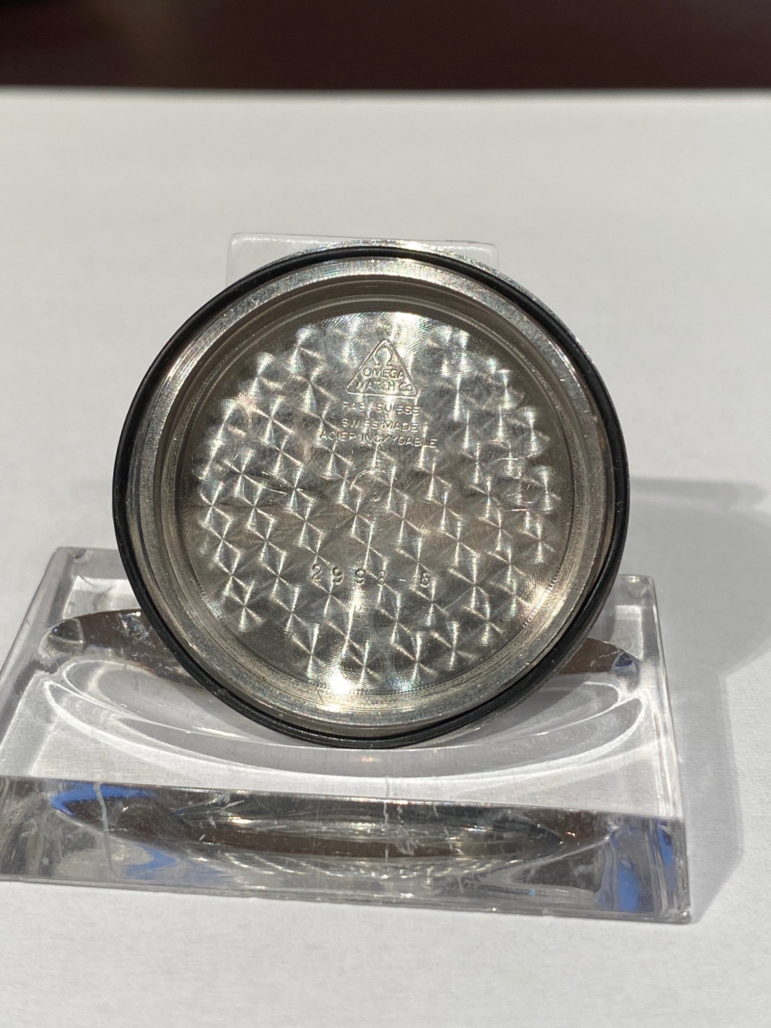

We have not yet seen the movement, case back (inside and out) dust cover or the SN. That鈥檚 important info upon which to base a decision on how far to go. Inclined to agree a cleanup and a crown is where I鈥檇 be. Pictures always highlight battle scars, I鈥檒l bet to the eye, this is more pleasant to look at. Dial looks great.

Before you do anything you need to open that watch. If the numbers inside check out, there is a restoration discussion. If not, this is all moot.
The watch has a later movement: the original 1962 cal 321 movement was replaced with a 1968 cal 321, in good condition. Would you not restore it because of that?
To be fair, if I need to pick, I prefer a nice dial and a later movement to a bad dial and a movement from the same year. Then of course I prefer a perfect watch to an imperfect watch....
