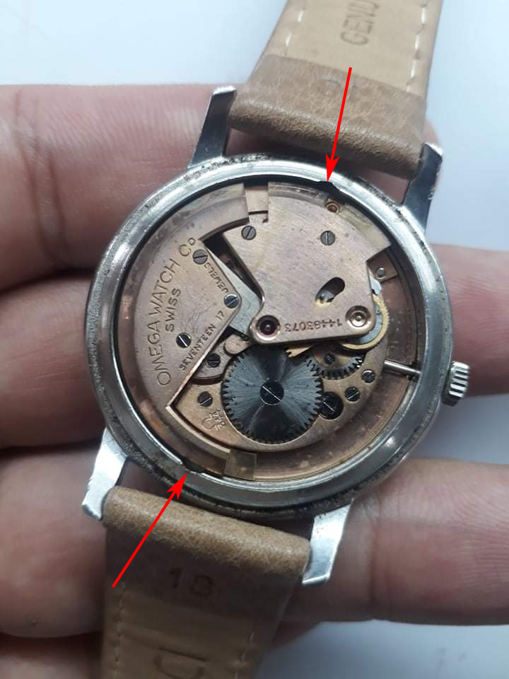

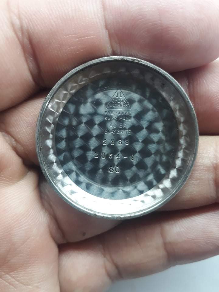

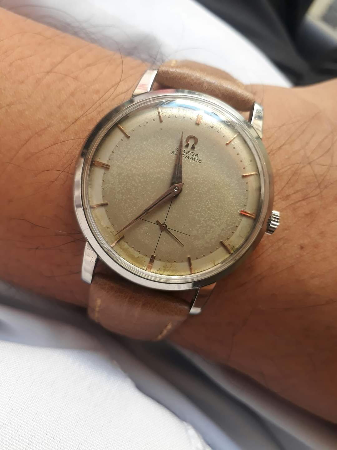

Can anyone confirm if this is a frankenwatch? From my limited knowledge SC refers to a center seconds hand. But this one has a subseconds instead.
24,836
55,255
Both of those references use rotor wind movements, 491 and 501 respectively.
Note the case has two notches for movement clamps.
Yes, indeed. I was so focused on the sweep vs. sub-seconds that I didn't even look at the movement. That's funny.
