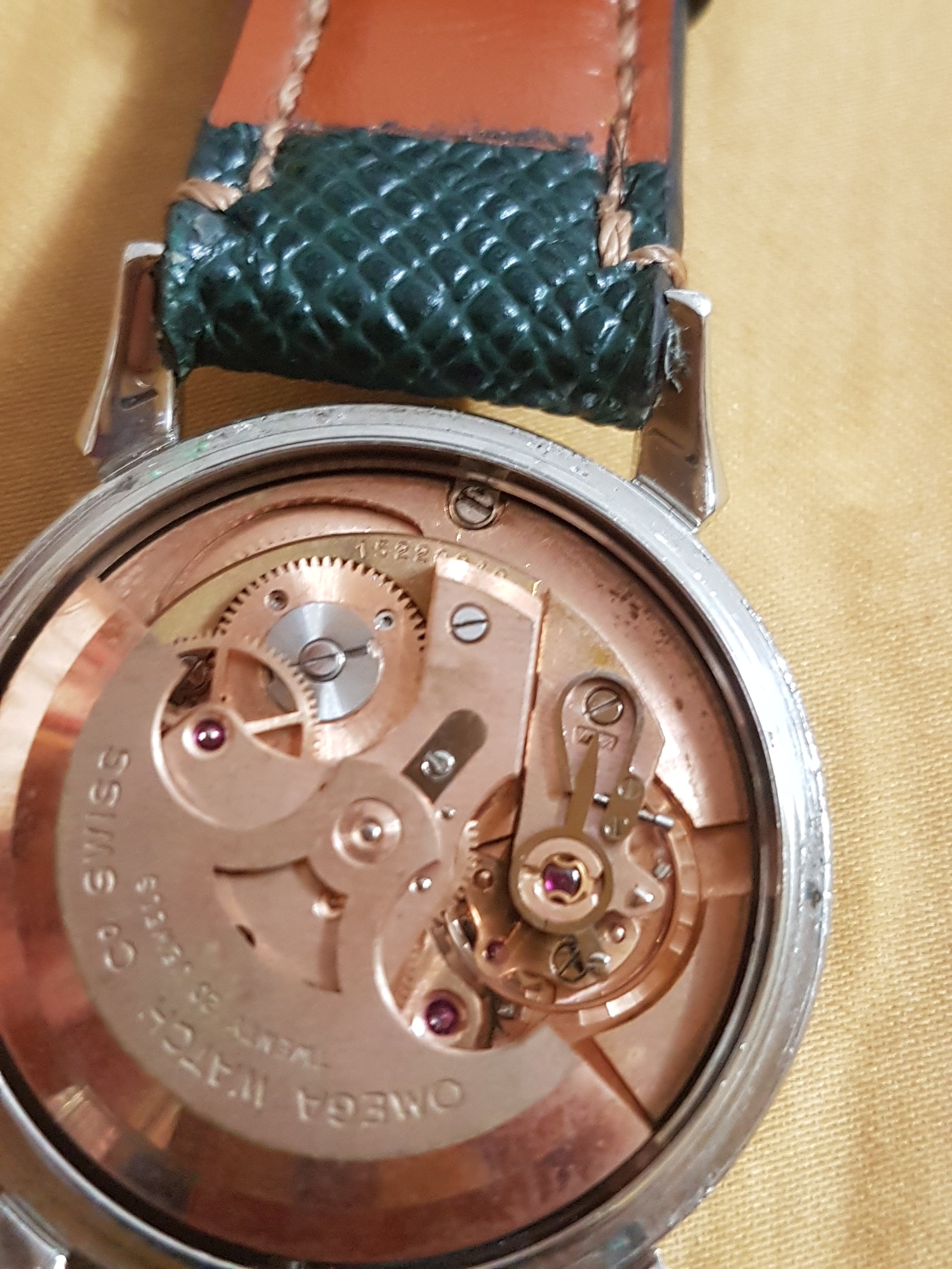

The subject watch as shown in the watch cleaner basket has not had the auto winding mechanism dismantled, the manual wind mechanism dismantled, minute train removed, or the crown wheel removed! Don’t let the sender convince you to pay a premium for the “service” this watch has received. It will need to be done again, and there is a possibility that parts might be required. Faulty or worn out parts not identified because of the sloppy repair job. In fact, I would suggest you walk on this one!

It does to me but also heed what Canuck says, he's a watchmaker.
I’m listening to everyone! I really appreciate the help everyone is giving me! Really don’t know what to look for atm. Trying to research but sometimes you just need the opinion of the experts

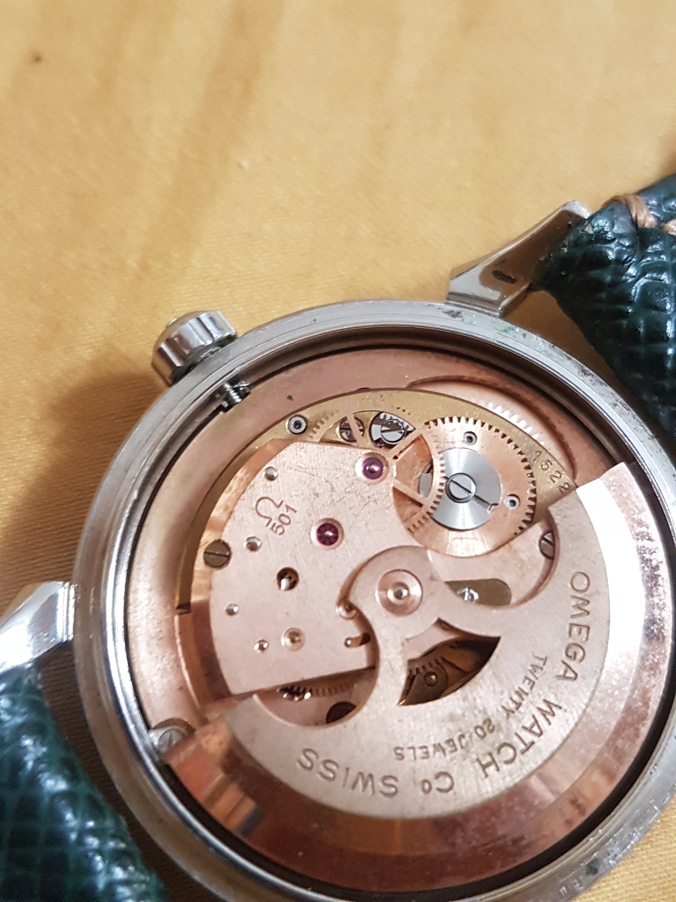

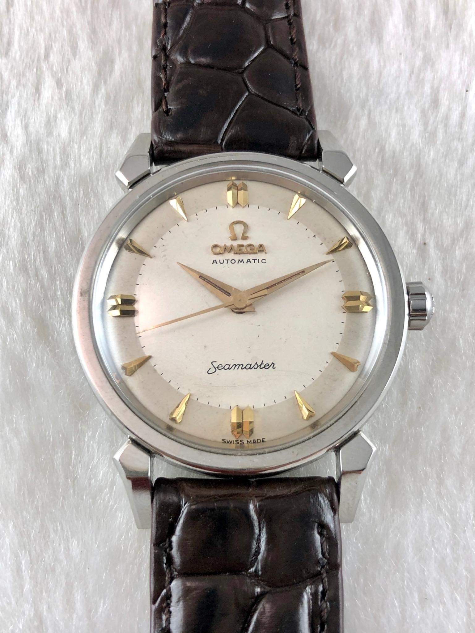

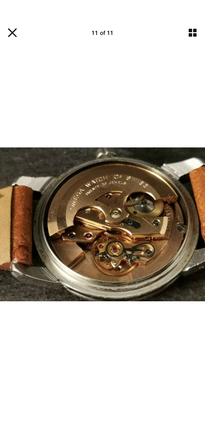

You see that fancy gizmo attached to the regulator arm? Omega thought that movement was capable of keeping very good time, so they added a micrometric regulator (fancy term for "fine adjustment"). That's a bonus if that's the steel Seamaster.
Yeah that’s the silver one. Does everything look alright to you on that? I know the dial and case are rather battered but I don’t mind that look to be honest.
