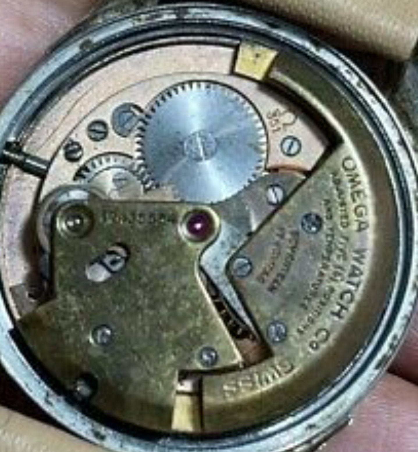

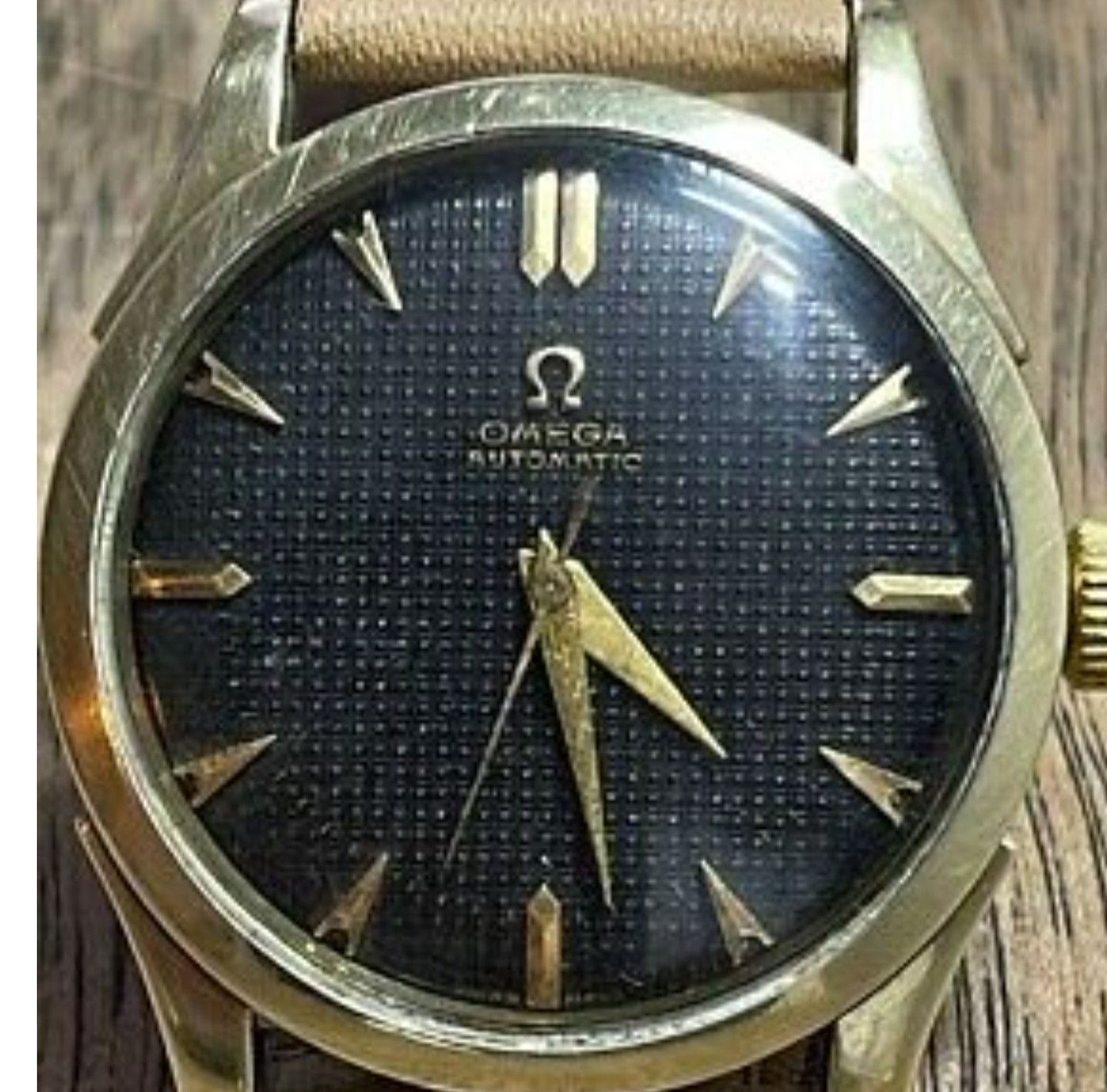

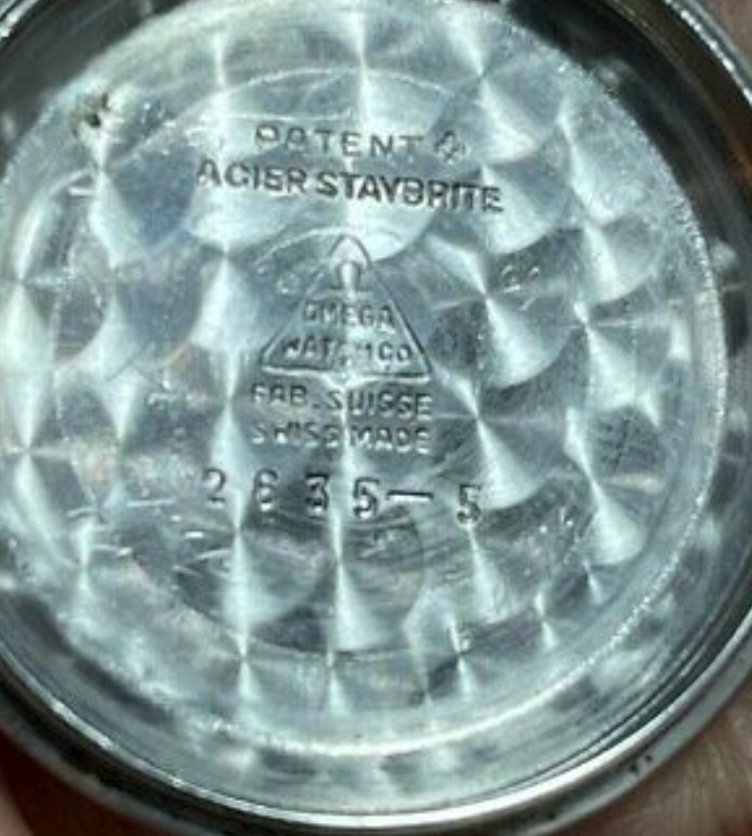

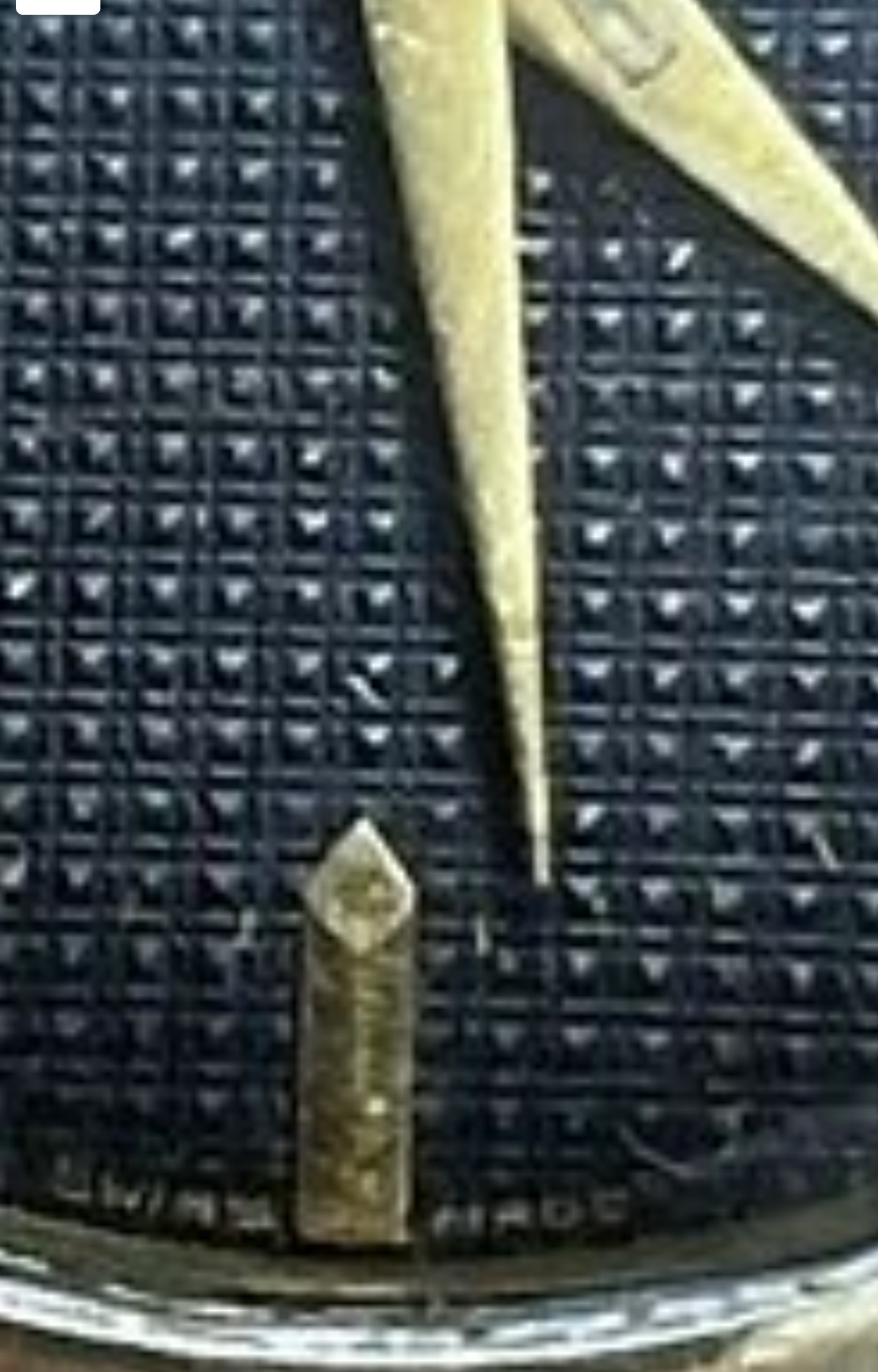

I found this Omega 2635-5. I m not sure it's original or not . Need advise!
The pictures are not clear enough. But that s what I have .
Thanks !

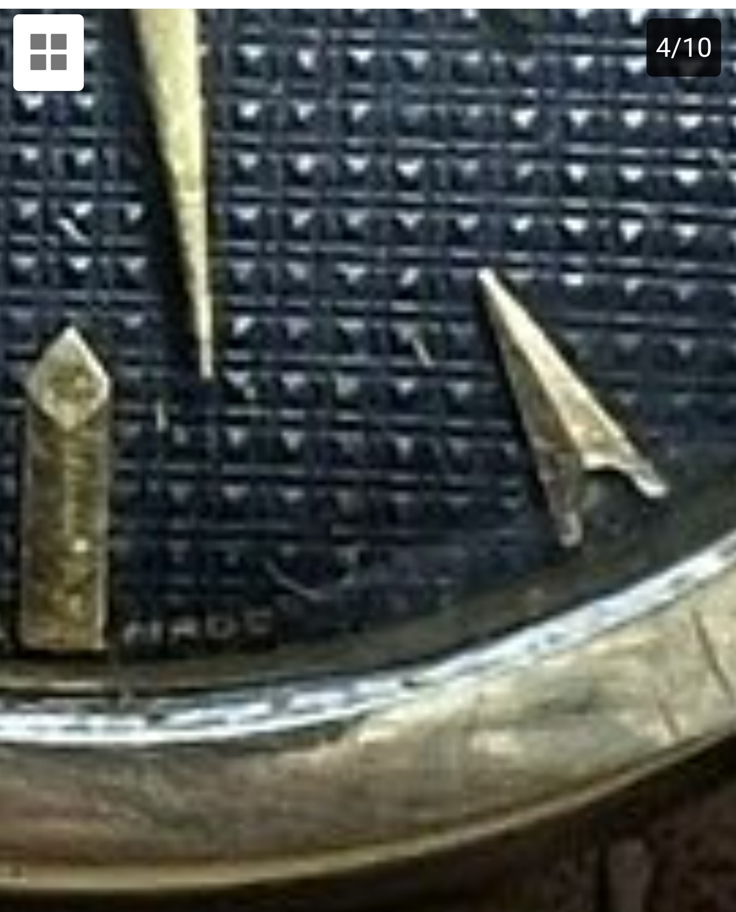

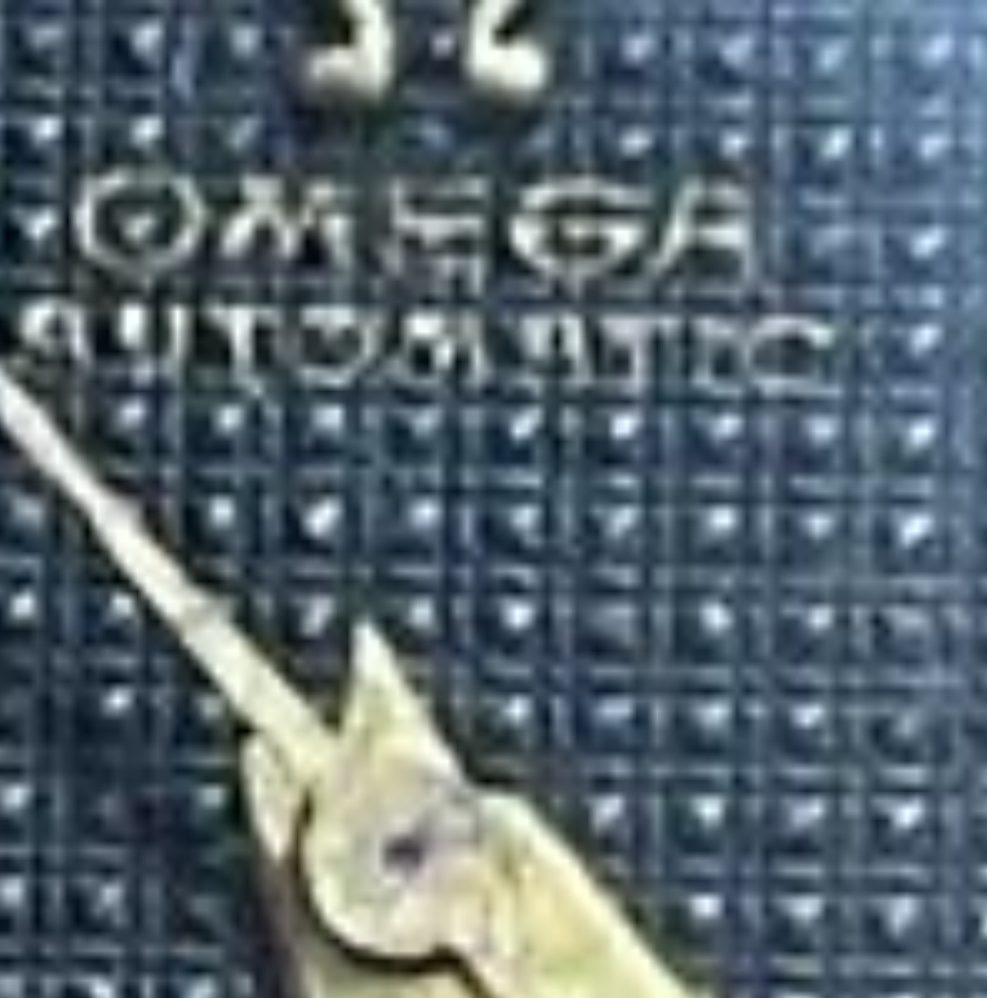

Hands don't have lume? Wrong hands.
351 with 5 position adjustment rotor? Frankened movement.
That the only two I can find in 2 minutes.

Could be a nice project though starting with the dial...depending on price of course
101
56
I thought the same as the dial is OK. I can find a Cal. 351 donor watch and swap the movement and hand.
The price is $425. What do you think?
