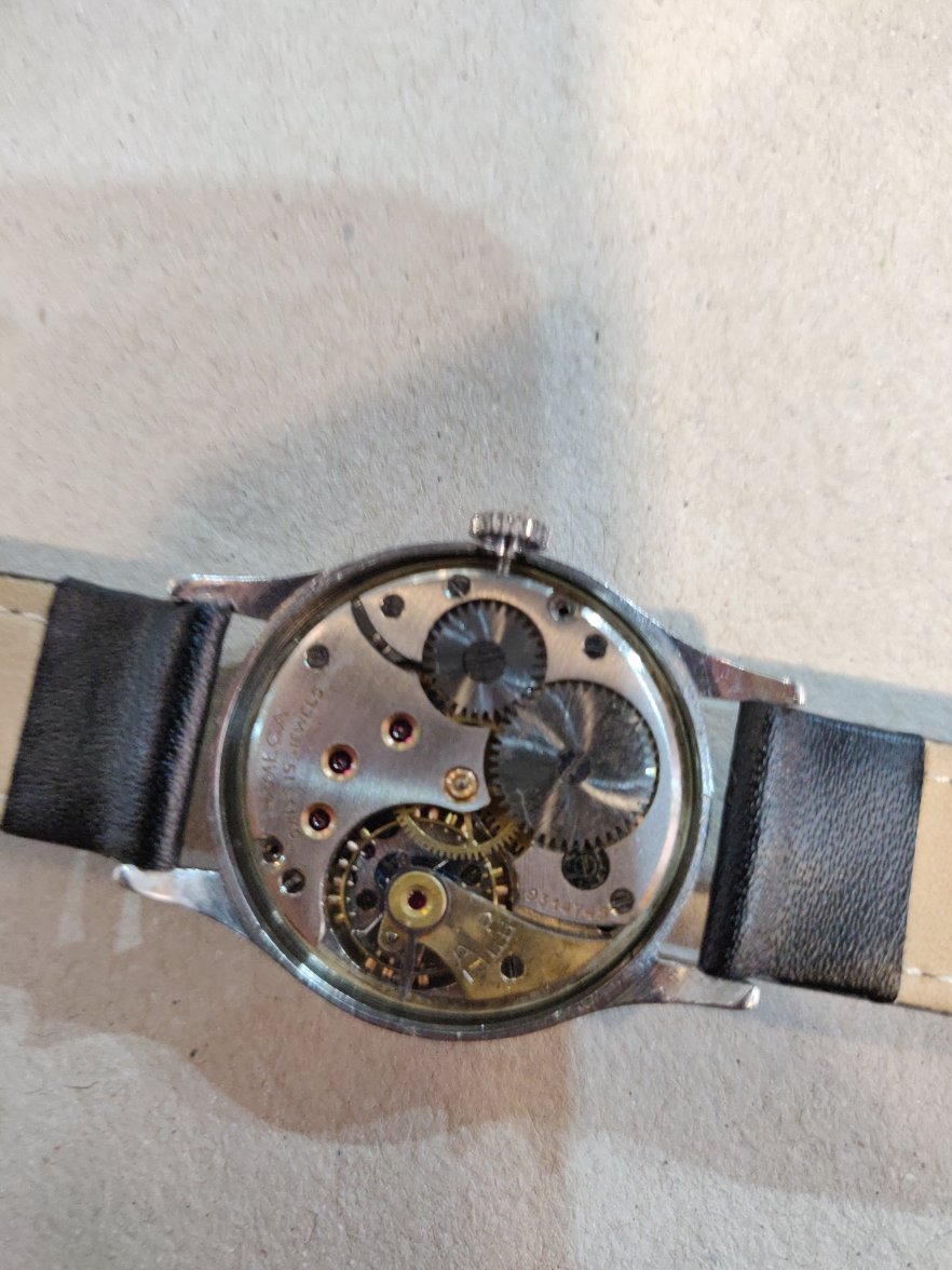

Hi gents,
What is your opinion about this one?
I only took this picture and I know that the caliber is 26,5.
13,490
31,809
Probably real but dial refinished.
Caliber 24.5?
5,708
9,502

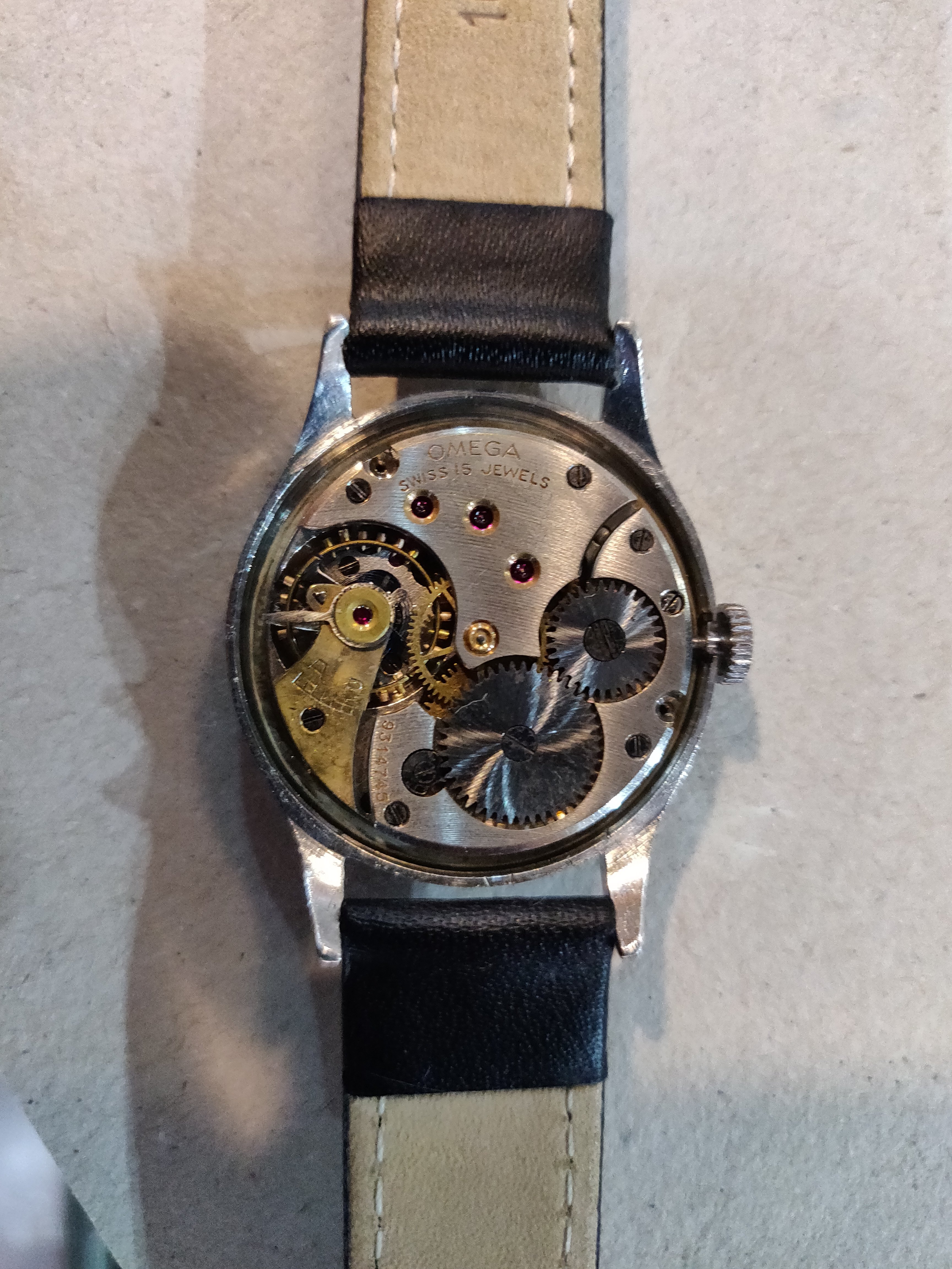

Repair bill will be coming up. Look where the regulator points to.....
28
8
26.5 SOB, T1, T2, or T3?
I don´t know.
and what is the three- or four-digit number in the caseback?
The situation in here is I´m in the point of buying it, I´m just waiting that the cover back came from chrome plating and then I´m thinking to buy it but I would like to know if it´s a good buy or not?
I can realise from the comment of the "watchyouwant" that I might have some costs already and I would like to discuss that with the watchmaker before I buy it.
If you can tell me more about It from the pictures I will be thankfull for that.
Thank you for your help.

That depends entirely on the purchase price and how much you like it. It wll need to be serviced, which might get expensive.

The regulator arm should be somewhere near the middle of the scale between A and R (avance et retard en français). That it is so far foward implies that there is a lot of wear in the system and it needs major work.

Even if it only costs you $1, it will be a money pit.
It has no collector value.
The movement is in poor physical and aesthetic condition.
It has been re-dialed.
It will need a service ($200 to $500, depending on your location).
It has no shock protection, therefore must be treated with greater care than a "modern" vintage watch.
It is probably no longer water resistant, therefore risk of further moisture damage.

About the only thing you could do with this thing is pay Omega $1500 to restore it, because they would remanufacture the parts.
$1500 can buy you a reaaaaally nice watch.
Don't know why you seem to have your heart set on this one unless you've already paid for it?

Yes, he might have "serviced" it, cleaned and oiled, but plenty of indication that is all he did.
