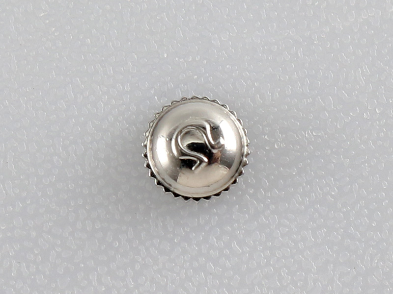

You'll note that the crown appears to be a clover, whilst I am sure these are supposed to be like this:
Furthermore the second hand appears to not be original.
Could anyone advise the part numbers for the second hand and / or the crown or have any available that I could buy? The crown that is referenced on cousins appears to be the clover type crown, but this is as far as I am concerned, not correct for this model. Furthermore the second hand shown is only a steel version not black.

Or if you don’t know part reference numbers is there a general term to describe this type of crown to aid my search? Thanks ☺️

Crown might be early enough to be unmarked and whatever you can get from Bestfit or similar would work.

Agree, you should just get a plain unsigned bowler crown. Do you have a serial no. for settling production year, Oliver?

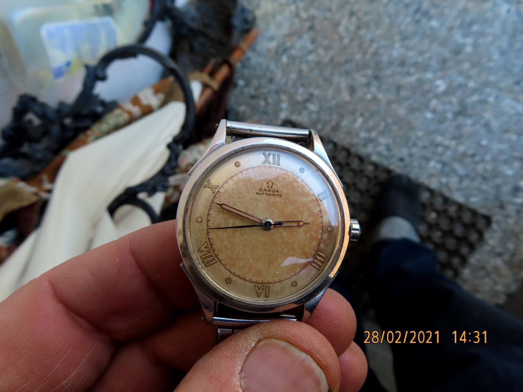

That’s a nice one, looks like it was posted on the « Roman numeral » thread? 😉

If you read my first post, I did check two suppliers and they’re both specifying the clover crown. I presume this is what Omega now suggest we use for this model, however through my research I generally only see these with this bowler hat crowns (thank you @Dan S).
Also neither of them reference a black hand for this model and only have a steel coloured second hand listed which of course would not be appropriate for this example.

Yes that is what I found, but it’s the wrong shape 🙁 as I said in my first post they’re specifying this crown which is a clover shape not the bowler hat style.

Yes, because that is Omega's current replacement. The "bowler hat" crown isn't made any longer.

Bowler hat crown 😁

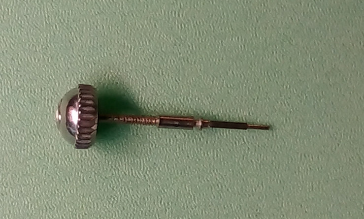

I would need to check tomorrow as this looks like a 550 series stem to me but I think the 330 stem thread is the same. This one is used and I'd need to see the seal but, as it's old, you couldn't guarantee water resistance with it. Apologies for the poor photo.
Is it what you're looking for? Diameter is about 5mm.
