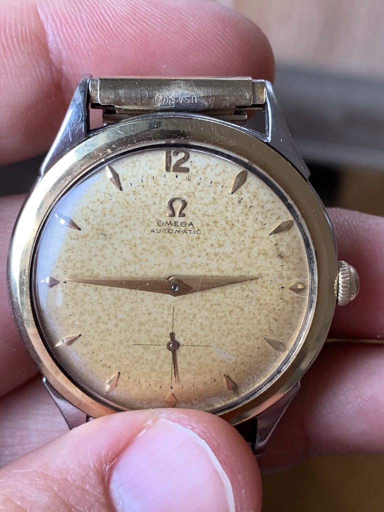

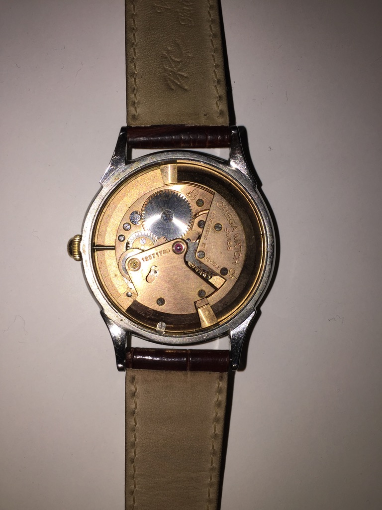

Got this omega 2515 with a 332 cal and a non-chronometer dial, and not the 333 as the 2515 chronometers does. I've only seen one watch online with the 2515 ref, non-chronometer dial and a 332 cal, but plenty of 2515 with chronometer dials and 333 cal.
Is there anyone else who has seen an omega 2515 with the non-chronometer dial with a 332 movement similar to this one - and is this a legit watch? Does the 2515 ref exist with a non-Chronometer movement?

I believe all authentic ref 2515 would be chronometers.
