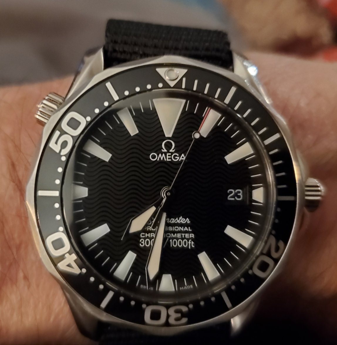

I recently received my 2254 back from service from OSC Miami and it’s looking very nice after complete polish. The service card that came with the watch said it was regulated to +4. Its not running anywhere near that. On the wrist it runs around -1 to -2 per day. If I put it on the winder, it’s worse at around -5. My concern is that it will only get worse over time. Should I send it back for a recheck? The reason i sent it in for service in the first place was due to it running slow.
