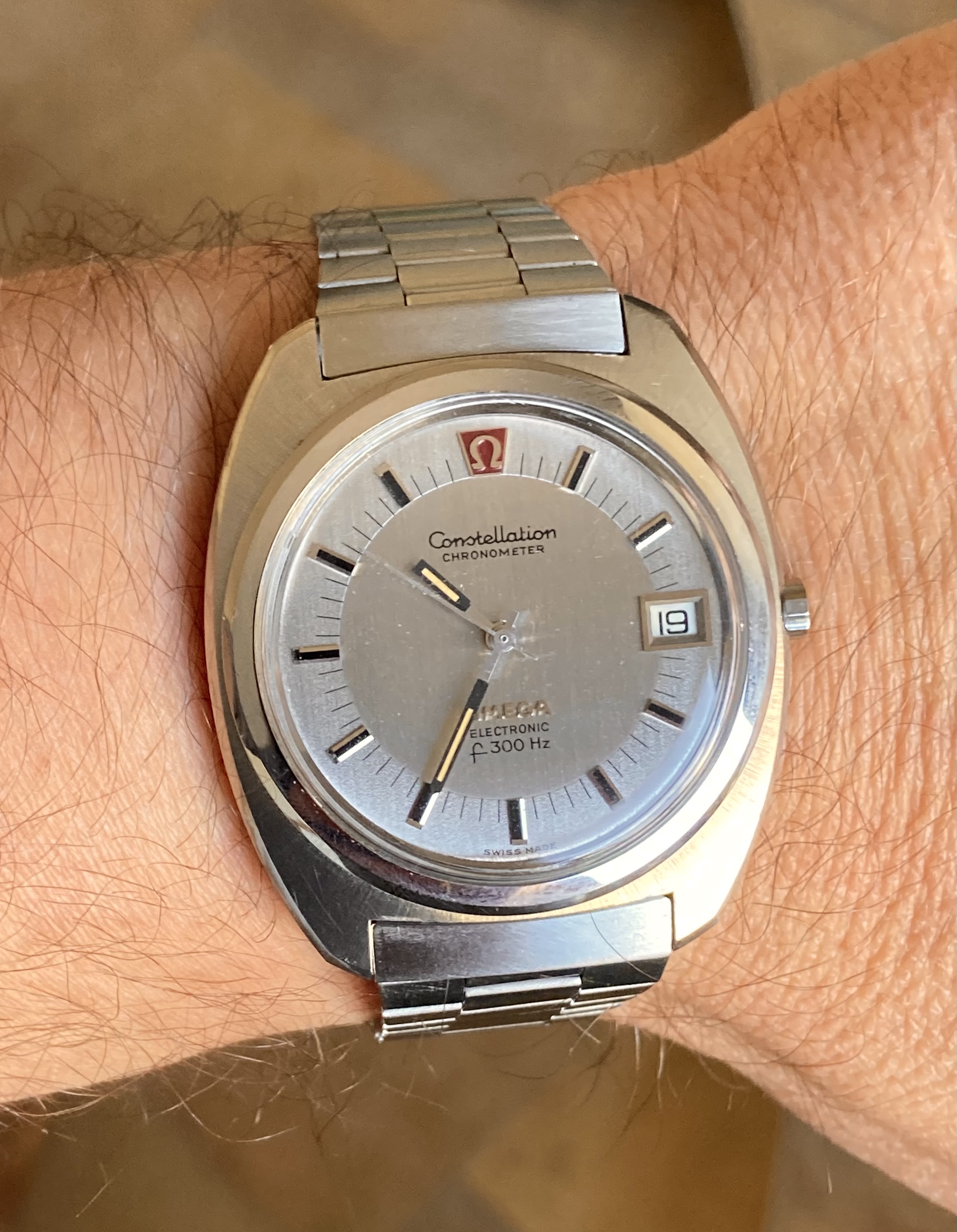

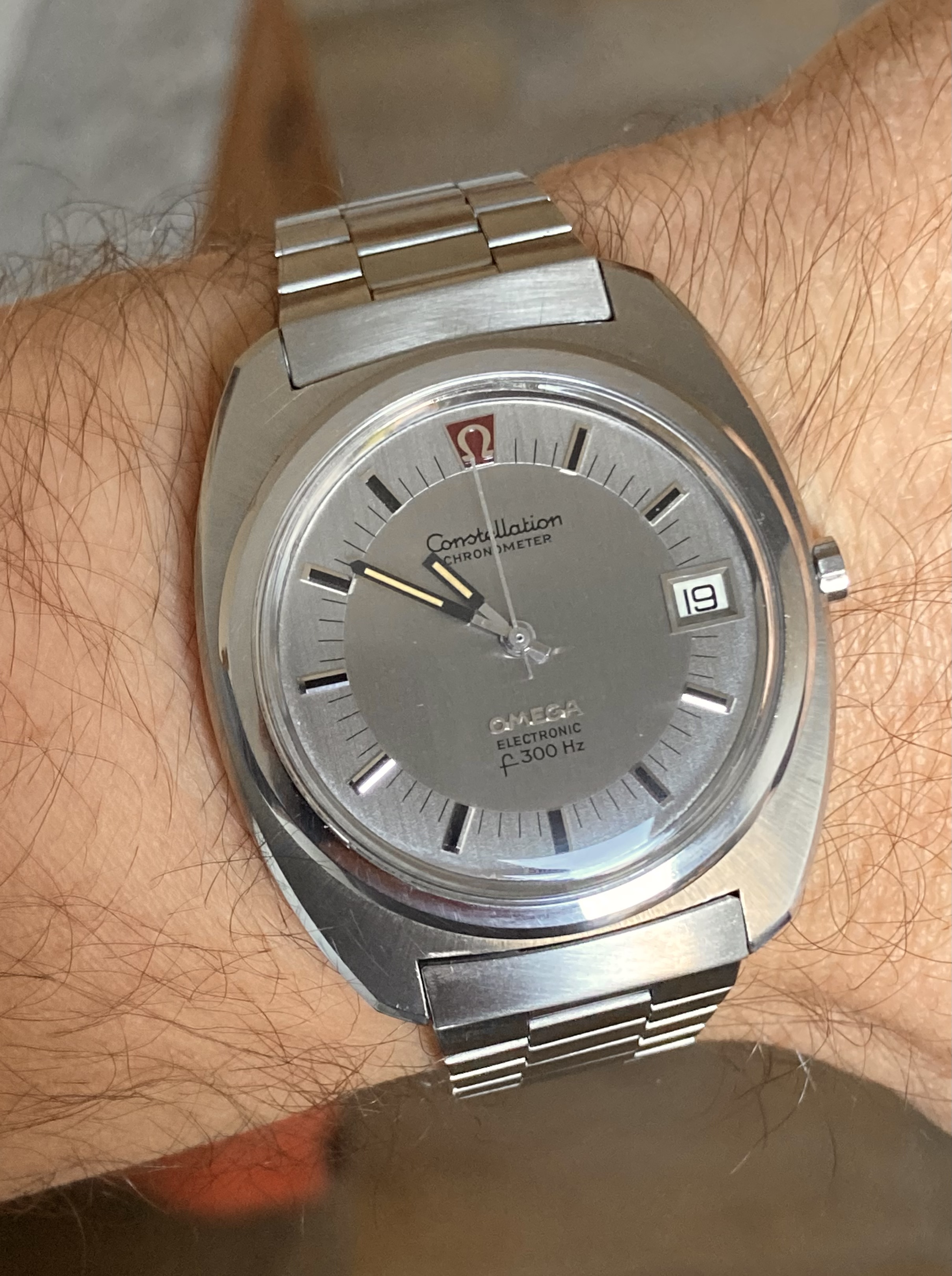

Hi friends,
I have this beautiful Omega 198.002 that has just been serviced. Now I am thinking about getting a nice bracelet for it. According to my research it will need 647 end links and came with the 1175 bracelet. I found 647 end links on ebay for a reasonable price but I don´t want to spend a couple oh hundred euros on a vintage 1175 (even though I´m sure it´s worth it). So I thought about fitting a Uncle Seiko bracelet to the 647 end link because I have allready a couple of them...
So can anyone tell the exact measurements of the 647 end link hole (to fit the male part of the bracelet). Or even better: has anybody tried something like this and can give me support?

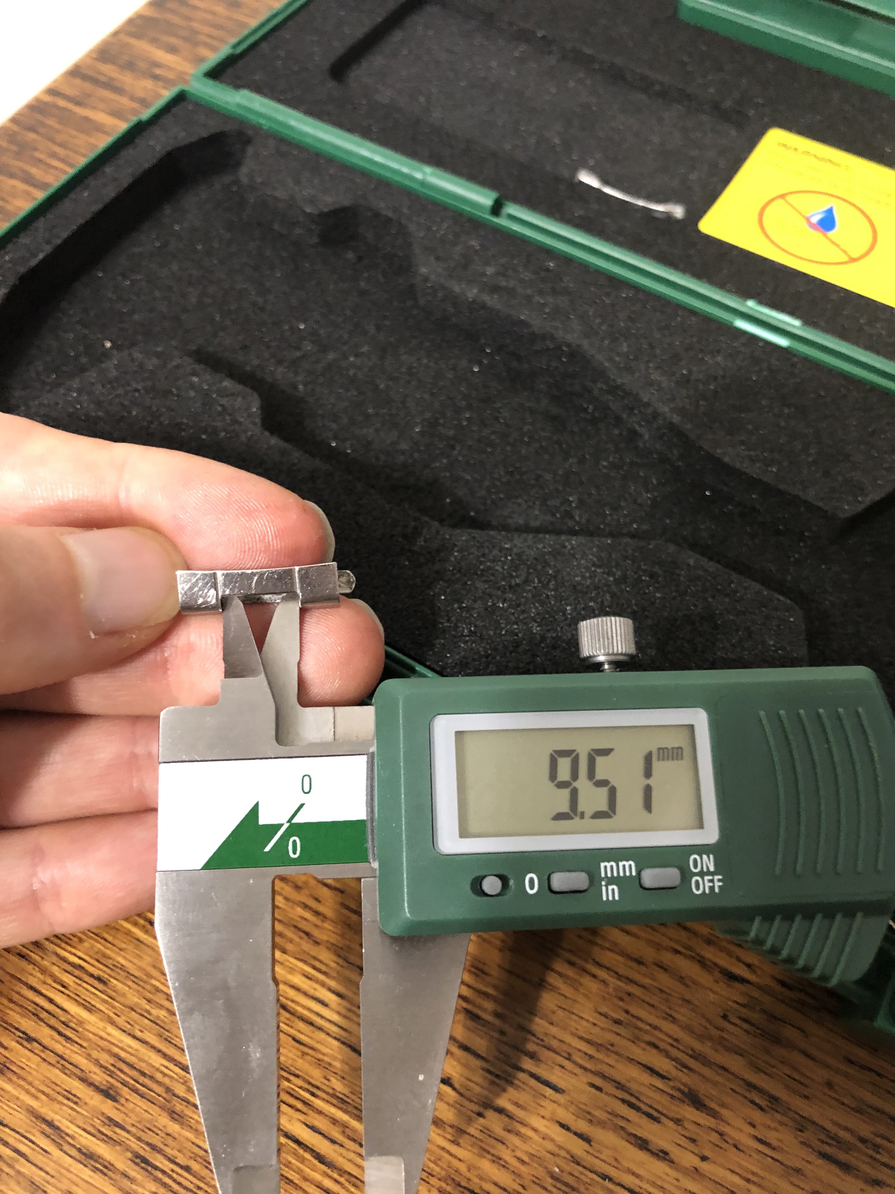

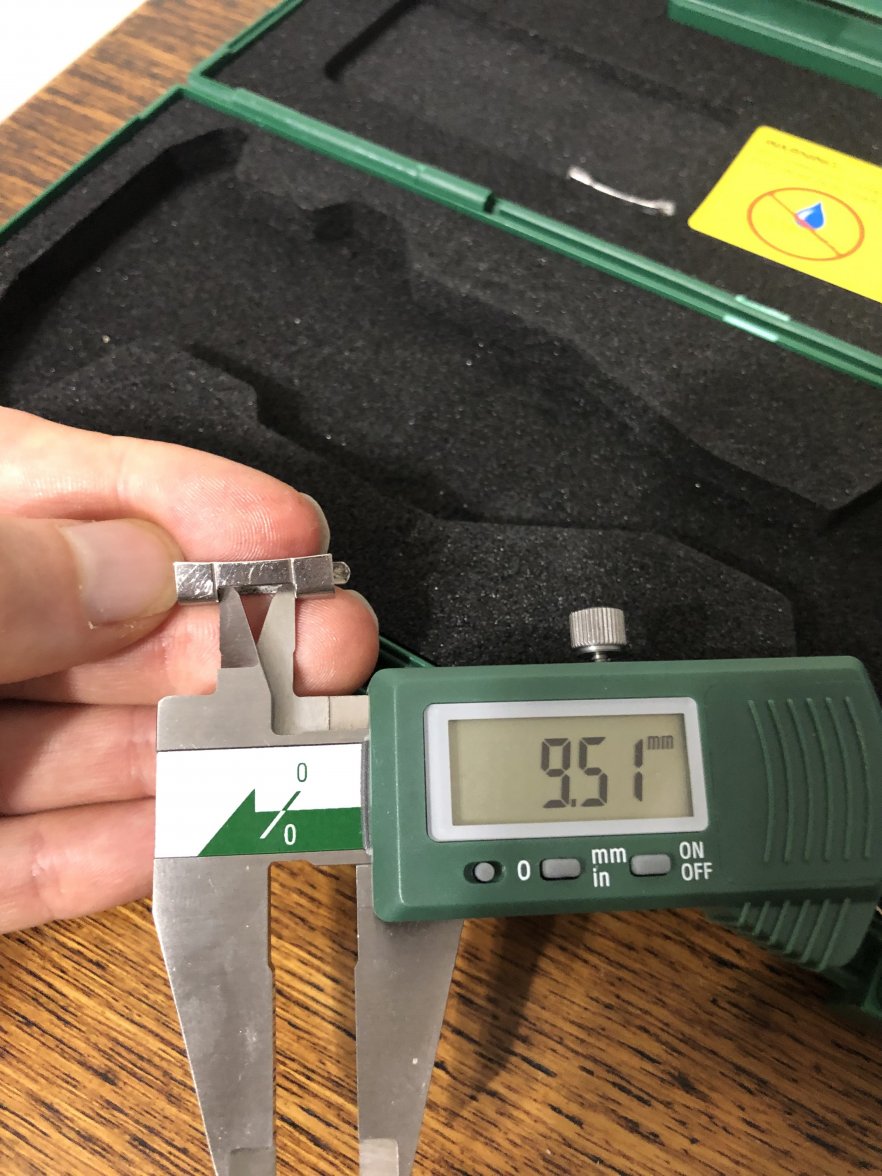

To be honest I don't understand which hole you want measured, it would help if you measure it on another endlink for reference - in picture is the original endlink (002) that came with this watch, it's for a 1125 - but different regions had different options, I've never seen 647
Since you're not seeking purity, filing any 20mm endlink that Uncle Seiko sells seems like an easy option - you can pm me if you are interested in these endlinks, I might sell them with a 1125

I like the clean look of this end link and think it fits the C—Shape quite well…and I was asking exactly for your measurment because the mid links of the Uncle Seiko bracelet are 10mm so I would have the file the end links to fit the bracelet.
