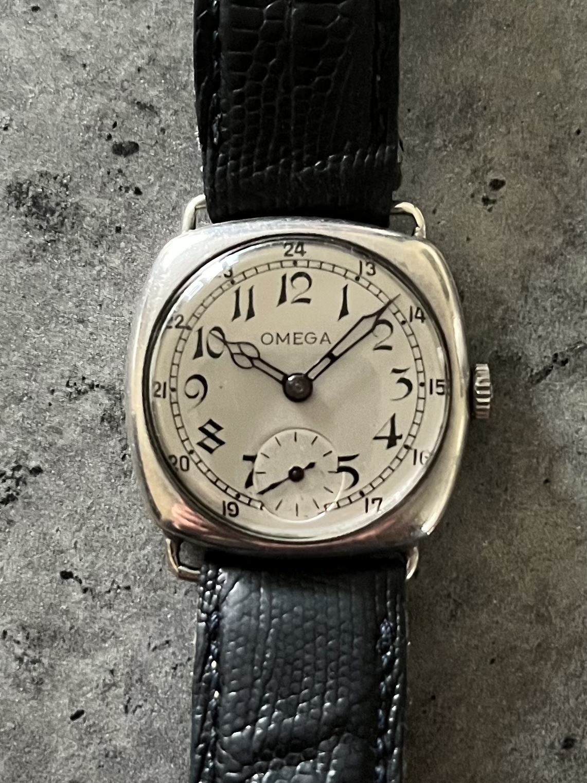

I have inherited the above watch and am starting the exciting journey of better understanding what I have been left! Any help much appreciated- thank you.

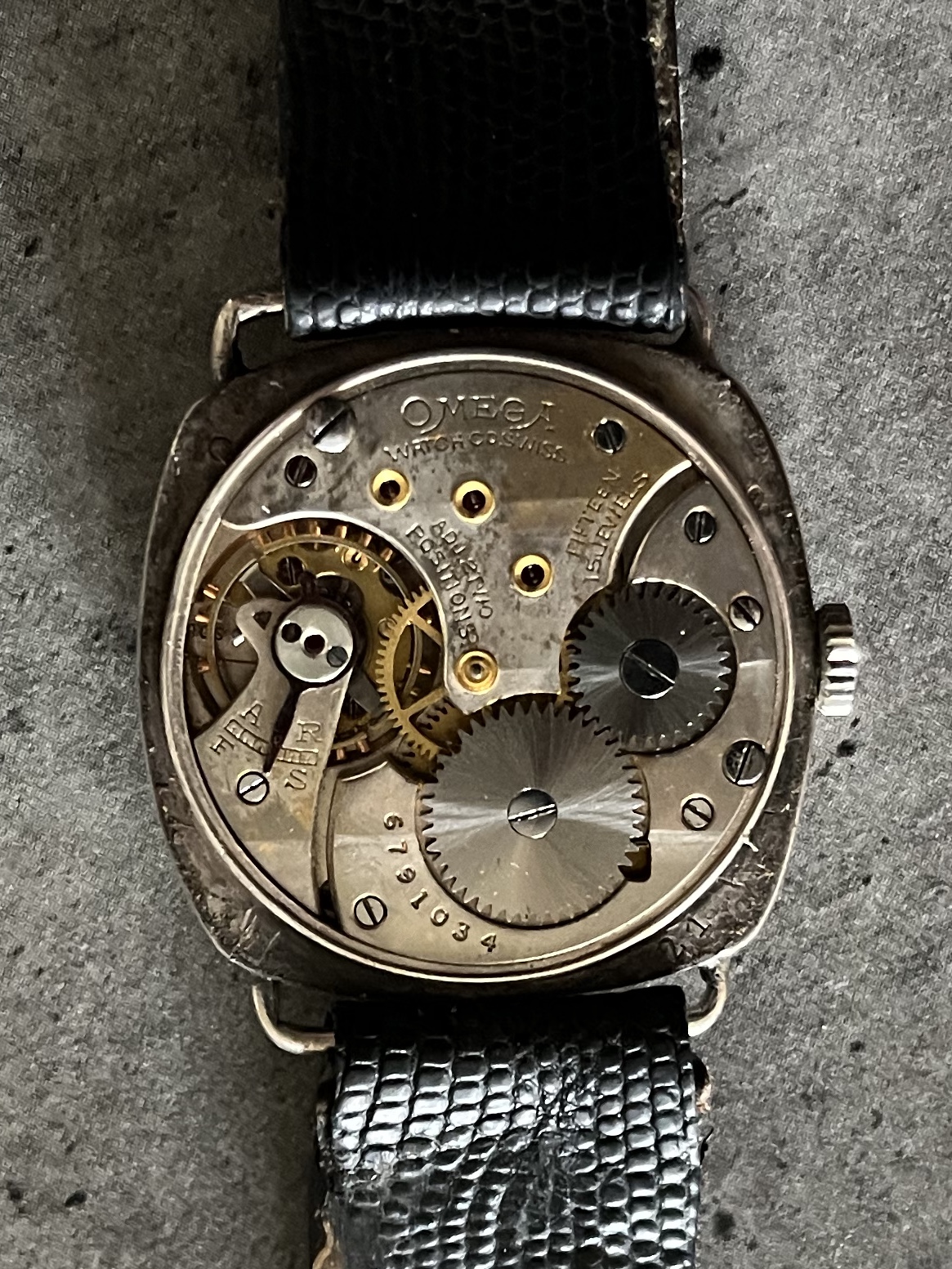

26.5 SOB inside, redone dial, radium hands not matching with a non luminous dial.
This is one of the first two models with 26.5 inside More info tonight when I have access to my catalogs (I think it is a ref 800, but need to check that).

The OP's watch has a 26.5 SOB (the original one without the transformations made by Omega later - T1, or T2 or T3). This original version is easy to spot as it has a 'sunk' spring click where later transformations had a 'hook' spring click.

Thanks for your reply. I thought the dial was not original as the 5 overlaps the bottom dial. Look forward to whatever else you can uncover. - many thanks.

Many thanks for all your comments. One last question I’m debating - should I get it refurbished back to its original spec or leave as is?

was it someone special's watch? is that how they looked at it for 50 years? if so i'd keep it that way, if not......

No, not really. Long story, so I won’t bore you! Can see that the dial has been replaced or painted to accommodate the hours 13 to 24. Also see the Omega logo is missing. Can keep as is, or have (hopefully) dial taken back to original - just not sure if it’s worth it, but no emotional tie.
