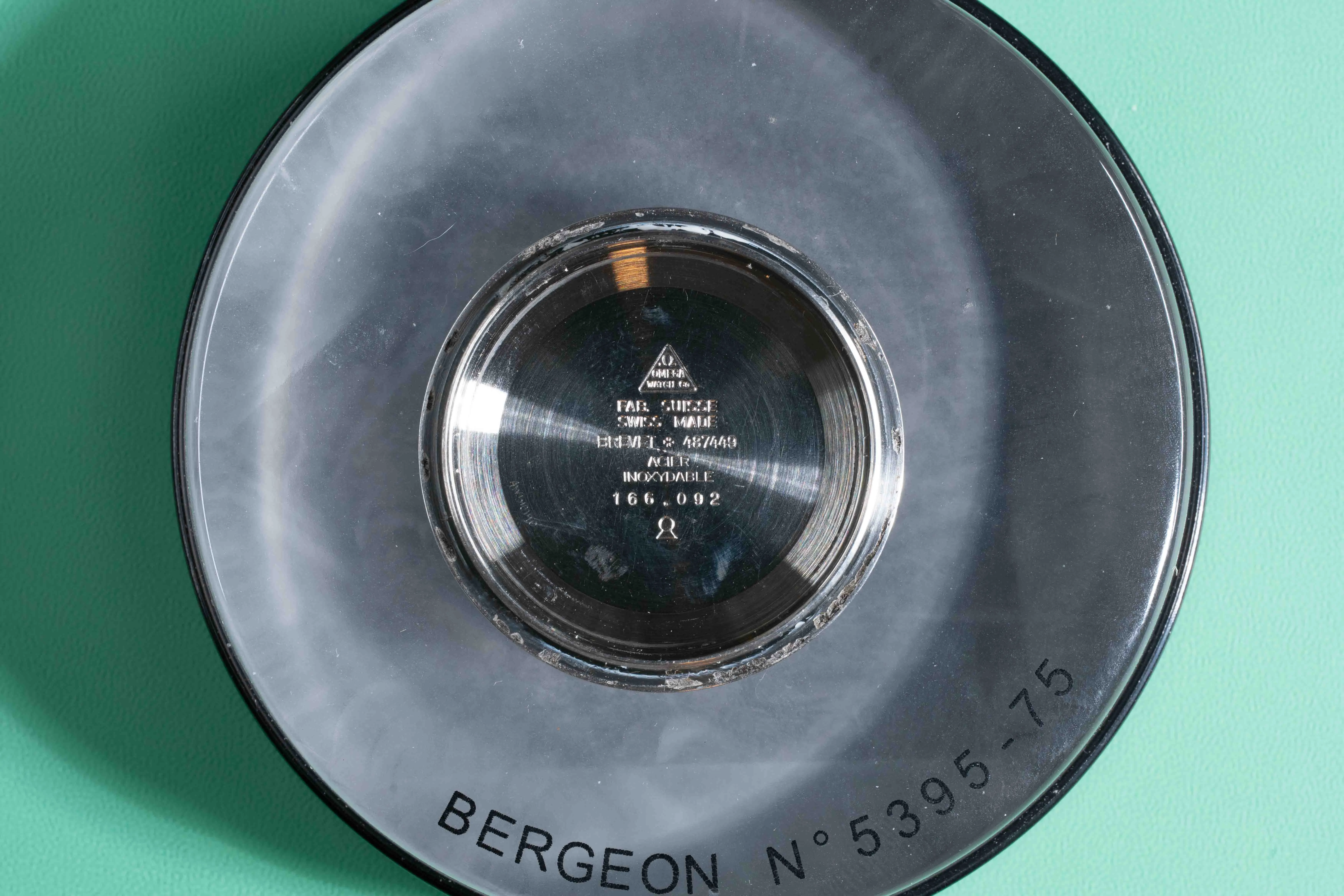

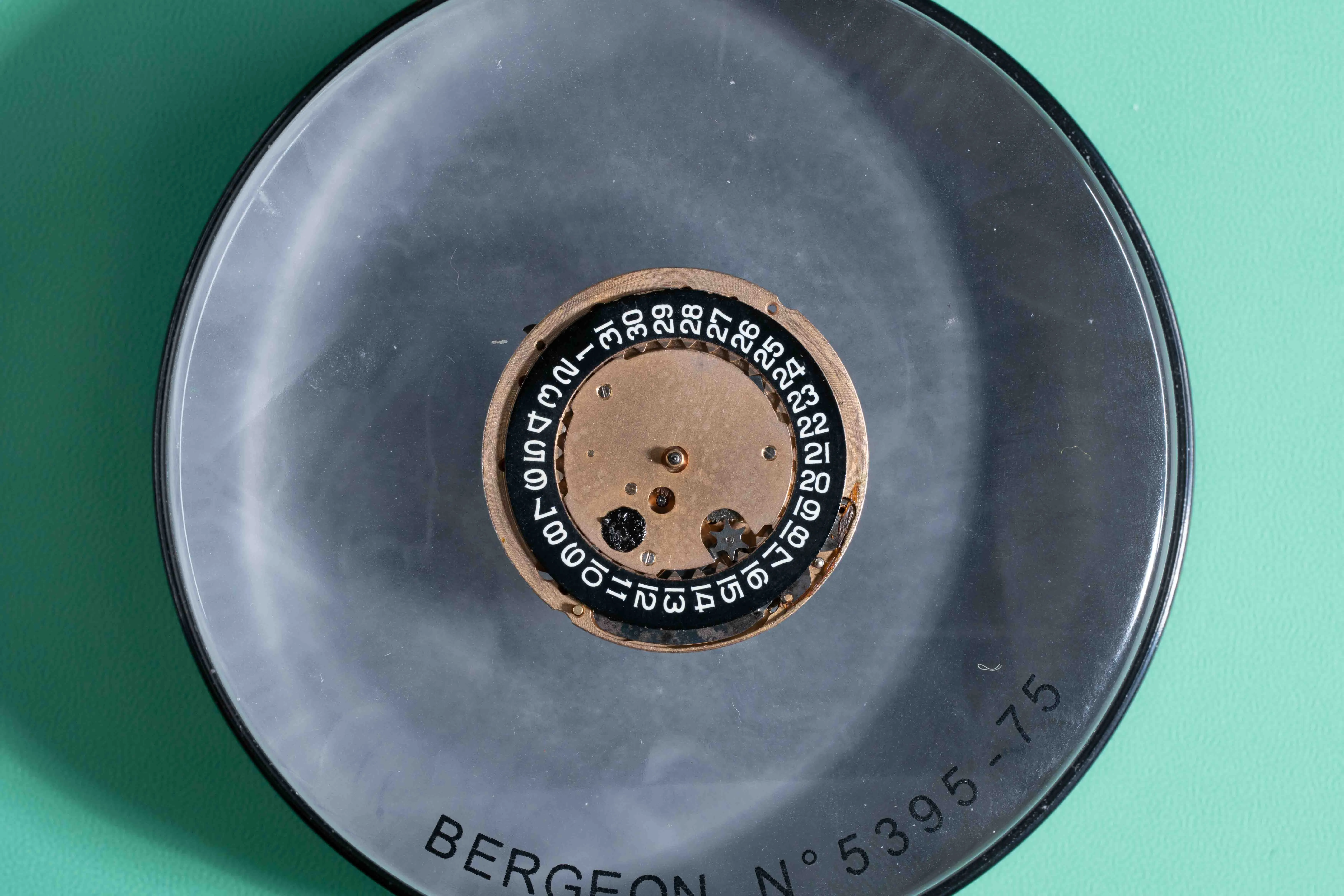

I am working on a 166.092 that had some issues and hoping to get some help on identifying the correct parts for this reference.
The cannon pinion, hour wheel and sweep seconds pinion were all too short with the tall indices of the dial and I am trying to figure out which are the proper height. The hands had been bent upwards to avoid the indices and each other. Quite a mess.
It appears the 1002 has 3 options for heights on these parts. My first guess is that this Ref is spec'ed for the H2 parts.
1000-7231 H2 Sweep Seconds Pinion
1000-1233 H2 Hour Wheel
1000-1220 H2 Cannon Pinon
Any help would be greatly appreciated.
