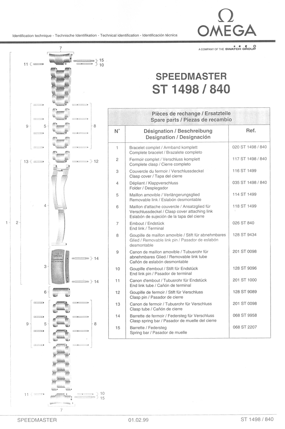

Can anyone provide me with the Omega part number to replace a 1498/840 bracelet with a new one? Can you still get a 1498?
I have moderate stretch on the 4-link end link side of the bracelet. I wouldn’t mind simply replacing those four links. Can I order those four links only? Is there a part number for that?

The 1498/840 bracelet is no longer available from Omega. But it shows up on the used market every once in a while.
I really like the bracelet and use to wear it on my 1996 Speedy.
Regarding part numbers:

Wow! Brilliant! Thank you!
