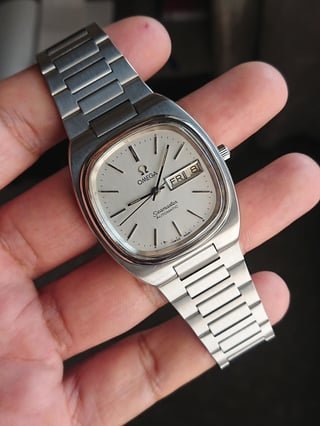

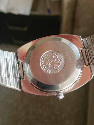

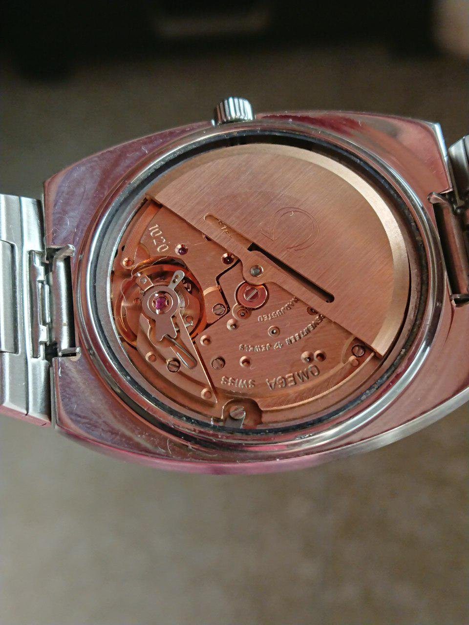

I am new to this forum and i recently got a vintage watch from reddit watch exchange. Had many good experiences from that forum but it's my first time getting vintage omega Online. Based on the seller info provided, the watch model is 166.0213 Which should have the quick date and day function set. However, after i received the watch i noticed the quick set day function is not working. I am wondering if this watch is legit based on the image provided.

Looks legit. To set quick day, you need adjust the time counter clockwise.
I tried but when i do that only the time is moving and the day is not moving. Thank you for your help. Does the movement or watch look fishy?
198
162
If you move the time backwards, the day should start move. If not, something is wrong, but I don't think the watch is a fake. It needs service.
