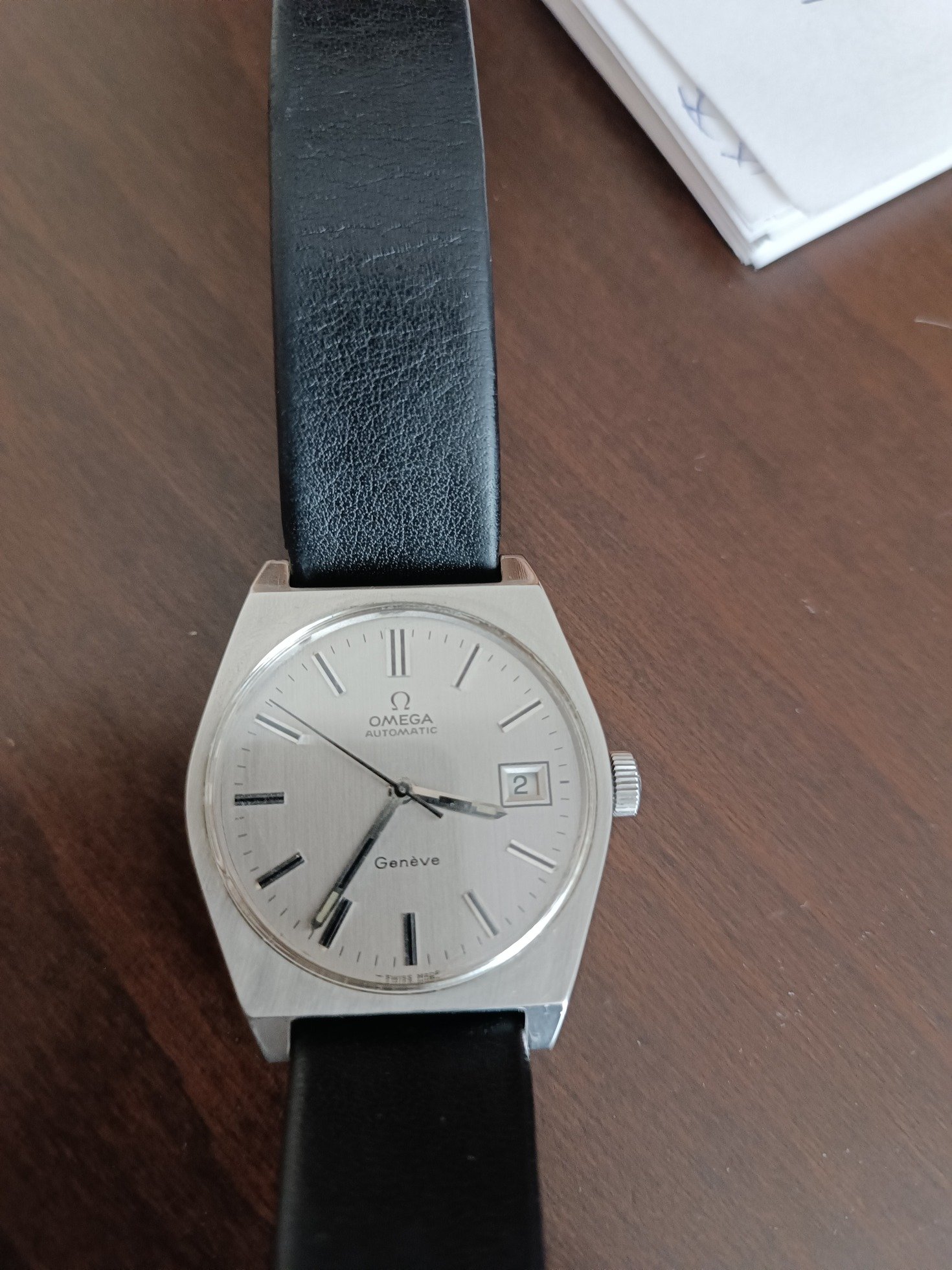

Is this watch genuine? And how much it cost? Can you give information please? And its deviation about 25 seconds in a day, is it normal?

Yea 25 seconds in a day isn't excessive, these are non-chronometer movements and if it hasn't been serviced recently, it probably could use that too

The watch is absolutely genuine, applying some negative pressure on the crown to stop it is the way to hack it just don't go too far and make the hand go backwards.
