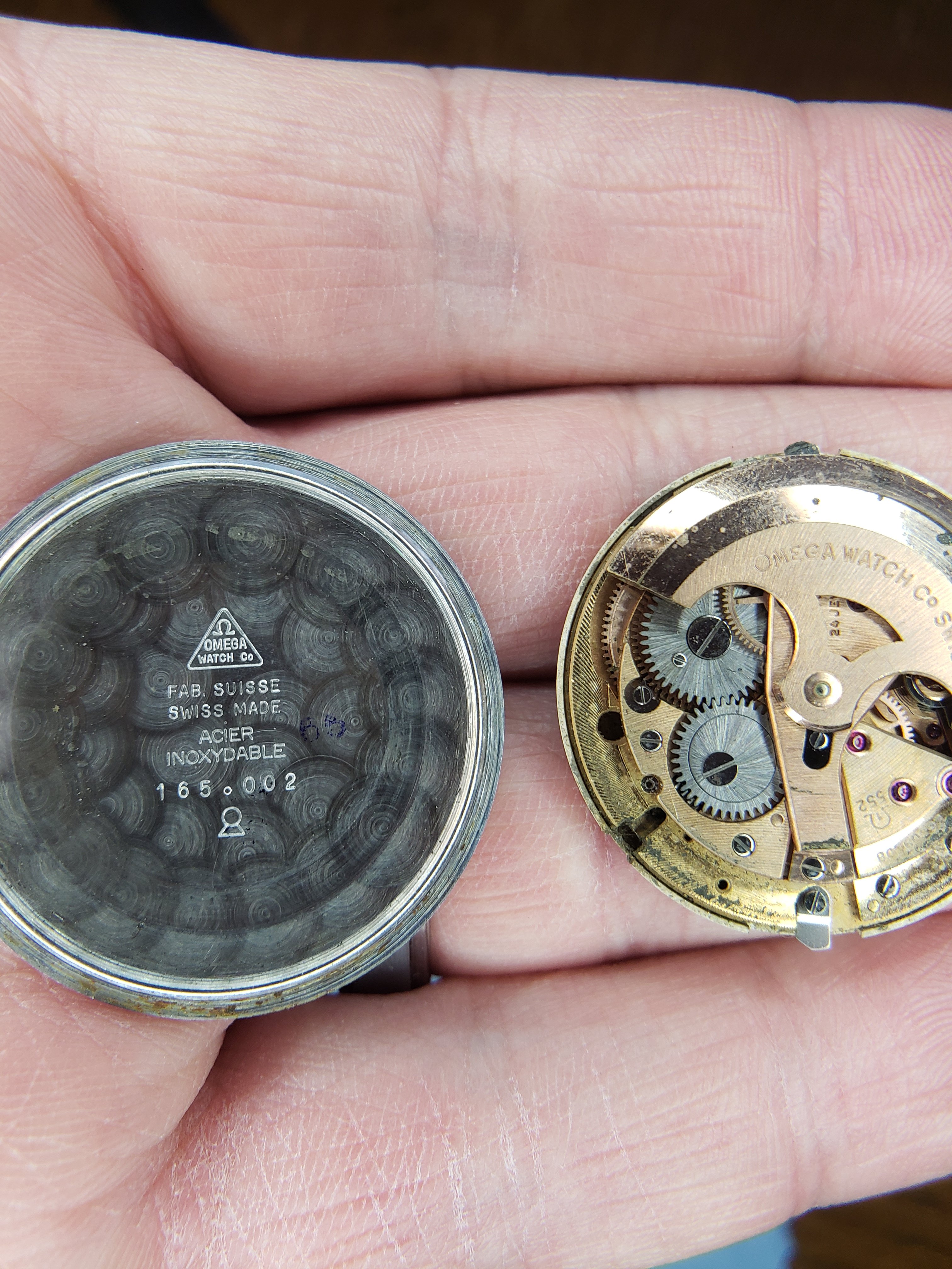

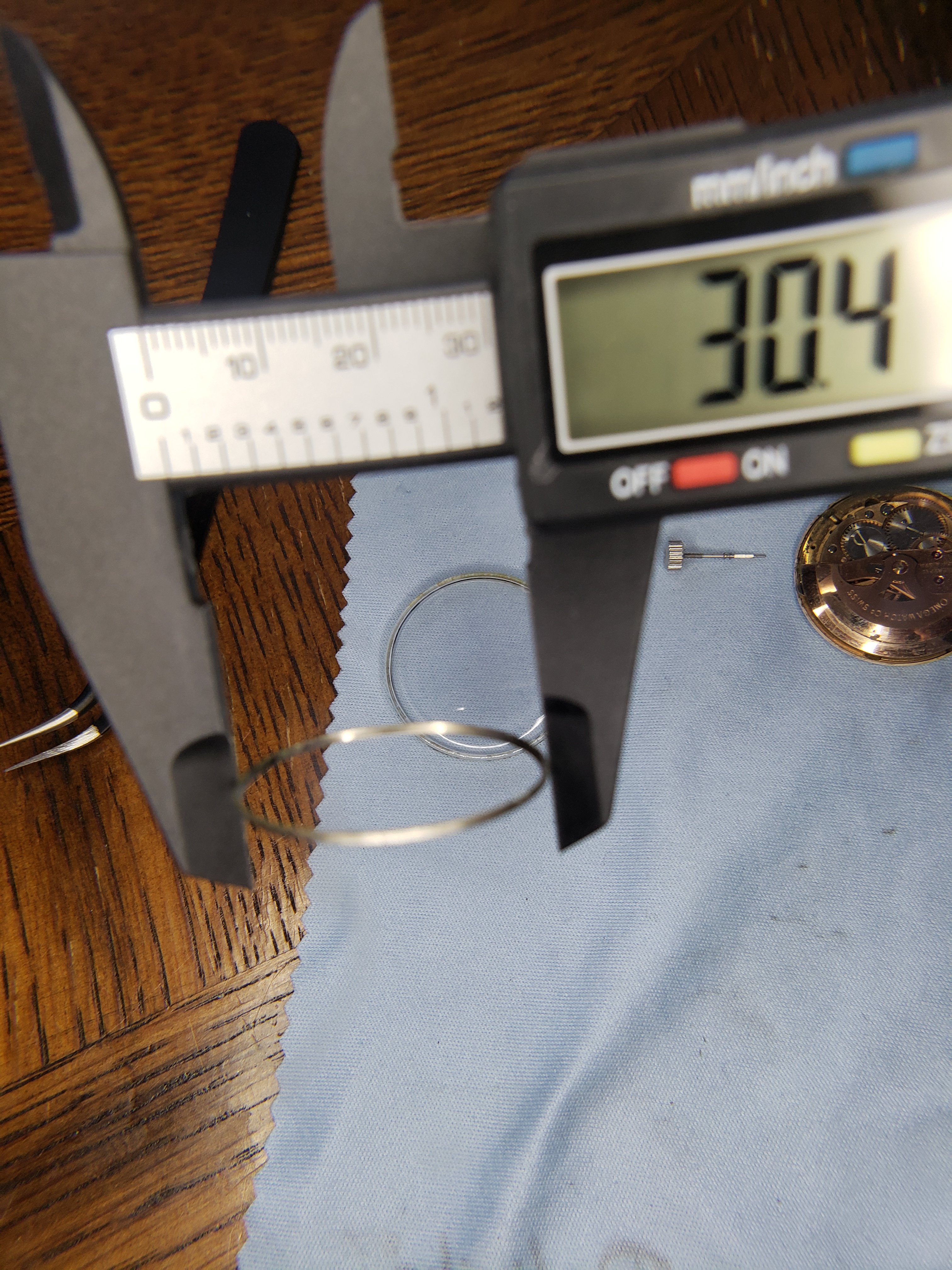

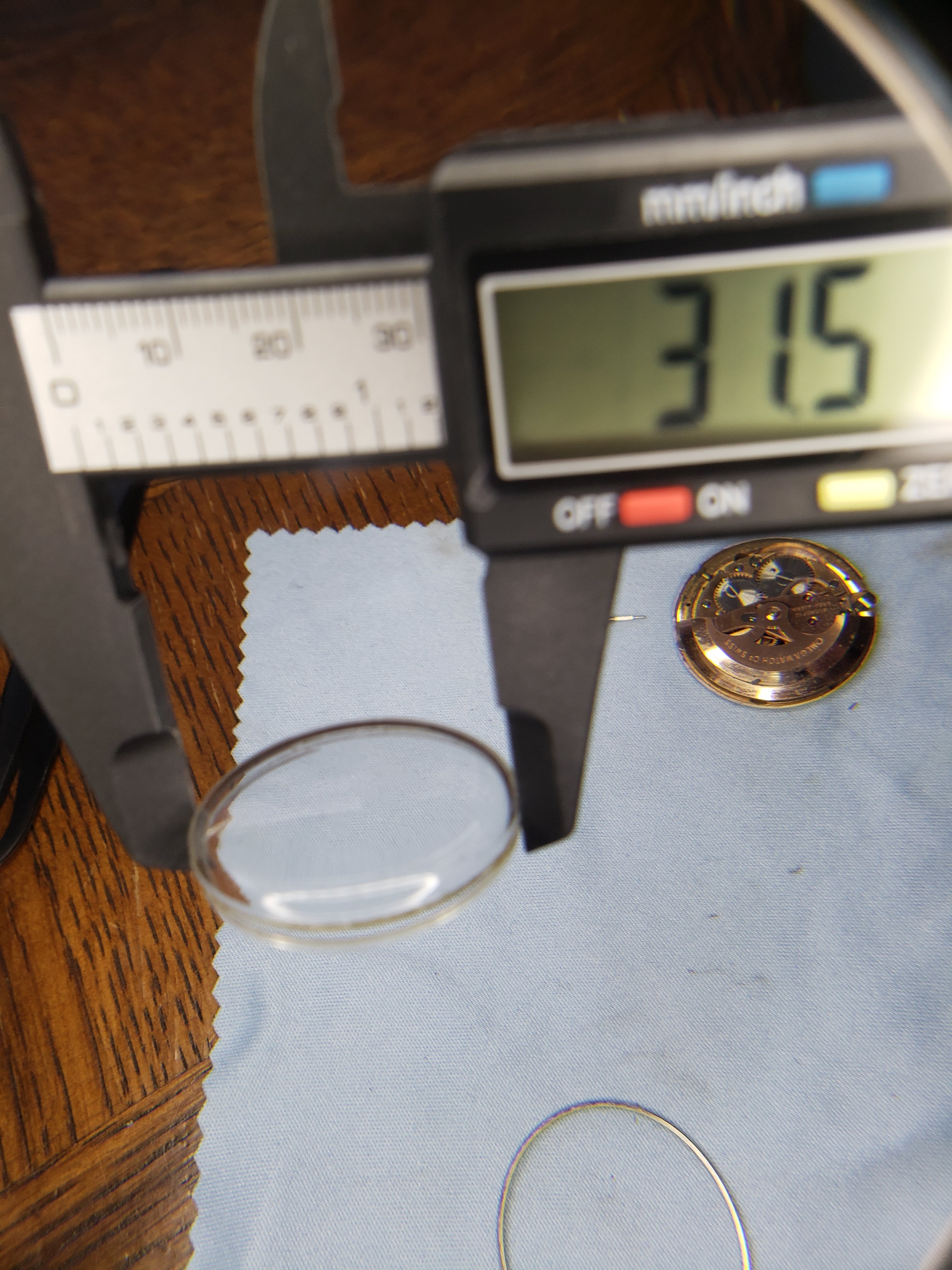

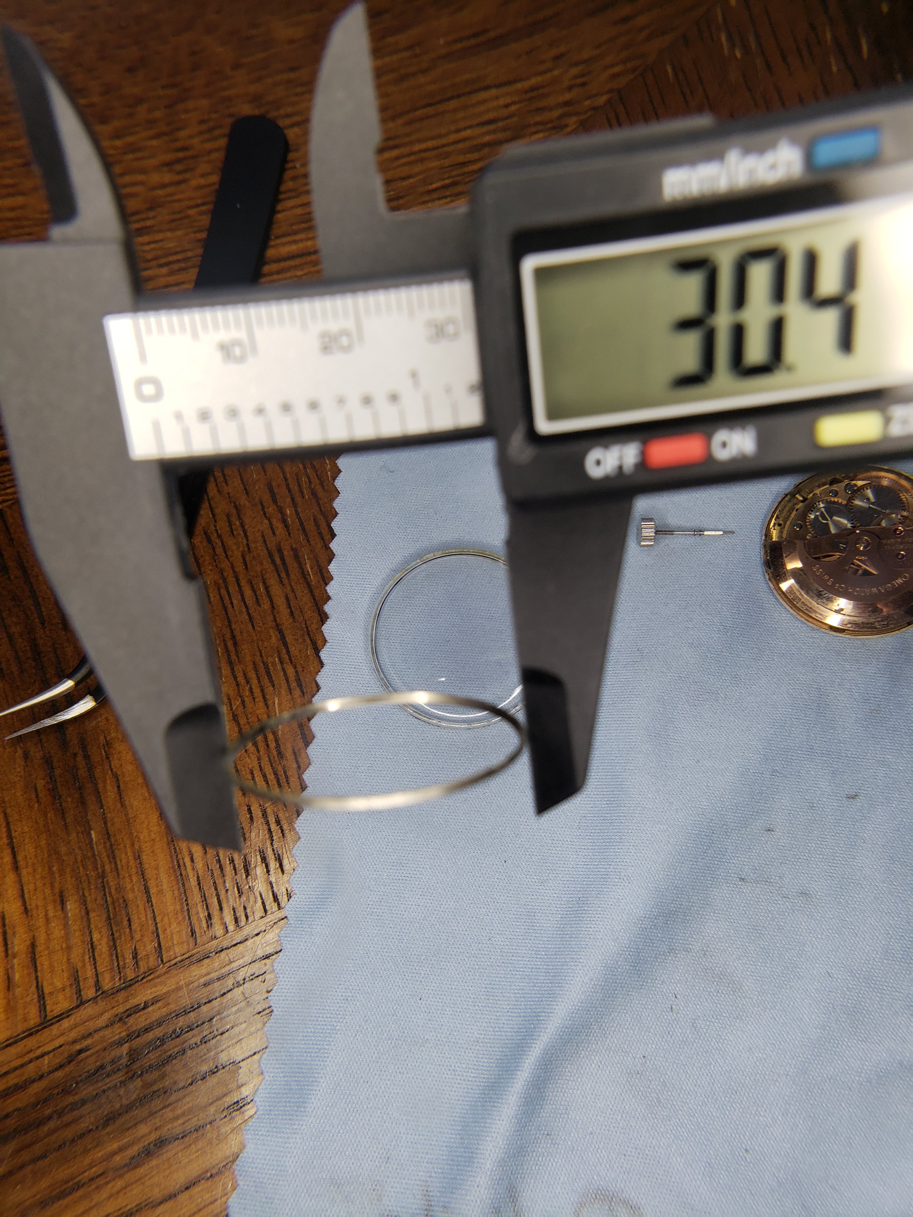

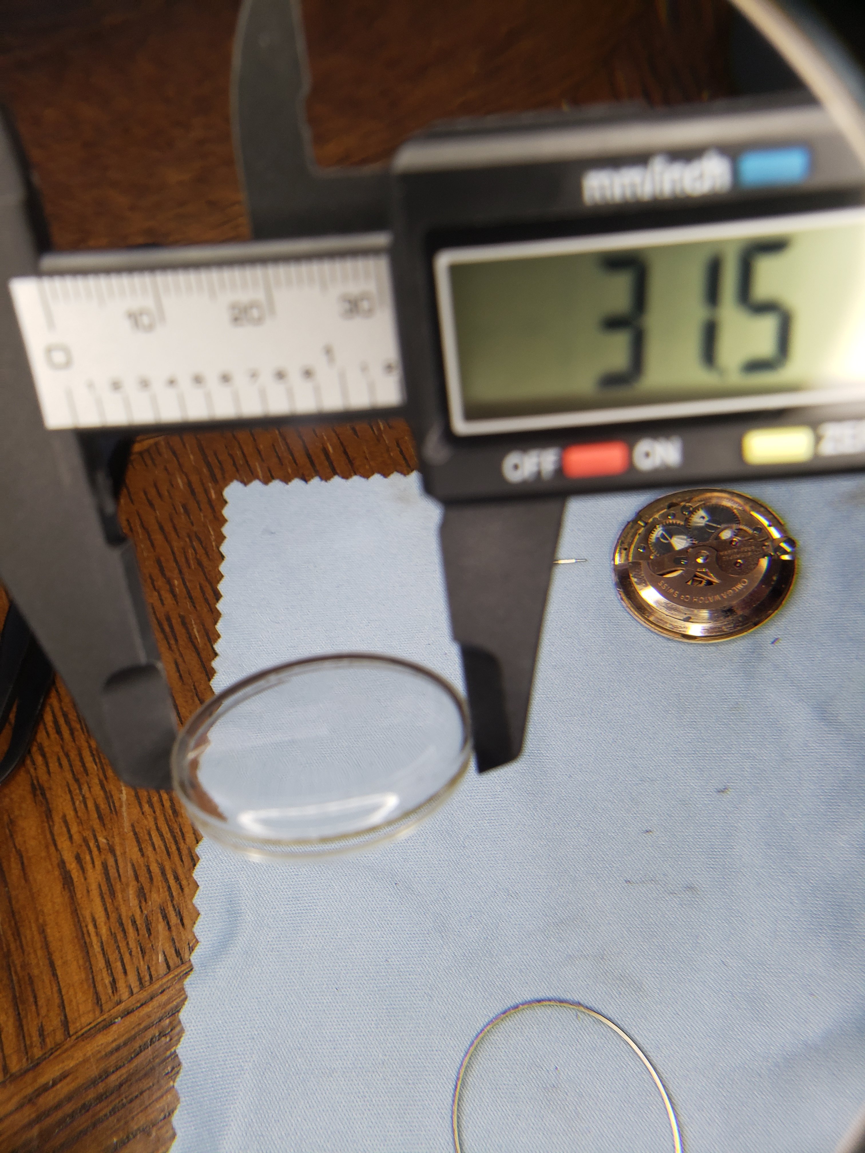

Hello all,
Looking for a bit of guidance on location a proper crystal. I recently purchased a 1968 Seamaster Genève, cal 552, ref 165.002 (Stainless steel) that needs a new crystal. I did see another thread on here that said PZ5028 was the correct replacement crystal for this case but I found this part at Time Connection (https://timeconnectioninc.com/crystals/2315-omega-crystal-063pz5028.html) but when I reached out they said it was not the correct crystal.
At this point I have no clue where to look next. Have any of you replaced a crystal on one of these before and recall where you purchased it and the last number?
Really appreciate any help with this at all, I'm at a loss.

063PZ5028 is the right crystal for your case.
8
Thank you confirming, I am not sure why they seem to think this is the incorrect crystal for this case. .
8

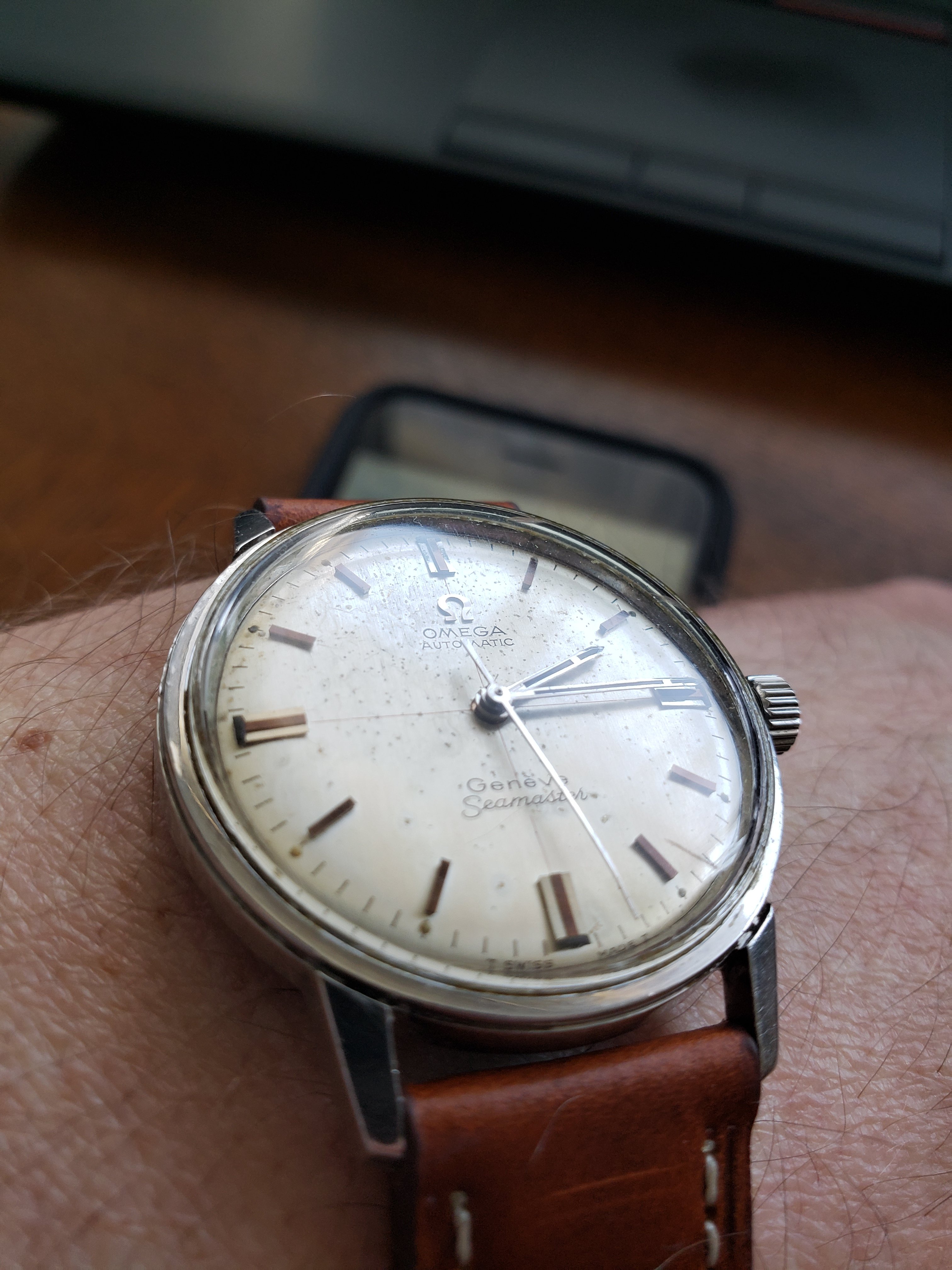

What is wrong with the current crystal?.
You cannot see it in the picture but it has cracks between 1 and 3 o'clock. The lip also broke off on removal.
