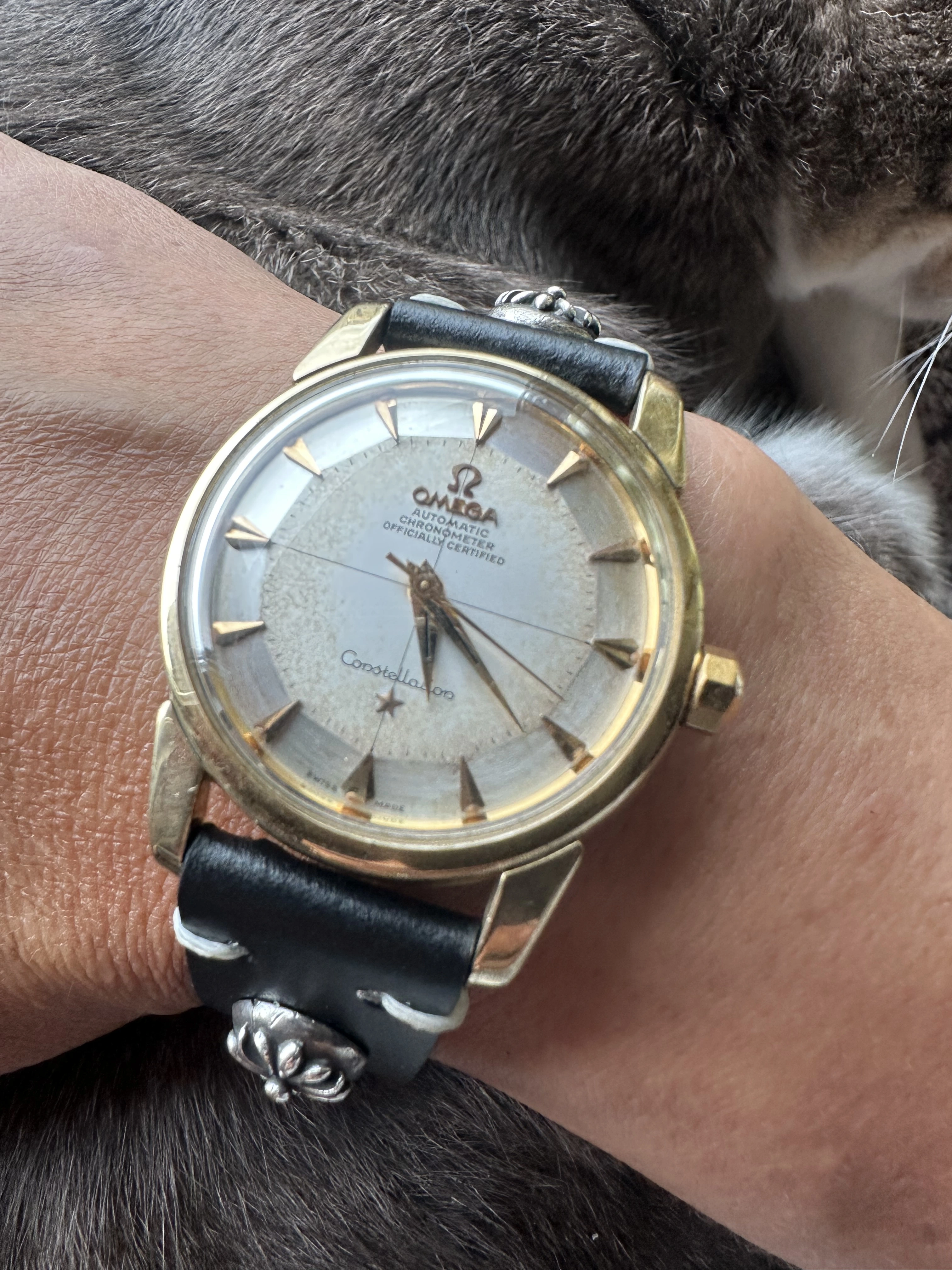

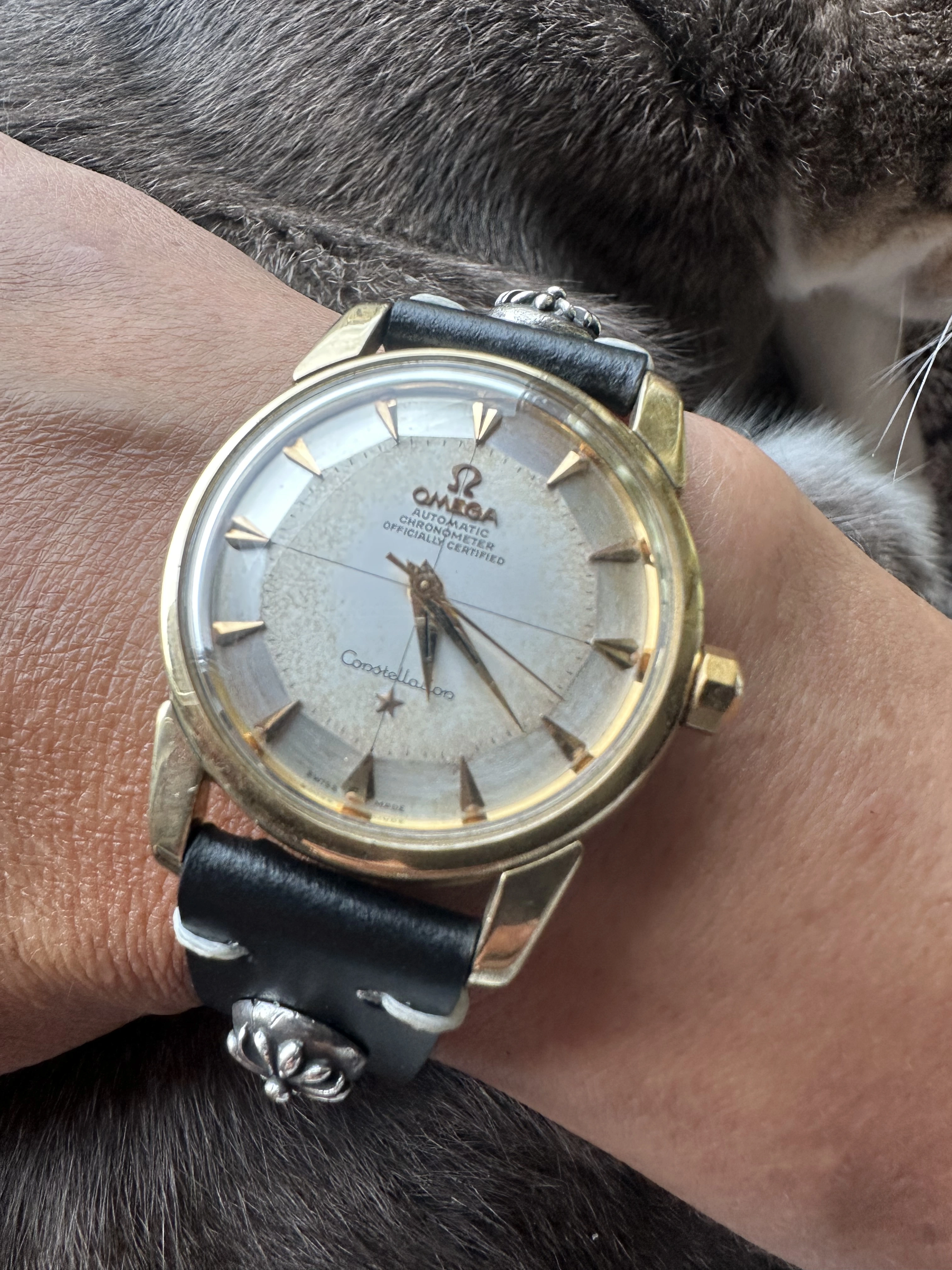

Posts 1 Likes 0 boyle ·Jul 14, 2025 Hi all .im new member This constellation 14900 61 sc its real or fake ? thanks all.
Posts 220 Likes 352 stormysky10 ·Jul 14, 2025 Have you tried searching for what a reference 14900 looks like? Hint: there is something majorly wrong here.
Posts 391 Likes 839 AG77 ·Jul 14, 2025 Looks like a 2852 to me, you'll want to open the caseback to confirm.
Posts 850 Likes 1,186 theluckyluke ·Jul 15, 2025 AG77 Looks like a 2852 to me, you'll want to open the caseback to confirm. The case/lugs do not correspond to a 2852 either. I am not an expert here, but I would guess this is a mix of Seamaster case (2577, 2767 or so) with a constellation dial and crown.
Posts 6,635 Likes 10,244 Peemacgee ·Jul 15, 2025·Purrrr-veyor of luxury cat box loungers Welcome @boyle As above, this watch is a marriage of a Constellation dial and a Seamaster case. With a ‘fat’ Constellation crown stuck on for good measure. The 14900 would have dogleg lugs.
