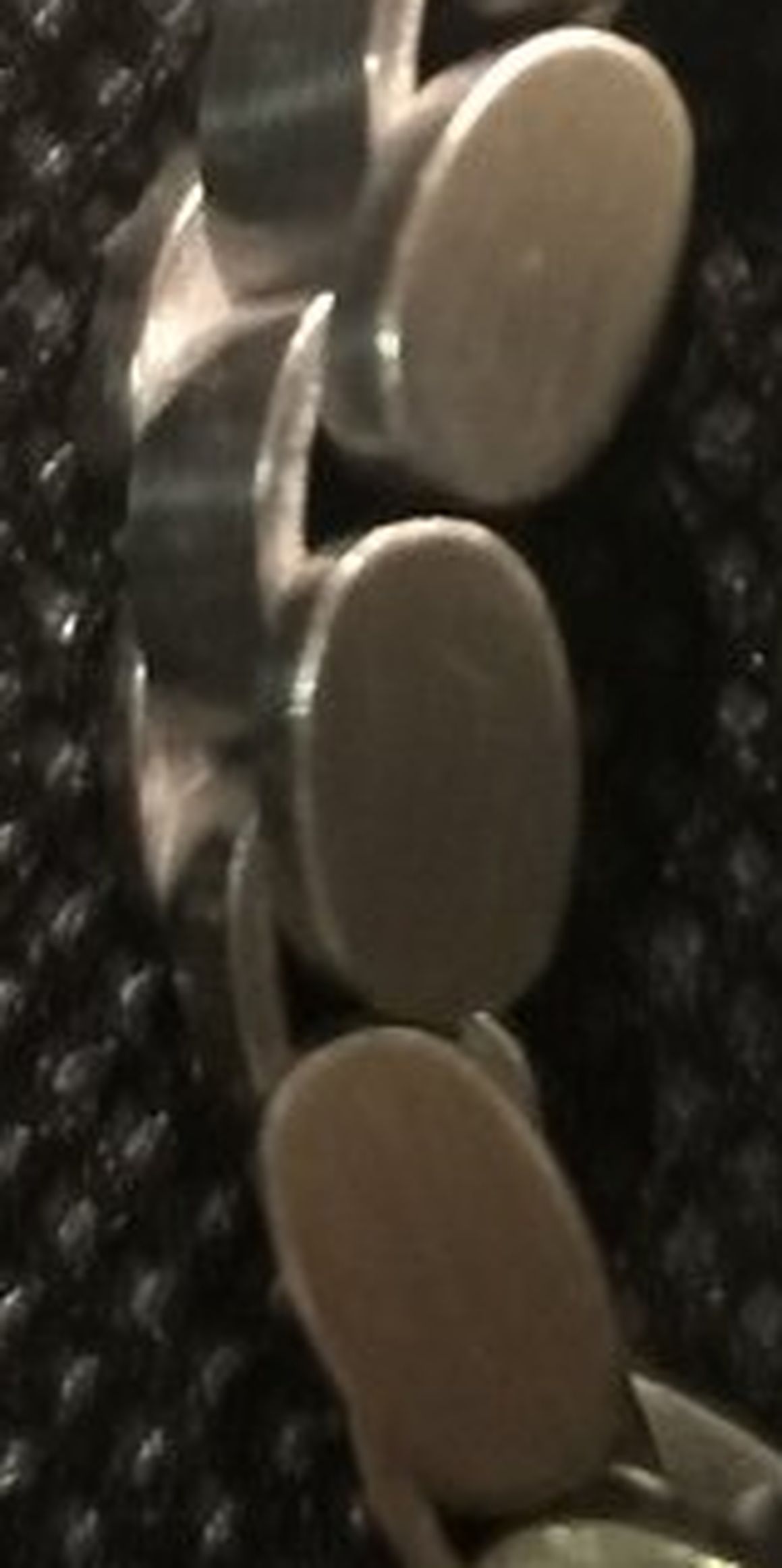

I would also say genuine. Though the photo is fuzzy, the links themselves seem very well made and finished, with (what appear to be) nicely beveled edges.

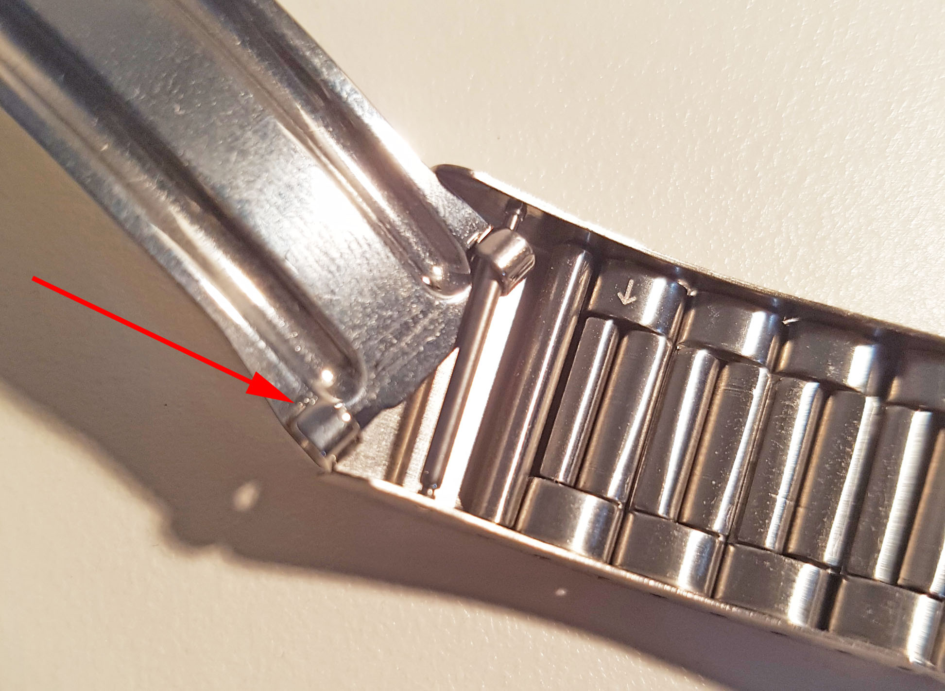

This is the photo you posted, that I have cropped and brightened. The red arrow points to one of the looped areas that simply wasn't crimped enough, so the spring bar slipped out. Not a failure, but certainly a defect.
A watchmaker would have spotted this and could fix it in about 5 seconds.
I have no opinion on the seller, but unless the watchmaker and the boutique you dealt with are very experienced in vintage watches (and specifically Omega bracelets) I would take their opinions with a very large grain of salt. Stuff like this is not unusual on genuine Omega bracelets (I know, as I buy a lot of them from Omega).
