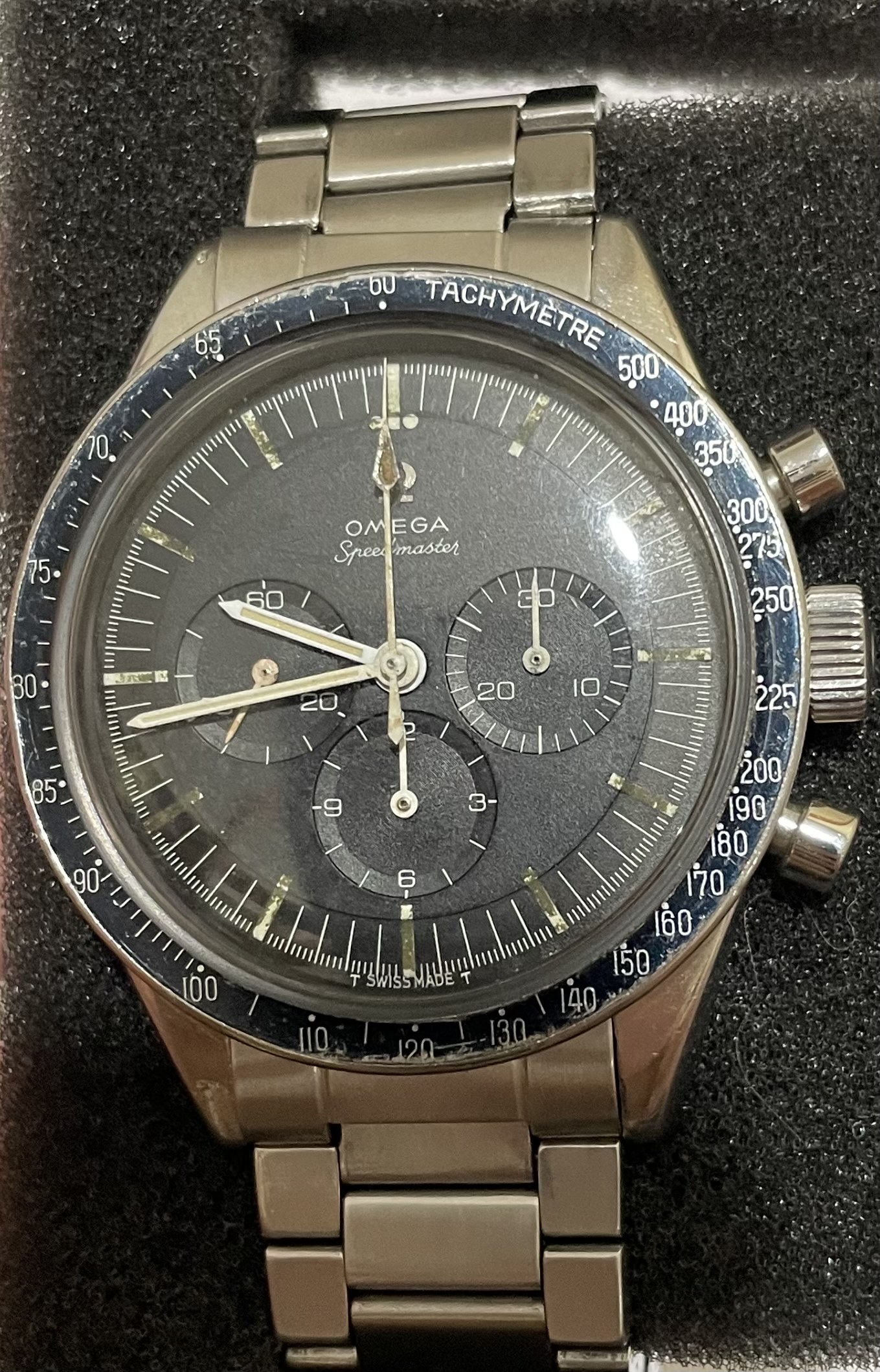

good morning I present to you my first vintage purchase I would like an evaluation advice on what work to do to make it better

What do you want to have changed? Technical or optical?
Could you please post more pictures? Where did you buy the watch?

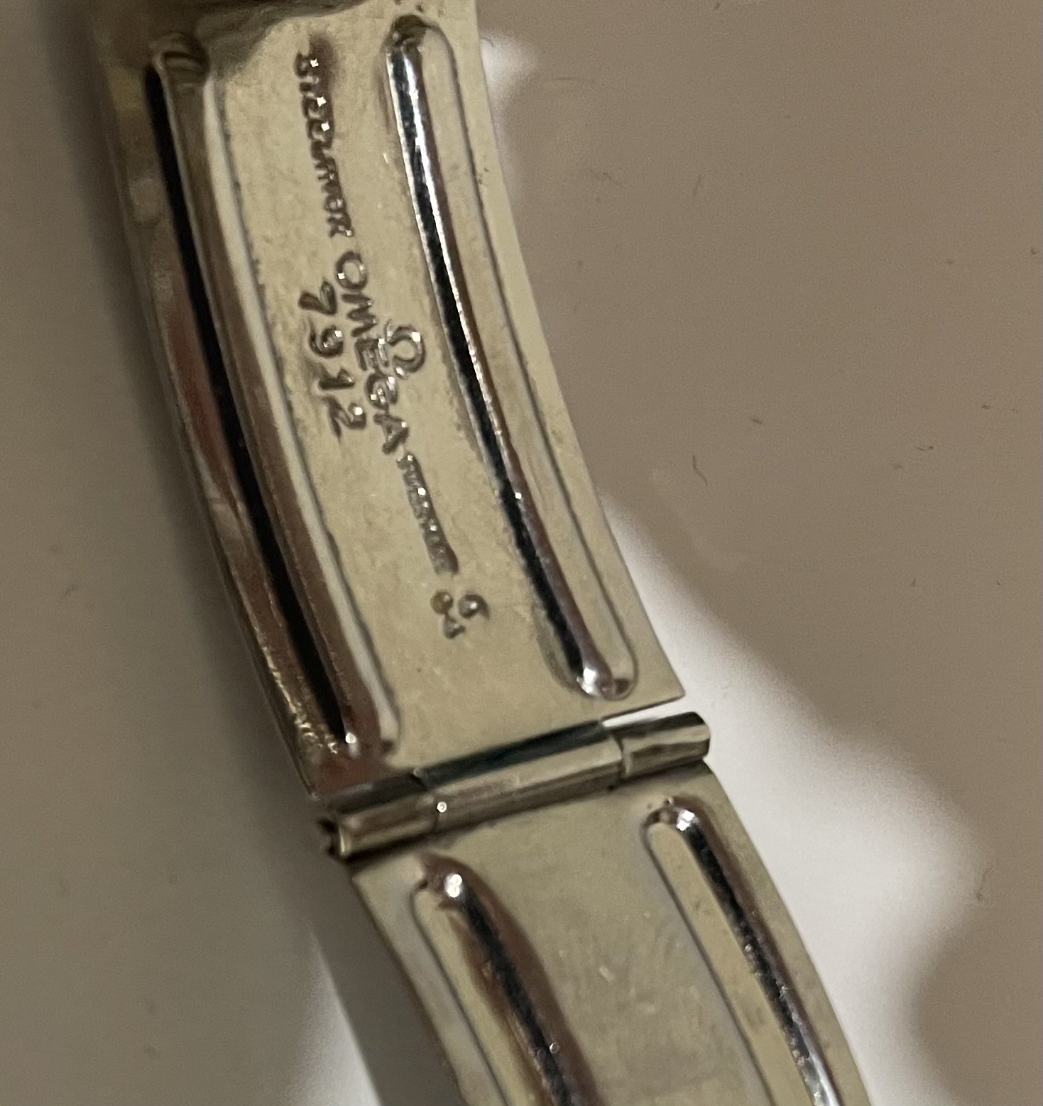

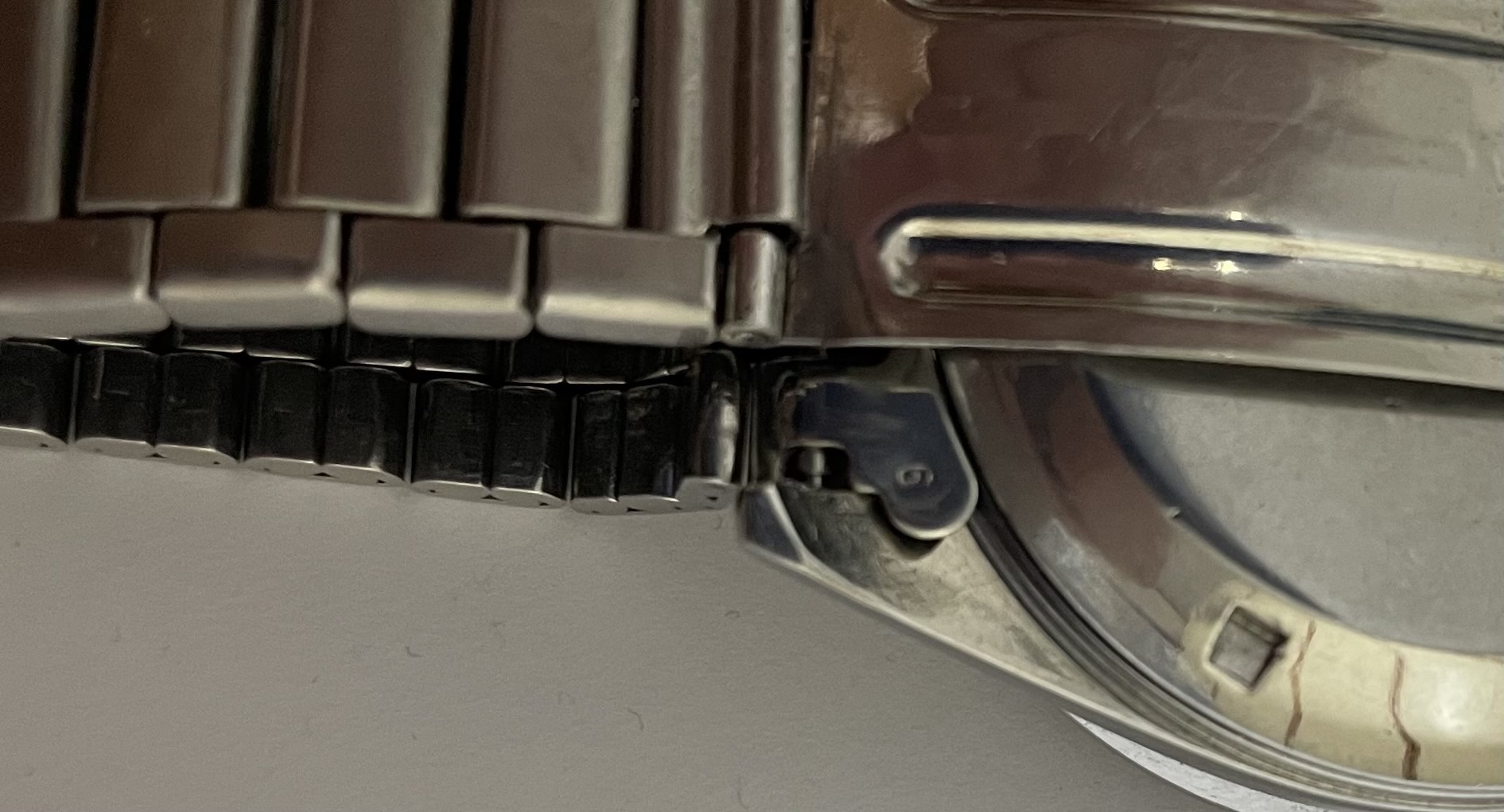

The 6 endlinks look a bit strange to me

to make it better for whom? are you not happy with the watch?
i think its a nice looking watch, and i would leave it as it is.
check if the movement is in need of a service.

It's a matter of personal taste.

any disclosure from the seller to share here would be initially helpful for OF advices, then pictures of its inner caseback and caliber is highly suggested.

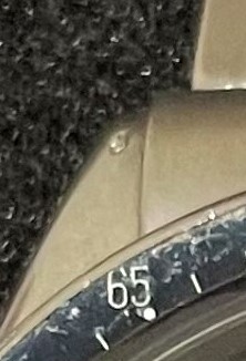

Is this a -63 iteration? The T marks are not right for a -65 IMO and may be questionable on a -64.
