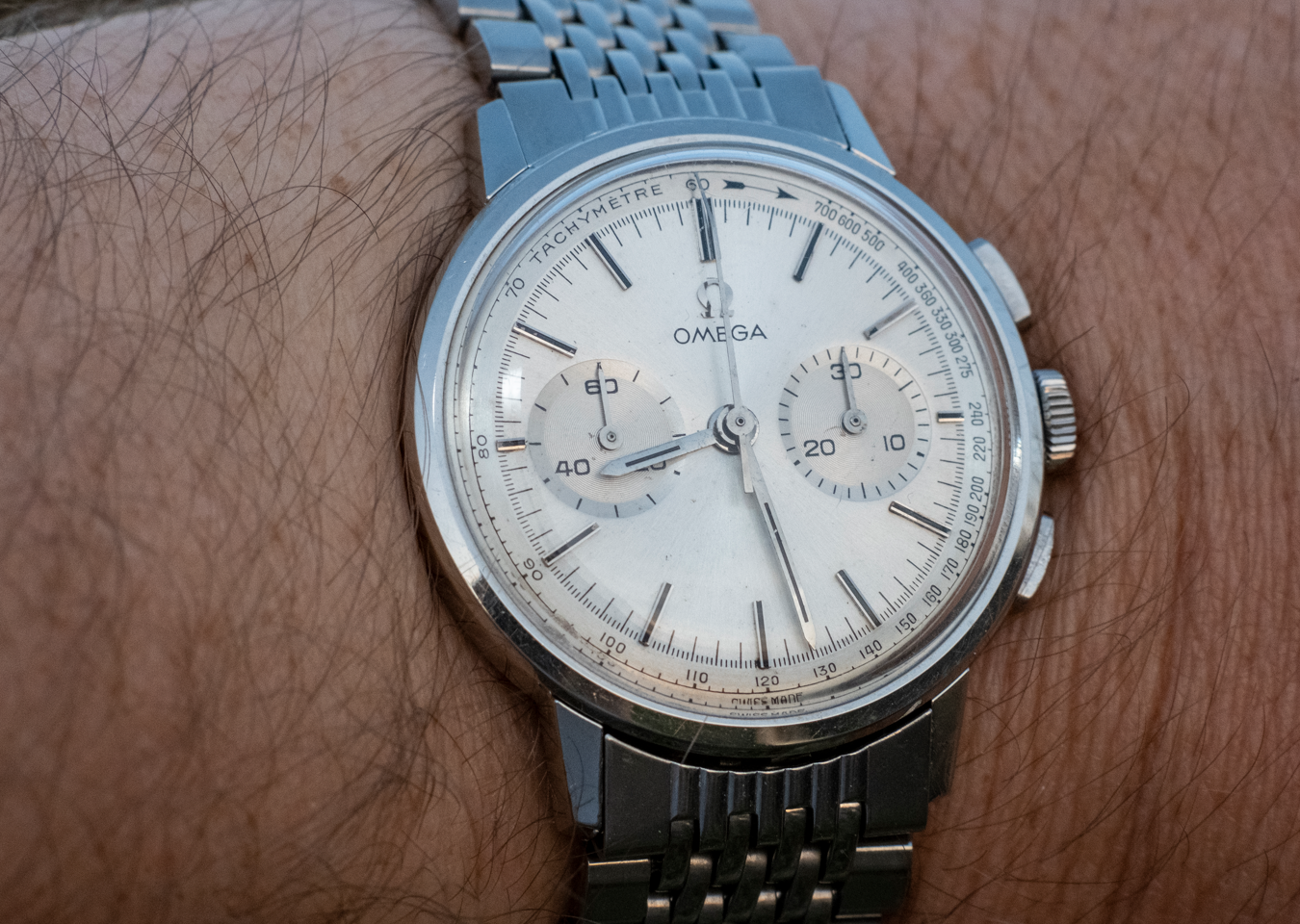

Hello,
I recently bought I beautiful 320 powered vintage chronograph and I am currently trying to get information about two things:
- which bracelet could possibly fit this type of lugs?
- is there any collection this watch can be assigned to?
Thanks for your help!

I think the later ones had DE VILLE printed on their dials, but generally this reference had unmarked dials.
The classic "bead of rice" bracelet could probably be fitted and would match both the age and style of the watch.

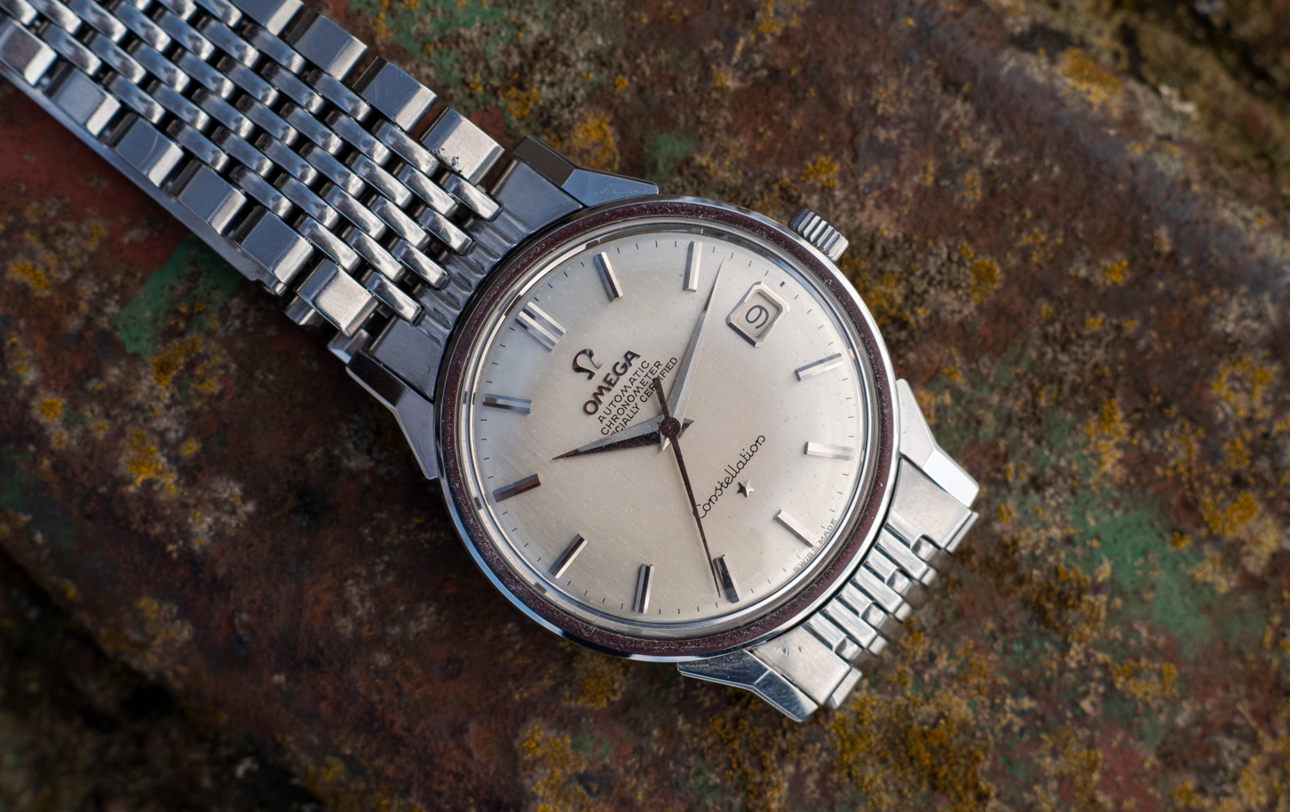

Can't remember the bracelet, but it looked like this and fitted also to my 14902 61 Constellation.

Thank you all for your replies! I already thought that this one is a pre de ville chrono.
I will dive into the beads of rice bracelet and check your urls. If any of you has a ref for the bracelet and the end links, just let me know.

1037 or 1503 bracelet I would think.
Endlinks will be harder to pin down as I’m not certain these came with a bracelet. Possibly 70 or 570?

{I have found the 570's seem to fit better with less play on most applications than the older 70's.

Thank you all so much, will have a look for 1037/1503 with 570er end links. In case I find a good bracelet I will provide pictures.
Right now the watch is checked because the reset button is a bit easy to trigger, hopefully nothing big because the movement runs smoothly as it should.
