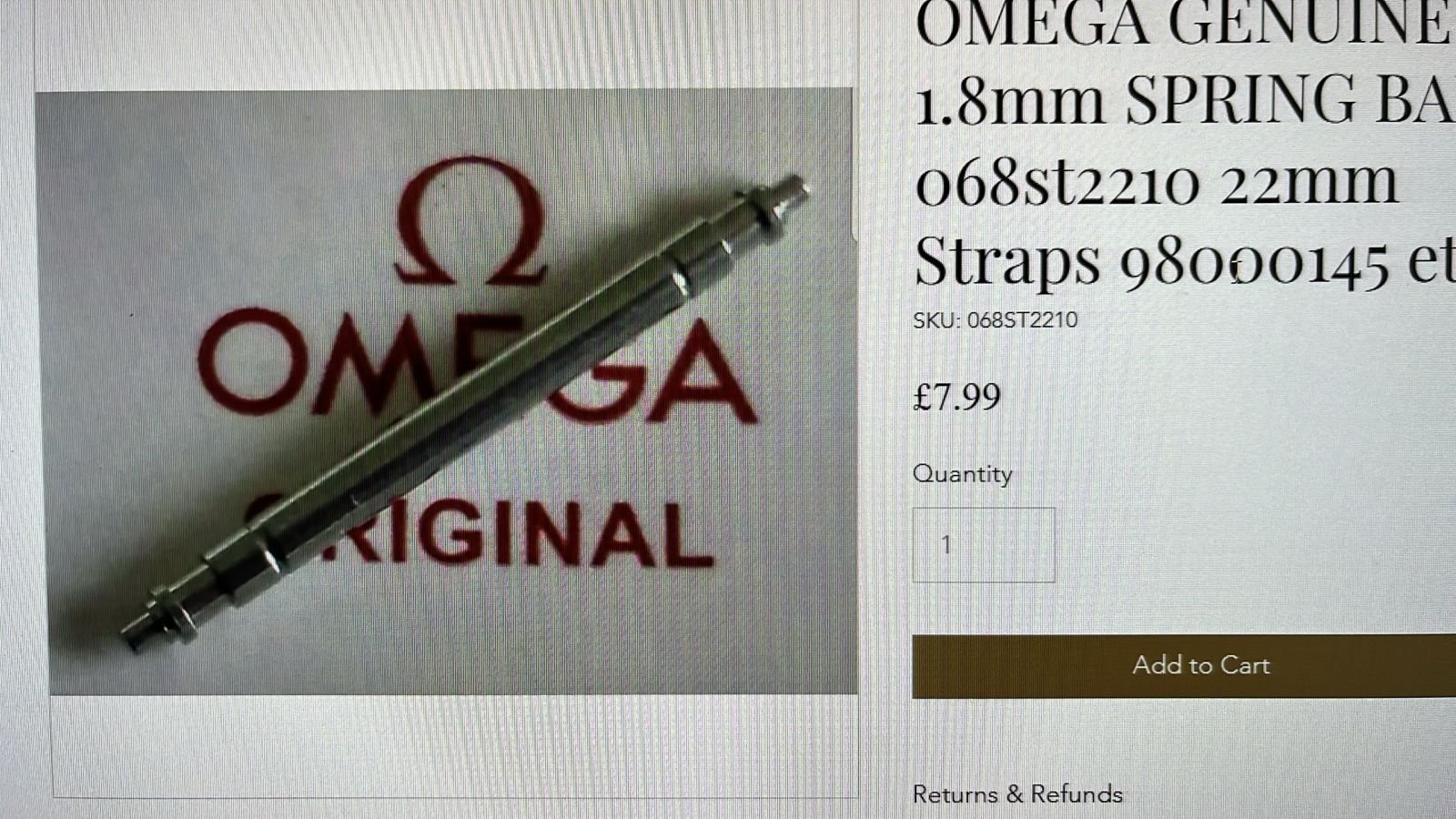

Are there any differences between the Omega - 068ST2210 spring bars with body ring (have the recess either side)?
On the internet I found two types: with and without a ring (recess) on the body !!!

Note that spring bars starting with 068ST22 are 1.8 mm diameter, and all these will have the "rings" around the body.
Spring bars starting with 068ST21 are 1.5 mm in diameter, and will not have the rings.
So 068ST2210 would have the rings, but 068ST2110 would not.
