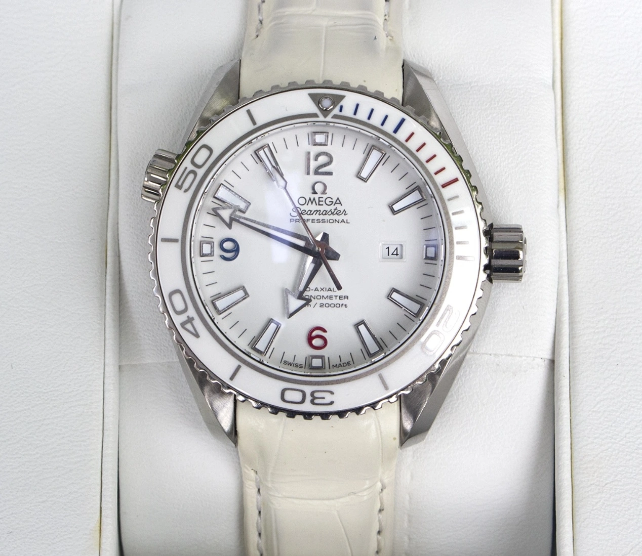

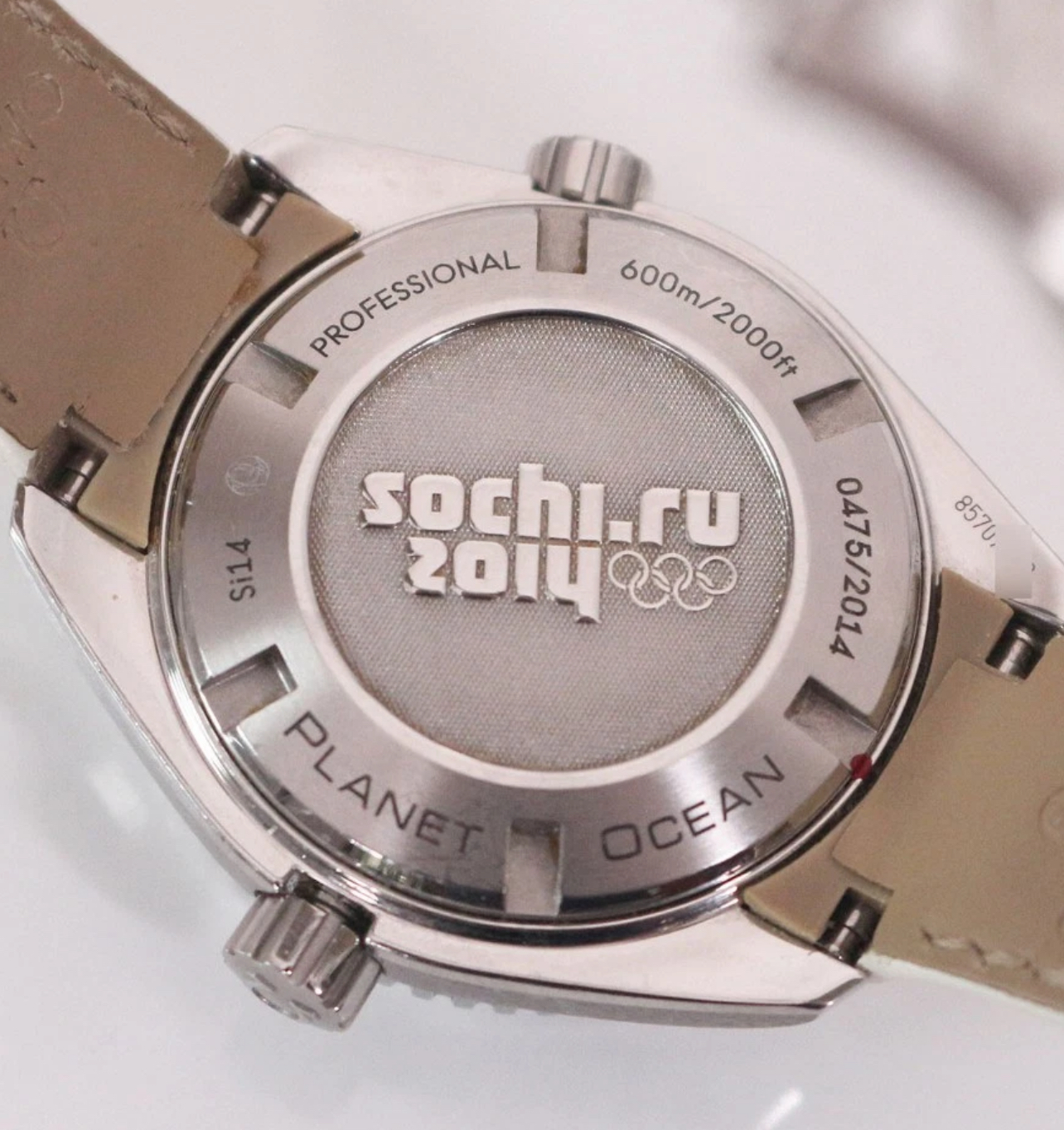

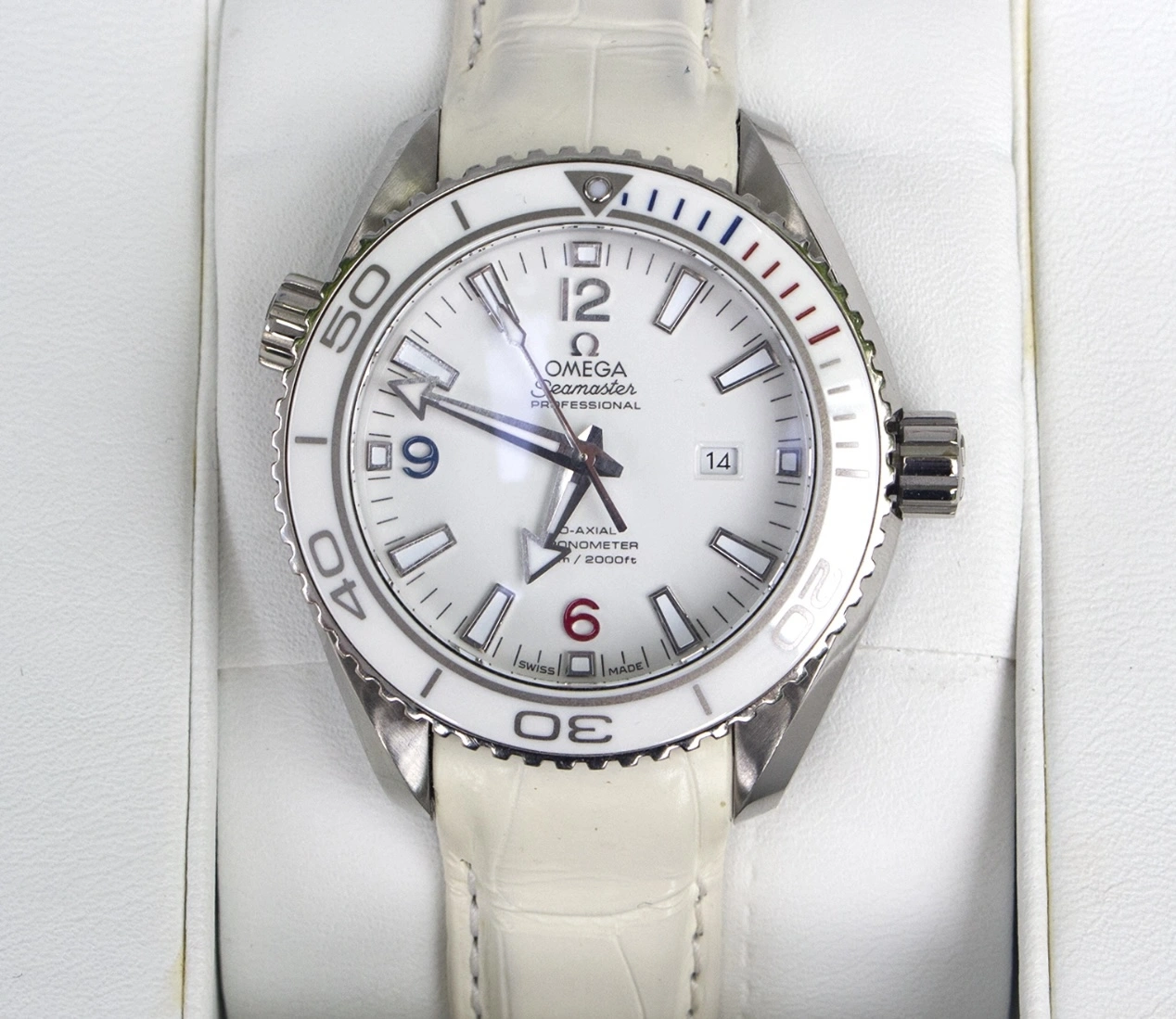

Hiya,

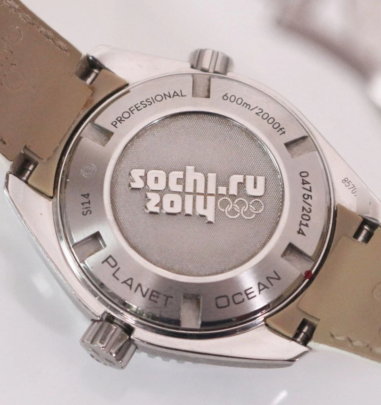

I have a smaller limited edition ladies’ Omega Seamaster Planet Ocean “Sochi 2014” wristwatch. It was released to commemorate the 2014 Sochi Winter Olympics. Case size 37.5, lug width 18mm, I want to buy a bracelet for it as it only has the leather strap.

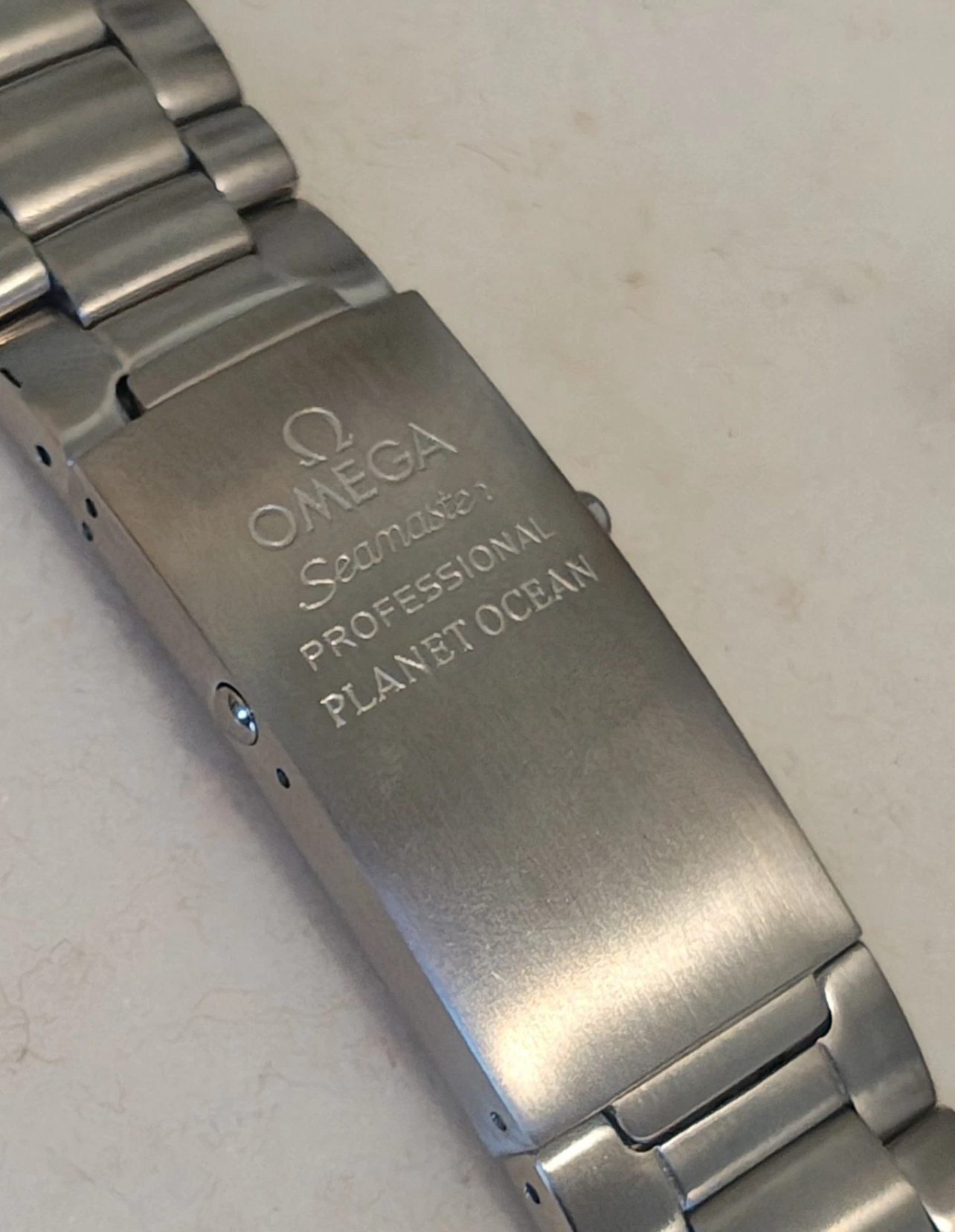

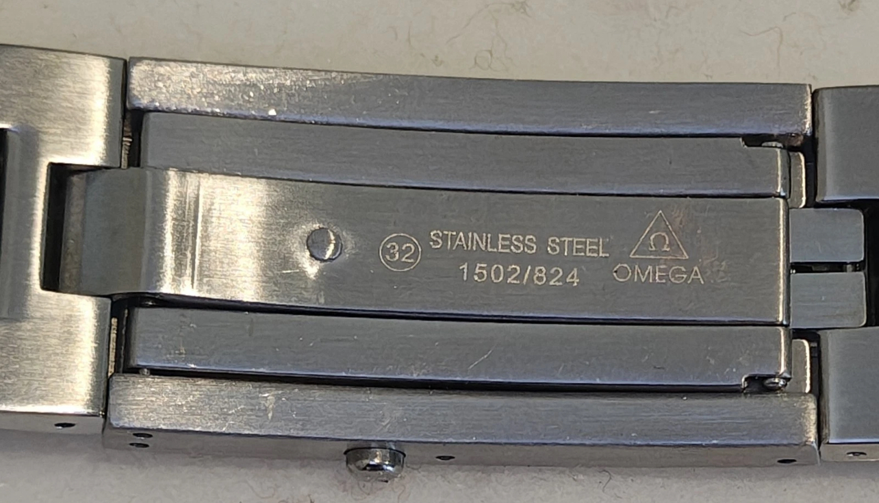

Would the Omega Seamaster Professional Planet Ocean Bracelet 1502/824 18mm fit?
Or do I need the newer Omega Planet Ocean Bracelet OEM 18mm Ref. 832 6592/832
Thanks all

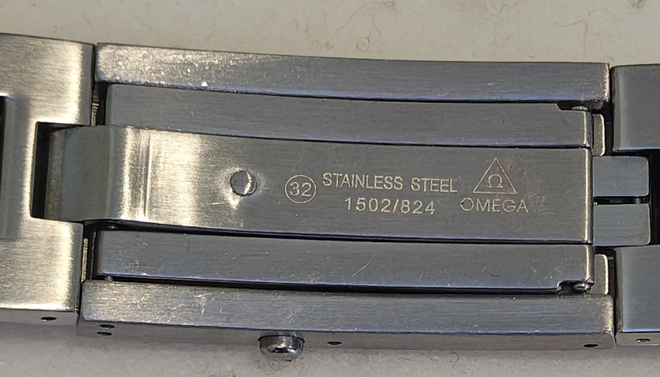

1502/824 will NOT fit the Planet Ocean 37.5mm.
You need the original 6592/832, full part number is 020ST6592832.

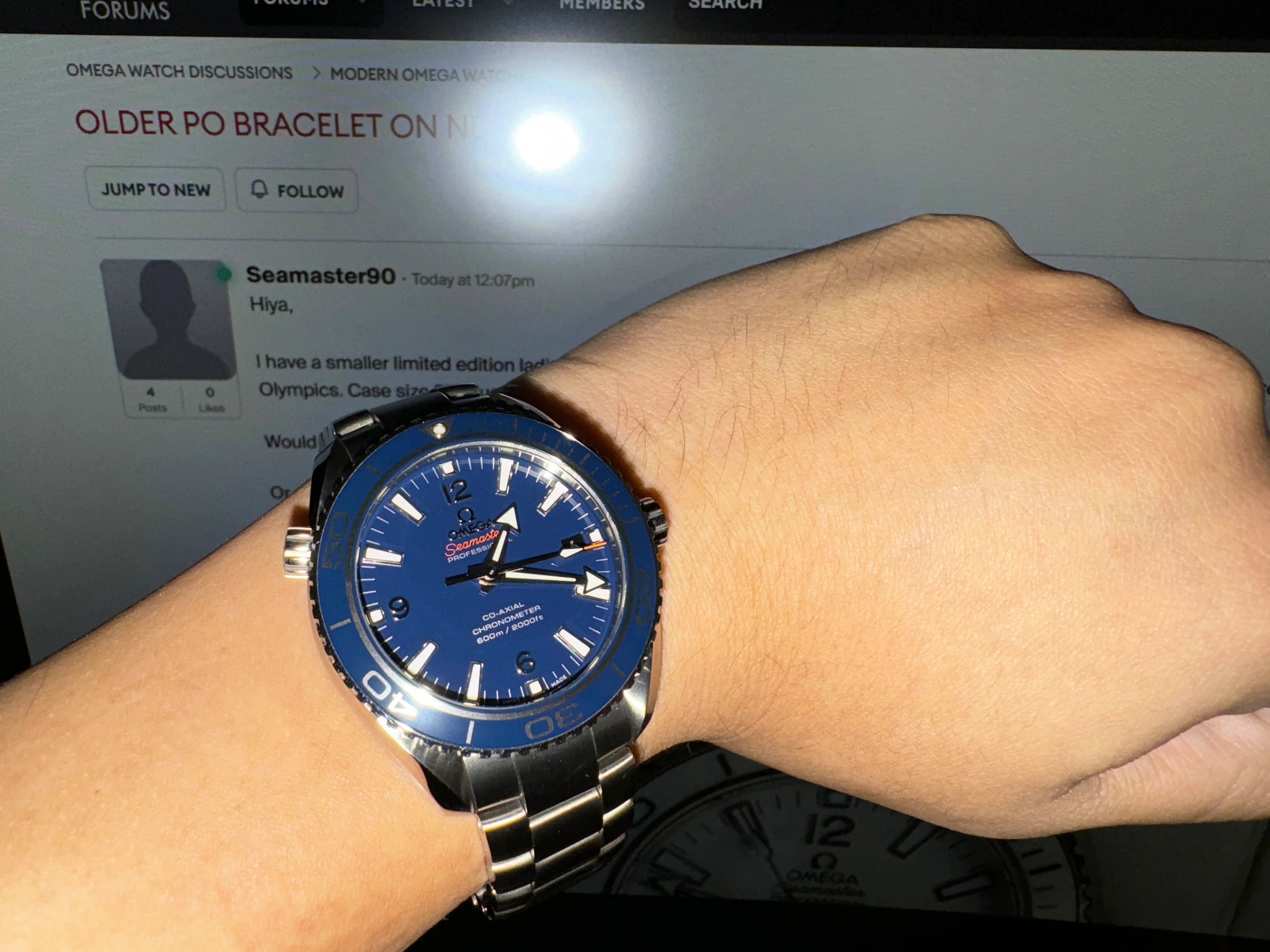

Thank you for the detailed response, did they do a titanium version of the bracelet out of interest?
2,424
3,766
Yes, for the blue dial, ref. 232.90.38.20.03.001.
I have the 42mm version in Ti:
