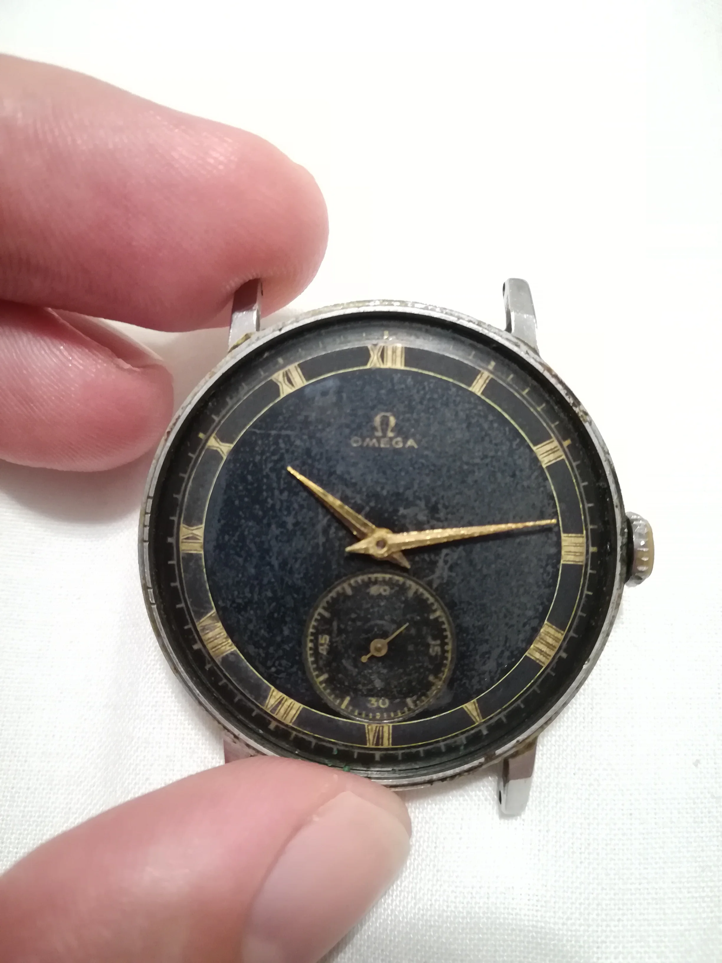

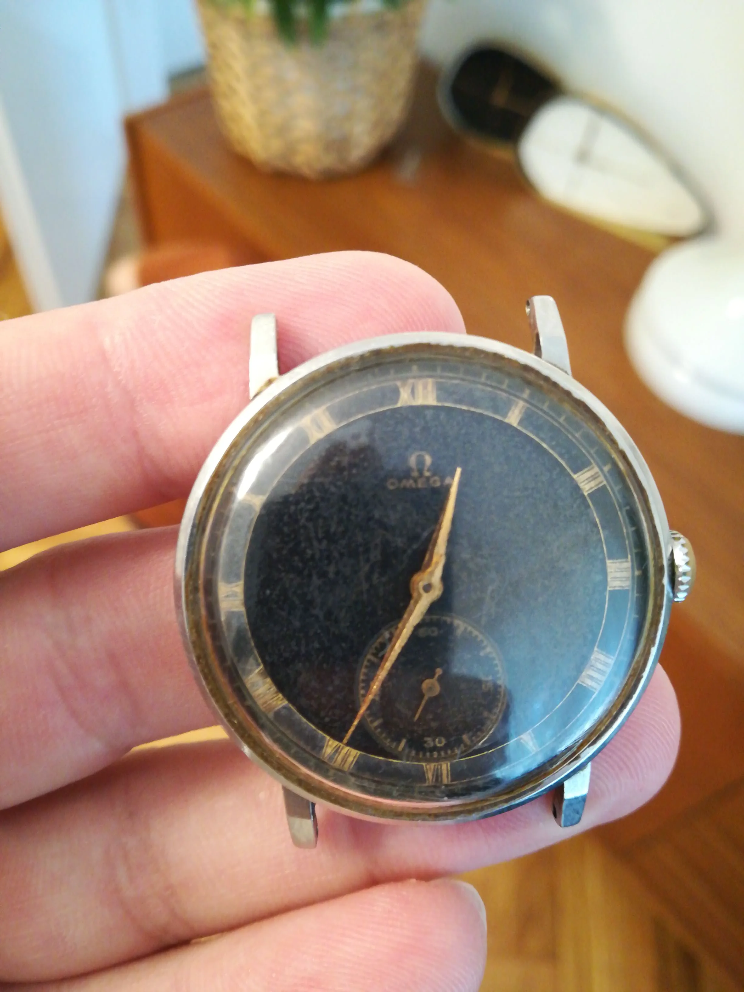

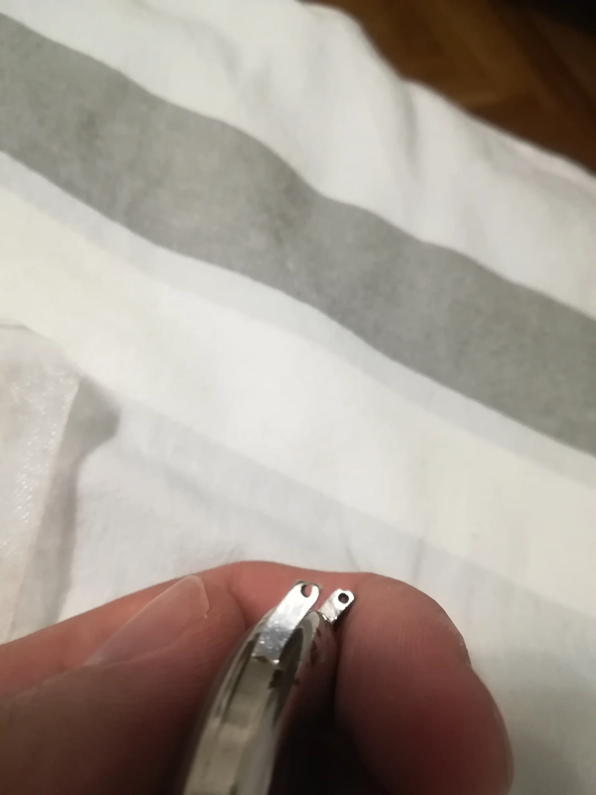

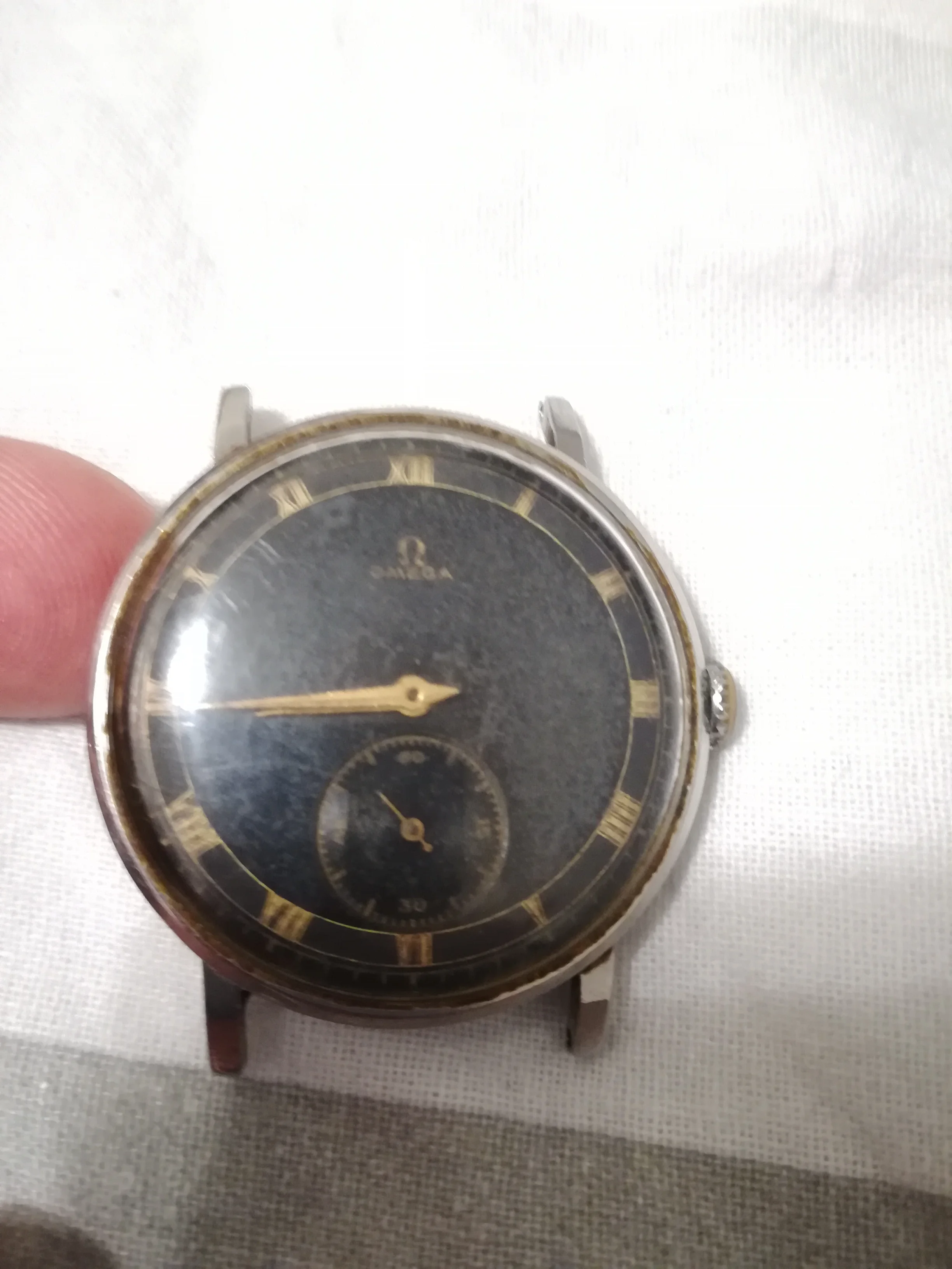

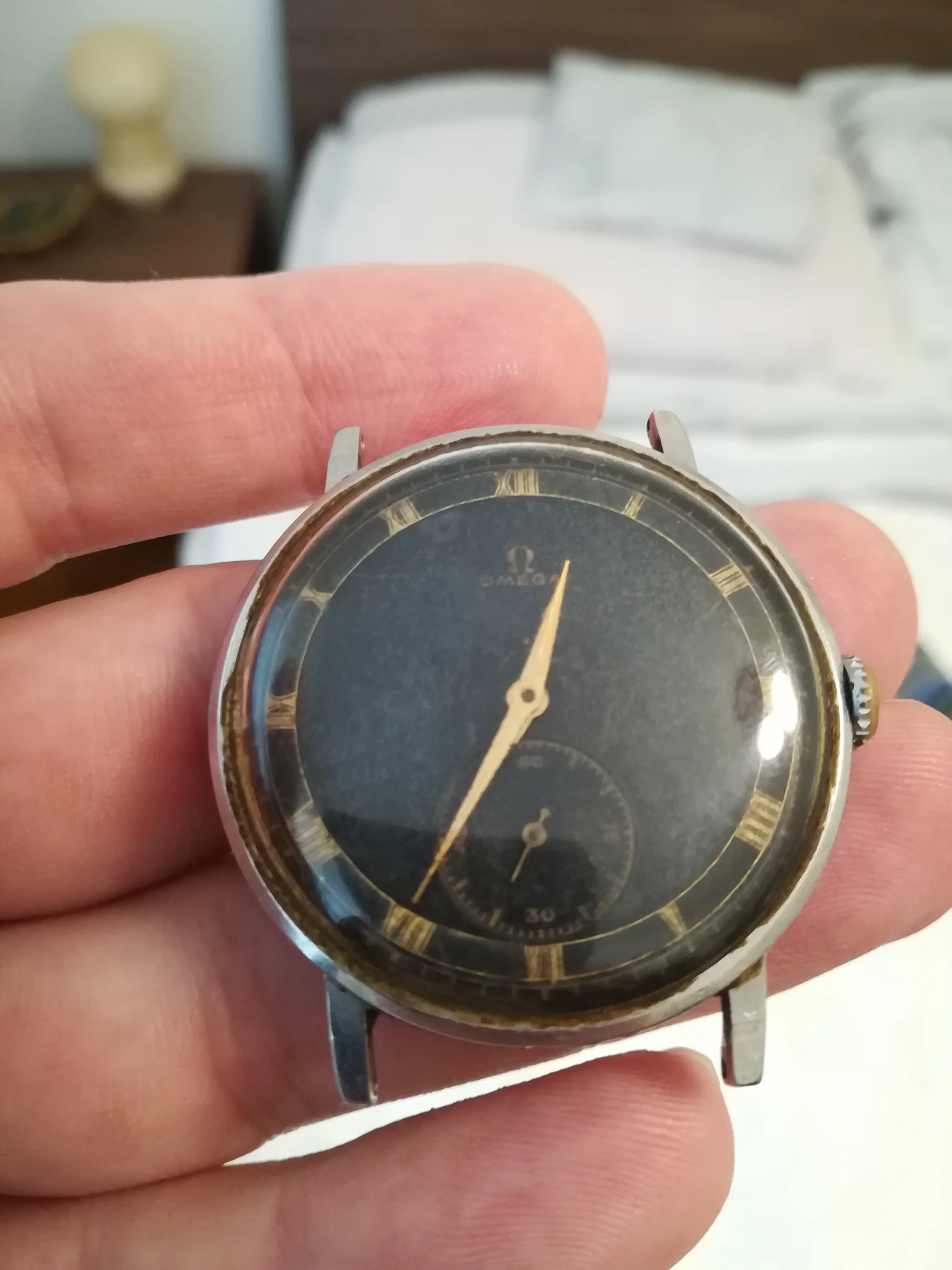

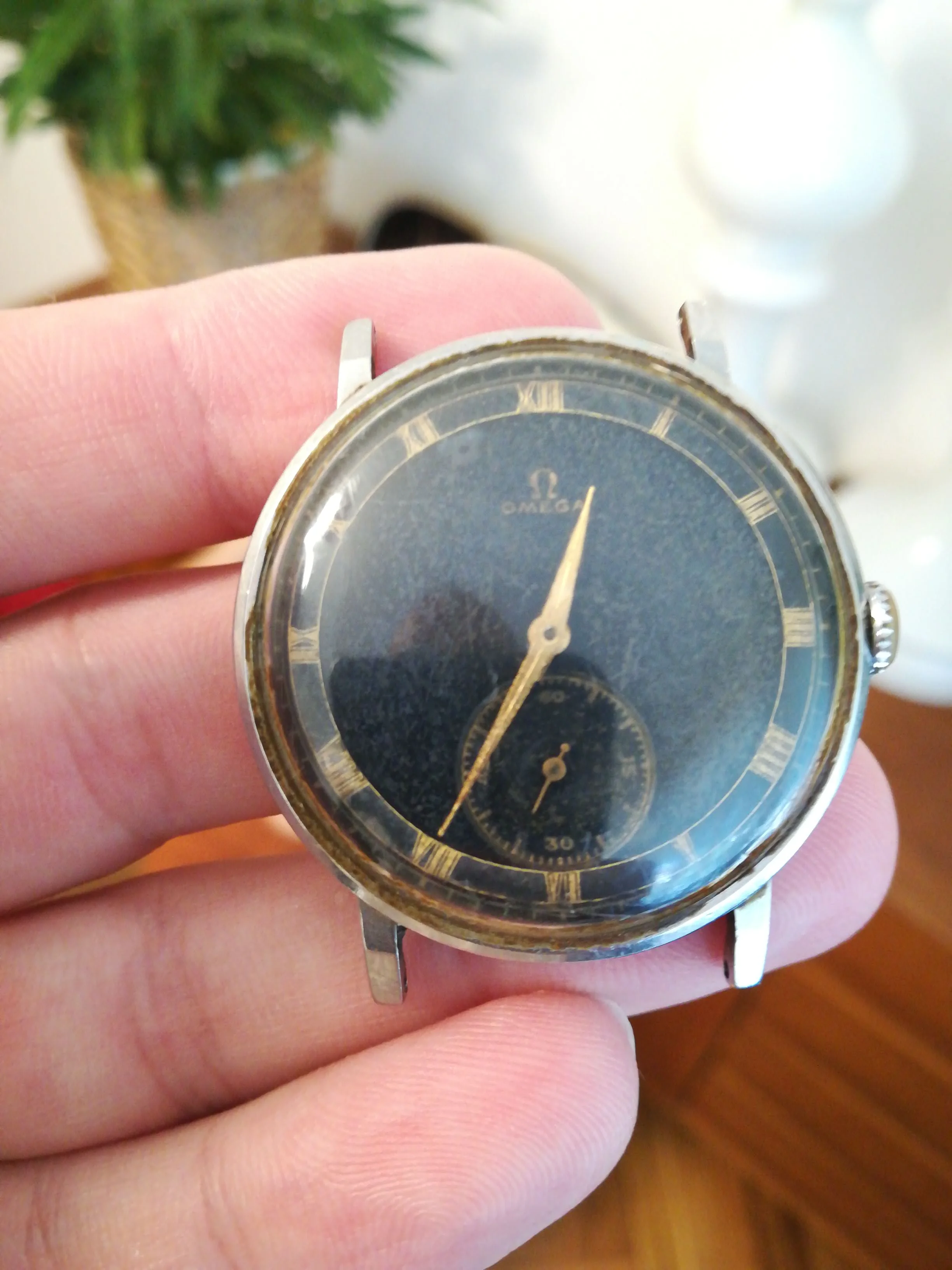

Hi, please are these hands on this omega watch genuine original? If not, can someone send how looks originals? Second question is about the foots, especially the one which is on photo detail, its very thin, is it repairable somehow? Thanks for reactions.
3,609
7,685
By "foots" you mean "lug" the part where you install the strap - right?
I see there is damage - yes this can be repaired by laser-welding.
IMO the hands are not original to this watch. But its difficult to see details (indexes) on this blurry photo.
Try to post a much clearer photo, so we will be able to help you.

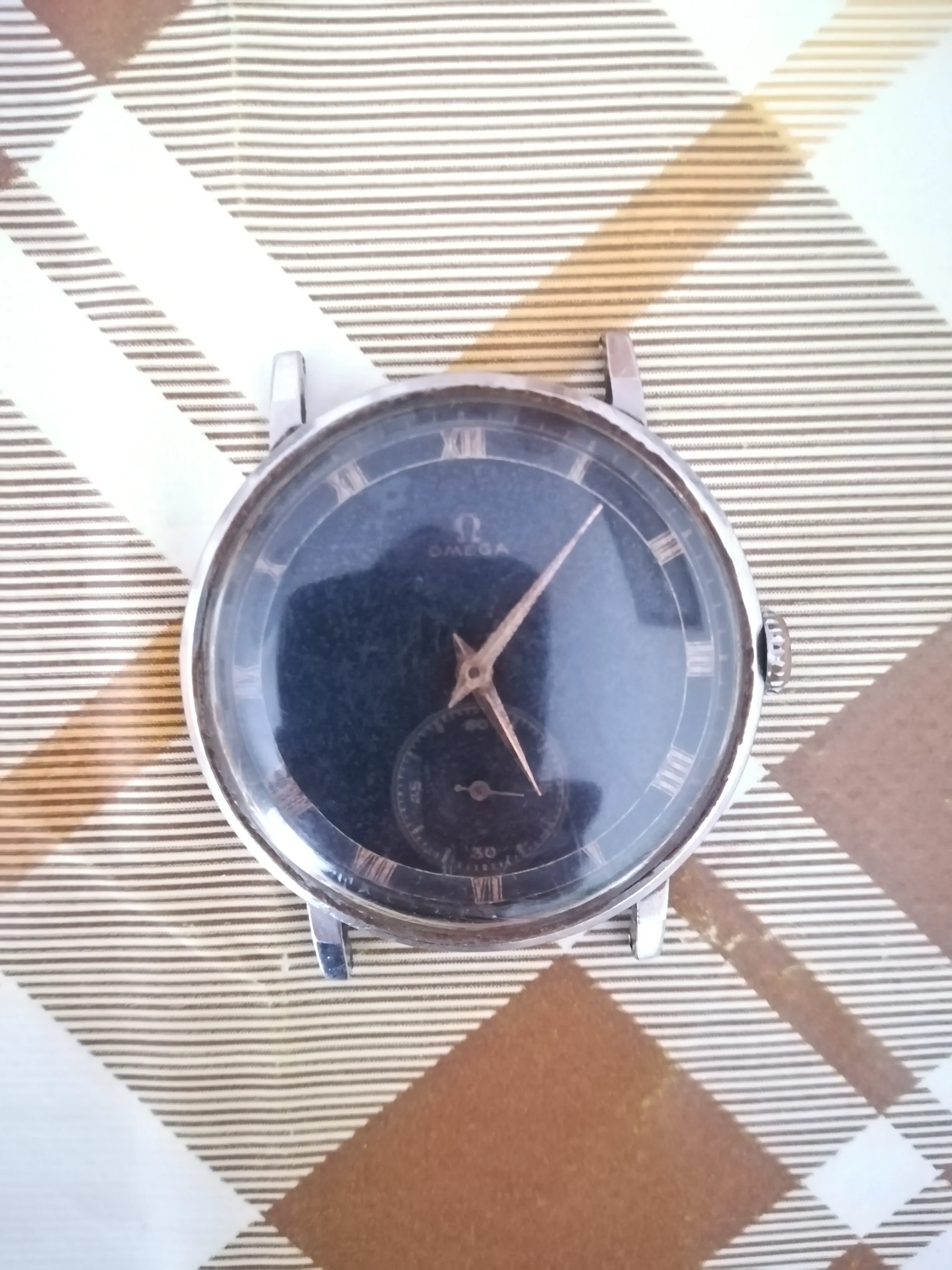

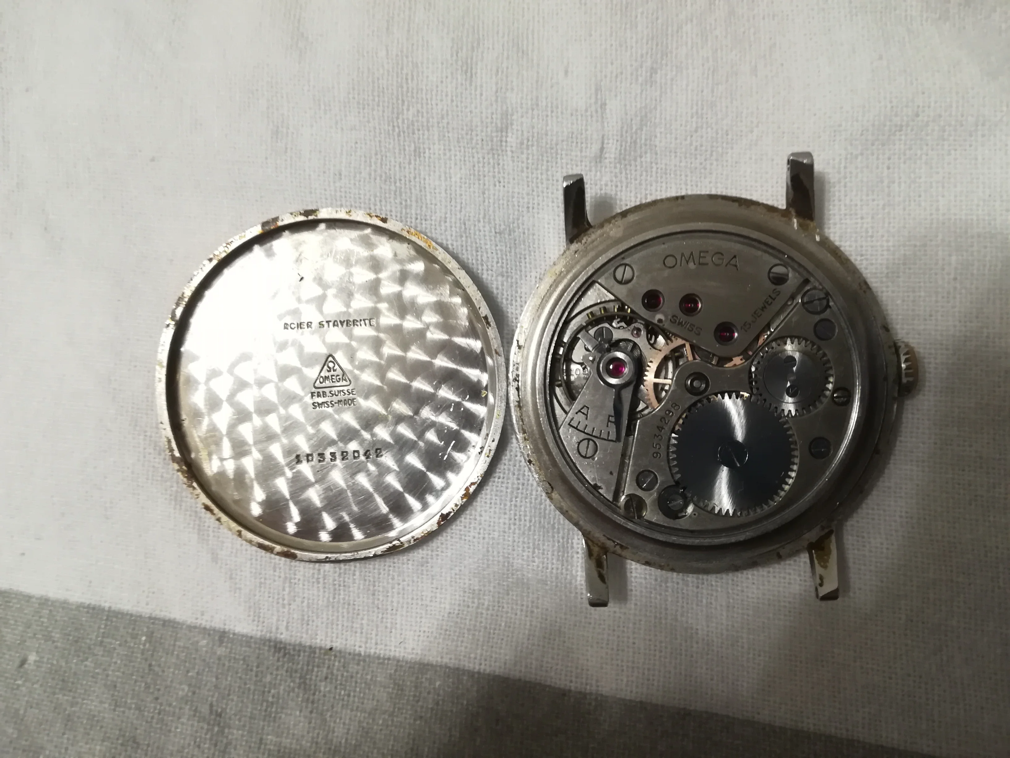

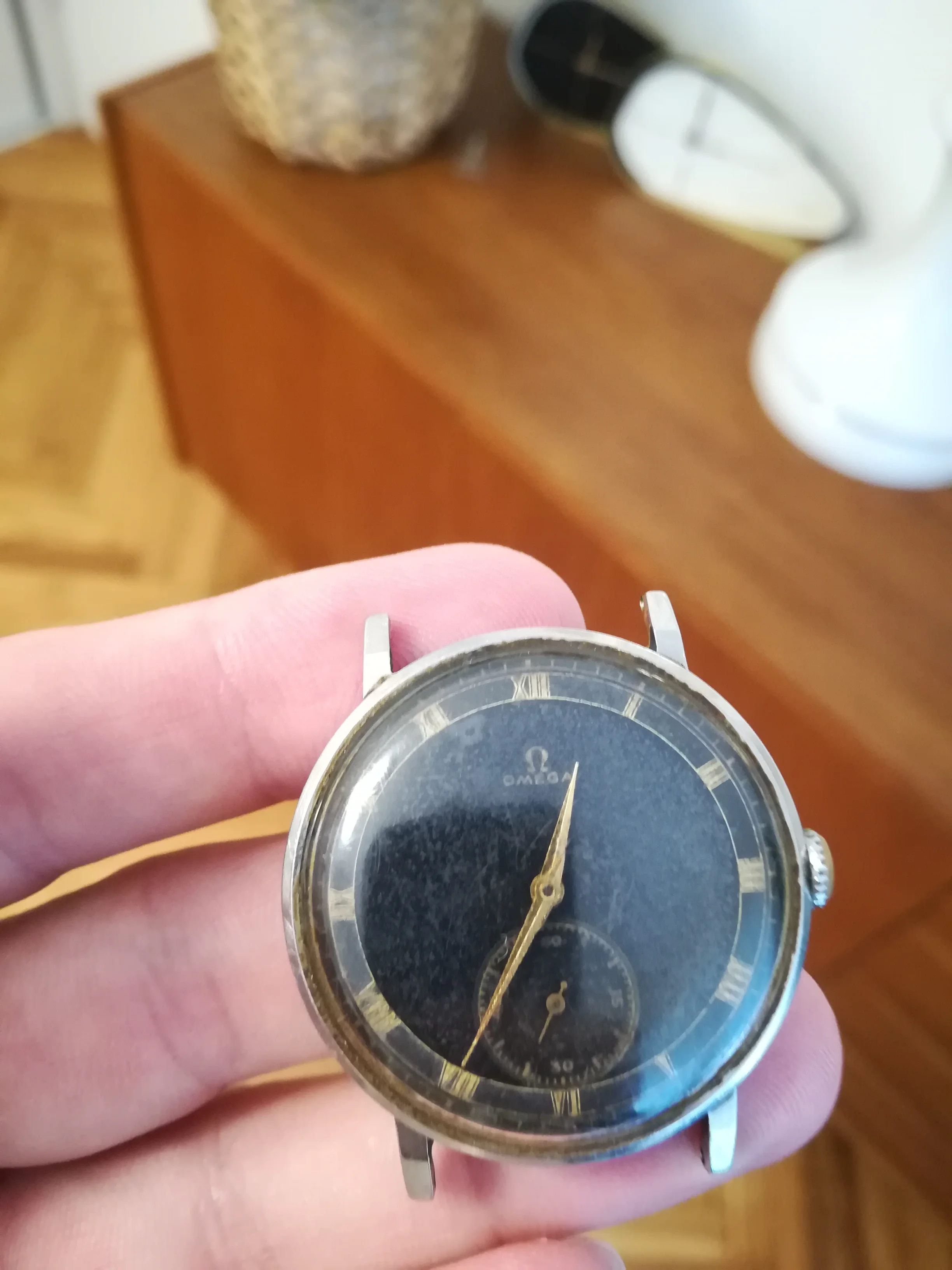

Thanks for reply, i attach more photos, hope will be better. I did not find the on internet. Case is Cca 37mm width.
3,609
7,685
Although the photos are not great (I know, black dials are difficult to take photos...) I guess the numerals are luminous.
Then you would need luminous hands and a new seconds hand because the old one is broken.
24,749
54,973
Quite an interesting dial, actually. It's too bad we can't get a good photo of it.

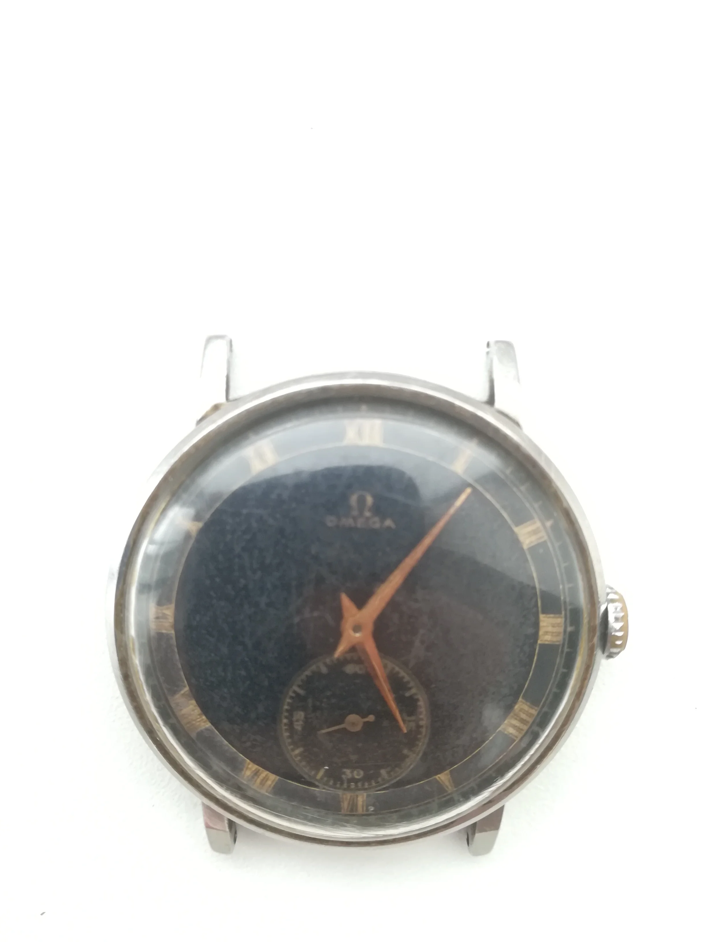

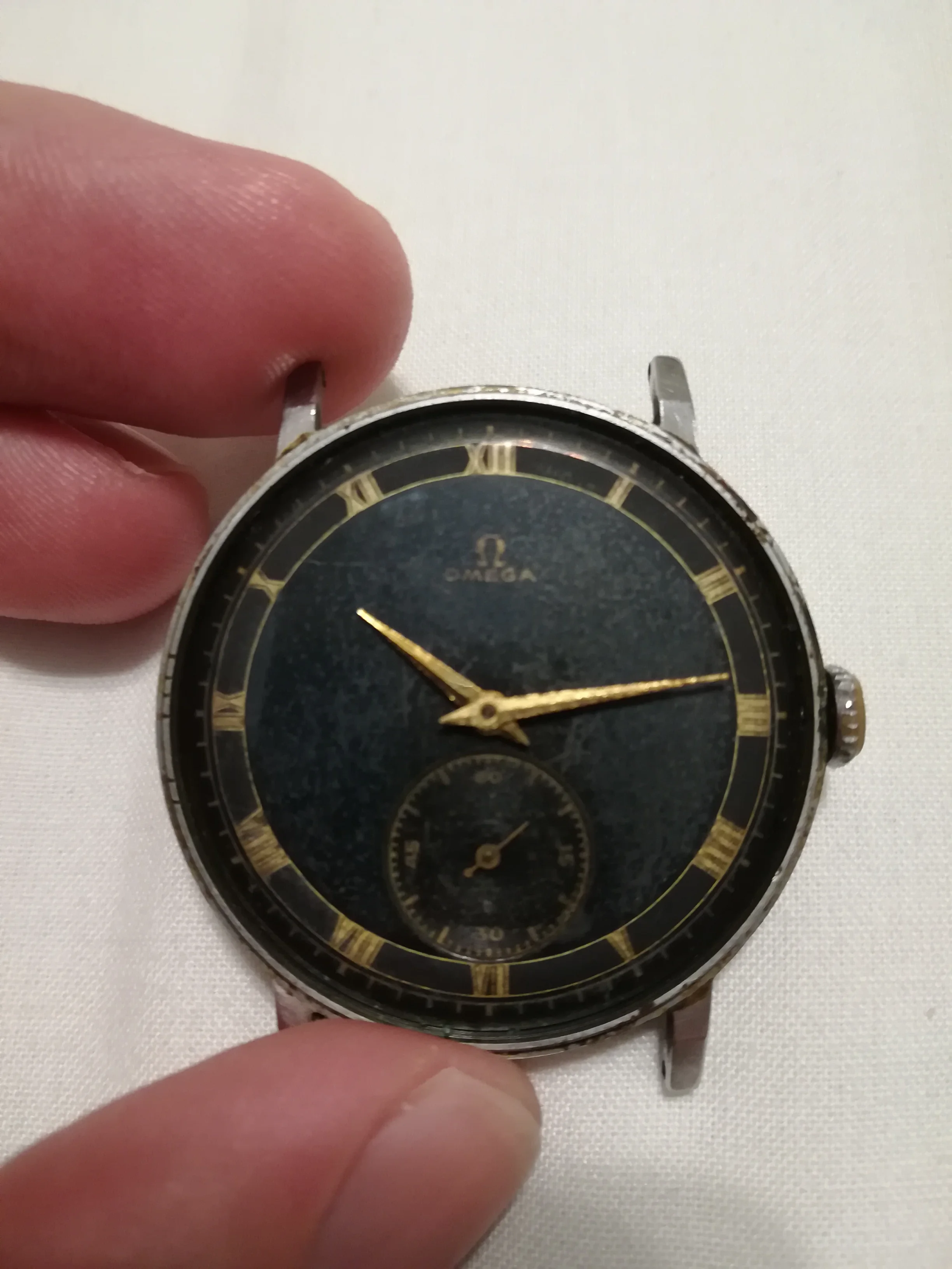

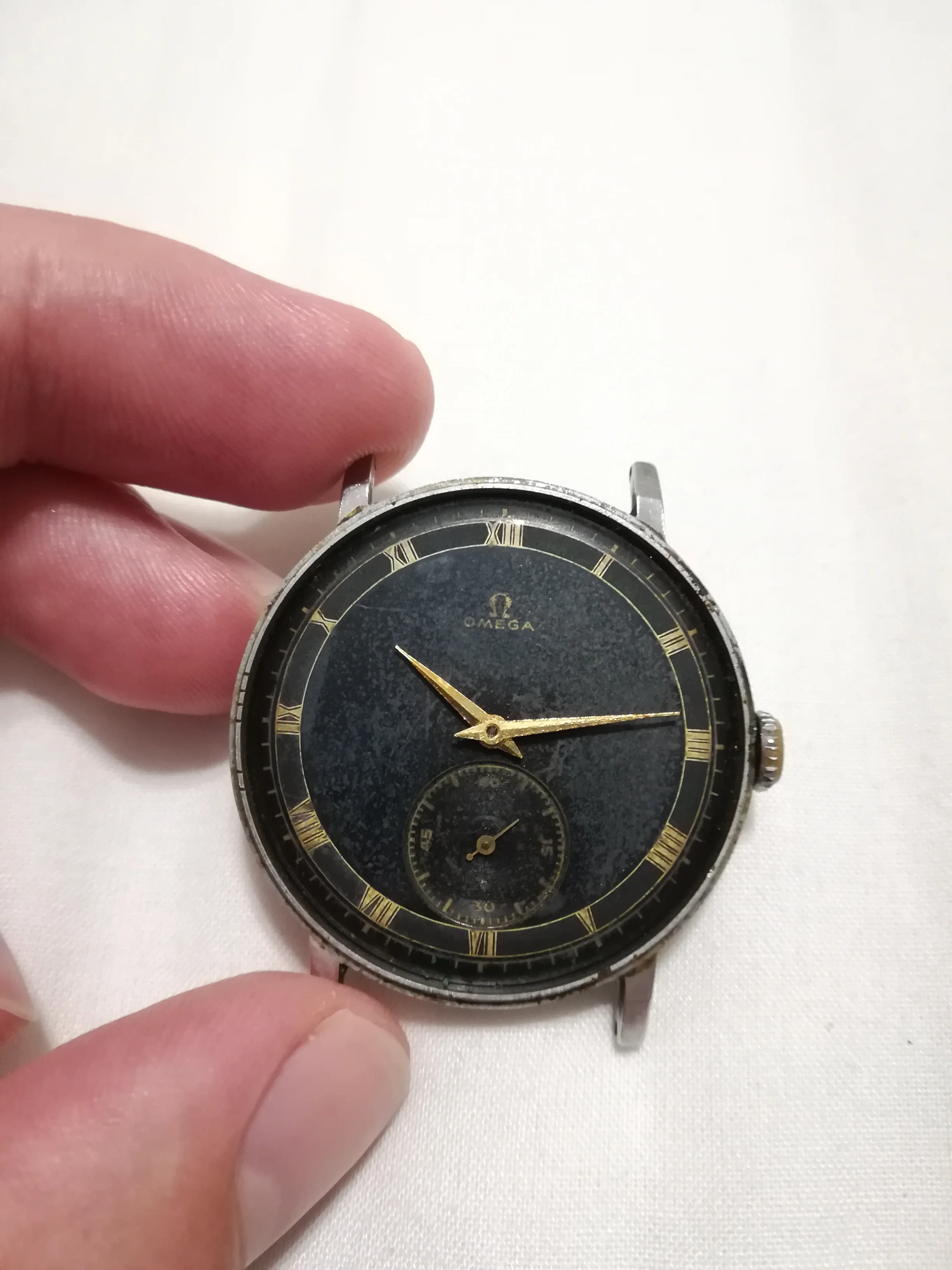

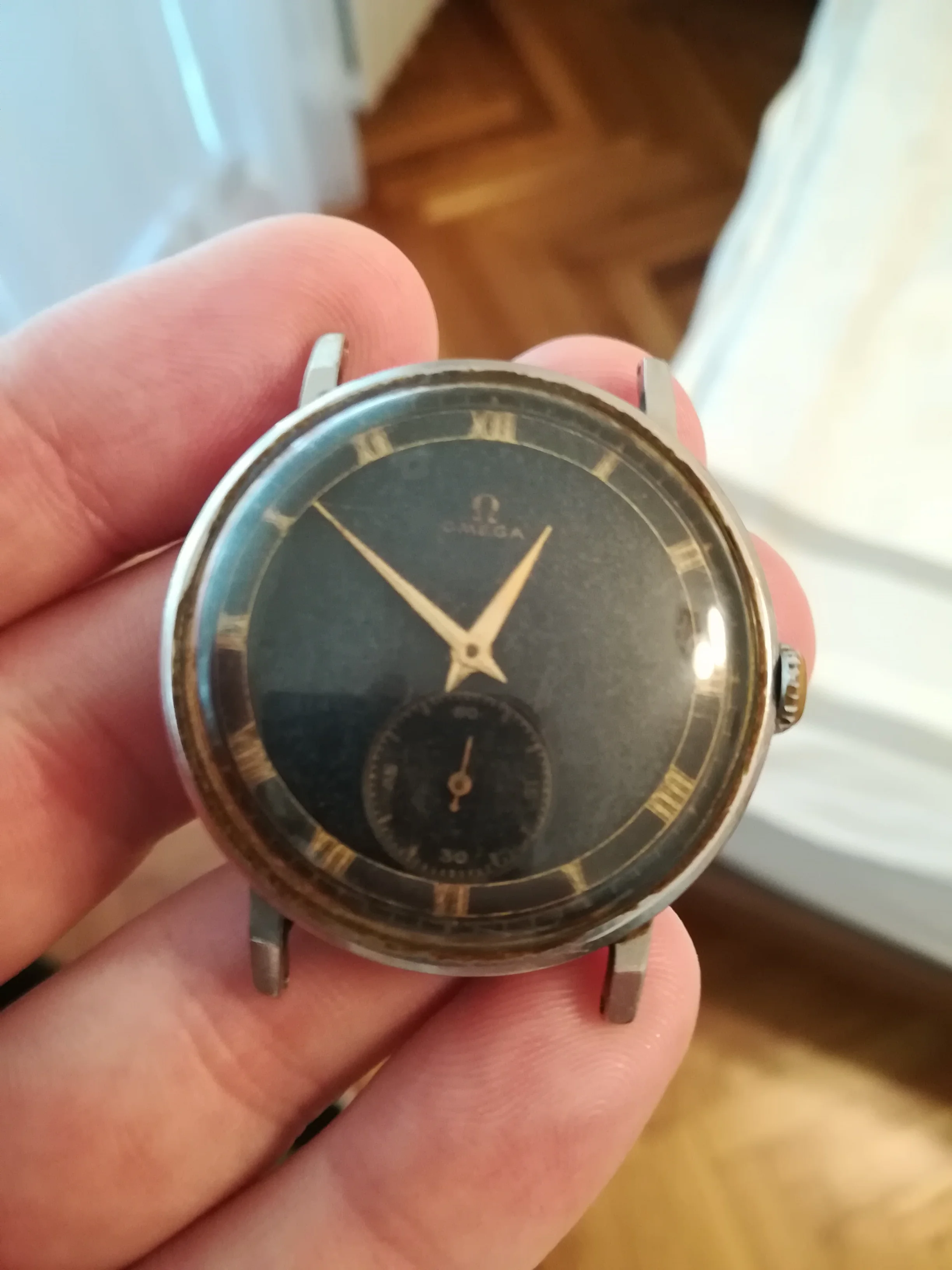

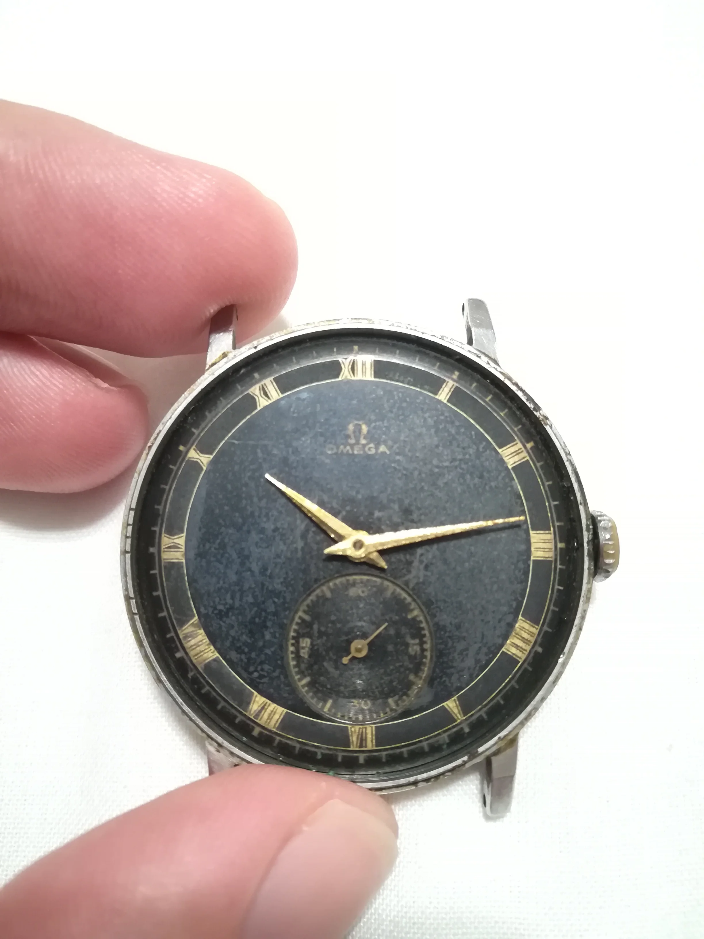

Thanks for reactions. I try make better photo without glass
153
154
Thanks for reactions. I try make better photo without glass Wow,
Wow, much, much better!
Especially the first photo, its very nice.
Non-luminous i think, very interesting configuration.
I think hands are not original, as others have stated.
Very attractive nonetheless, would be amazing with the correct hands.

Hi, thanks for reactions, and what are correct hands please? I still dont know... And if you can tell me cca price of watch in this condition, i would appreciate it. I plan to restore them and keep them, but I am curiois about price.
15,791
47,301

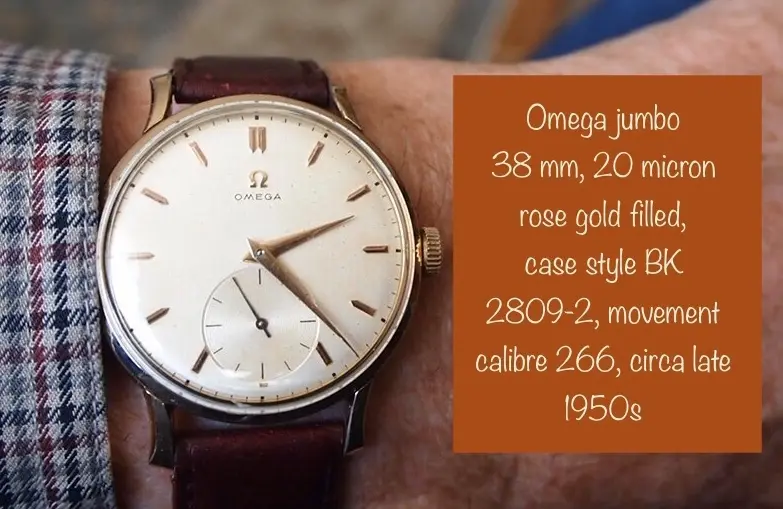

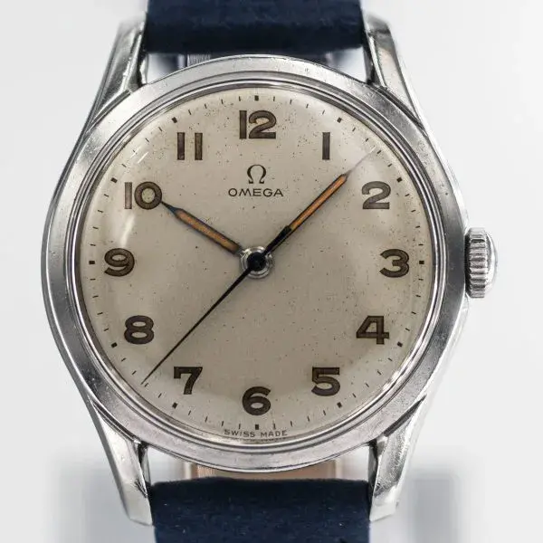

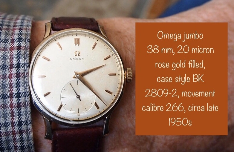

It is difficult to say for certain, but your Omega appears to be a “jumbo”, or about 38 mm diameter. I’ve shown my jumbo for reference. The hands on mine are original.
19
5
Thanks, yes they are bigger, about 37mm diameter. But I think mine are older, someone wrote me that from seriál number its year 41-42.

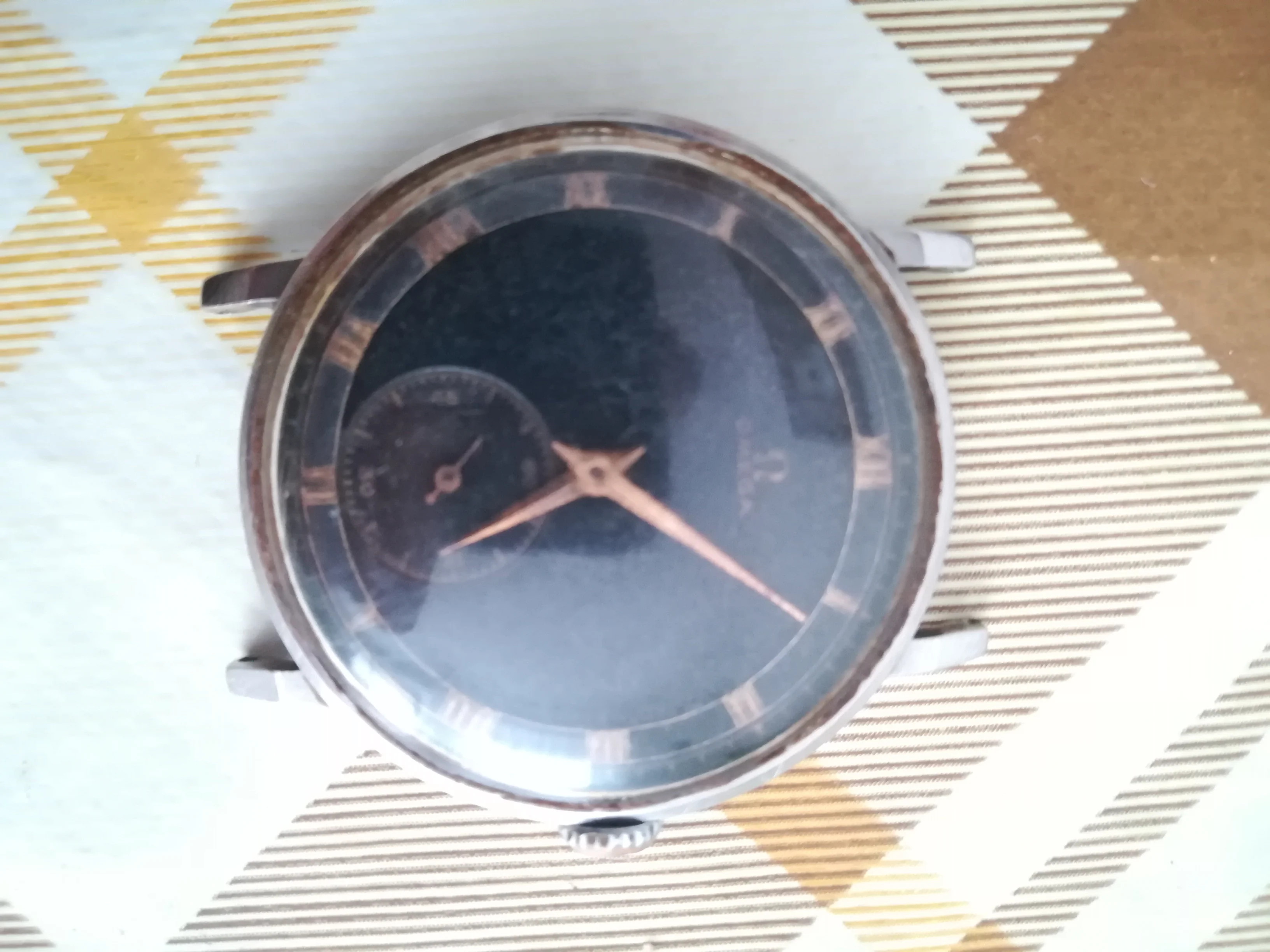

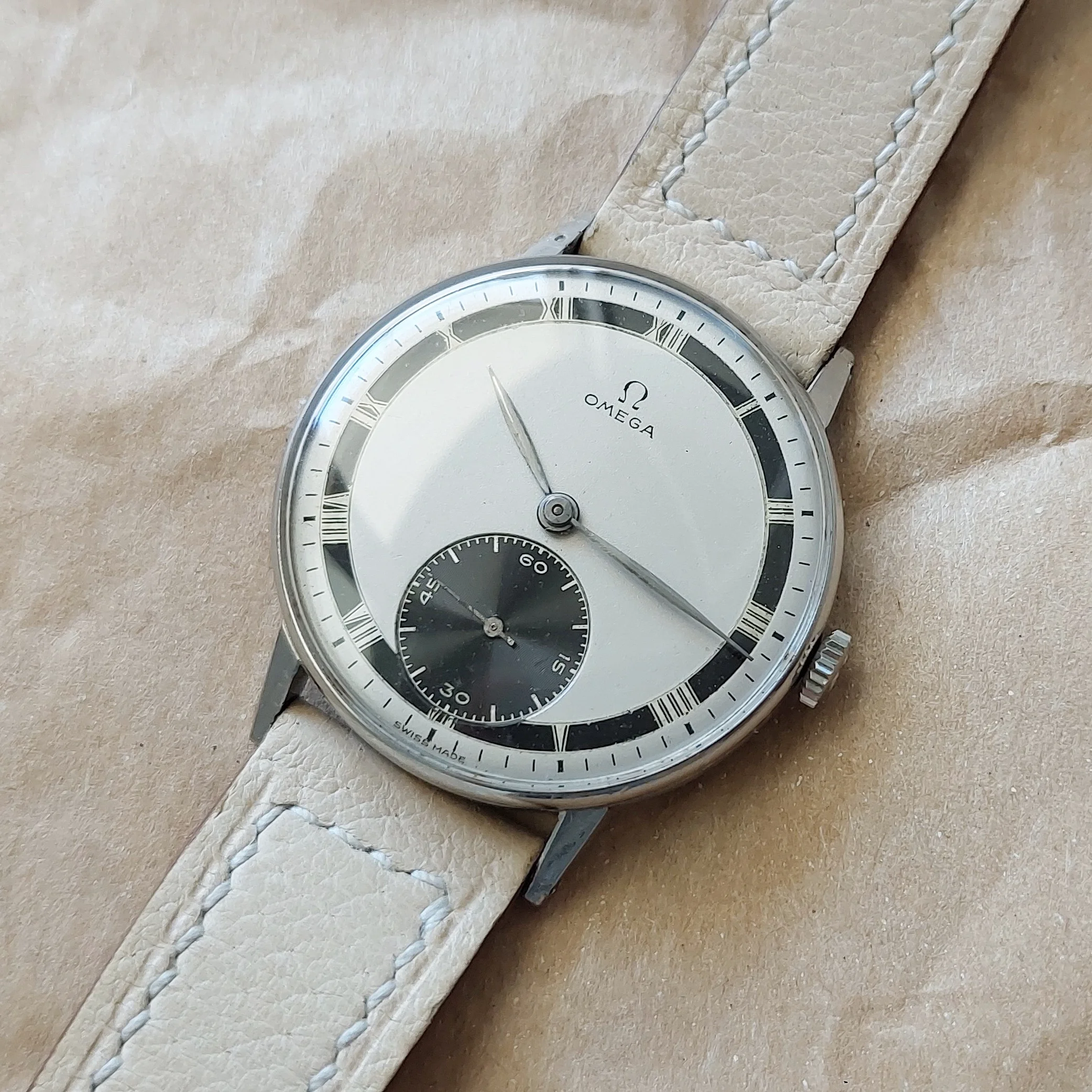

Very nice dial! Here is mine 😁
Nice! Looks amazing. Mine dial looks very similar, any idea where to find/ buy hands and crown?

Please any advice where can I buy correct hands and crown?

Hands may have been Luminous baton with fine points style
153
154
My guess would be gold leaf hands like Zapatta's example, just in gold.
No lume as Fallout Boy has said.
Make sure to find an example that fits the correct caliber while having the correct length at the same time.
