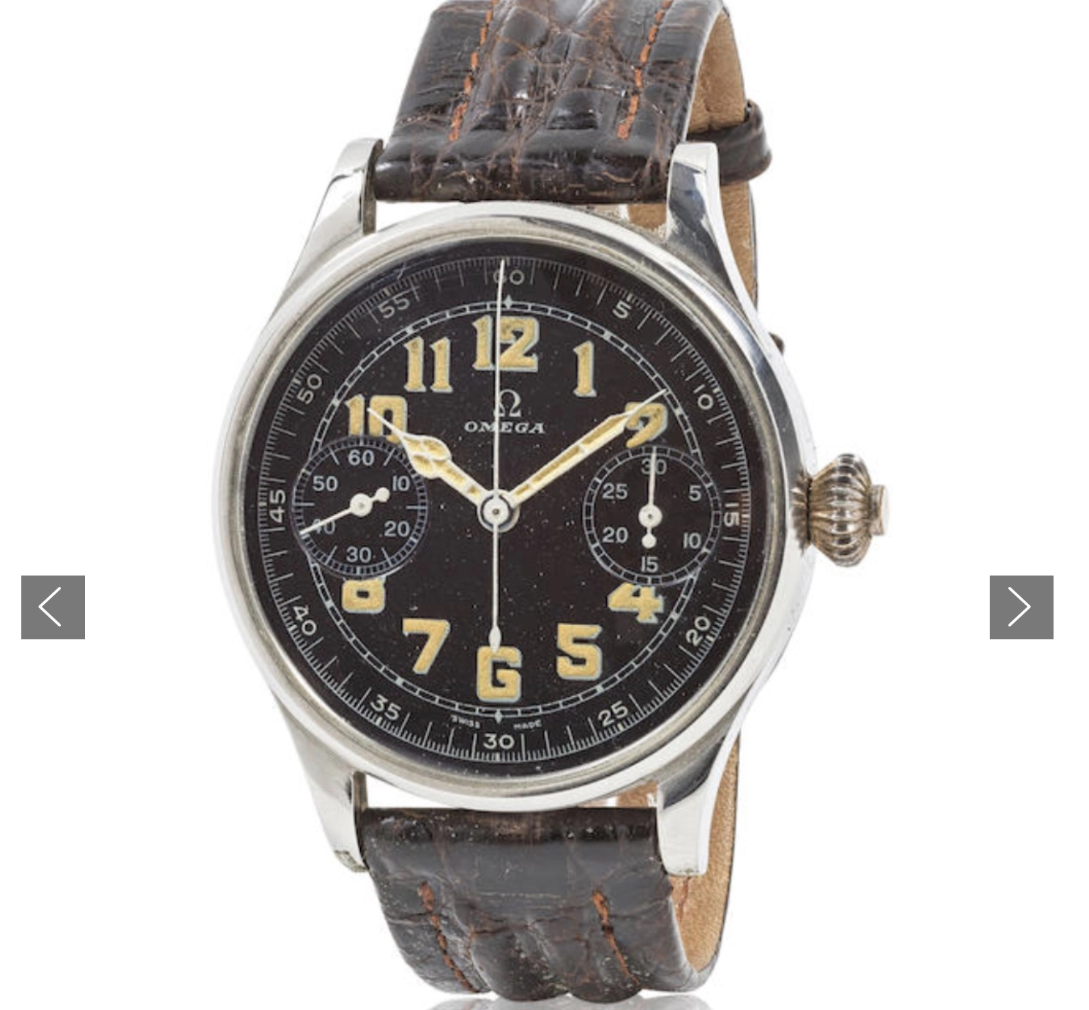

Hello. I am having a hard time believing this dial is original given its age which is 1930. Do you have any opinions? (Edit: I think it’s cool as hell)

Yes it looks a bit too colourful.
Don’t think that is tell but just inconsistent printing throughout - see the difference in the 2 in 20 vs 2 in 25 as an example. Every 5 on outer scale looks slightly different and printing of Omega looks off from other old Omega chronos. I am no way an expert on this model but just my experience looking at these.
Also think good rule of thumb is to be pretty concerned with any old black dial.

Another paint job vote. ‘Swiss’ of Swiss Made really wonky.

Thanks for all the responses here. I never would have thought into inconsistent printing.
