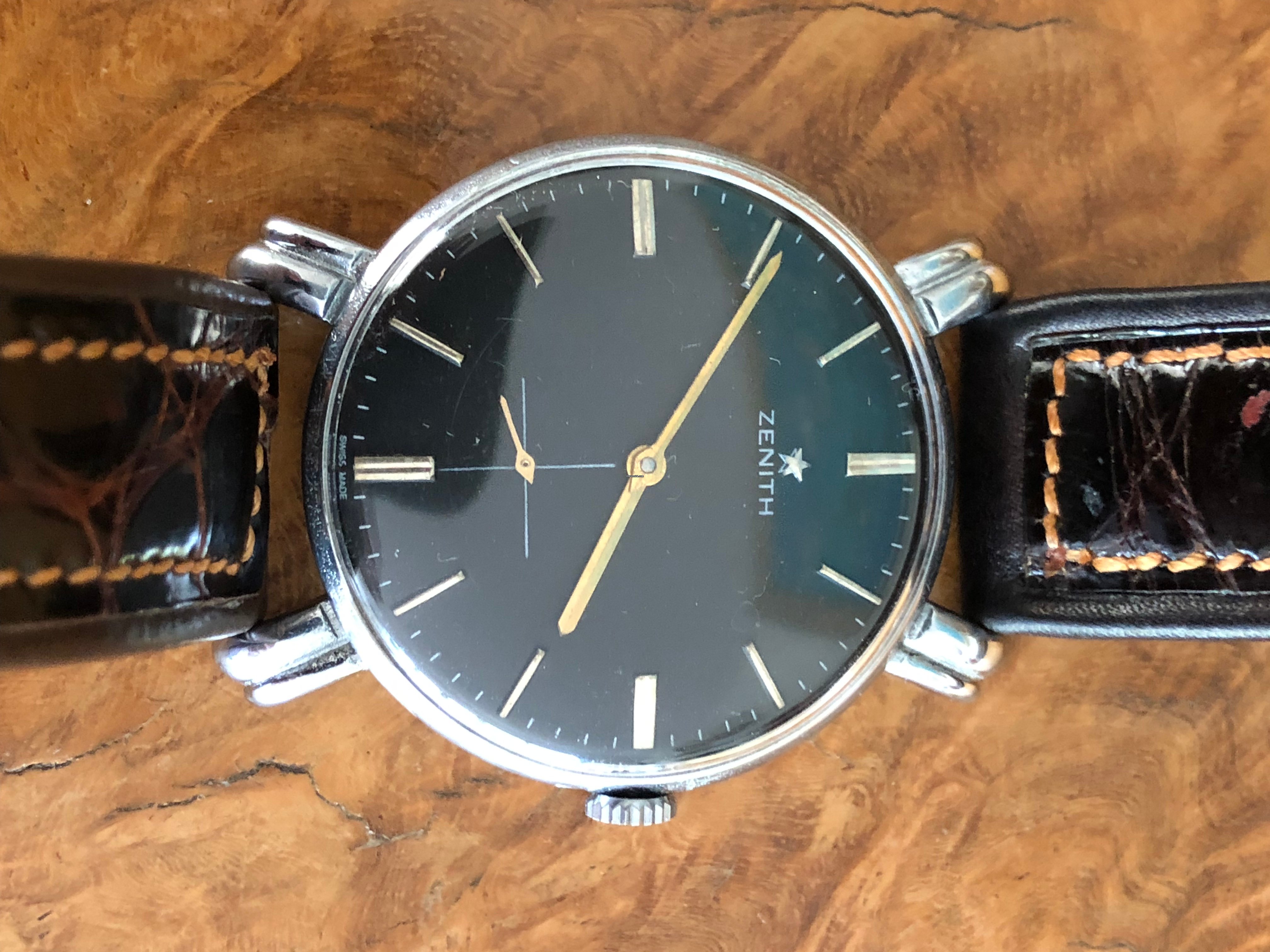

Do you think this one is a redial?
16,305
45,025

Yes, probably a redial IMO. And the applied star is misaligned with the underlying printed star, which is fairly bizarre. No way the watch came like that from the factory. I also suspect that the hands are replacements.

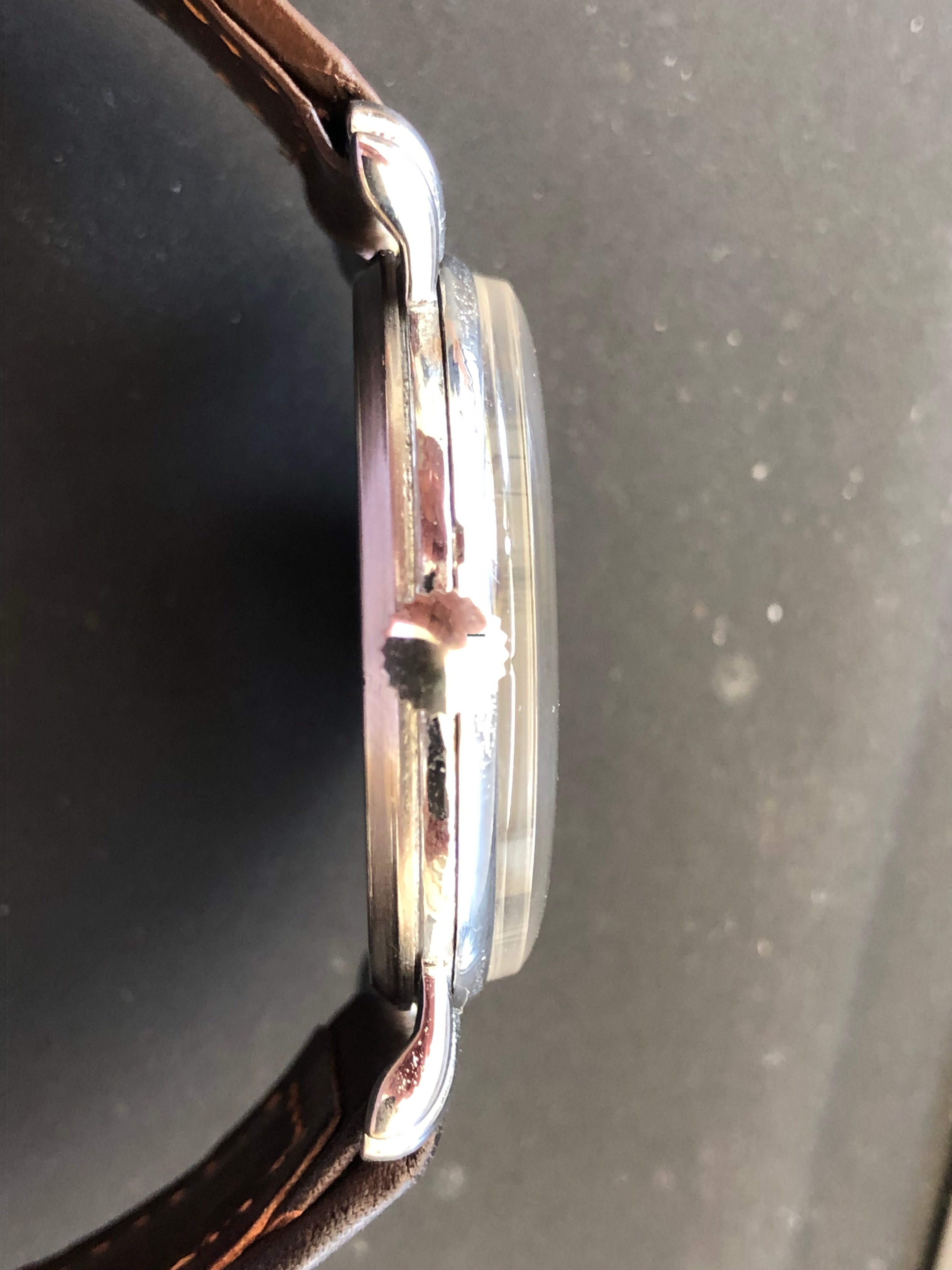

10,823
16,841

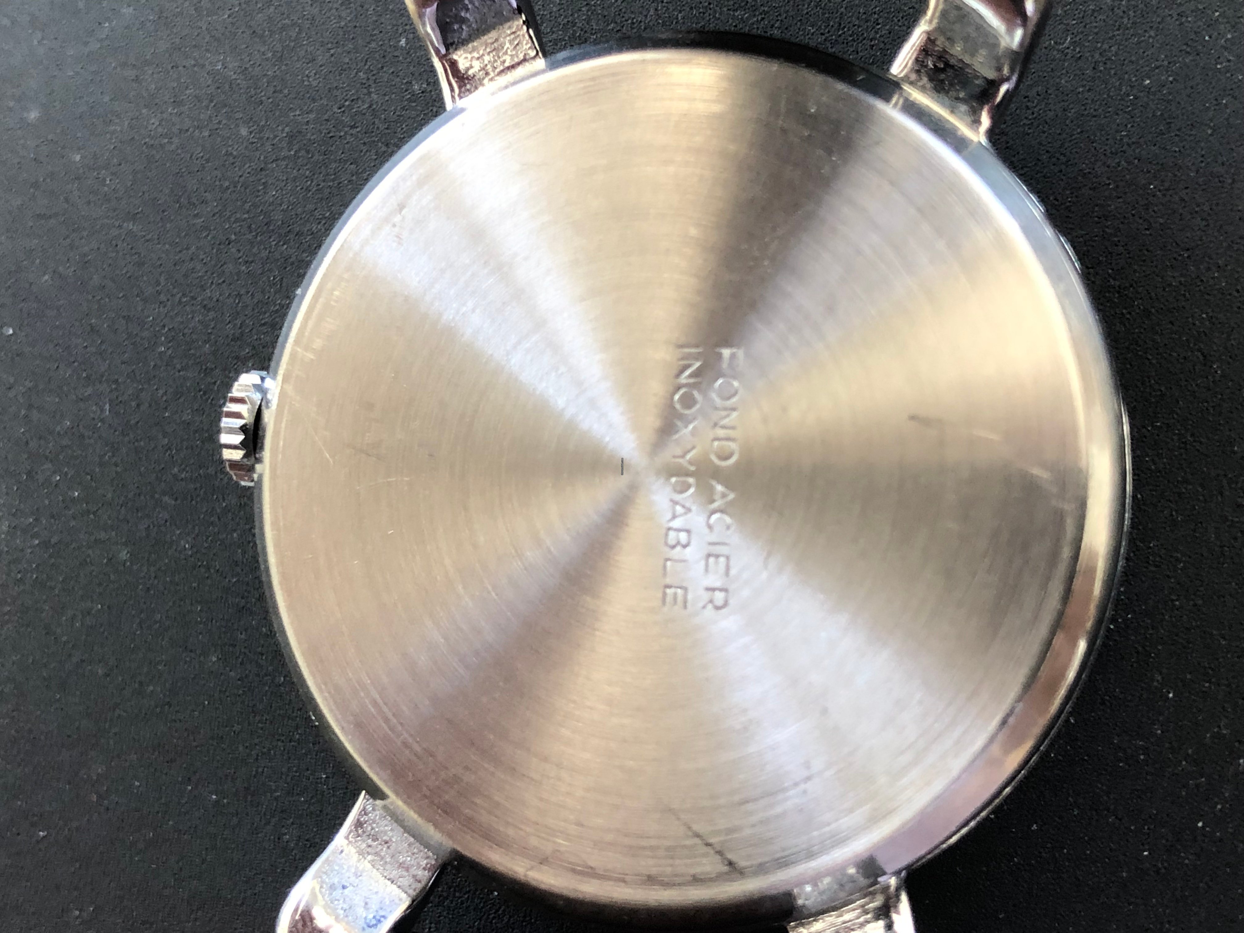

I am no expert on these but that caseback text looks pretty low rent, more commonly seen on low end vintage models. Even if it is straight, the thing with the star and the back would put me off it altogether.

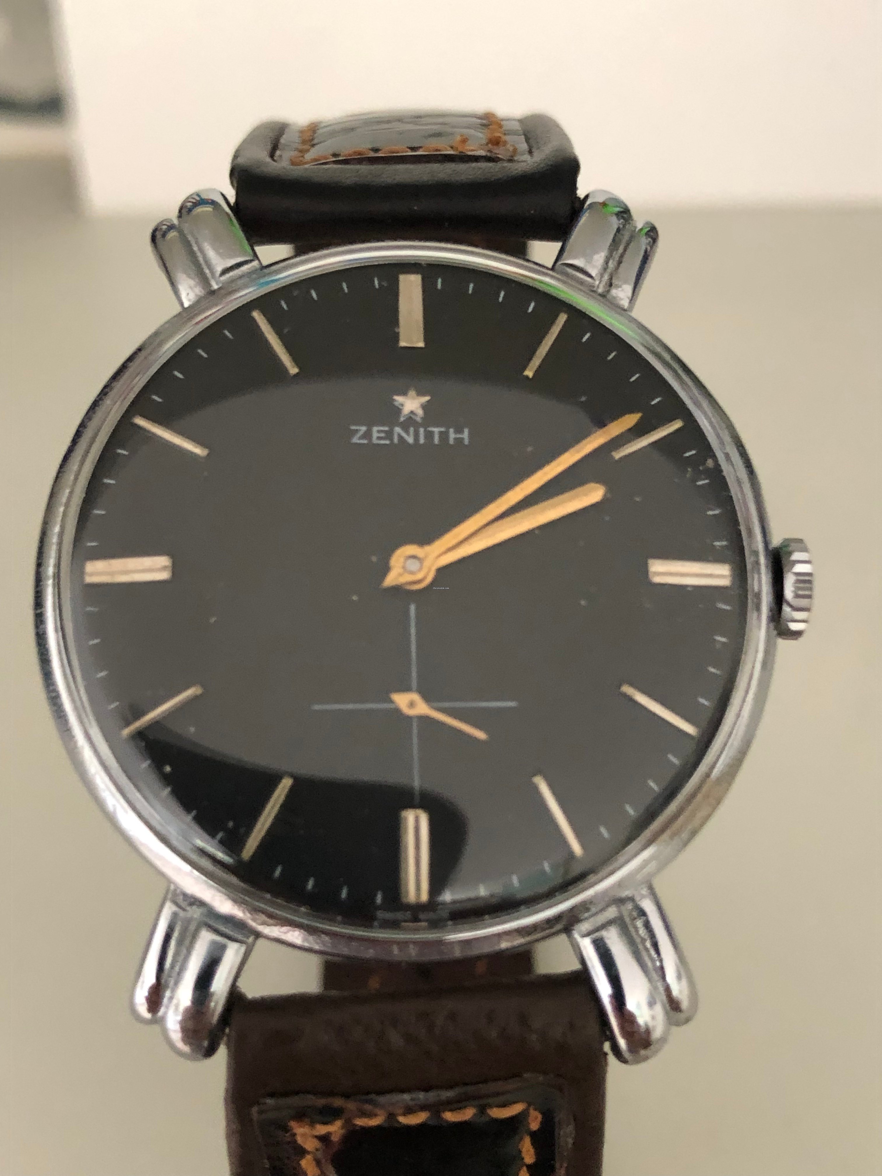

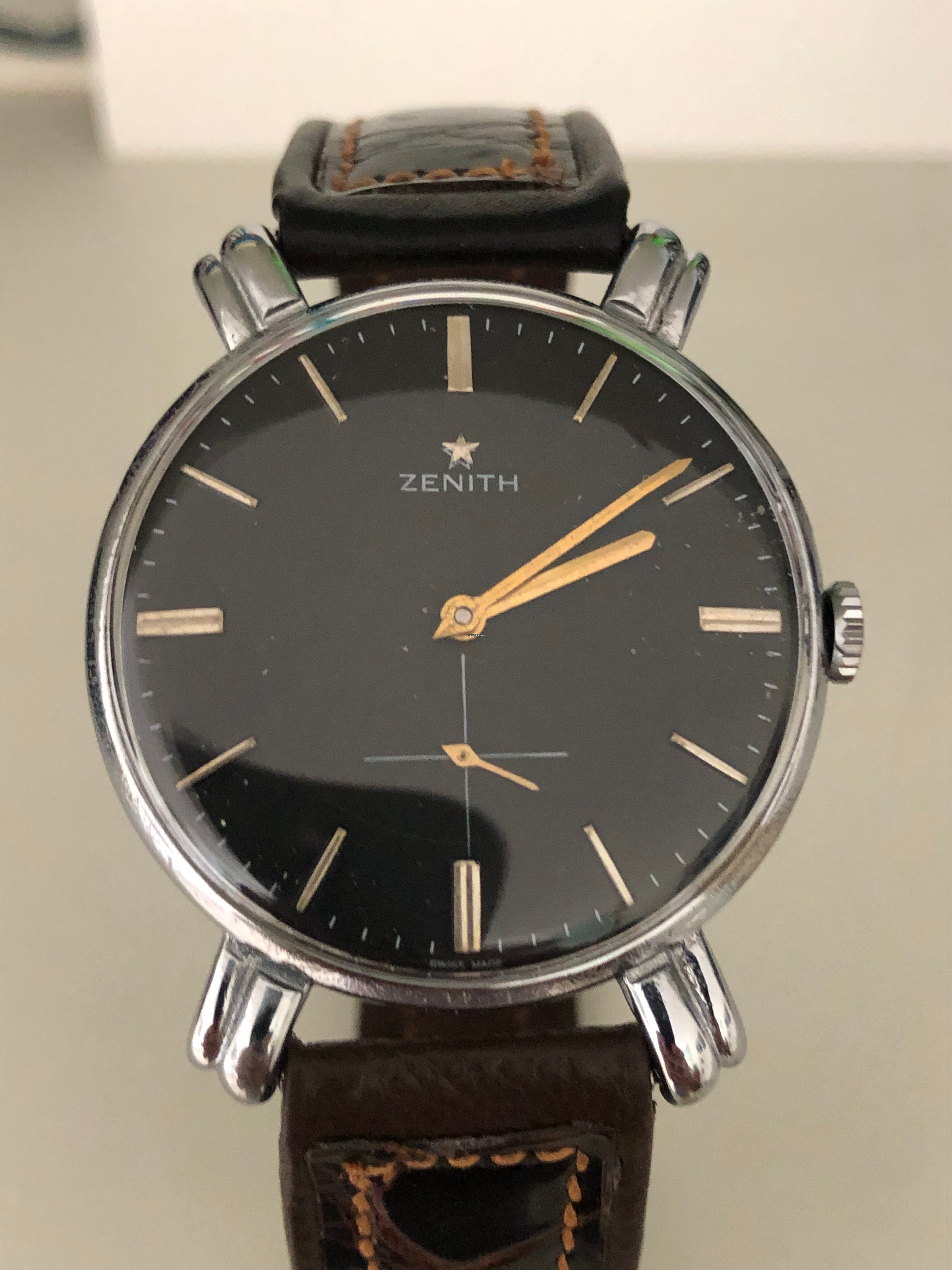

5,539
9,478
Minute tick mark spacing is inconsistent, 44 sec mark is diagonal. Crosshairs for small seconds do not align with 6 marker.

1,997
3,582
It’s a mess. Why they put a star over the other star is bizarre. Could be original case as Zenith did have some wild cases in the 40’s but the caseback doesn’t look right. Hands not original for a dial like that. Sub seconds crosshairs too long for the short hand. I can smell the paint from here

It looks like it should have a Cal 106 or variation inside. The thing with those pieces is that you could have no star, outline star or applied star but never one on top of the other. Although Zenith catalogs from the time advertise Cadran Noir, black dial, I’m always suspicious of them. It says sold, what was the asking price?
1,218
1,452
I think it was between $525 and $550
