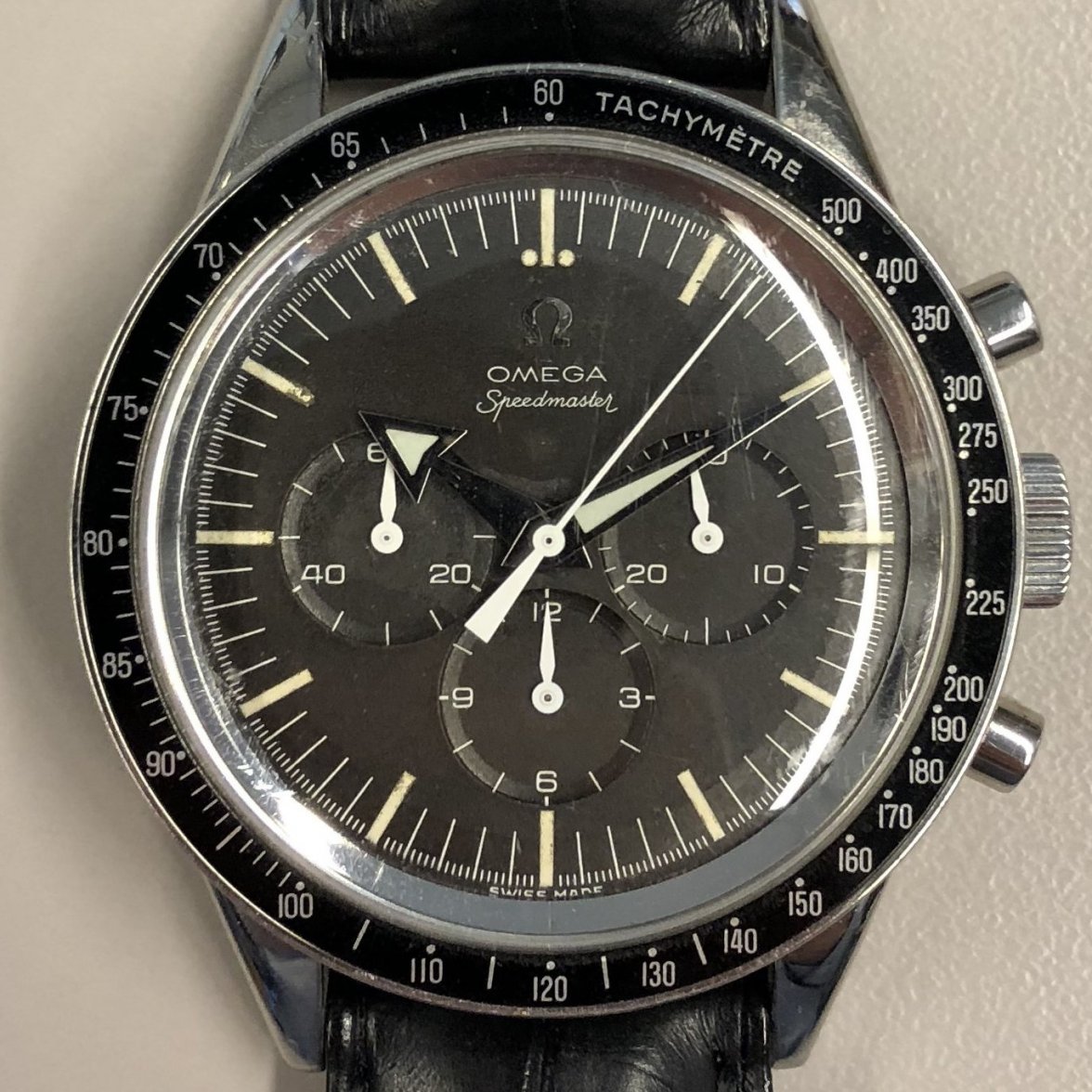

Okay, I'm a complete Omega rookie, but here's my 2915-2 situation.
1,690
5,246
So, this has an original dial, not a service dial? I've never seen 2915 dial in such a shape.
Its not in that great a condition:
The running seconds subdial is damaged. The lume has been scraped possibly. At least the printing is intact. As these dials go, this one is in the better part of the bell curve.
Look at the Oval O, the short indices.
So I think it is original, but perhaps not in un restored condition. I am fairly sure the lume has been removed - perhaps as it was Radium to comply with Swiss Regulations?

i`m pretty sure, there is lume present ob the incices. the running second subdial looks like it has Oil stains. a close up from the old hands could clarify a lot regarding the Lume. does not look like Radium to me. a Geiger would be interesting..... kind regards. achim
