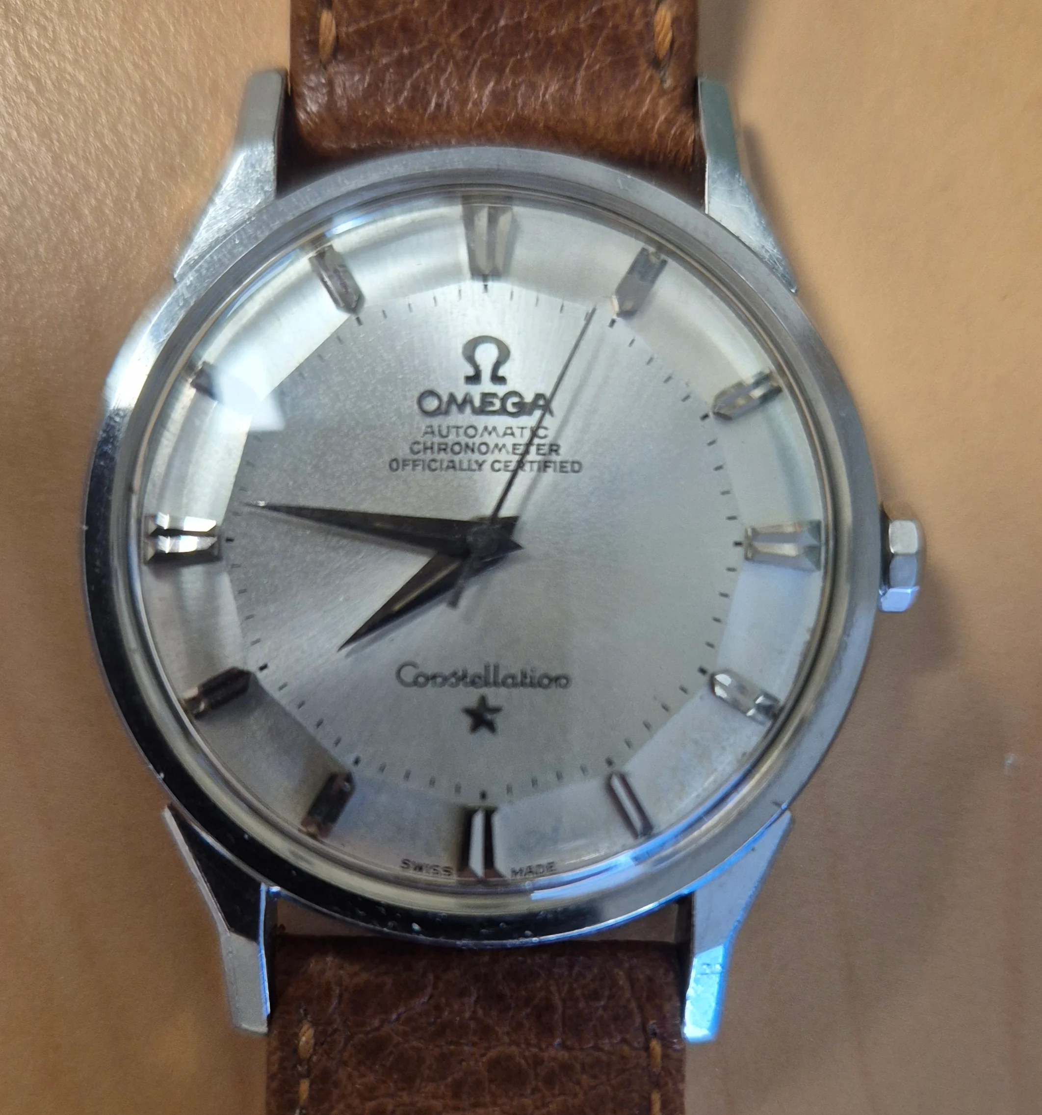

Posts 107 Likes 53 babaky ·Sep 1, 2026 Hi All, So it is done, After learning a lot here and following advise, it is done.....
Posts 1,610 Likes 2,722 Caliber561 ·Sep 1, 2026 Excellent example! They're getting harder and harder to find in such condition...
Posts 7,157 Likes 57,792 noelekal ·Sep 1, 2026·Home For Wayward Watches Good for you! Thanks for posting it.

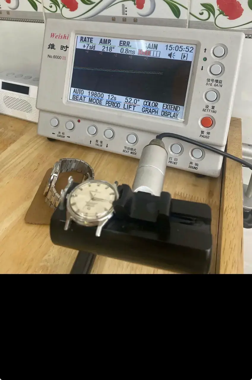

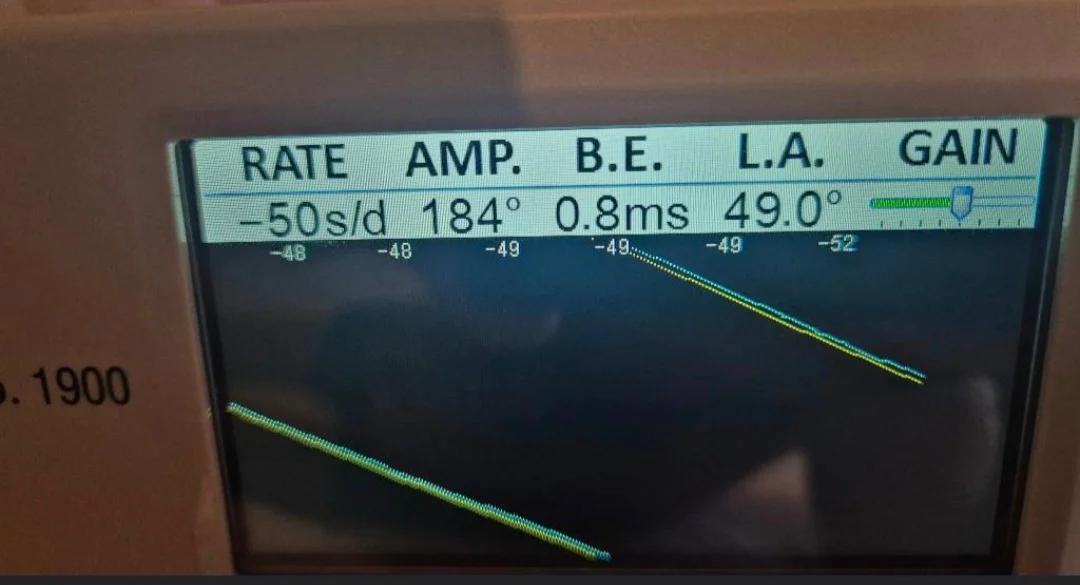

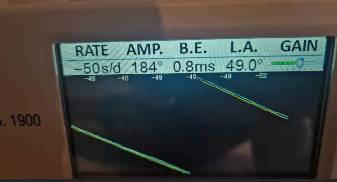

Posts 107 Likes 53 babaky ·Sep 3, 2026 thanks, I am very happy, except there is a slight problem. It is losing 7 minutes a day, so I put it on the time graph yesterday. Got in touch with the dealer as it has just been serviced. He sent me his time graph Not the same?? So the watch is on its way back to his watchmaker to see what is going on. Hope its something simple as I quite like this watch.😰😰
Posts 8,877 Likes 62,873 TexOmega ·Sep 3, 2026 Shipping can be a b*tch, best to locate and establish with a local watchmaker. Could be just magnetized.
Posts 107 Likes 53 babaky ·Sep 3, 2026 TexOmega Shipping can be a b*tch, best to locate and establish with a local watchmaker. Could be just magnetized. No I demagnetised it before putting it on the graph timer.
Posts 325 Likes 510 amuscare87 ·Sep 3, 2026 The lift angle on your screenshot and his screenshot are not the same
Posts 107 Likes 53 babaky ·Sep 3, 2026 amuscare87 The lift angle on your screenshot and his screenshot are not the same Yes, but its a minor difference and it only affects the amplitude as far as I know.
