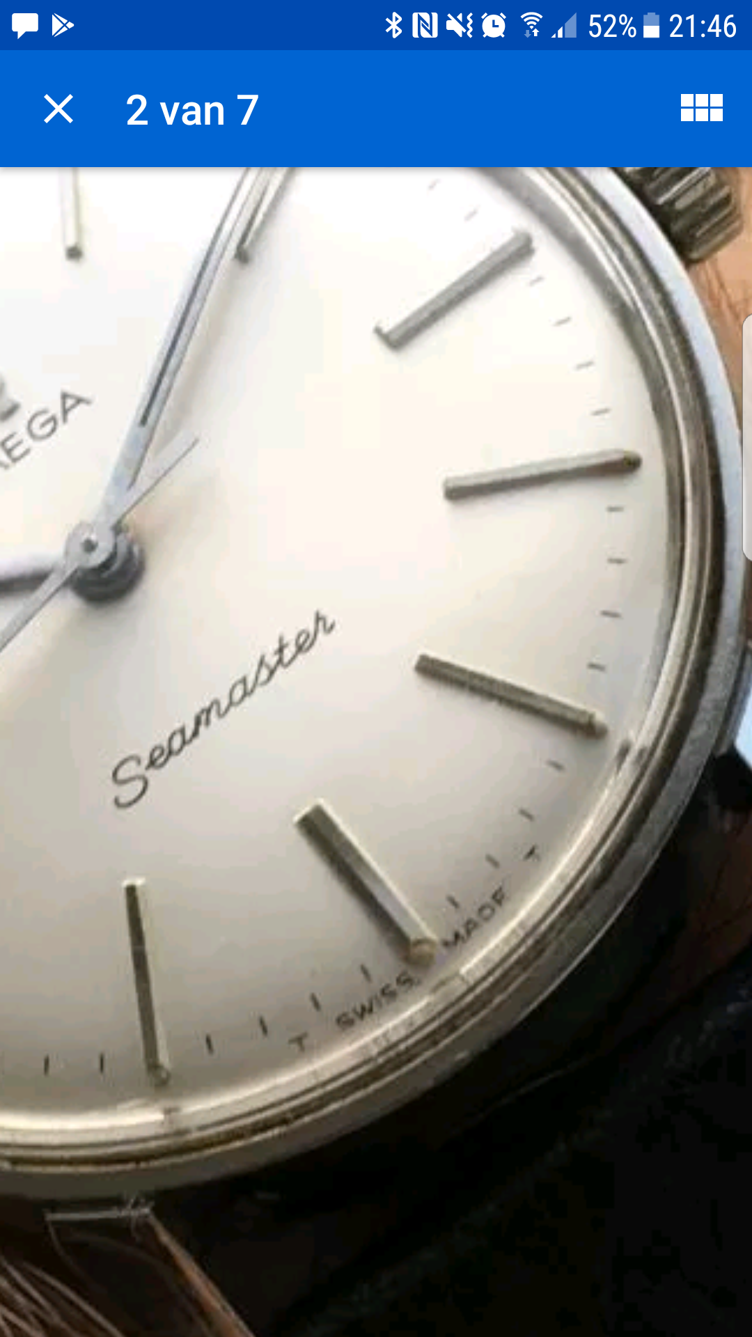

    Hi all,
    I'm brand new to the forum. I'm overwhelmed that it exists and I have been scrolling for hours reading through various threads digesting information like it's candy. It's an incredible resource and I'm grateful for the acceptance.
    I'm a recent enthusiast, my collection is small but diverse but always items of substance.
    I'm currently trying to purchase my first vintage omega, a relatively cheap seamaster as things go. But it's still a chunk of change for me. And I would hate to shell out only to be caught out by my lack of experience. I'm hoping that some wise watchers might weigh in on my choice and advice if I'm a fool, and how much an expert would consider shelling out for the same item.
    The item under consideration is :
    https://m.ebay.co.uk/itm/Vintage-Om...?_trksid=p2349526.m4383.l4275.c10&_mwBanner=1Purchases made through these links may earn this site a commission from the eBay Partner Network
    But I am also thinking of picking up this simple beauty:
    https://m.ebay.co.uk/itm/Sample-title/222951301818?pb=0&du=1&ebay-mobile-status=successPurchases made through these links may earn this site a commission from the eBay Partner Network
    (For no other reason than its incredibly simple face appeals to me-it would like sit on a shelf peaking out at me)
    I would appreciate that if anyone wants to weigh in on the selection that while offering a critique that they also offer the points for which they reject/accept the piece so that going forward I can apply the same methodical thinking to future potential purchases.
    Thanks all,
    Kevin.

    Welcome Kevin. I can't see anything wrong with that dial on that first watch. Always check out the case ref. number, which here usually seems to be Seamaster 600s or De Villes, so you'd need to do a search for examples with just plain Seamaster on the dial. However this is potentially a good, safe choice. Edited To Add: an image search for this case ref. seems to show only 600s or DVs, so tread warily and seek further advice.
    I would incline to give the second one a miss. My gut instinct says it's a redial, a very good one but it looks too clean to be true, 99% of black dials are redials and it's in South America where a lot of dodgy watches come from (or just fail to turn up...). And I don't care for the M in Automatic or the placement of Swiss Made.

  4. billythekid Apr 29, 2018
    269
    154
    hi, re black dial . it looks to new. it has no patina. also, it looks like the x hair is not central to the dial..

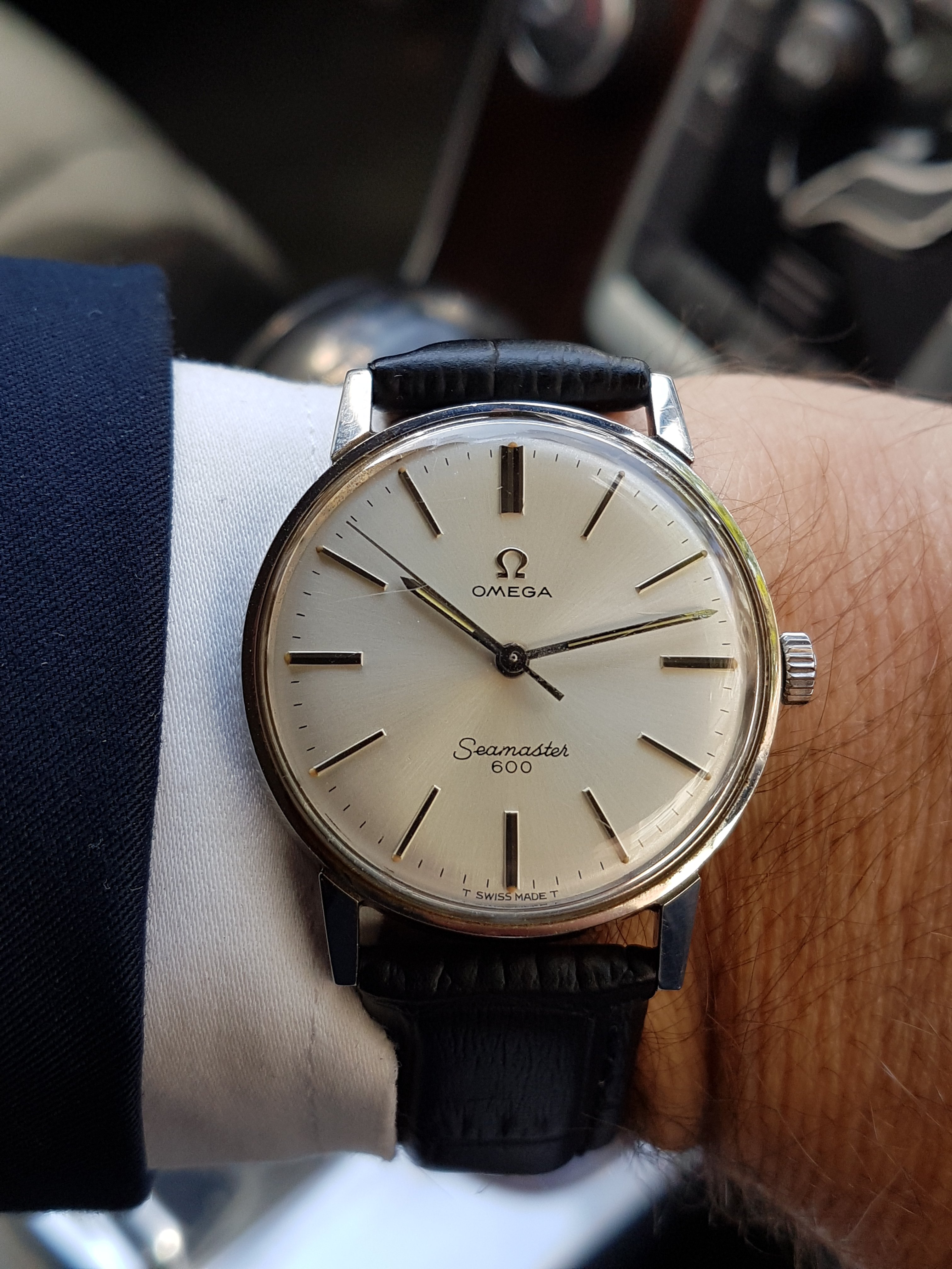

  7. Dan S Apr 29, 2018
    18,818
    43,265
    The OVD lists this ref as a Seamaster, so it's probably correct: https://www.omegawatches.com/watch-omega-seamaster-600-st-135-0011
    Keep in mind that the cal 601 manual-winding Seamaster watches are not as desirable as the automatic (e.g. cal 56x) and can be readily found for quite a bit less. Even at $600usd the seller would be doing well.

  10. Shabbaz Apr 29, 2018
    4,900
    17,865
    Huh. It's a 135.011 right?!? So where is the 600 on the dial? This is a 135.011!
