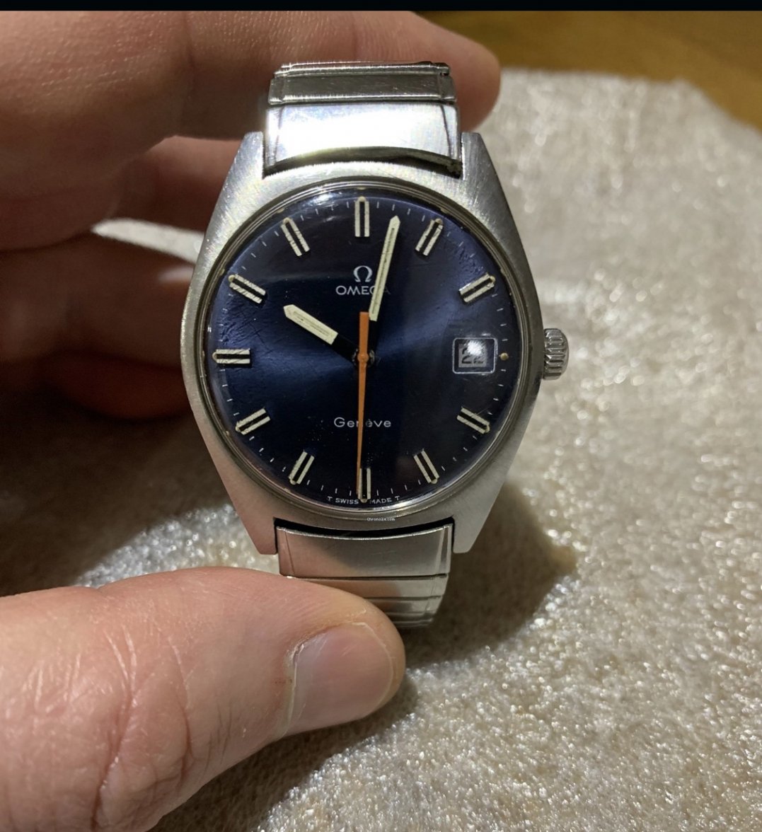

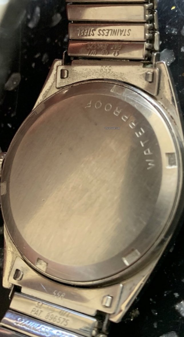

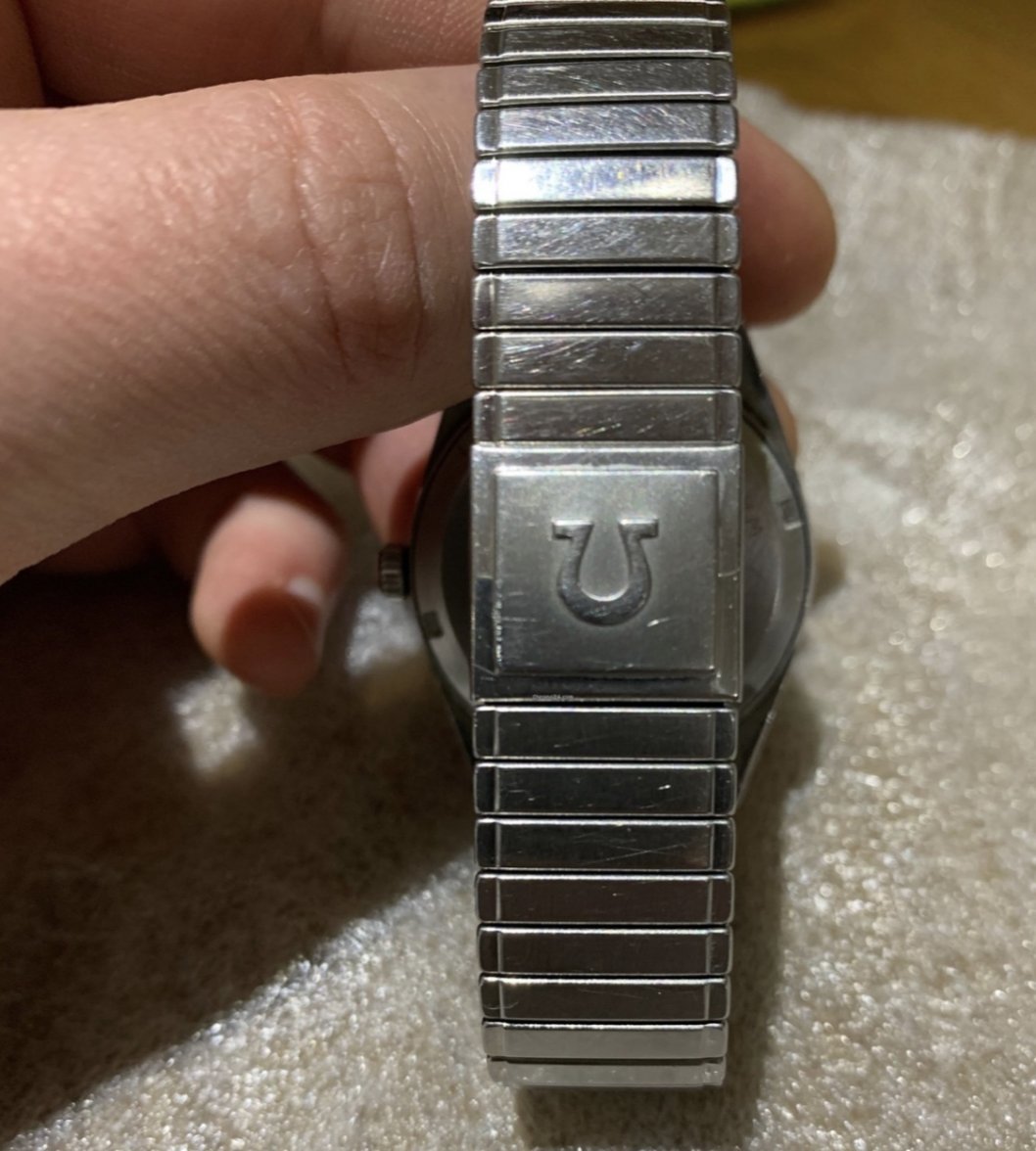

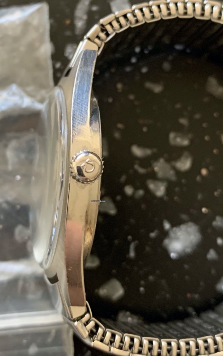

Hello all and hello to those of you helped me in the past, @DIV, @Archer and @Dan S. See how I got you guys tagged. Haha! Sorry guys. In the photos (again not mine, so not great), my questions are about this bracelet and crown. First issue for me is the bracelet. I had the same question last week to the OF about a similar piece. An automatic Geneve with reference 166.041 with a 1118/582 bracelet. Simply by looking at my bad photos, @Dan S was able to identify the bracelet correctly (the photos made it very hard to read the #’s on the clasp and end links) and help me out. Thanks again @Dan S! This time it’s also a Geneve with the reference 136.041 with a cal 613. The bracelet (1122?, maybe) looks like it belongs in a longer lugged Geneve, like a non-diver Admiralty (ex. 136.015). And second, the crown doesn’t look right, looks smallish. Sorry if my reference numbers are off, I think they are right, and thank you for the time. You guys are always helpful!! Again sorry bout pics.

Bracelet is an 1122 with 558 end links.
If it had the end links (563) for the Admiralty size lugs it wouldn't fit.
Crown maybe a replacement, but it's OK in my eyes.

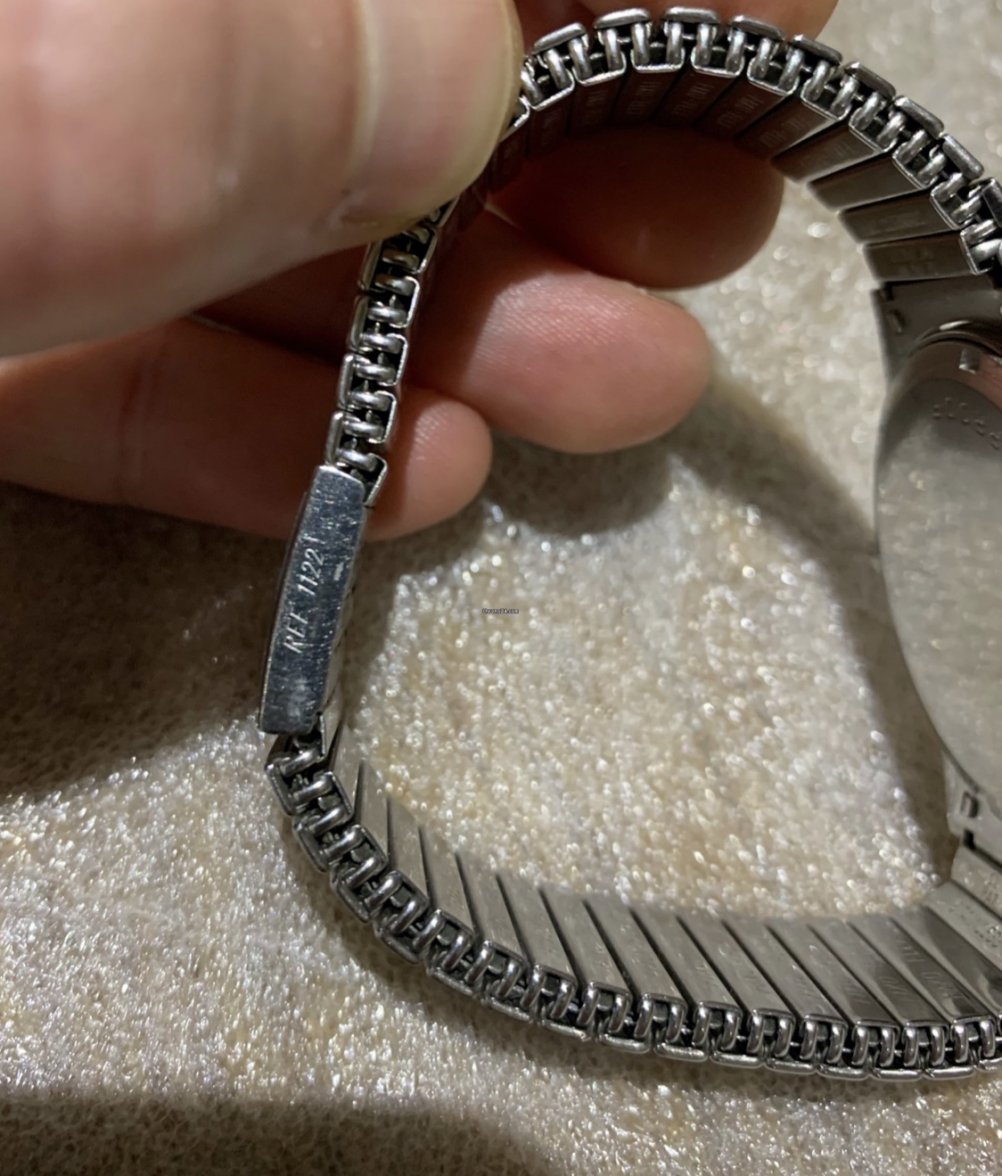

Thanks @JimInOz. Pic below. You’re right on the end links. Sorry I forgot to leave that pic. So the bracelet could be correct? The seller said he bought it with the 1122/558 bracelet. Thanks again.
