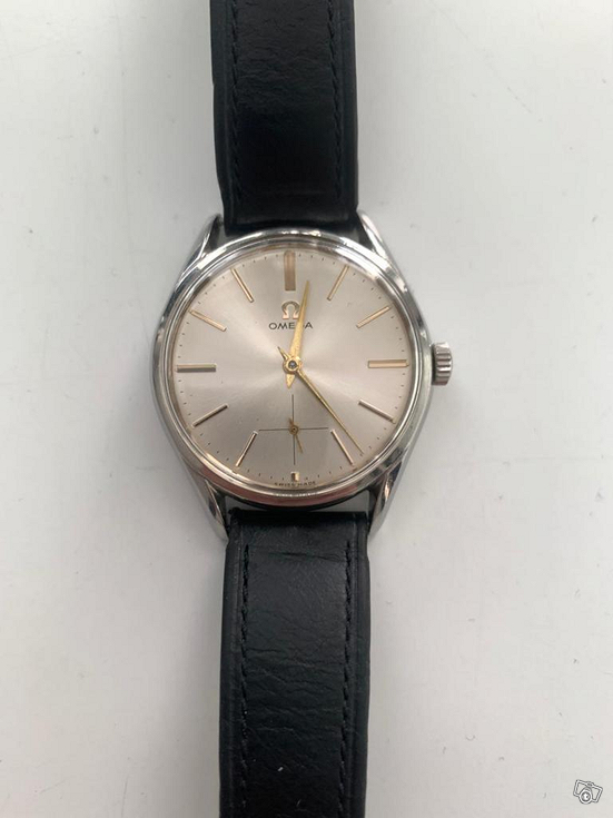

Hi, I have been looking for a seamaster 30 and had found a decent one, but was putoff by lume possibly being radium - the whole story in another thread.... long story short, the guy that was selling that watch contacted me as he has a 1954 omega, likely not a seamaster as it has no marking. Movement is cal.266 I thought I might go look at it, I was just wondering if you wise people might have some advice on what to look for? Apparently it was just serviced and has a tolerance of 16 seconds/day. It is also claimed to be original. I am including some pics that I got from the seller, but of course they might not be too detailed. That did not worry me too much, as he is local.
I have read much of your input in the past, including the how to fish piece, which is excellent! Any tips are welcome. The other thing, that I would ask you is your views on using this as a daily wearer? not sure this may be appropriate given the age, but who knows? on this basis, Nomos also takes my fancy, quite much as a more modern alternative. Thanks for your insights!

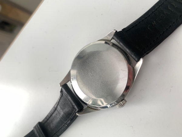

Please post pic of the back of the watch.

Thanks Bill, here is the back of the watch pic. I only have these three, I just got this today as I was asking about engravings. For whatever reasons, over here engraving seem to have been quite popular at one point in time :/

Case looks like a 2639, but a sunburst dial wouldn’t belong in there - generally, 1954 is too early for that. Also, the small second is too short (it should be as long as the cross hair) and the hour and minute hand are a strange mix of styles. This is surely no “original” watch, eg it didn’t come from Omega this way.
edit: More than happy to be corrected, though 😀

It looks like a manual wind Seamaster to me !!!
See the back is marked waterproof ( 6 oclock position )

Thank you @Bill Sohne and @MtV! Definitely your eyes are much more tuned into these details, like inconsistencies or worn out markings on the back. I definitely value your views. Indeed after a quick scan on pictures from similar years, it seems that the hand on the minute dial is a bit too short... Also, I thank you for the comment on the dial. Period coherence checks need experience which I don't have, so once again thanks! I will try to source some further information, and if I do, I will keep you posted.

I agree that all of the hands are mis-matched. Perhaps one is correct for the watch, but I'm not sure which.

with that movement, it could be pre-seamaster or pre-connie.
Not if the the serial really is from 1954, it’s too late, and certainly not a Connie of any kind as it’s man wind. Looks like a mid 50s SM with a replacement/service dial to me.

Dial and hands are incorrect IMHO. I think the dial is a later service dial.
If 1954 my guess the watch is from the model line "Other"
There is something... Off about it.
- The sunburst finish is too strong for an Omega of this age.
- It can't be a 2639 as those are screw-down caseback, so it could be a 2791 (or is it 2792? keep forgetting)? Those came with or without Seamaster typing on the dial.
My view: a ref 279X with replacement crown and hands and a dial someone has tampered with. Either service replacement or redial.
