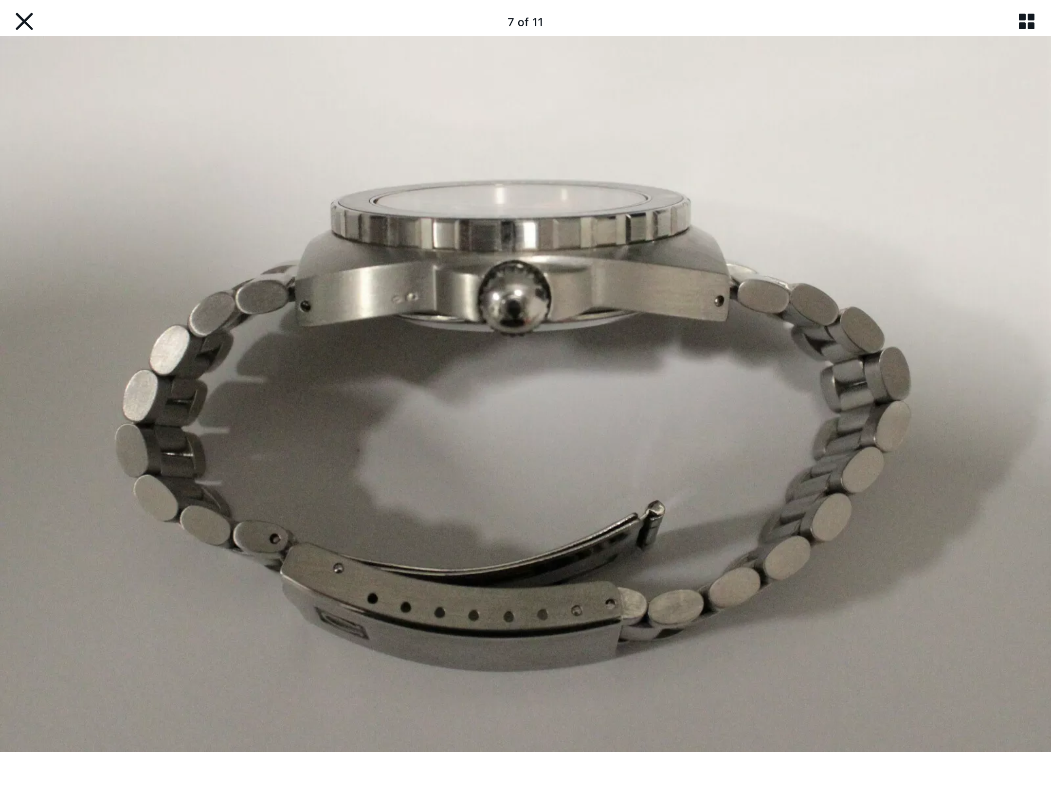

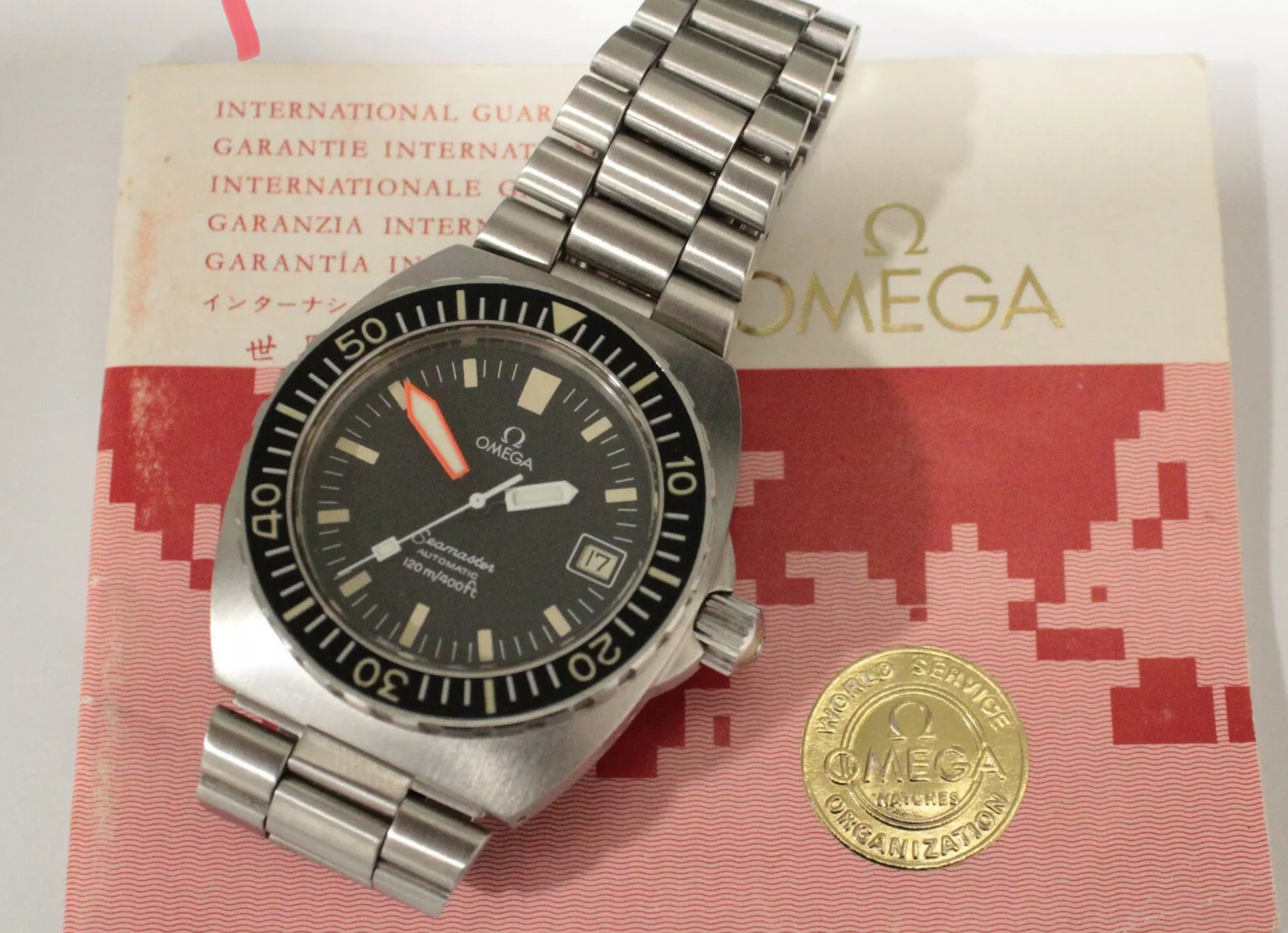

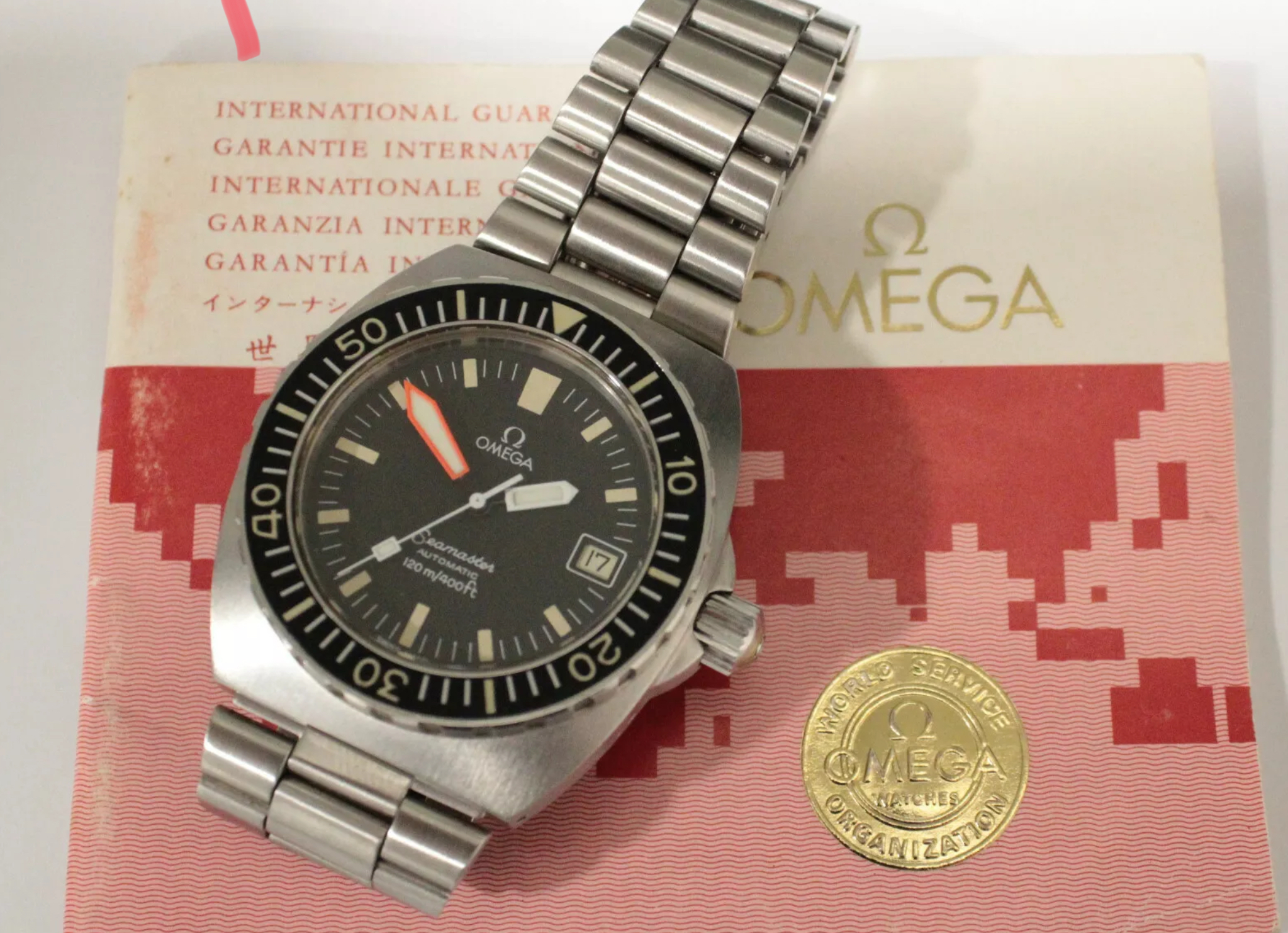

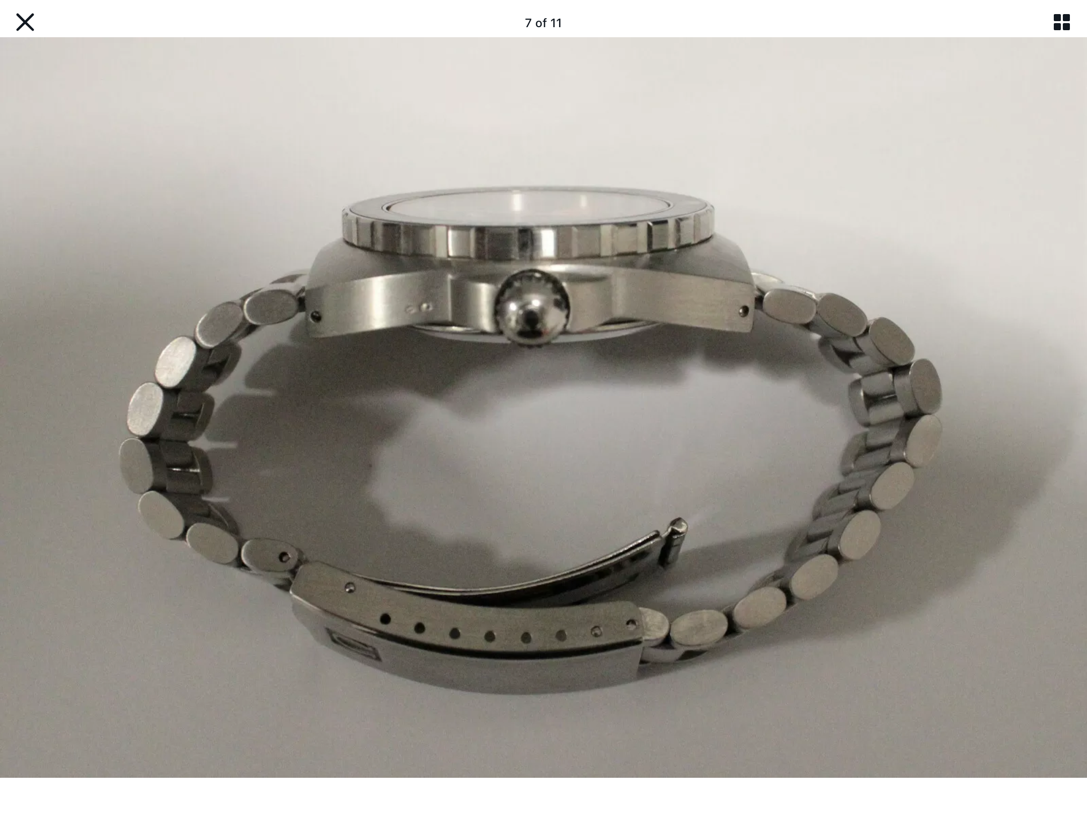

NOS?? 166.0250 Baby Ploprof on EBay from Portugal. Has papers from 1999 although the watch was produced in 1978. Hands appear to be replacement as well. bezel appears new and correct. Even has the imprint from Portuguese customs. And it has the wrong dial. A later service dial. I messaged the seller who seems quite surprised. I suppose a buyer would be as well.
ebay listing
Customs stamp on case looks correct....I think.

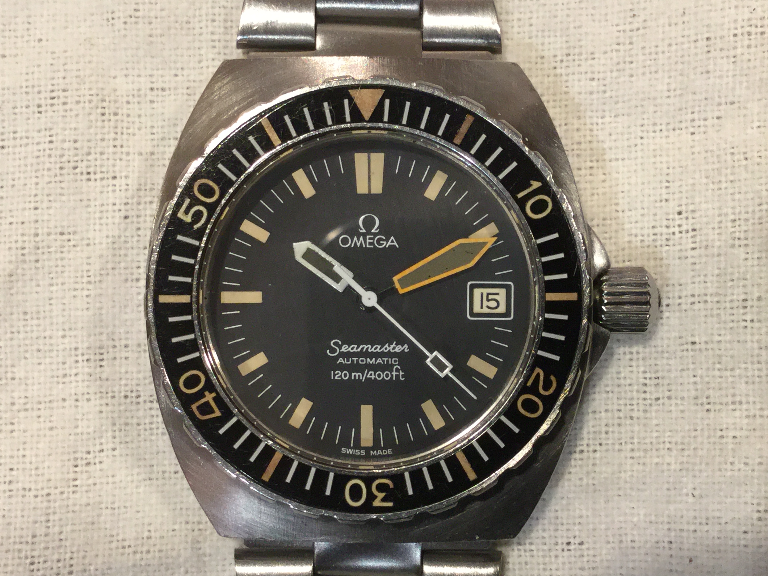

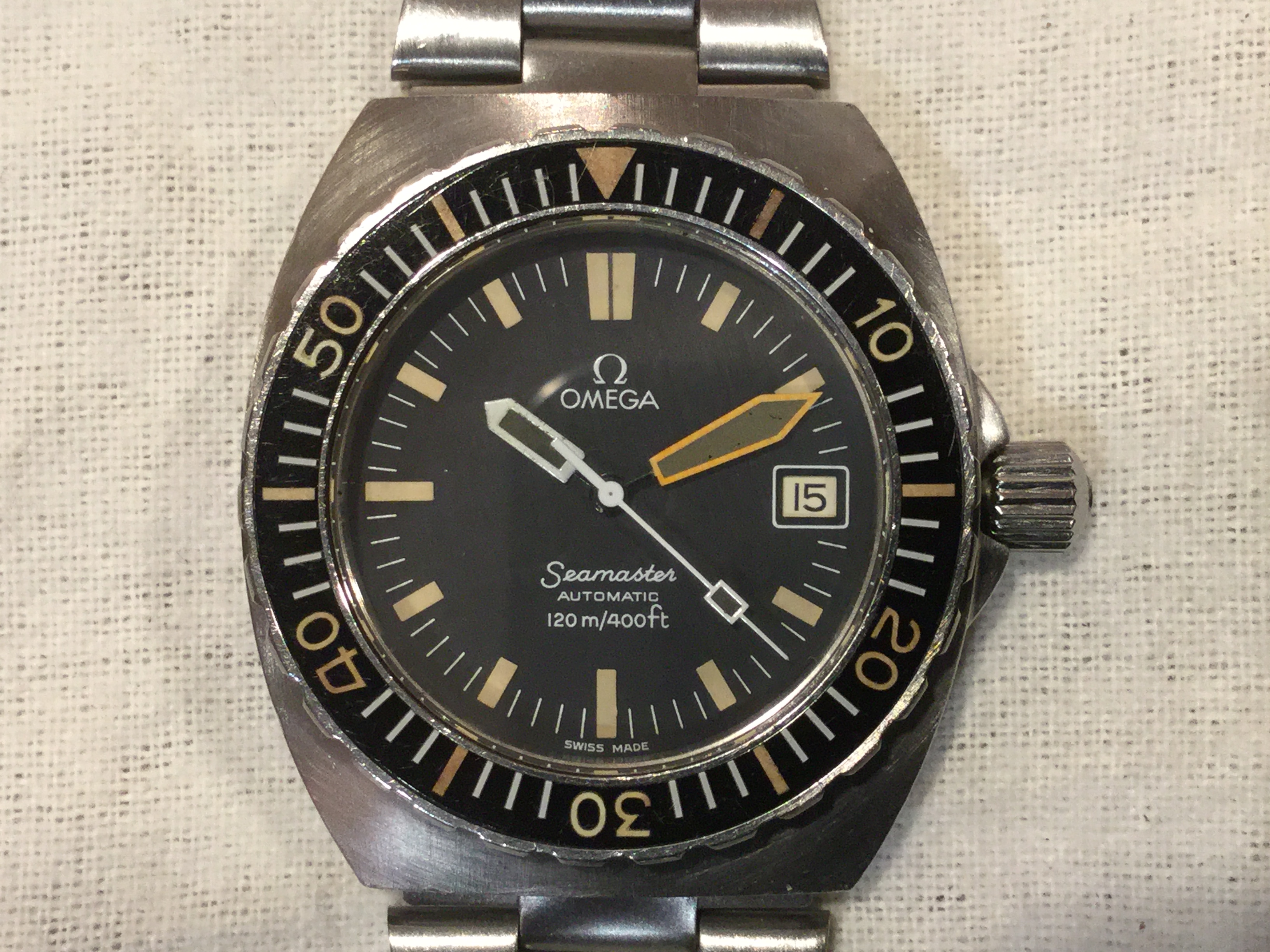

Here is a correct example.

I do wonder if this is not an original dial. It looks tritium to me. I have not checked but I had a few of these over the years and half remember having both variants in Tritium.
78
103
I would agree, the later dial was a tritium single index marker at 12 and the service dial was luminova, bezel looks good, service hands and likely warranty papers from another watch unless it’s been sitting in a safe for years..
