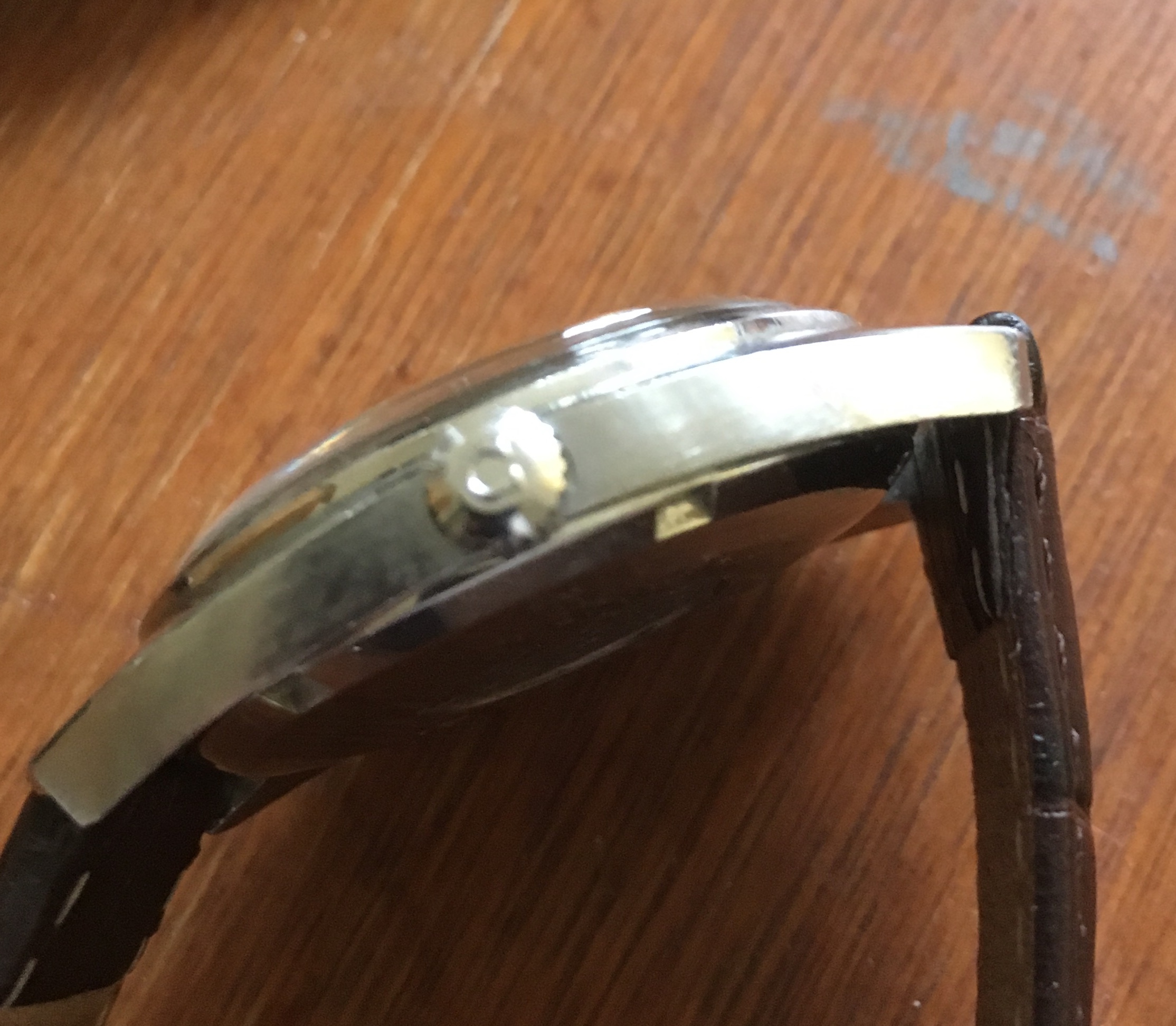

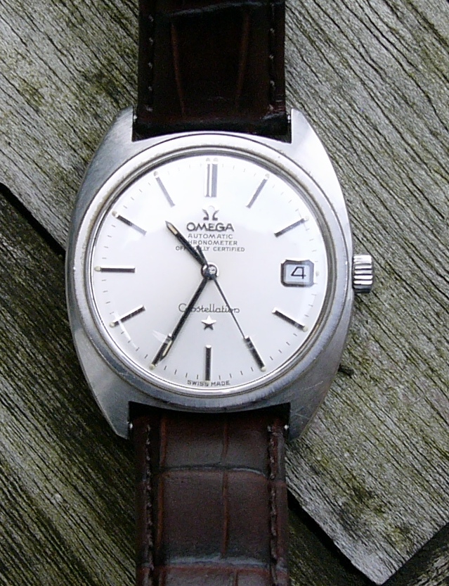

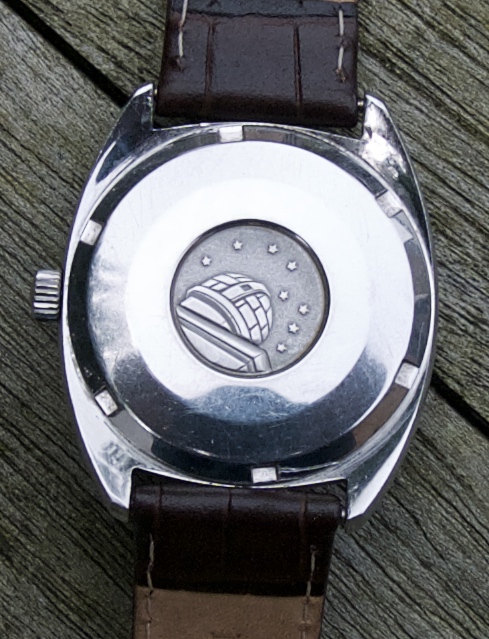

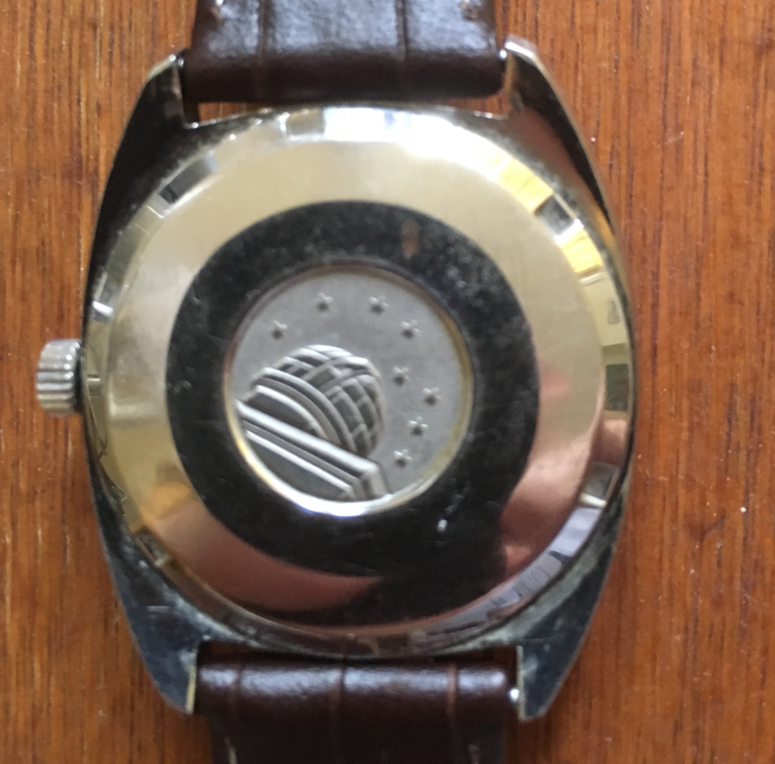

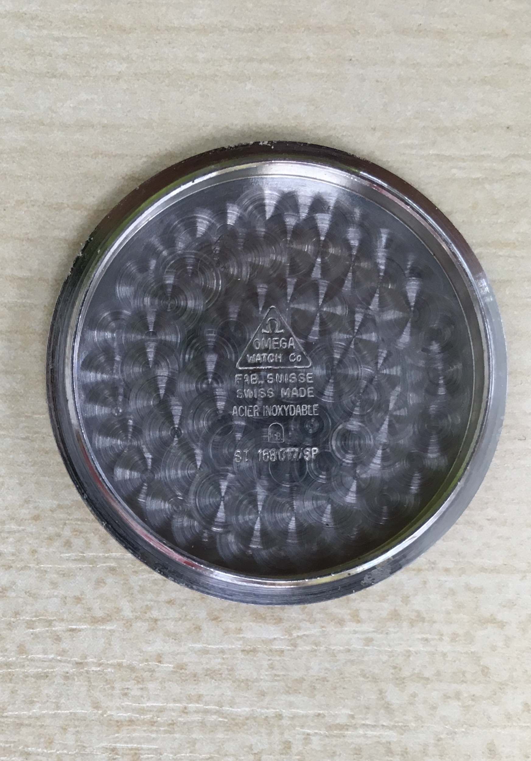

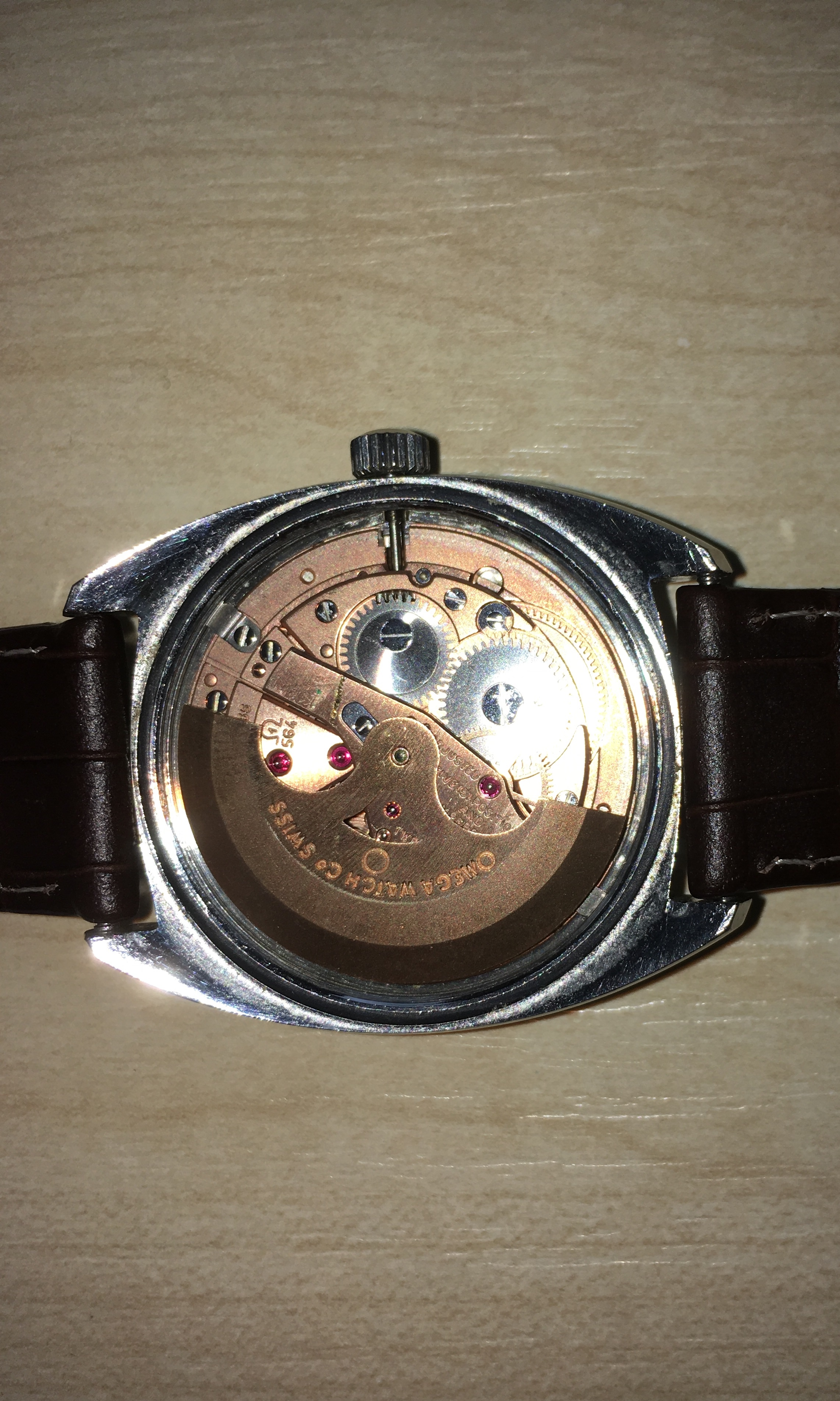

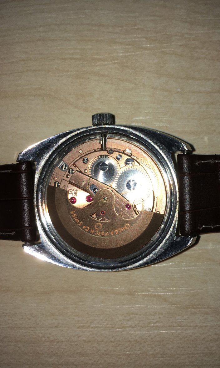

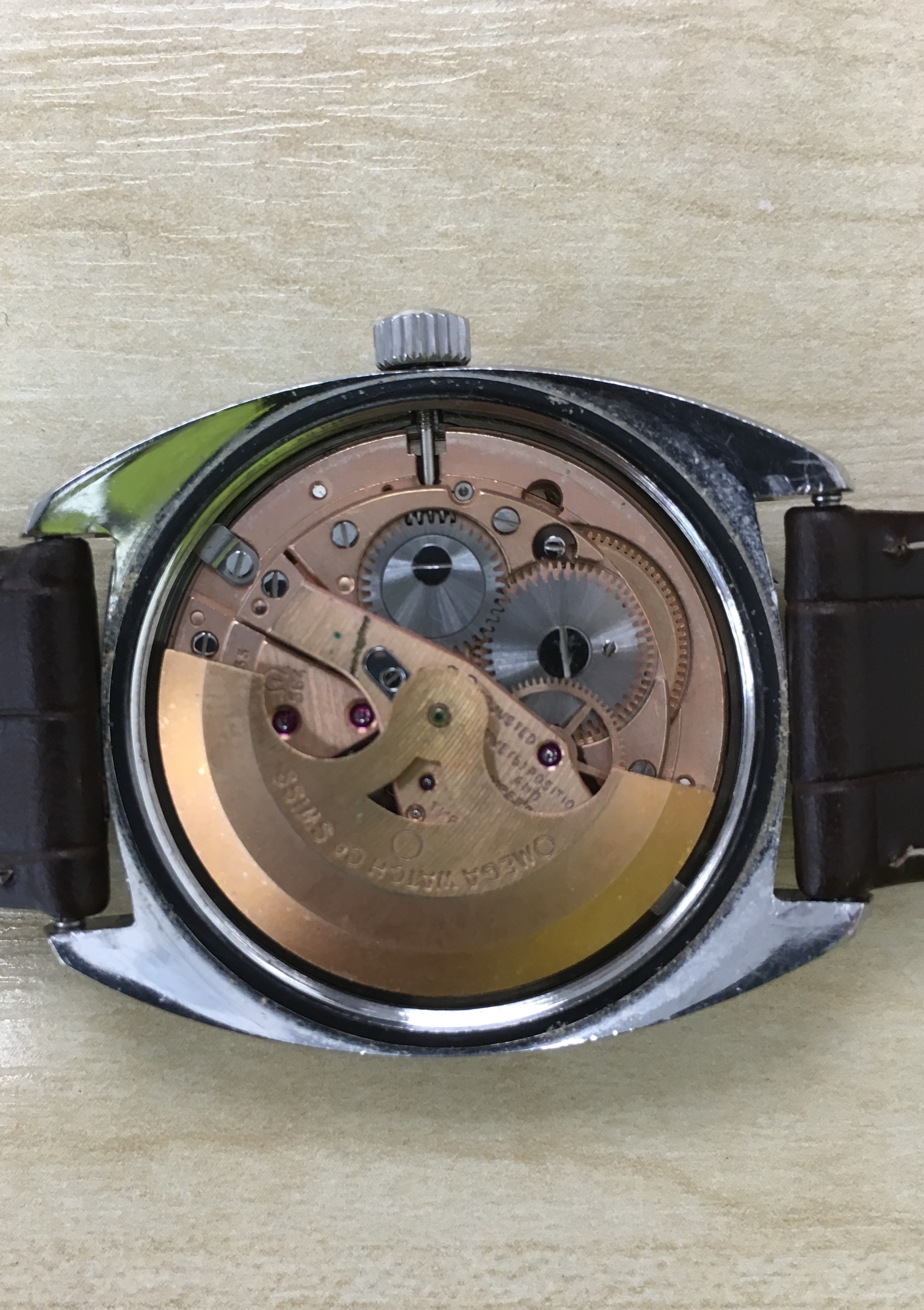

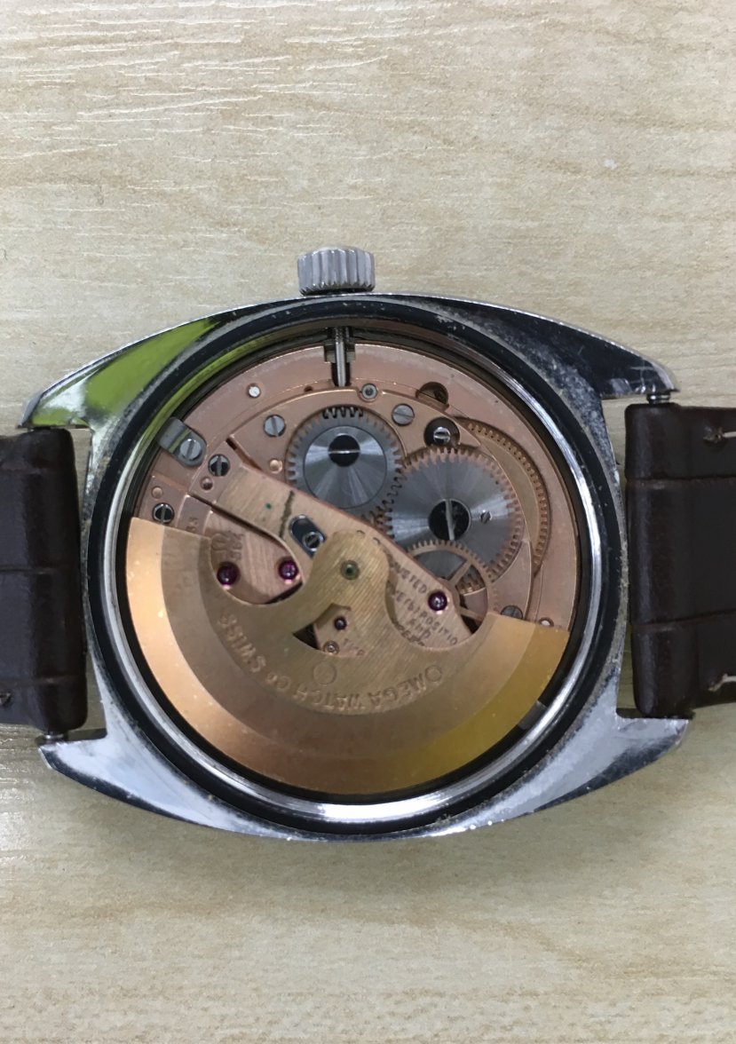

Then I saw this and I liked it. The listing was, I thought, honest, but there were no images of the inside. I decided to take a risk on the basis that if the watch was wrong the seller would not be difficult if I wanted to send it back. Now I've had it opened up and I think I've got a decent example. I know it's not a super-collectable watch but it will be a nice watch for daily wear. There's a small crack in the lens below the surface which is hardly noticeable. The seller pointed this out. As the lens has the Omega signature I think I shouldn't change it.
Here are some pictures. It's a Constellation "c" 168.017 cal. 564. I'd really appreciate being put right if there's anything wrong about the watch. I paid £500 for it. Is that reasonable?

To me it looks like a redial and wrong hands. Should be without lume dots and lumed hands. And if it came originally lumed I‘m missing the T for tritium.
But please wait for the experts opinion.

Absence of the T is fine, just look online for this model. Hard to tell if the dial is good from that photo. Hands and fonts look ok but markers look relumed - final S in Swiss Made shouldn't be blotted out.

Like @Edward53, the lumed out 's' in Swiss stood out for me, as did the seemingly off kilter lume plots at 12 o'clock and elsewhere. @Hijak has a killer 'C' case for sale on the private Sales Forum. Not $500, of course, but a gorgeous specimen nevertheless (that would be on it's way to me now if I weren't in Canada!)

Yes that does seem weird to have the lume plot on top of the S. The Swiss Made looks a bit off altogether, the E looks kinda cooky unless it's just the pic or the UB edge warp.
Other than that it looks good to my non expert eyes.

Incorrect assumptions!😵‍💫 Sometimes the light can play tricks with the color of hands, I’d would want to see better pictures before making any claims.

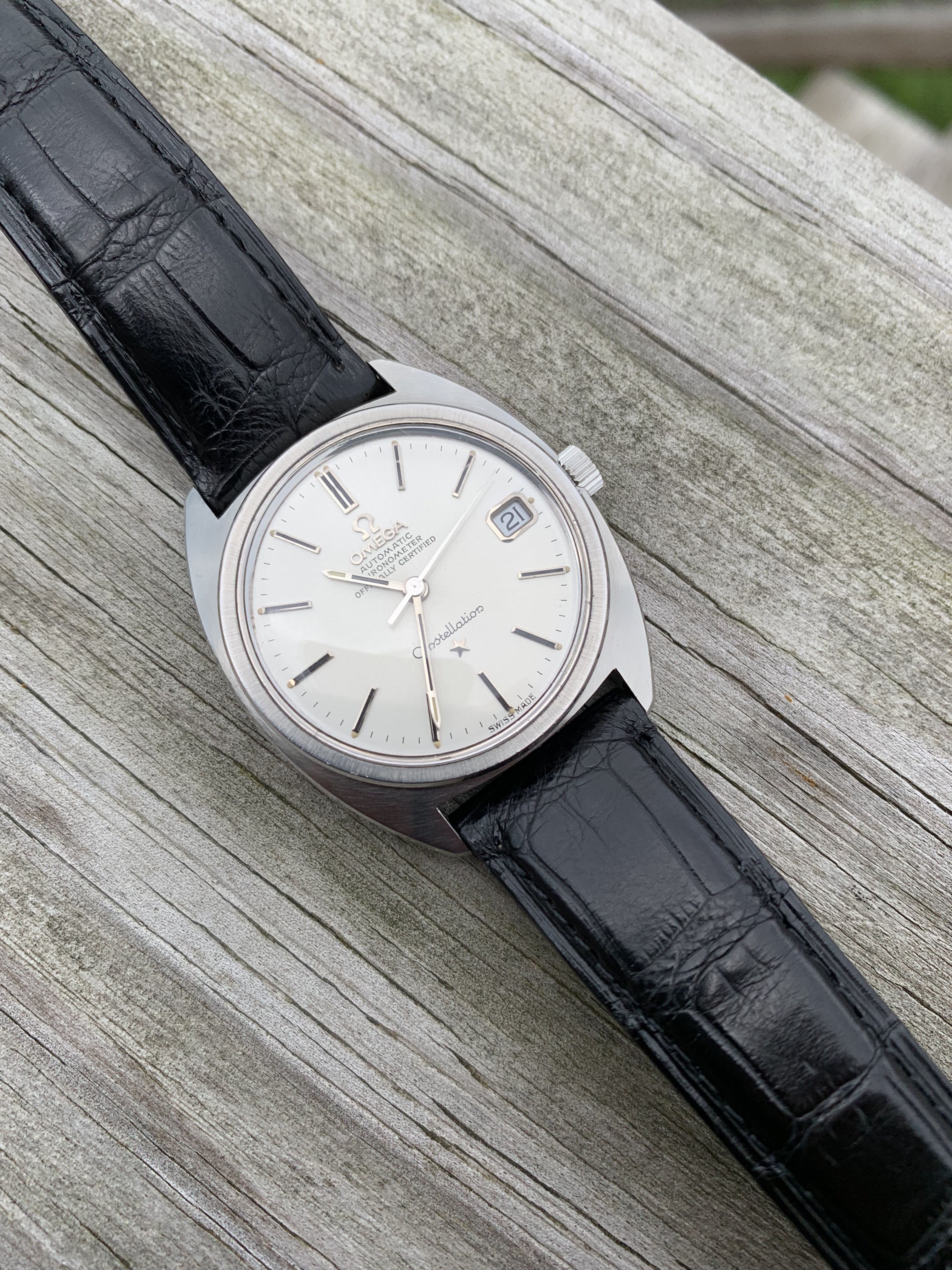

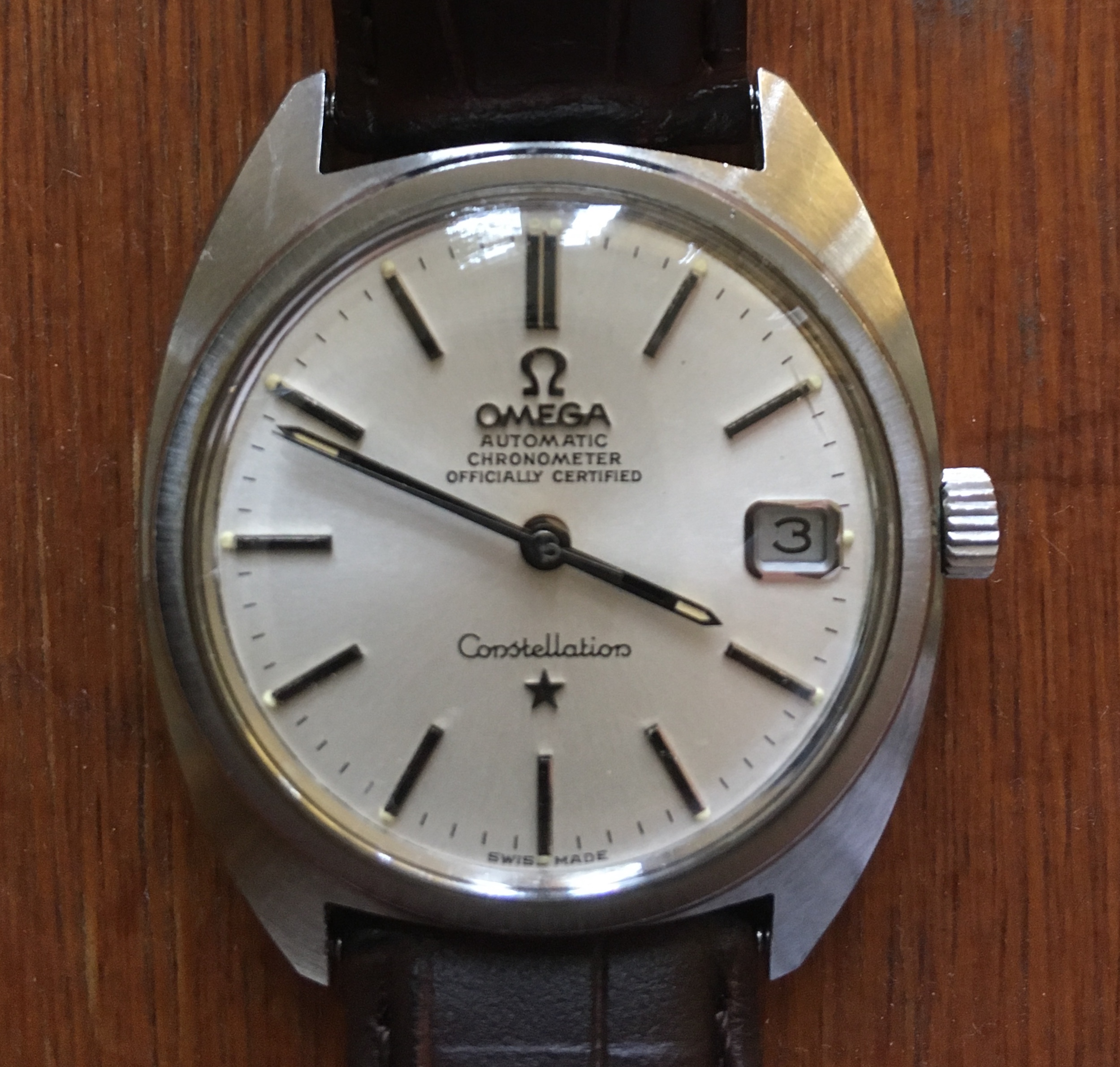

Flat indoor light makes for not very good watch pictures! The hands and Lume on dial should be there on earlier versions (564 movement versions) like this but at least on dial may have been relumed. You did well @Engee at $500 for this, a picture taken in better (outdoor sunlight maybe) would give us much more to go on. Here is a picture of my c-case for comparison...
Here in Wisconsin haven’t seen the sun in a bit so this picture isn’t the best either. but you can see from this that yours looks pretty good from an originality standpoint!👍 Also your crystal seems to be an original Omega based on Omega logo in center.

I think the dial is legit. There are several tritium examples without the T marking. Plus AFAIK no 168.0056 has the T, so it is fair to assume that lates 017 do not have it either. It may have been relumed at one point but it is correct to its specifications given it also have the lumed hands instead of the thin black ones.
The gold bezel is brushed as it should be, and difficult to tell but it seems the case still has its radial brush. The end of the lugs look also sharp so I guess it will look good overall
Do not worry too much about the crystal, it is not a huge scratch. If it bothers you in the end, for sure you should look for an original and not a replacement (or find a very good replacement but keep the current one in case of a resell one day)

Thank you Lurk41. Just for clarification, it's all SS, no gold. That must be the artificial light the picture was taken under.

I see what you mean about the lume. Mine is rather blobby compared with yours. I wonder if it's realistic to have the lume re-done?

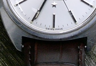

Having looked at mine at home, [EDIT: and the new OPs pictures] I'm not shure anymore that it is relumed:
On the OPs watch the second S of Swiss is only half hidden by the lume dot, exactley like on mine (of course mine could also be relumed), I will post a picture of mine later
EDIT: Other examples with half hidden 'S'
