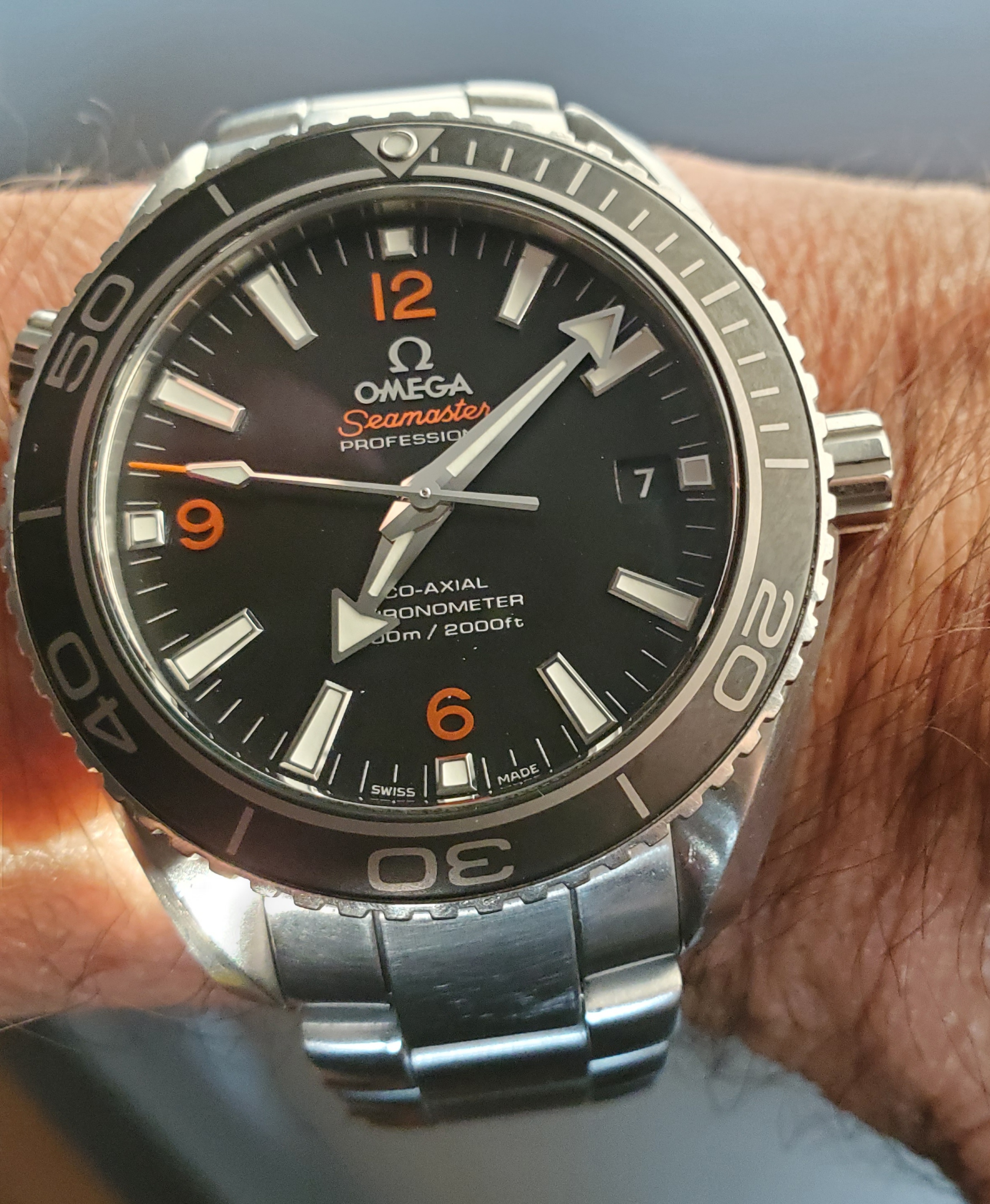

So I set my watch yesterday at 9 am (SMP 2500d movement....watch was stopped from not wearing it). I fully wound it. I just noticed that it’s 11 seconds fast in the past 30 hrs or so. Now when I first got it, (about a 2 months ago) I tested its accuracy and it was +3. Now all of a sudden it gained 11 seconds in a day. So is this cause for concern, should I wait longer and see what happens? Could it be from letting it stop for a week? Is this supposed to average out, everything I read says it’s an average but I really don’t know how it averages...

I’m just curious bc is supposed to be COSC certified. So +11 seconds seems wildly out of spec. However it could loose time over the next 2 days I don’t know. I’m kind of new to this

I did not buy it new, the receipt I have from the guy says it was purchased in Feb 2017 from sterling jewlers. Not serviced yet although it shouldn’t have to be. I do have quartz watches My work watch is a luminox, and I have several autos. Just my first Omega. Never really cared about accuracy when it came to things like my SKX or Oris aquis. But they never claimed that they were COSC.
Maybe I did not pose my question correctly. I tested the accuracy and the power reserve on the watch two weeks ago it was running a little bit over +3 seconds. I tested it over about a week. The power reserve lasted approximately 54 hours.
A few days ago I set it again as it was stopped for several days and in one single day it gained 11 seconds. It was running fine a week ago at +3 now I reset it and it’s +11.. right now it’s about two days and it’s at +15.
My question was what would cause the watch to go from running from +3 and then a week later running to +11 when it wasn’t used. Or am I being ridiculous by testing it every day as opposed to testing it over a months time doing the math and seeing if it actually is in COSC standards.

This is probably going to sound a little ignorant to most people here. However, it may NEED to be serviced, But I Don’t think it SHOULD need to be serviced. It’s only halfway through it’s service interval.
Now saying that, I’m not stupid, things happen, I don’t know exactly how the watch was treated by the previous owner. He may have left it in his freezer for 3 yrs. Letting it sit and never worn may have gunked some stuff up in there. I don’t know.
but this is part of my learning experience here. What would make it go from +3 to +11. Could it be from me letting it stop? Is this normal to have a variation like this? Should I bring it in.
now since most people are telling me to stop being so anxious and just give it time and see what happens, that’s probably what I’m going to do.
