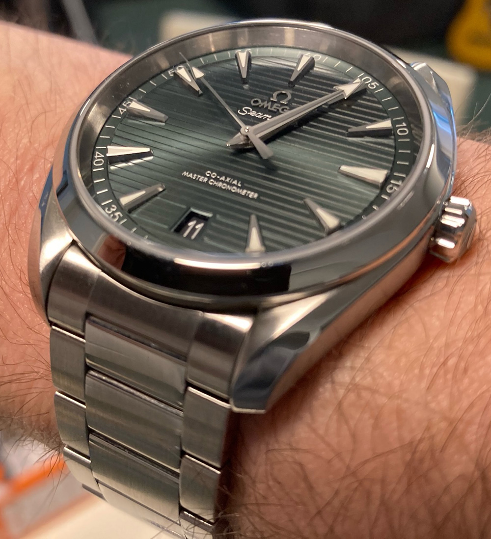

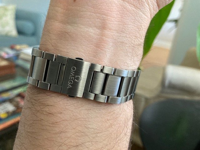

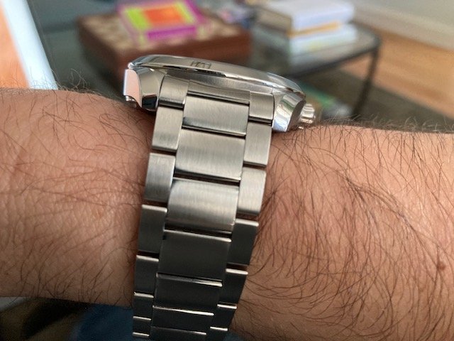

I decided to go the DIY brushed center links option, figuring if I mangled the job I could always get a pro to re-brush (or re-polish) them. In the end, I'm very happy with the result and have no regrets. I respect Omega's choice to use PCLs on a watch that can swing from workplace to sporty, but for my use and my taste (not a blingy person at all), the all-brushed look is just way better. And especially on this model, with its mesmerizing green (dare I say Patekly?) dial, I think toning down the bracelet is a good move---it really focuses the attention where it belongs.
For anyone who's interested: I did a ton of reading and video-watching before committing to this, and was, I'll admit, slightly nervous at the prospect of damaging an expensive bracelet, but felt reassured upon reading, consistently, that nothing I'd do could really be irreparable (short of something cataclysmically stupid). I also practiced first on a few old junk watches and a spoon my wife won't miss before getting anywhere close to the AT. I used two media: first several swipes with the green scotch-brite pad (standard issue, grocery store item); then several more with a 3M ultra-fine pad, purchased for about $3USD from Home Depot. That's it. I'd say about 20 swipes with each and it was done---couldn't have taken more than 2-3 minutes for each length of bracelet. I made long swipes in one direction only, and had the clasp and already-factory-brushed parts masked with painter's tape. The bracelet was removed from the watch during all of this, so there was never any risk to the case.
Is it perfect? Certainly not. And I know myself well enough to know that I will almost inevitably end up doing some touch-ups in the future. But I've worn it now in several light conditions and don't see any flaws---at least not any that bother me. I'm sure under magnification, or looking at an enlarged photo, it'll be a different story, but to the naked eye, you'd never know it wasn't factory-finished. Glad I did this, and glad I didn't pay anyone to do it for me.
One of these days I'll probably get around to brushing the removed links too, but for now I'm just going to enjoy wearing the watch without the glammy center links driving me nuts.

P.S. the horizontal line on the second link is a reflection, not a gouge. 😀
56
124
For a do-it-yourself effort, the results look great. And I agree, the AT looks better, less blingy, and more versatile with an all-brushed bracelet.
