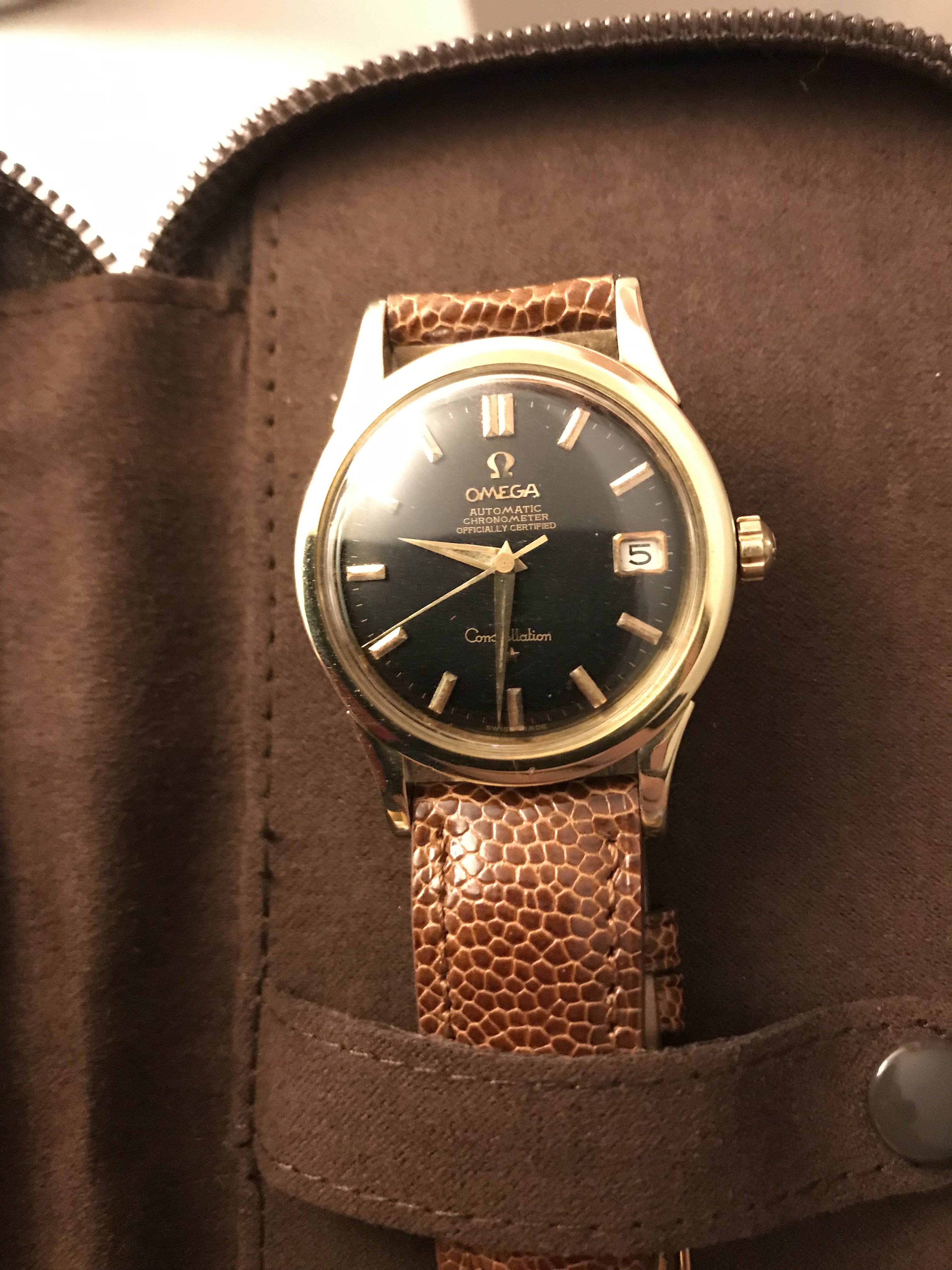

Hello and apologies in advance if this question has been answered countless times before. I purchased this watch today, an Omega Constellation (1960) but I was surprised to note that the ‘N’ at the end of the Constellation didn’t have the curve. I assumed for this period that it would have it? I’ve been trying to compare it to others and have been getting confused. Any clarity would be much appreciated.

I'm pretty sure you're correct. From what I've seen, even on the later models the font is different from what I see on yours. Maybe that font is used on references I never look closely at. I've gathered that black dials are often faked or repainted since they're sought-after.

Original factory-finish dials had the straight n from the 70s onwards. Your example is earlier, as you noted, and was redialed, unfortunately. Whoever did it picked the wrong font.

Not looking good but we shall wait for the expert's opinion. How much did you pay?

Agreed. I brought my first purchase to a watchmaker who told the dial looked good, but the members here showed beyond a shadow of a doubt that it was a bad redial.

I'm not an expert but that one look like a redial to me. Wrong font, also the size of each letter seem uneven.

Redial, badly
"Constellation" font not from the era of the watch and spacing is not good up top

Buying a black dial without being a black belt (in knowledge of the model) is a ticket to sadness. The vast majority are redials including this one.

As others have said, unfortunately, the dial has been repainted.
Alongside the incorrect font and spacing, a 1960 version of this reference, 14393, should have the 'missing text' dial.
There are uncommon examples at both the beginning and end of the production run that have the full text dials but this shouldn't be one of them.
The case is quite polished and the crown is incorrect for this reference.
If the watch was described as original, you should probably try to return it if you can.

I’m curious, is the lettering of OMEGA usually so close together on a Constellation?

Can I clarify - this was always a black dial but it has been painted again? I’m new to this hence asking.

Can I clarify, when you say the dial has been repainted, was the original still black?
There's really no way to know, but it's unlikely given that black dial Constellations are uncommon. People repainting dials frequently make them black because they are so desirable. There are probably 10 times as many black-dialed vintage Omegas now compared to the number originally produced.
