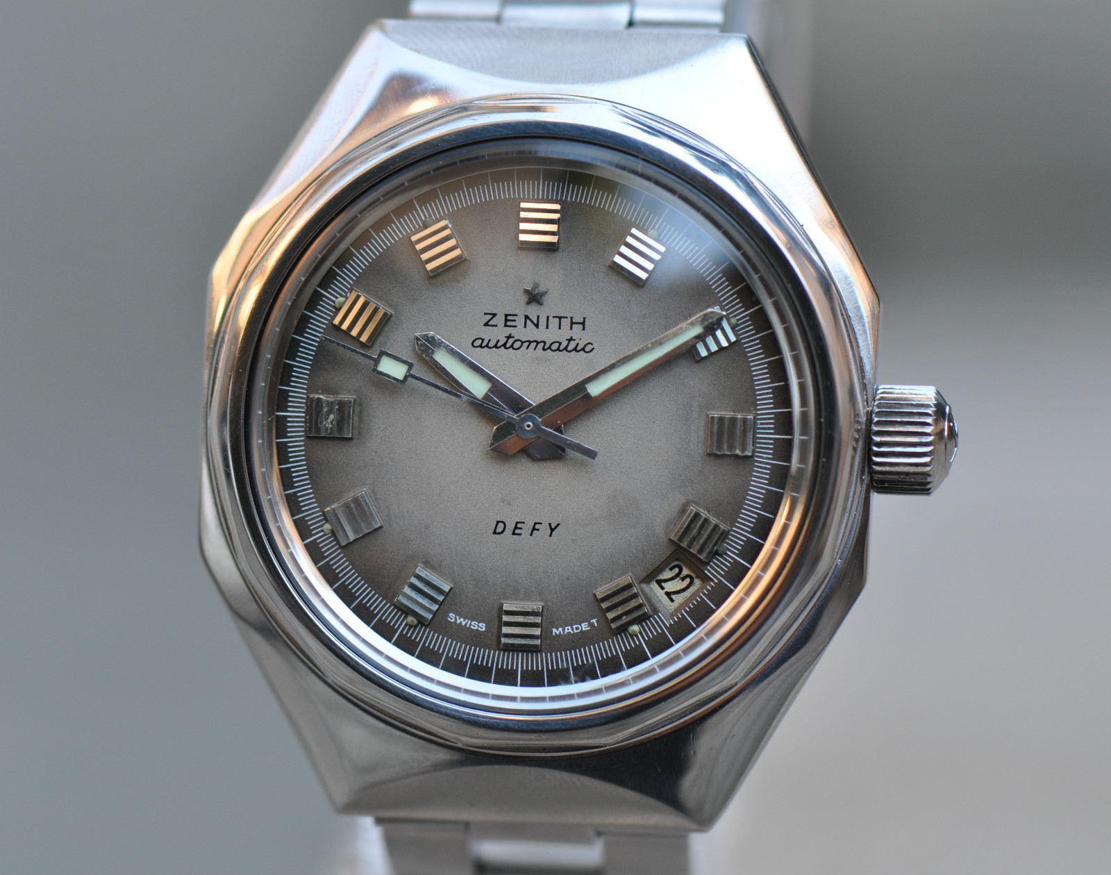

    Thanks MMMD. I was looking at this Defy and I thought it was overpolished. But looking at the ad you had posted in the first picture, it seems to be fine to me. What do you guys think?

    I like that one, except for the color of the relumed hands. And the 2562pc inside might be a replacement for an original 2552pc; usually the ones with 2562's inside say 28800 on the dial. It's been polished, I think, but overpolished is in the eye of the beholder.

    Thanks MMMD. Am with you on the relumed hands.
